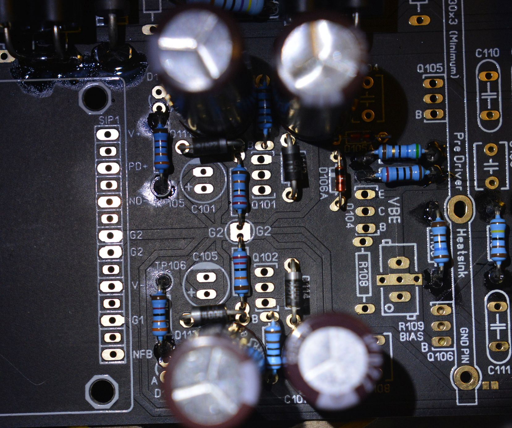

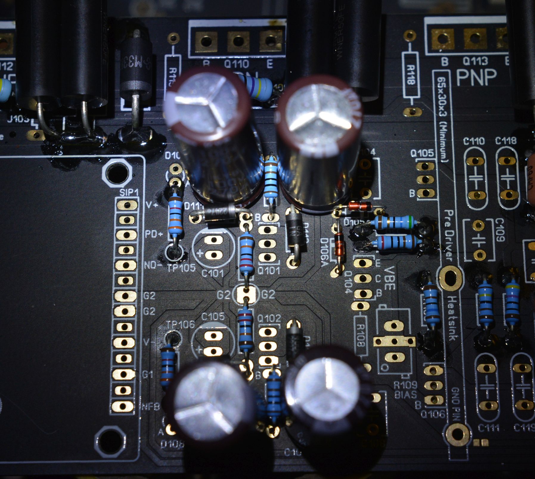

hi, i have a question about placing resistors and diodes around C102-3, C106-7 caps
i have a lot of 270uF 12.5mm dia caps for that positions, but if i'll use them, there is not enough space for R101/4, D111/112, D113/114, D105a/106a and maybe R102/103. I plan to mount those elements at the bottom side of the board.
Board will be mounted perpendicular to the heatsink. boards ef3-3 and ef3-4
are there any caveats that should taken into account?

my question is more towards lack of space between components
resistors and diodes are touching capacitors
placing them at the bottom side would partially fix this. but BOM shows different components values depending on mounting style (parallel vs perpendicular) and this might be connected with how air cools components (my assumption)
so don't know how different placement might impact my build 🙂
