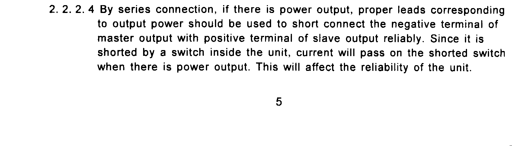

^ I don't disagree. I admit that I saw the photo with the "series" configuration buttons pressed and your proposed wiring, and I reacted too quickly without noticing your careful addition of "independent" in the text.
If it's better to remove the posts and following conversation after, I'm totally fine with that. I have no issues with admitting / owning an error. Cheers.
And even now you still don't understand why that message of you was so wrong. RTFM you said. Yes let's just do that, practice what you preach. Read The ******* Manual. I give you a pointer to the most relevant part below.
Note that on this unit the master is at RHS as pointed out in the manual page 2 - 4.

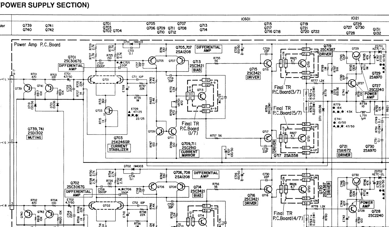

I studied the Luxman's -
most are a deluxe version of the Hitachi topology (below 1). The input stage is the typical Wolverine fair ,
the VAS is different (differential w/ current mirror) . Compensation is lead - lag + VAS miller (C707,711,717,719).
Close in THD to Wolverine - without the EF3 !
"Typical Luxman" is similar to the "Symasym".

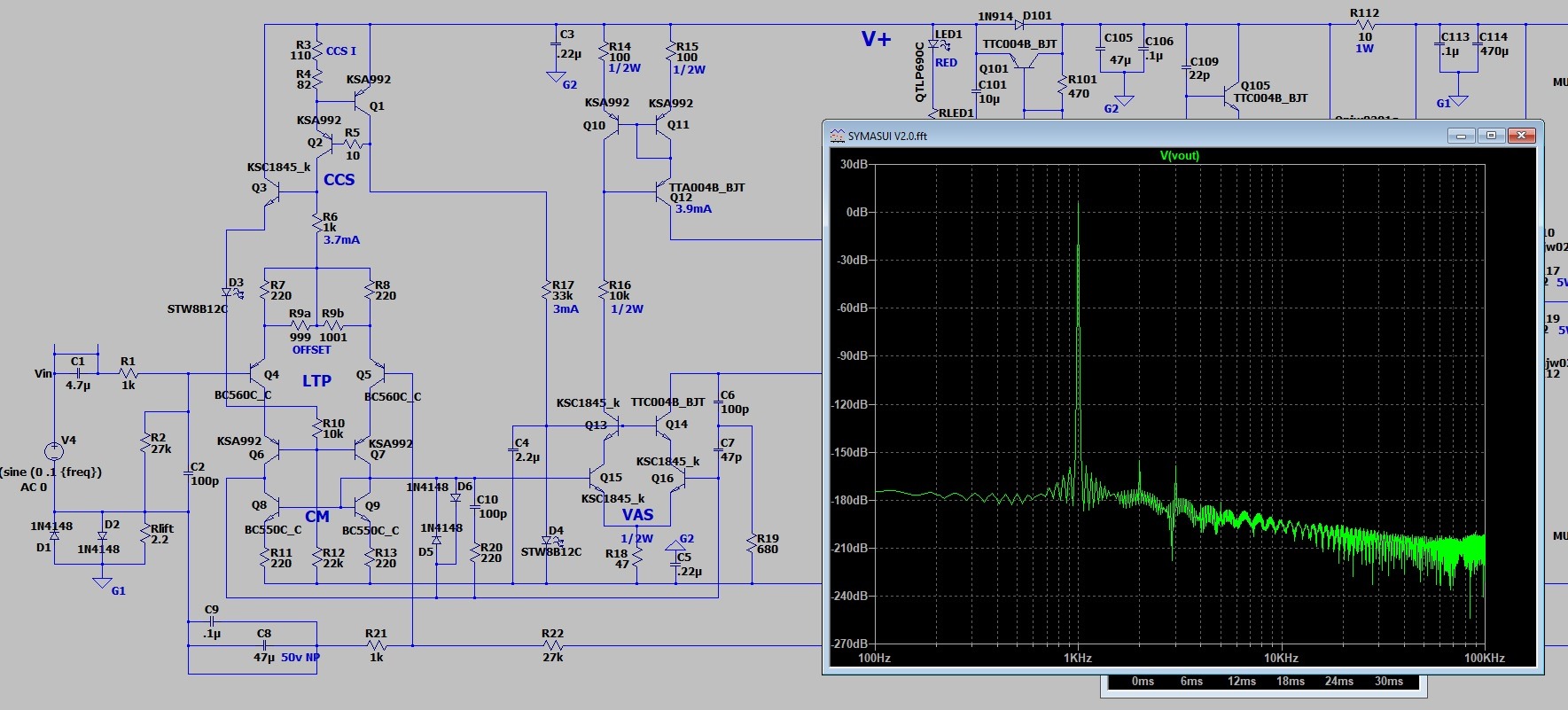

(below 2) is a deluxe LUX .... .1PPM ! Add a Widlar mirror and the Wolverine input stage = lower than the Wolverine ! ZERO distortion.
Almost 15dB more gain margin at 20Khz without oscillation. The only circuit that can beat the Wolverine I know of.
Luxman does not need to be class A with that advanced feedforward 2 pole setup.

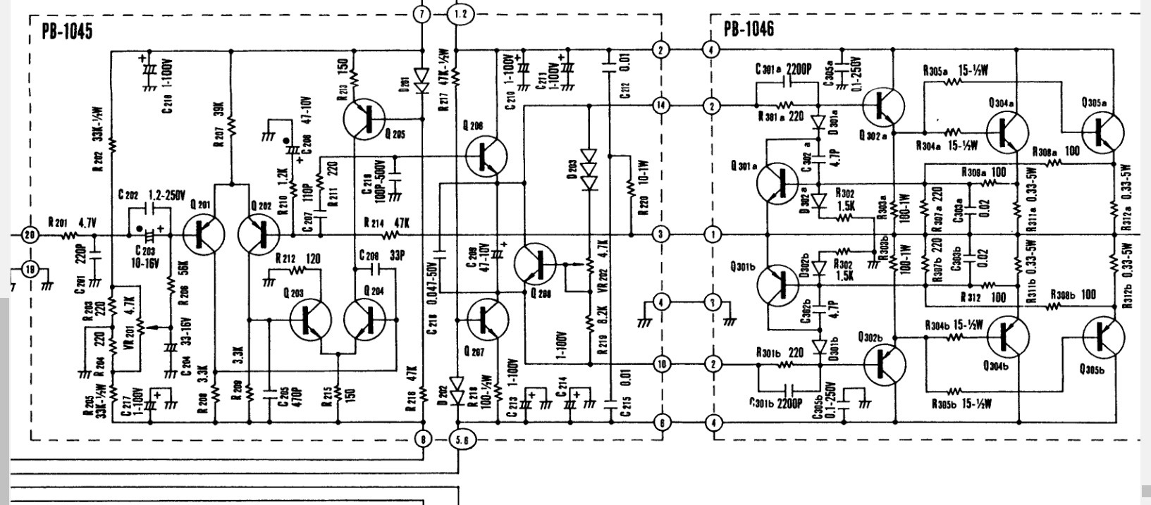

(BELOW) ye olde (1973) M2000 amp. LUX Cult following - same as a sonance 260 -20 years later.
I've run this on the Wolverine OPS , People forget ..... the Wolverine can run ANY input stage!
OS

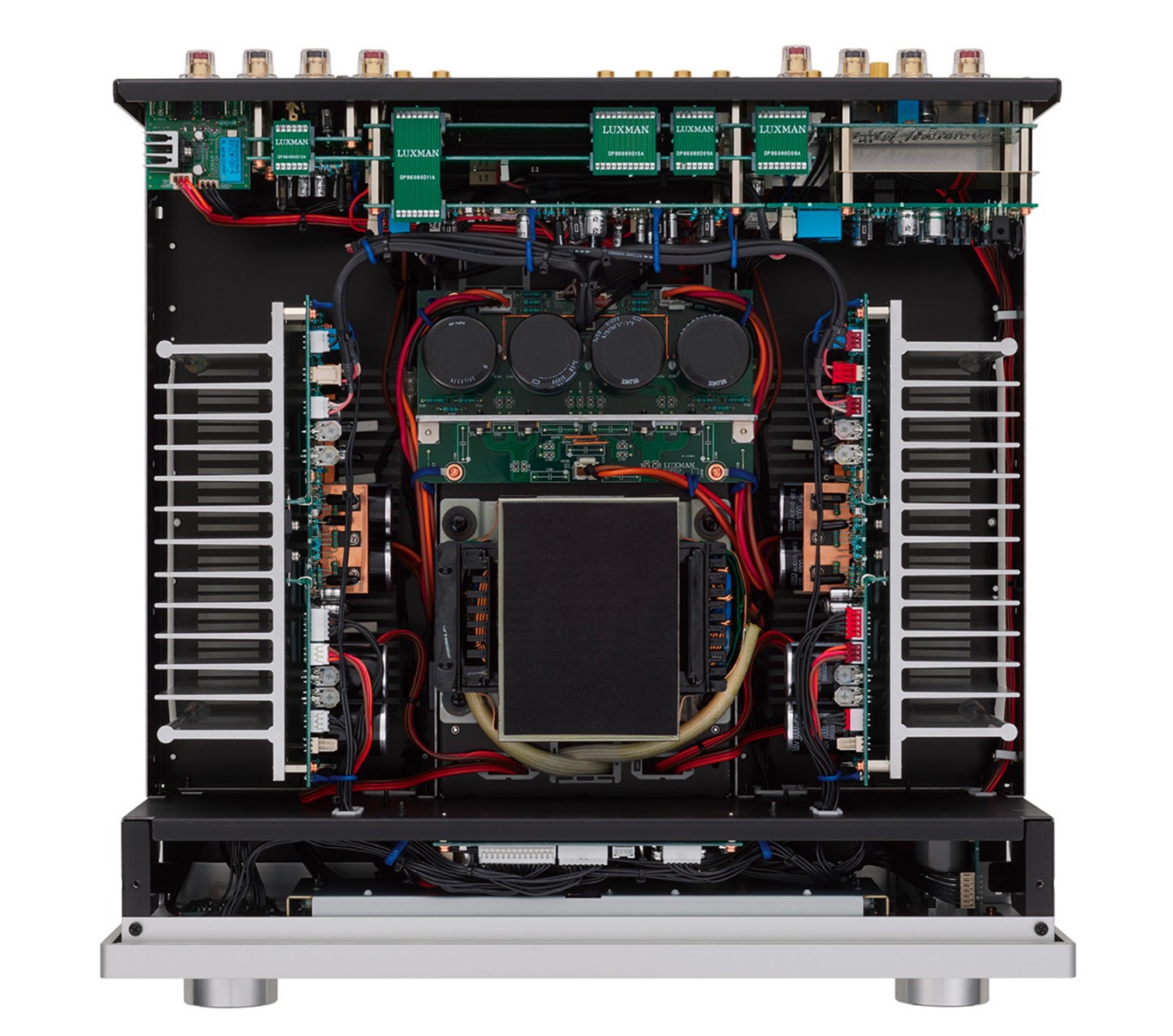

The LUX 505/507-9 looks exactly like a typical Wolverine build - 6000$ perfect amp.
EF3 with 3-4 pair Sanken outputs. Most of these elite units are <.001% THD.
Similar circuit and construction to a Wolverine.
One could fetch $2-5K for a well built Wolverine. I only spent 250$ with spare parts for my
Wolverine to get a 2K$ amp. People underestimate the value of this DIY offering.
Stuart's monoblocks are easily worth 3-4K each !!! Yikes....

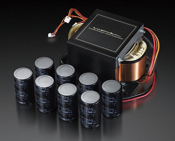

Can't forget the HAND WOUND (by a Japanese craftsman) 600VA trafo - (below 2)
Caps are custom (samwah - korea) 10Kuf 71V beauties !

aren't there errors in here? for example, looks like no DC bias applied at Q206 base!
