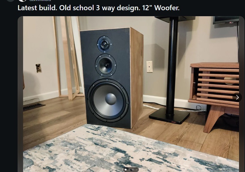

I have the drivers , 10" 250W woofers ... 5" ferrofluid mid , dome tweeters. DIY speakers for my DIY amp.

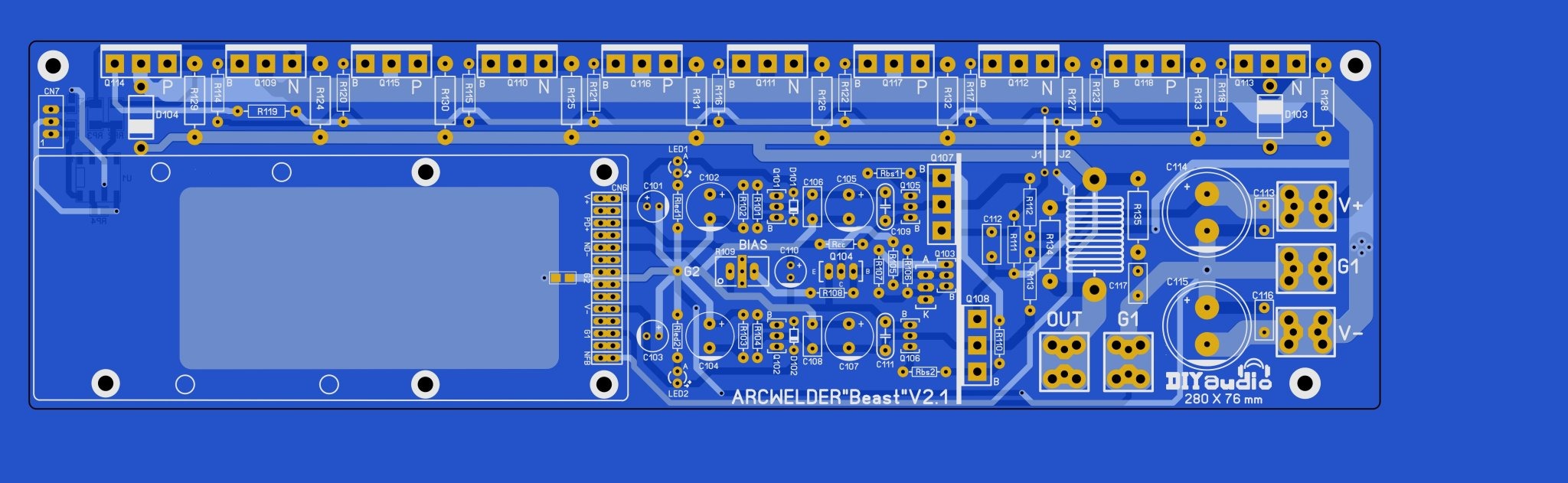

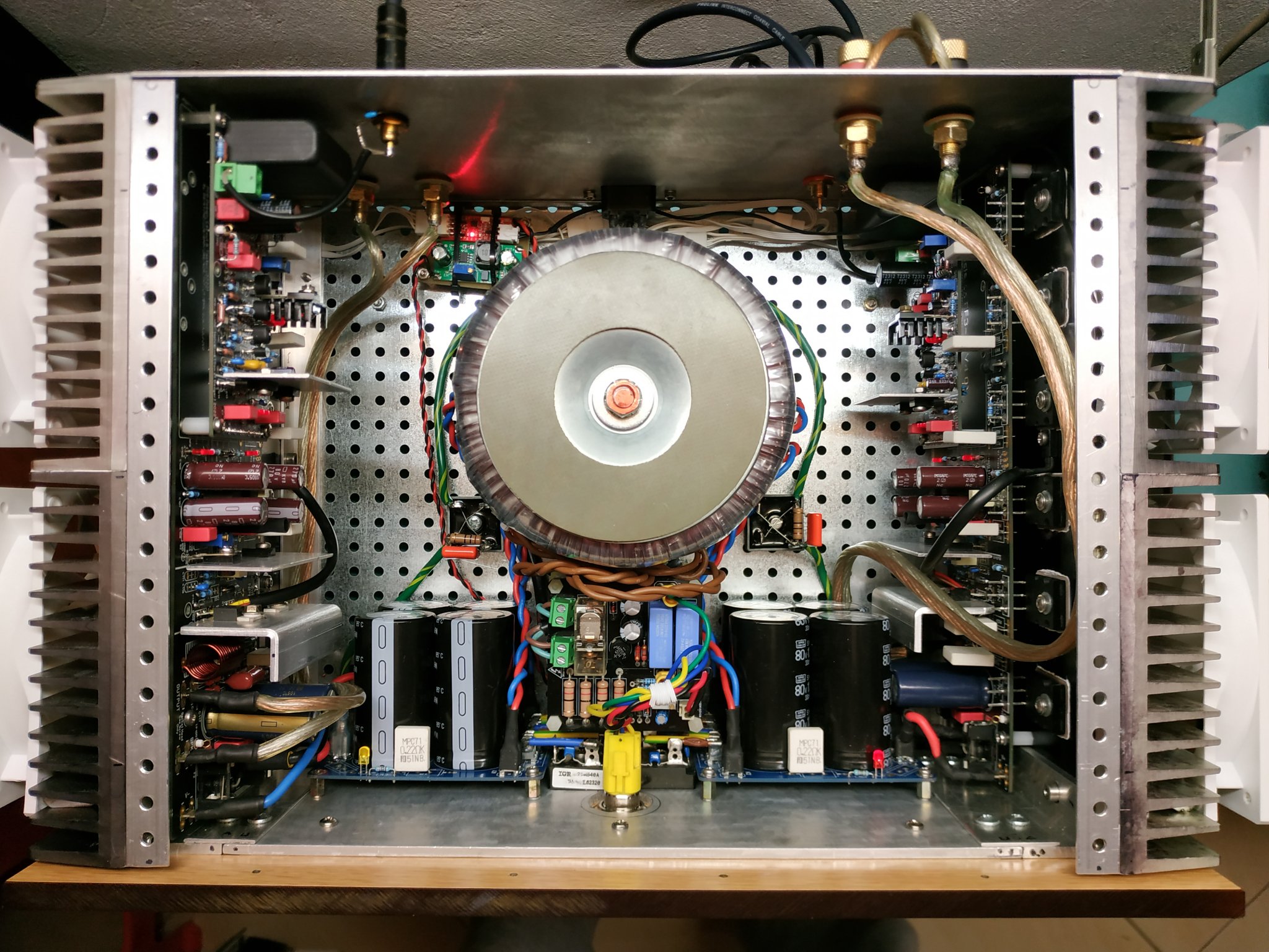

very nice 😍 ST hey you don't mind if I show this on my YouTube channel this is certainly a nice motivation 😊 I still on this design trying to improve my PCB layout design skills and is also a nice mental exercise too 😁Finally finished one of the Wolverine monoblocks. Now just the wiring to go on the second.
Sure go ahead. Please post a link here to your video once it's done.very nice 😍 ST hey you don't mind if I show this on my YouTube channel this is certainly a nice motivation 😊 I still on this design trying to improve my PCB layout design skills and is also a nice mental exercise too 😁
You would still have to be careful , you need something like ferrofluid cooled "party speakers". Acoustic suspension 500W woofer....I'd love to try a stereo pair on the Klipsch Jubilee
Wolverine begs for 75mm voice coil - 8KG magnet monsters.
OS

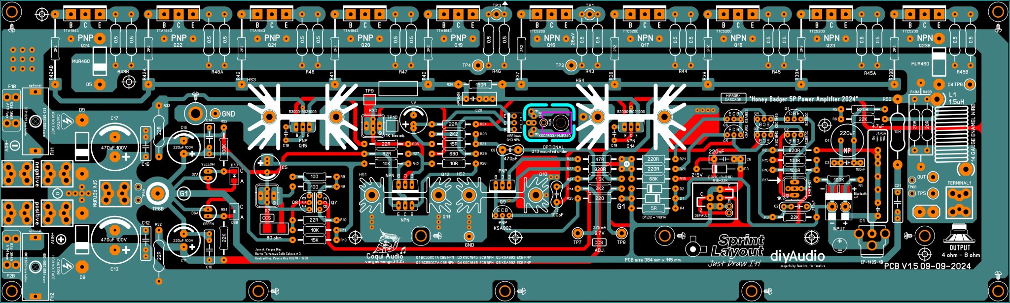

Your design would have current loop area issues. The original design with the IPS/VAS where it is makes for the PPM performance.I still on this design trying to improve my PCB layout design skills
As well as the P/N/P/N (everything cancels). For a non modular board , just integrate whatever input stage - permanent (in the blank spot).

sorry Pete by mistake I use the report I wrote a positive comment and I forgot to "Quote" 🤣 yes I agree but it does look cool right? 😄Your design would have current loop area issues. The original design with the IPS/VAS where it is makes for the PPM performance.
It would work (the "pretty" PCB), but remember the tests that showed even the slight routing change of NFB killed the THD.
A long power loop would do even worse. I IS pretty , Vargas !

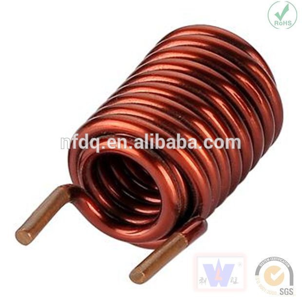

I 'm curious why the Wolverine output inductor is not the cancelling type. What I mean is one wound layer with a outer wound layer
in reverse. Full cancellation of EMF. My little Sonance 260 amp actually has this , even as they did not take NFB from the center of the EF2.
(I fixed that).

I reverse engineered it. Up or sideways don't matter if the coil is self cancelling. Most OEM's don't have coils like this , just ones that are
designed for loads (under 3R).

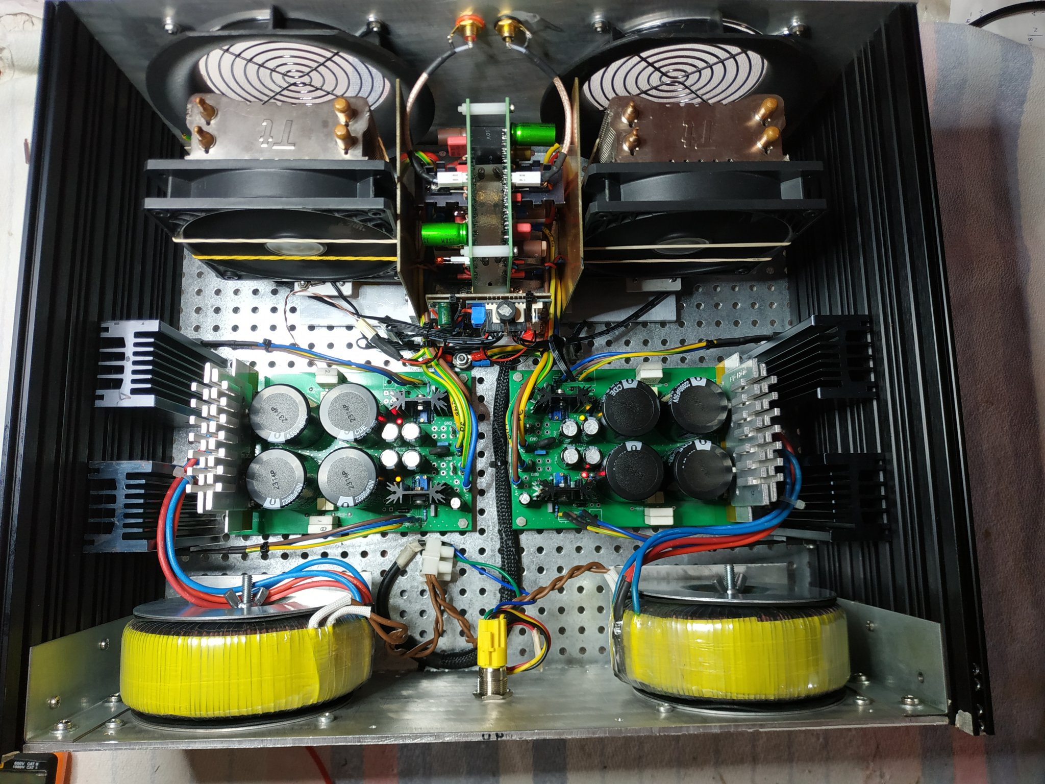

I decided to deal with the small problem I had in my amplifier Wolverine 3ΕF at 57-59V here and two years since I believed that the smaller heatsinks with dimensions 27cm x 16cm x 5 cm I had were my issue and as many times I mentioned it, I didn't have any technical instructions.....(small complaint) ..
However, it wasn't the relatively small heatsinks that were wrong...I changed the position of the transistor from the heatsink to one of the output transistors....Νοw the bias reaches 45-47mv at 38 C degrees in the heatsink and when it reaches 40-45 C it decreases and stays at 40-41mv......
This is for the friends who have a similar topic.
Ηowever, it is a very strong neutral amplifier which, when warmed up, performs qualitatively better.....

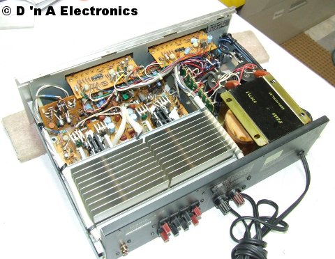

That one is interesting , using big CPU vapor phase change (heatpipe) heatsinks to cool the outputs.Since after finishing my last amplifier Alpha Nirvana 39/4R with great success in terms of the result in sound quality.
Luxman is only OEM i've seen that in.
Nice layout on that wolverine 3-pair OPS !!
OS
Hi OS,
Marantz and a few others used vapour phase heat sinks. The Lux M-02 is one example. The odd service guy blew products up since "standard service position" was the unit on it's side. Those heat sinks must be level to work properly.
I don't like these heatsinks. In practice, the fin to pipe connection is poor, and the fins are not thick enough to be effective. They were less expensive and lighter than standard heat sinks. These were abandoned later. I think another reason they were used was to make slim case as was the style in the early 1980's.
