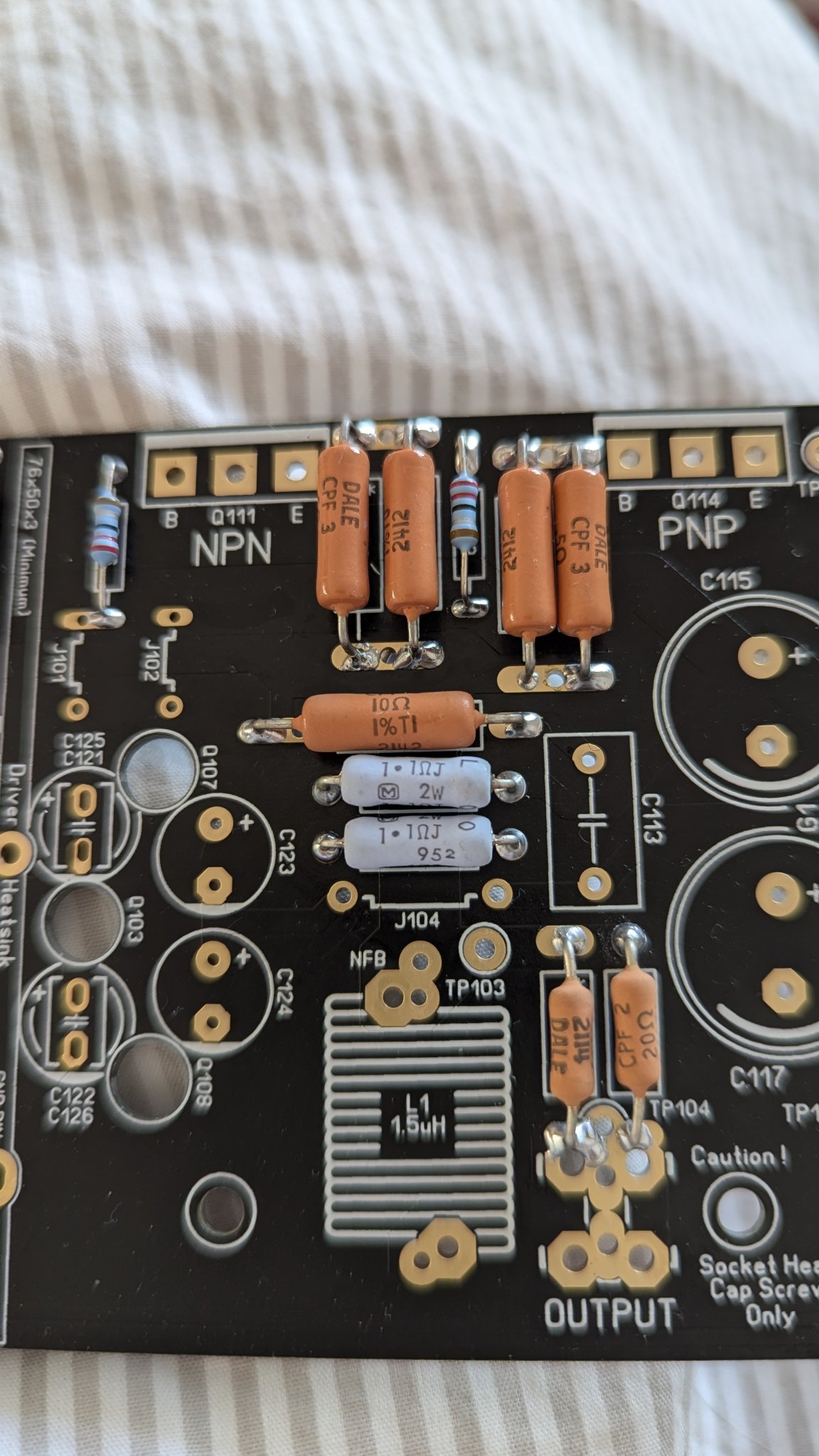

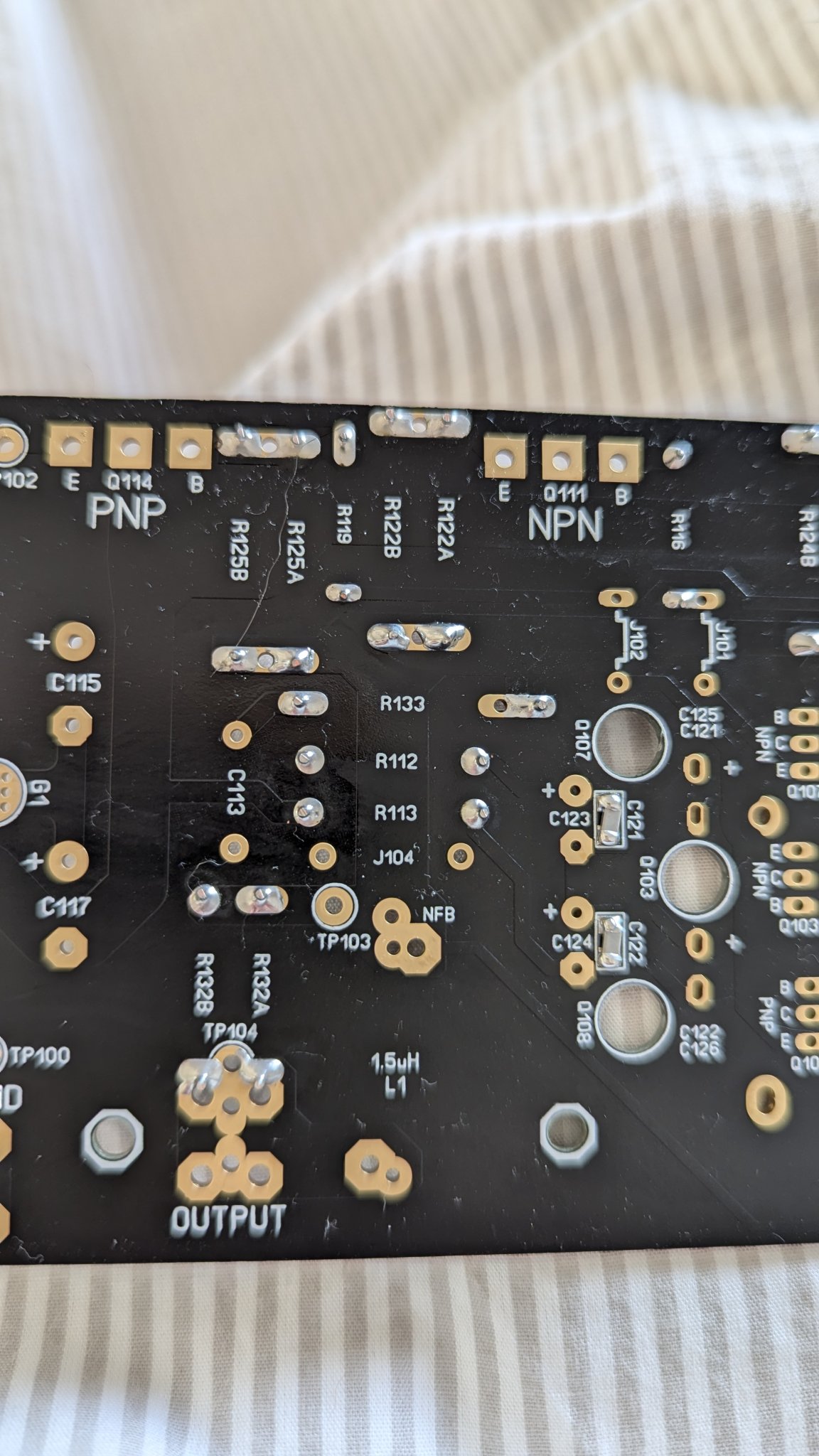

Where is R133? I cannot find it anywhere, neither on schematics nor in parts list.Hi @mainframe99
Thanks very much for your reply. I'd figured the asterisk was probably just because the R133, R112 and R113 were higher wattage resistors, and had soldered them with an appropriate gap under them. I have done this for all the resistors >1/4W. There are quite a number more than those 3 though, and they don't have an asterisk on the PCB and that's what confused me. Thought I may be missing something.
I have watched all Daniels videos multiple times, but there are still some conflicts I haven't resolved. Thanks anyway though.
Hi @janusz it's only on the EF3-4 board I think. Above the inductor coil is J104, R133, R112 and R133. The Dale resistor in my photo of my part-built board. The EF3-3 has 133A and 133B inWhere is R133? I cannot find it anywhere, neither on schematics nor in parts list

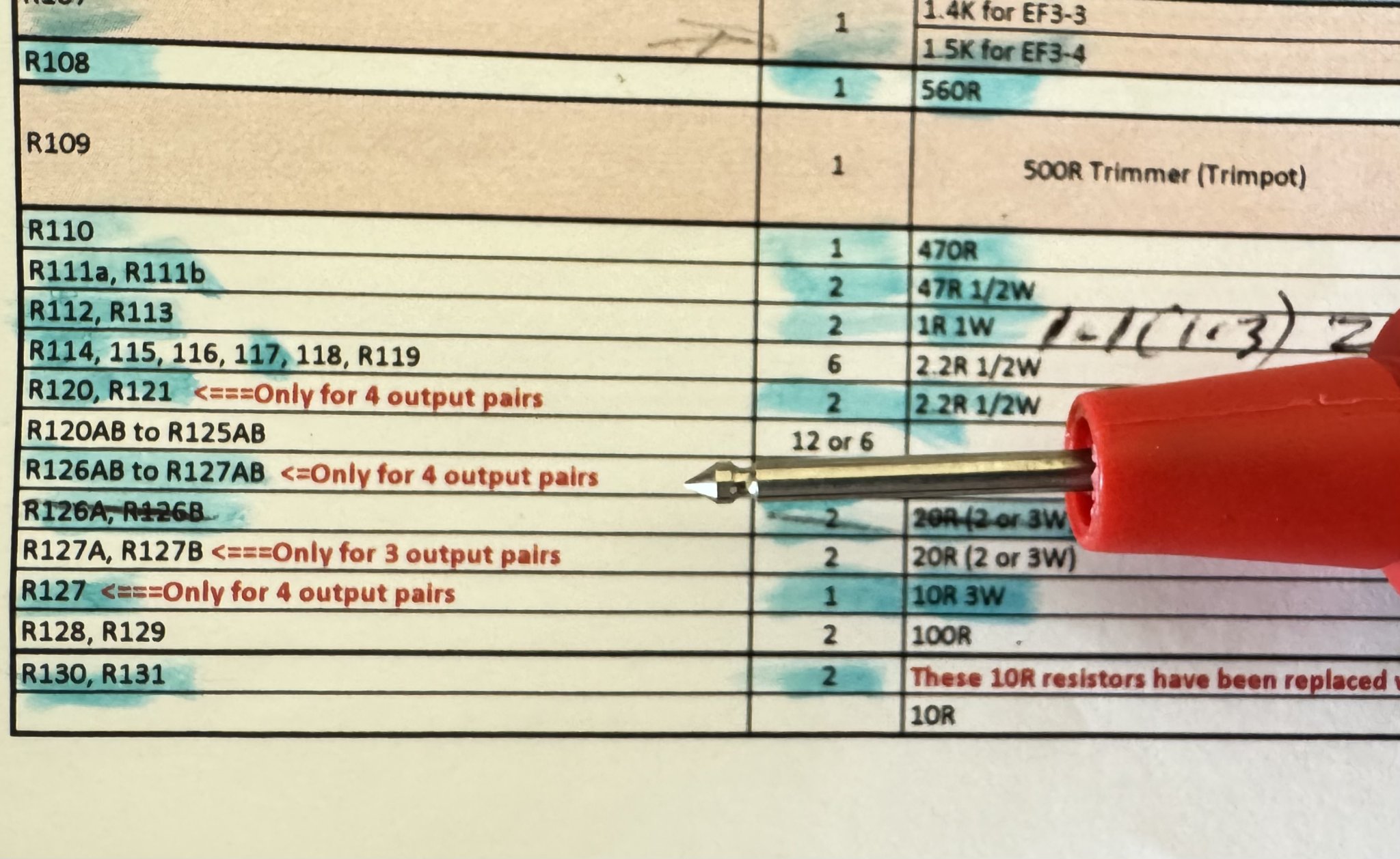

Hi Folks,
I need help with the note on the B.O.M. for R127A and R127B. I have the EF-3-4 (V4.0) boards. The note indicates these resistors are only used for 3 output pairs. I'm using 4 output pairs. The place for those resistors is clearly marked next to Q116. If you are using 4 outputs pairs, do you install these resistors?
Many thanks,
John
Many thanks,
John
The BOM lists different values for EF3-3 and EF3-4 for these components. The build guide lists the EF3-4 ones as #127A/B and the EF3-3 as *127A and *127B indicating those values are only for the EF3-3 boards. In the BOM they are listed as “R126AB to R127AB” as the components in these locations have the same values. At least that’s my understanding…The place for those resistors is clearly marked next to Q116. If you are using 4 outputs pairs, do you install these resistors?
Thanks Stepping3D! 127A/B is 127A and 127B. The values are different depending upon how many pairs of output transistors you are running. Thanks again.

Thank you, now I know where R133 is on your board. You must have a new version of E3-4 board. Mine is v3.9 and it has R127 where you have R133. Judging by the resistor numbers new EF3-4 board versions must have a few resistors added.Hi @janusz it's only on the EF3-4 board I think. Above the inductor coil is J104, R133, R112 and R133. The Dale resistor in my photo of my part-built board. The EF3-3 has 133A and 133B inView attachment 1350811View attachment 1350812stead on the BOM

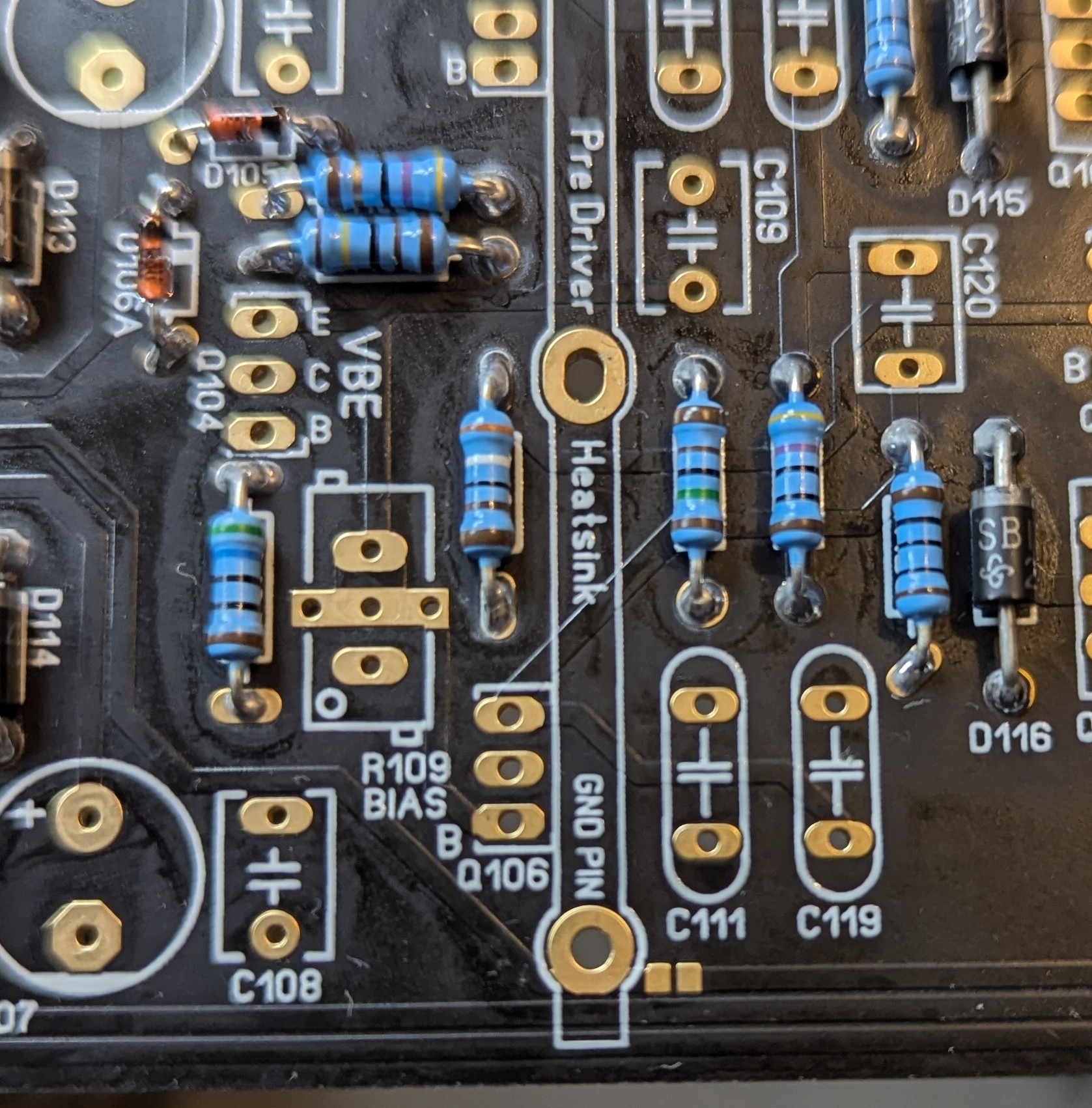

Hi all, I have a query re EF3-4 (V4.2) board. Next to the GND PIN of the predriver heatsink is what looks like a solder bridge, and I can't figure whether it needs filling or not, or even if it matters? It seems to only connect to the GND PIN of the driver heatsink and that isn't being mounted anyway on this board.

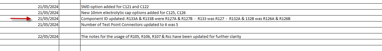

Hi Guy's
Please check the revisions listed at the bottom of the BOM.
Some ID were updated to provide further clarity.
Please also ensure you are using the correct BOM for the boards that you have to avoid further confusion.
Yes this jumper only needs to be soldered if you are installing the driver heatsink on the board.Hi all, I have a query re EF3-4 (V4.2) board. Next to the GND PIN of the predriver heatsink is what looks like a solder bridge, and I can't figure whether it needs filling or not, or even if it matters? It seems to only connect to the GND PIN of the driver heatsink and that isn't being mounted anyway on this board.

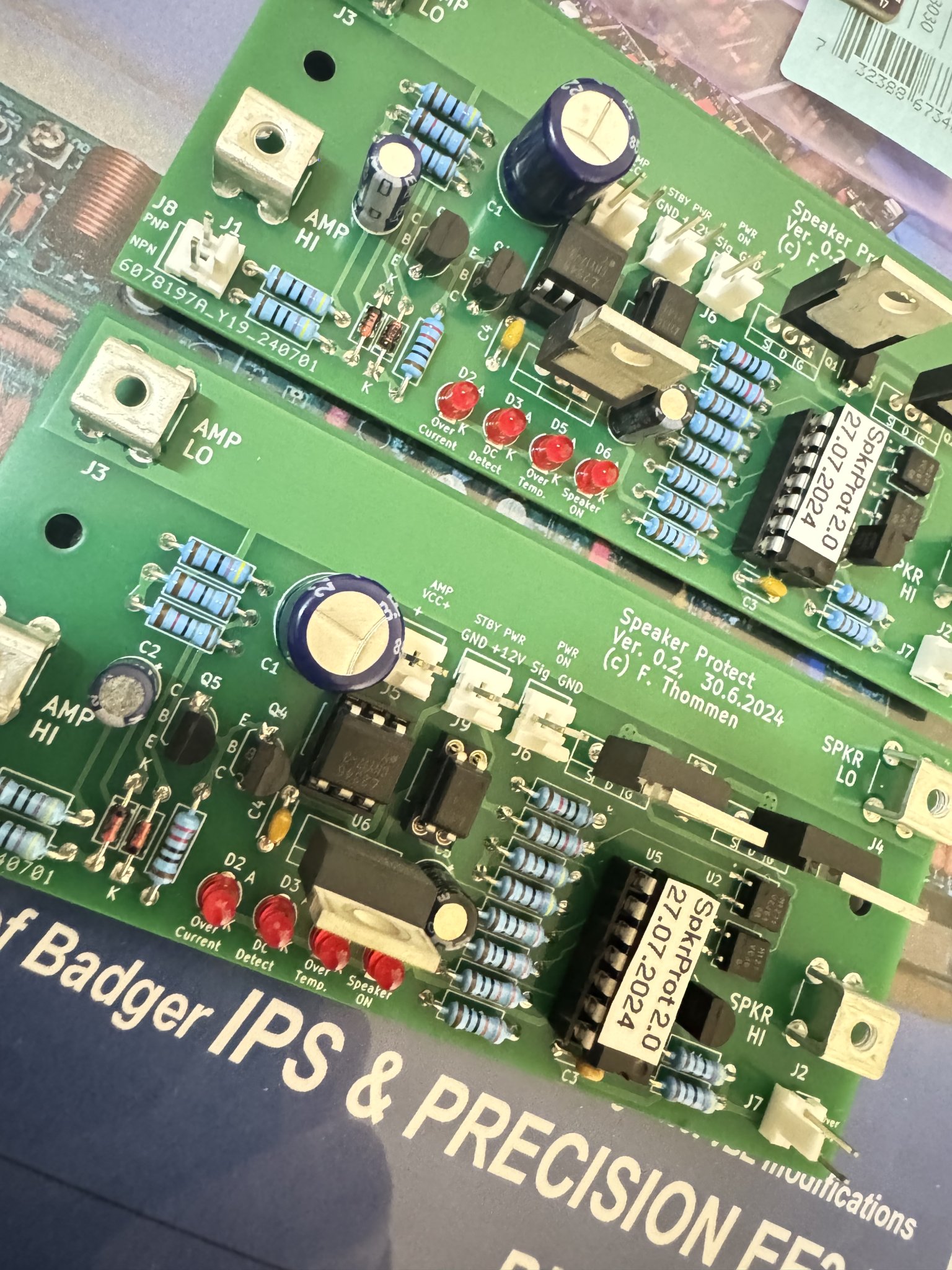

Finally finished the speaker protection boards tonight. It’s all slowly coming together. Thanks to @felix1024 for the boards and pre programmed ATtiny84. Next step… finish the rest of the soldering on the Wolverine output stage… 🙂
