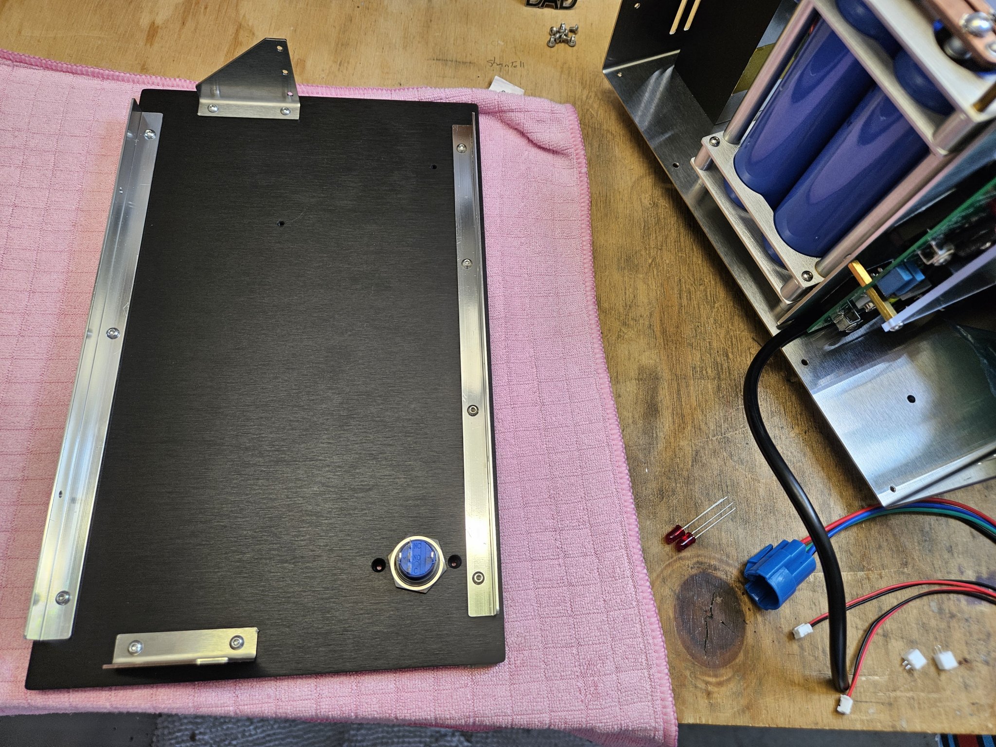

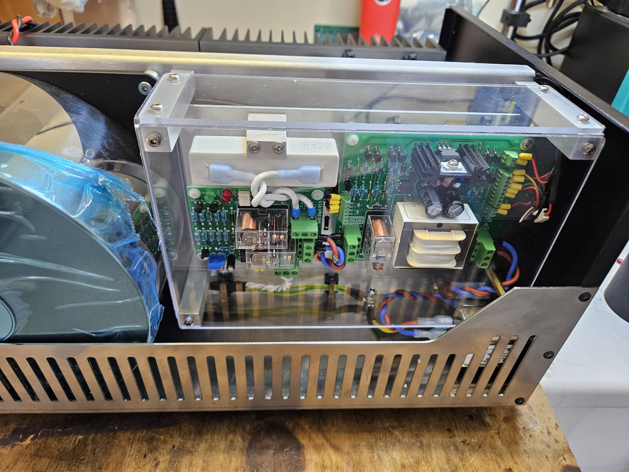

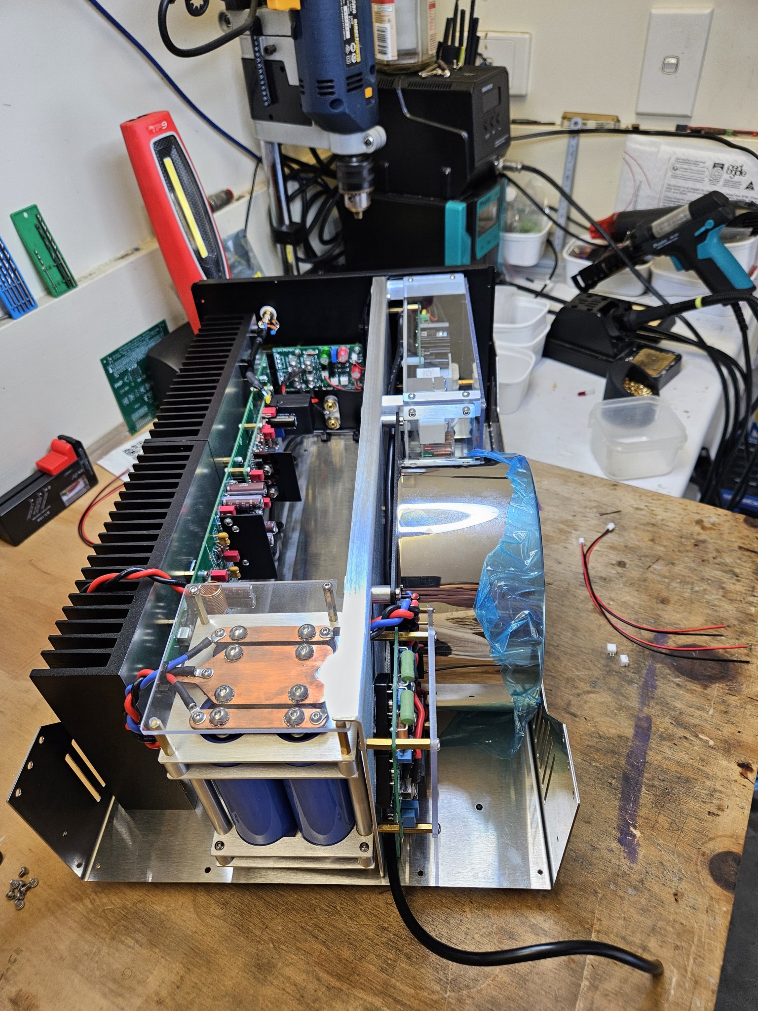

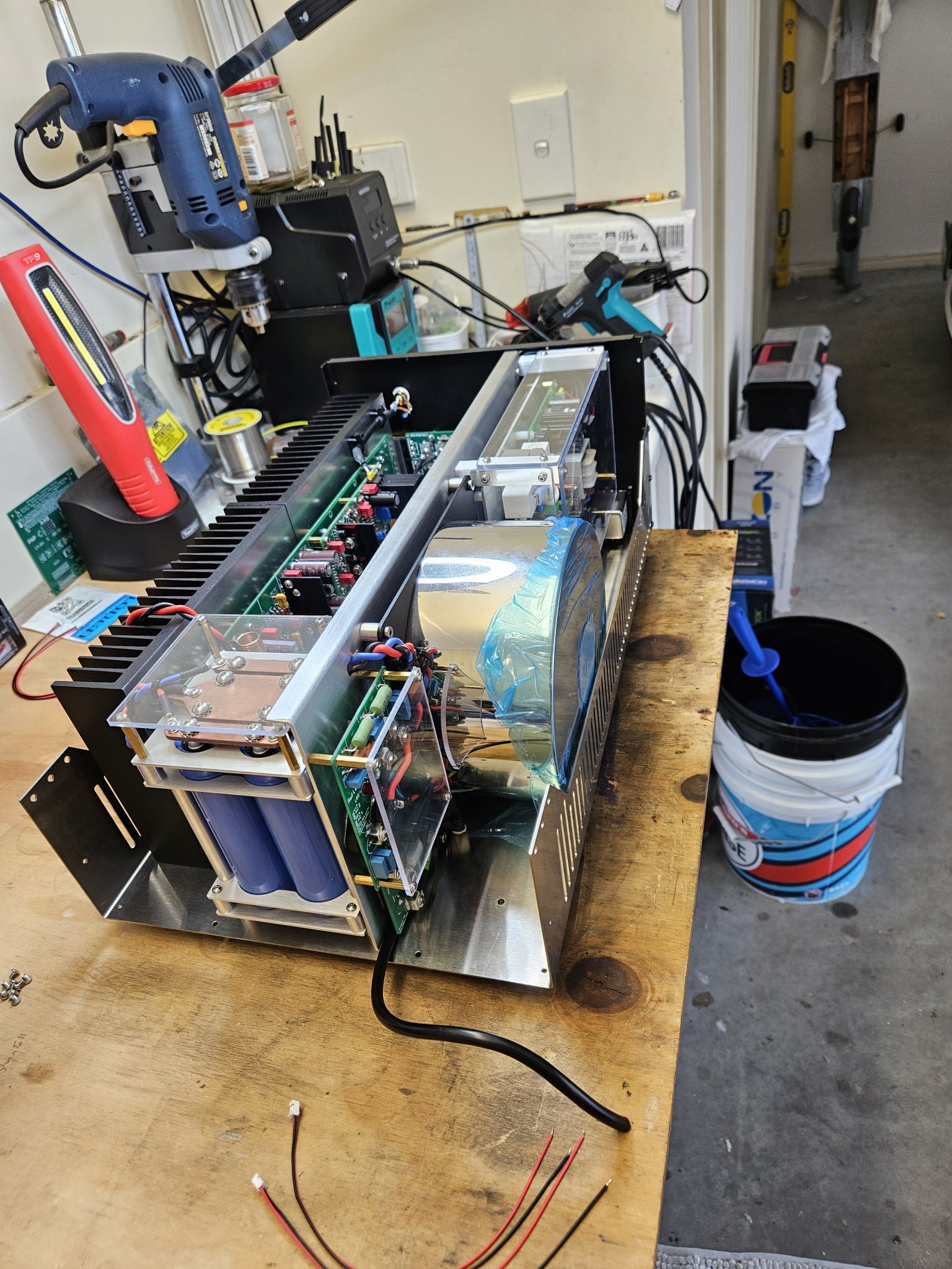

Hi Guy's,

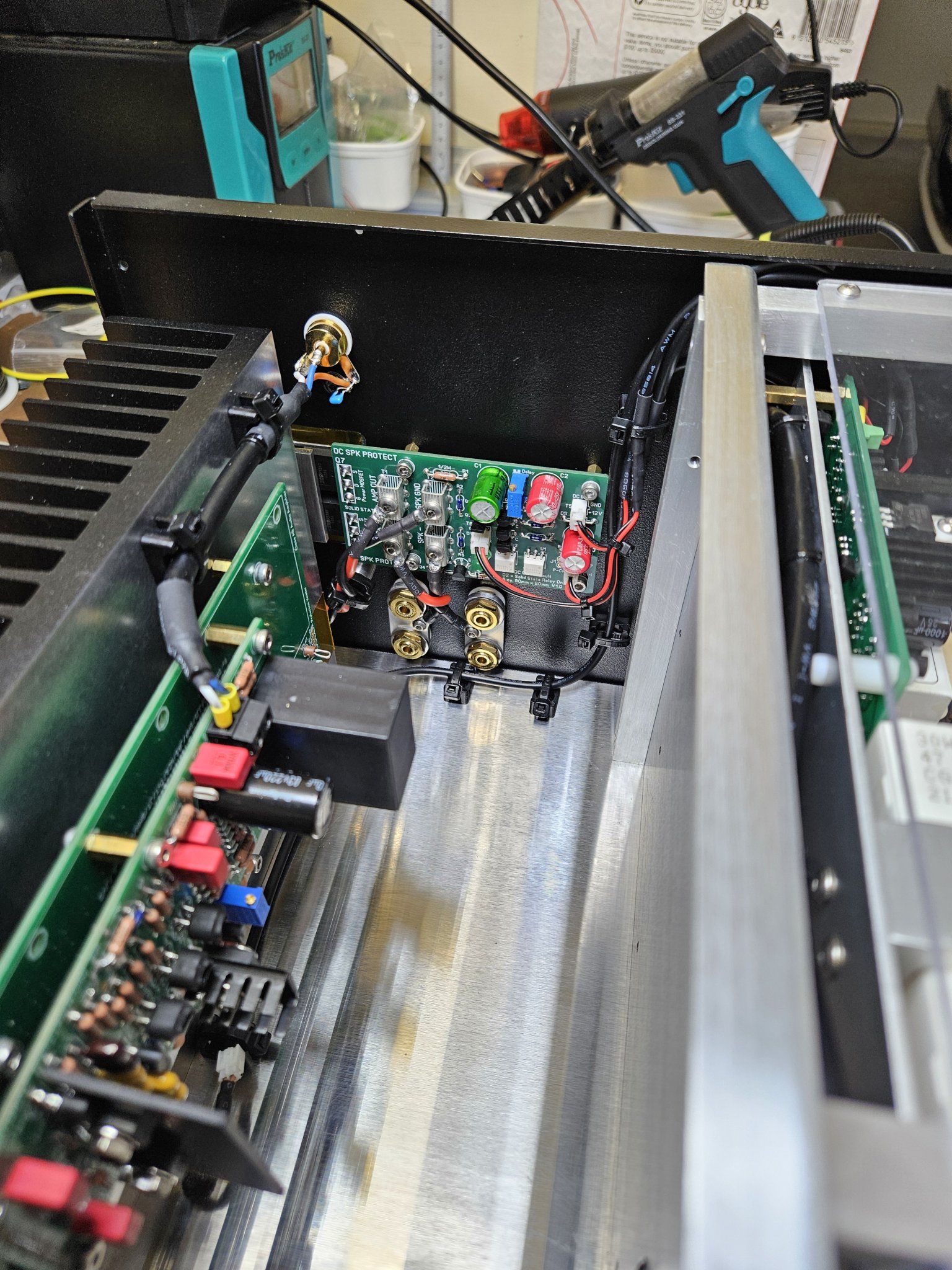

Just a quick update on my build.
I just have the wiring of the front switch, stand-by Led and DC protection board fault Led to go.
That looks amazing Stuart! I only just noticed you have a quick disconnect on the back of your front panel switch. Very cool and professional looking! Can’t wait to see it once the enclosure is on and it’s all lit up. 🙂Just a quick update on my build.
As usual your work is quite amazing! Looking forward for your finished beasts!!!Hi Guy's,

Hello,
What are some of the secondary boards you are using in your build?
Soft start and speaker protect of some sort? Which ones are you using?

What FET do you use for the SSrelay? It was hard to find non surface mount low RDSon devices ?
What schema for the protection ?
OS
OS
Use IPP076N15N5 TO-220 device less than 5mOhm Rdson. Works excellent in my Speaker Protect Circuit

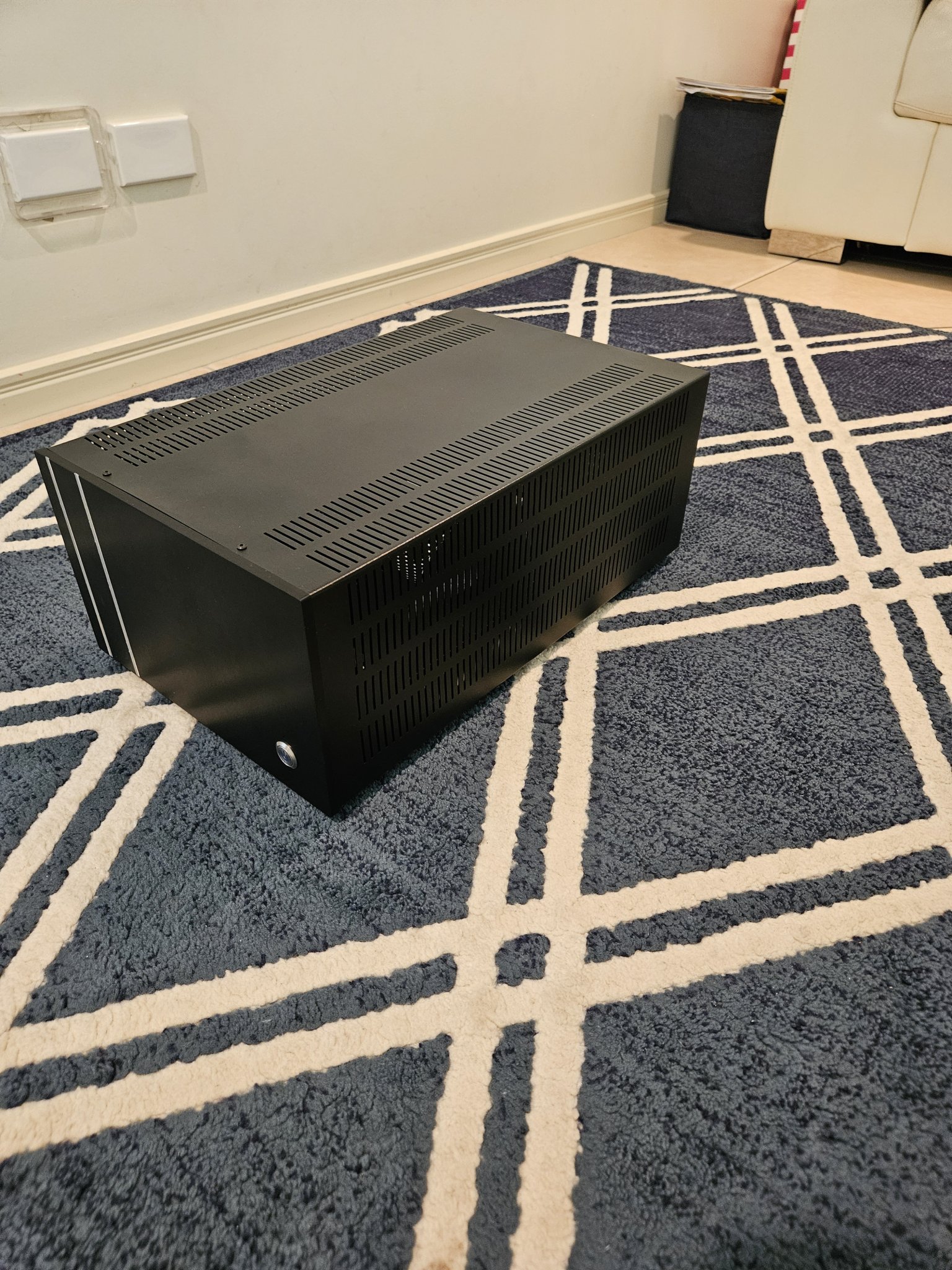

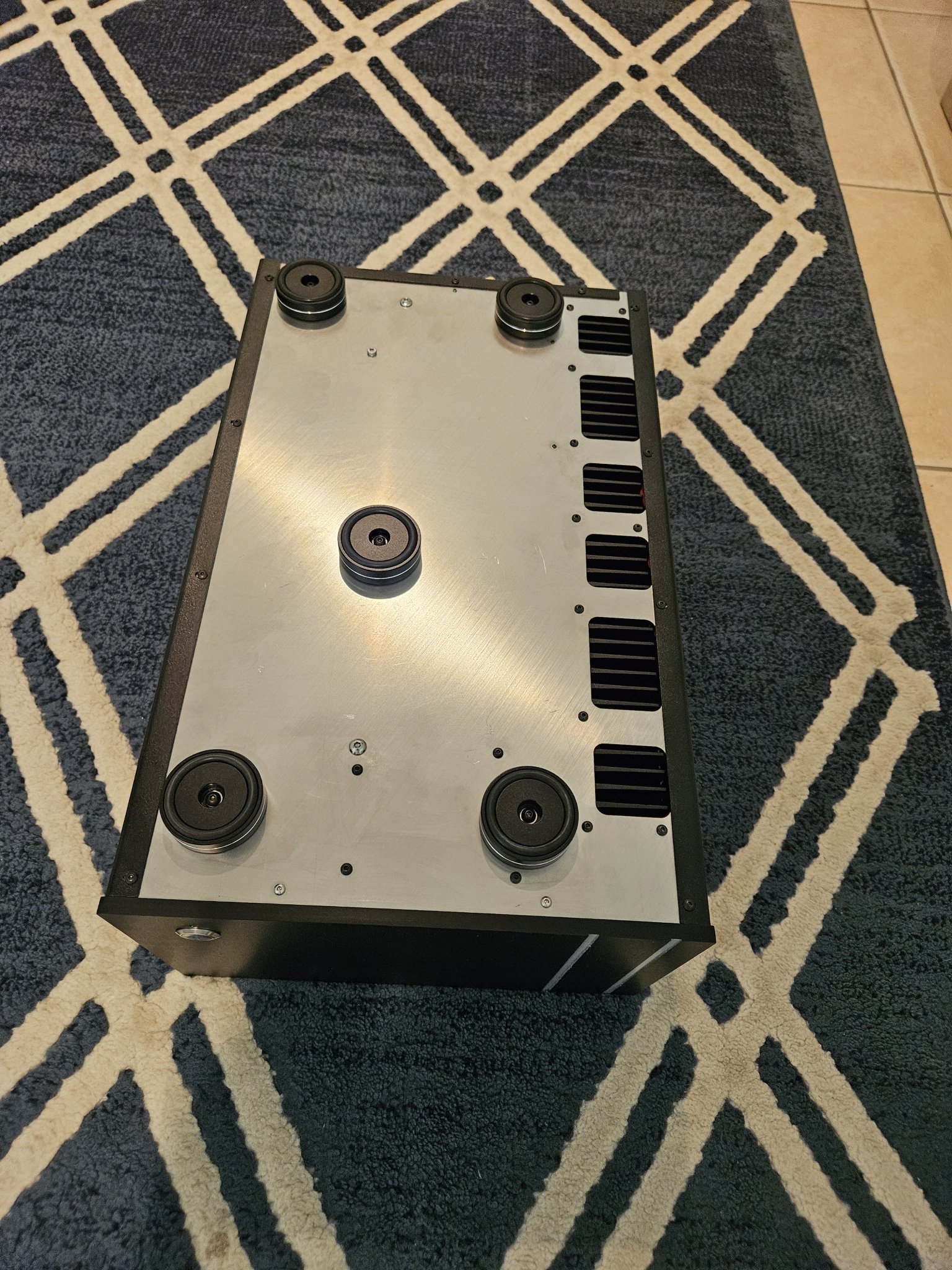

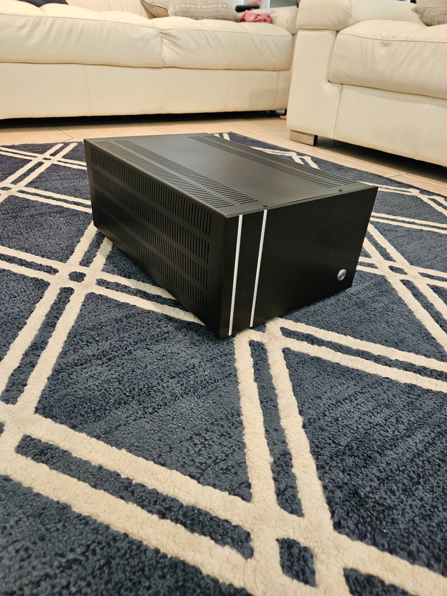

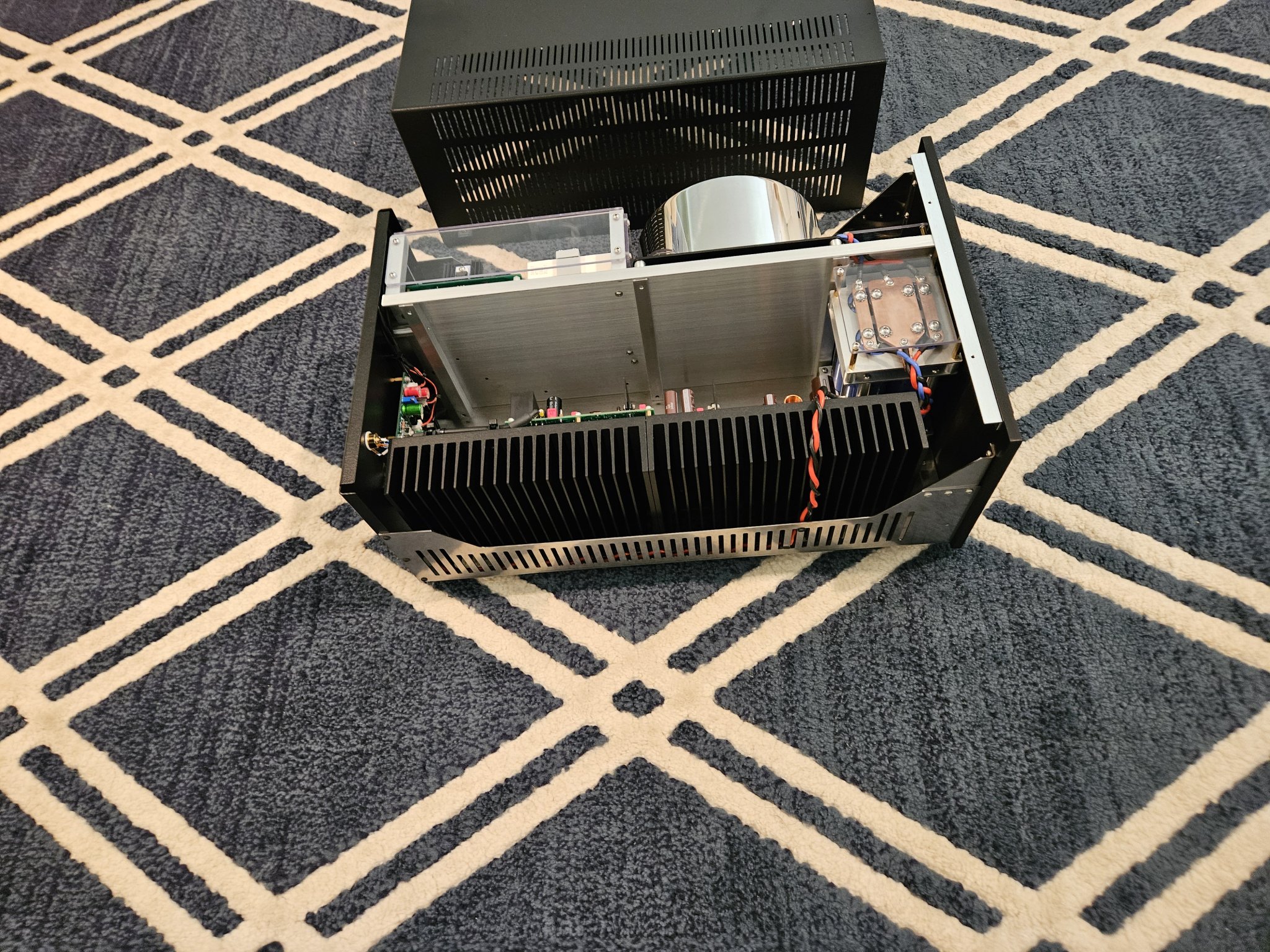

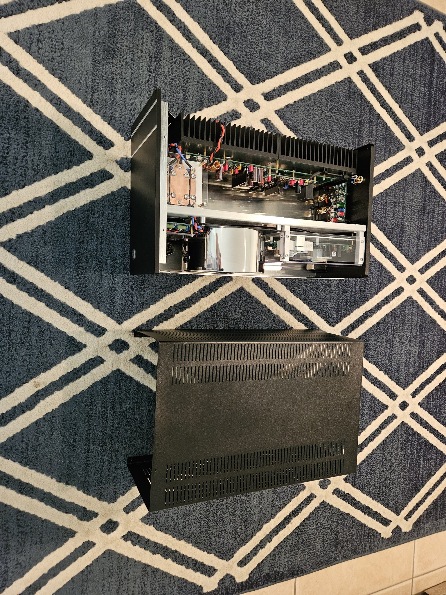

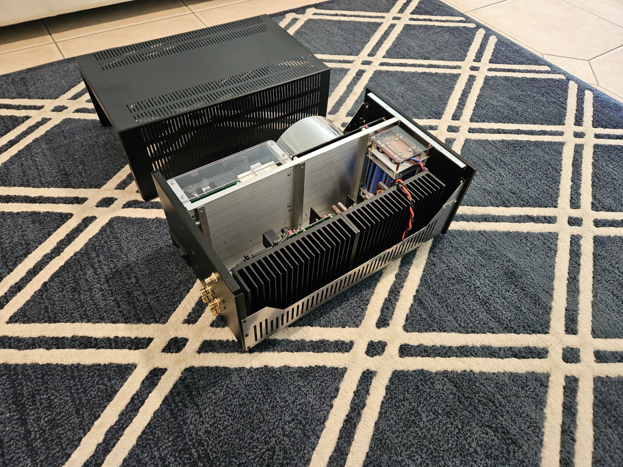

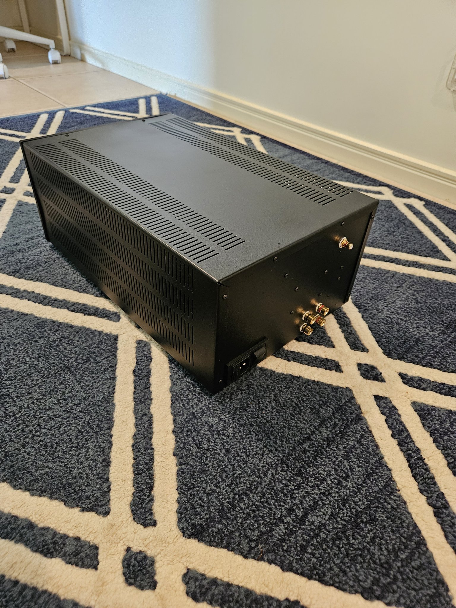

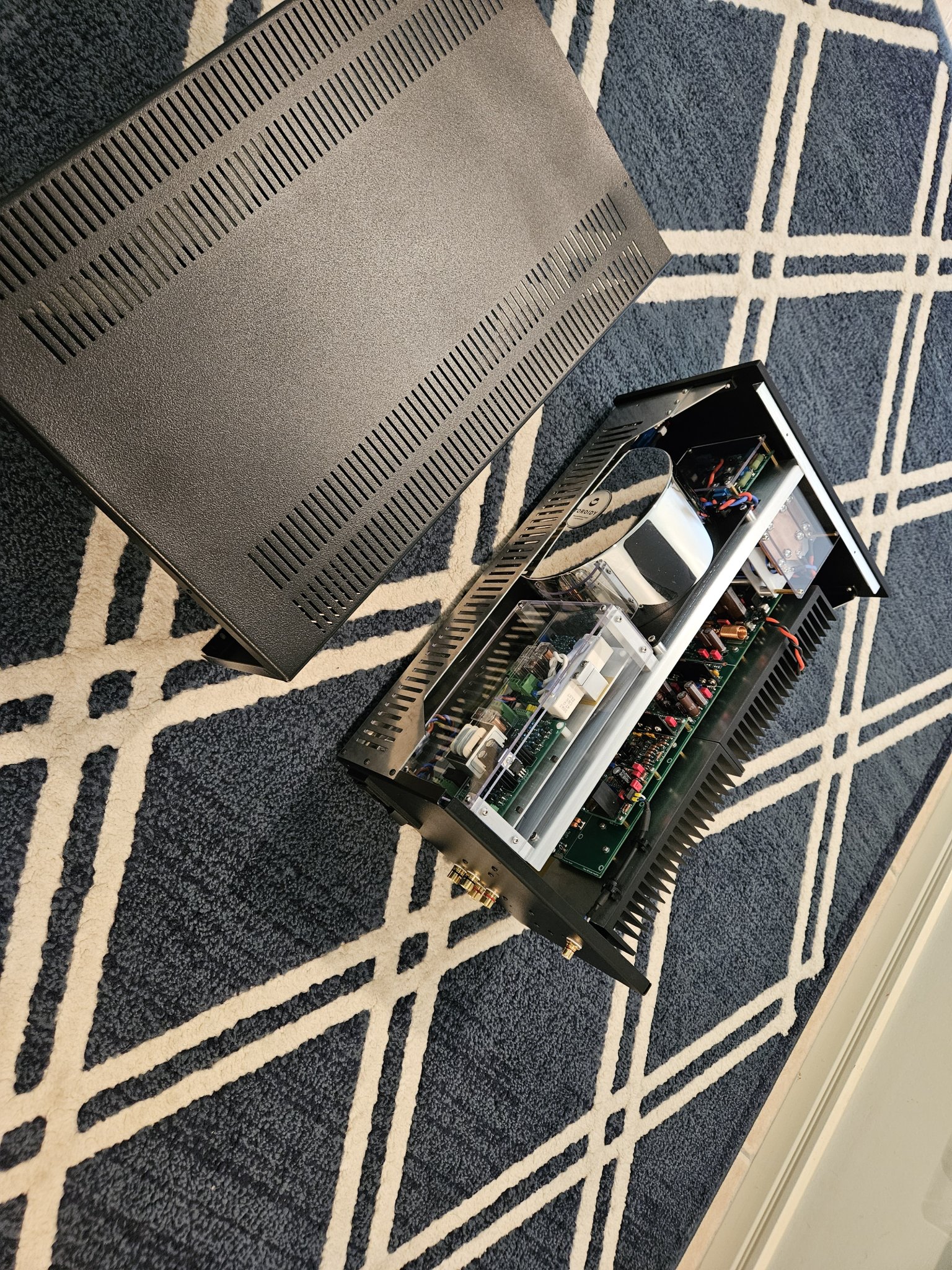

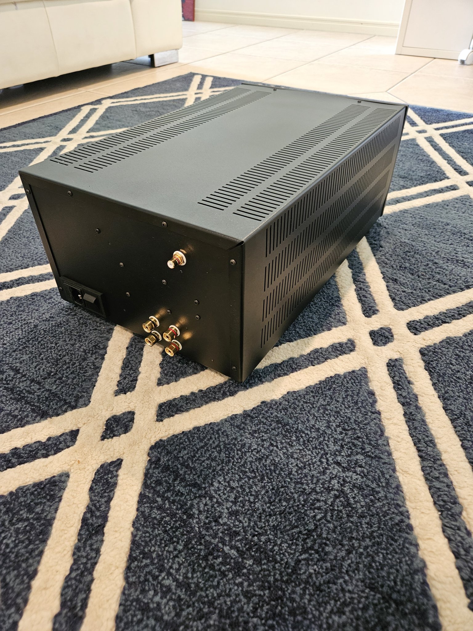

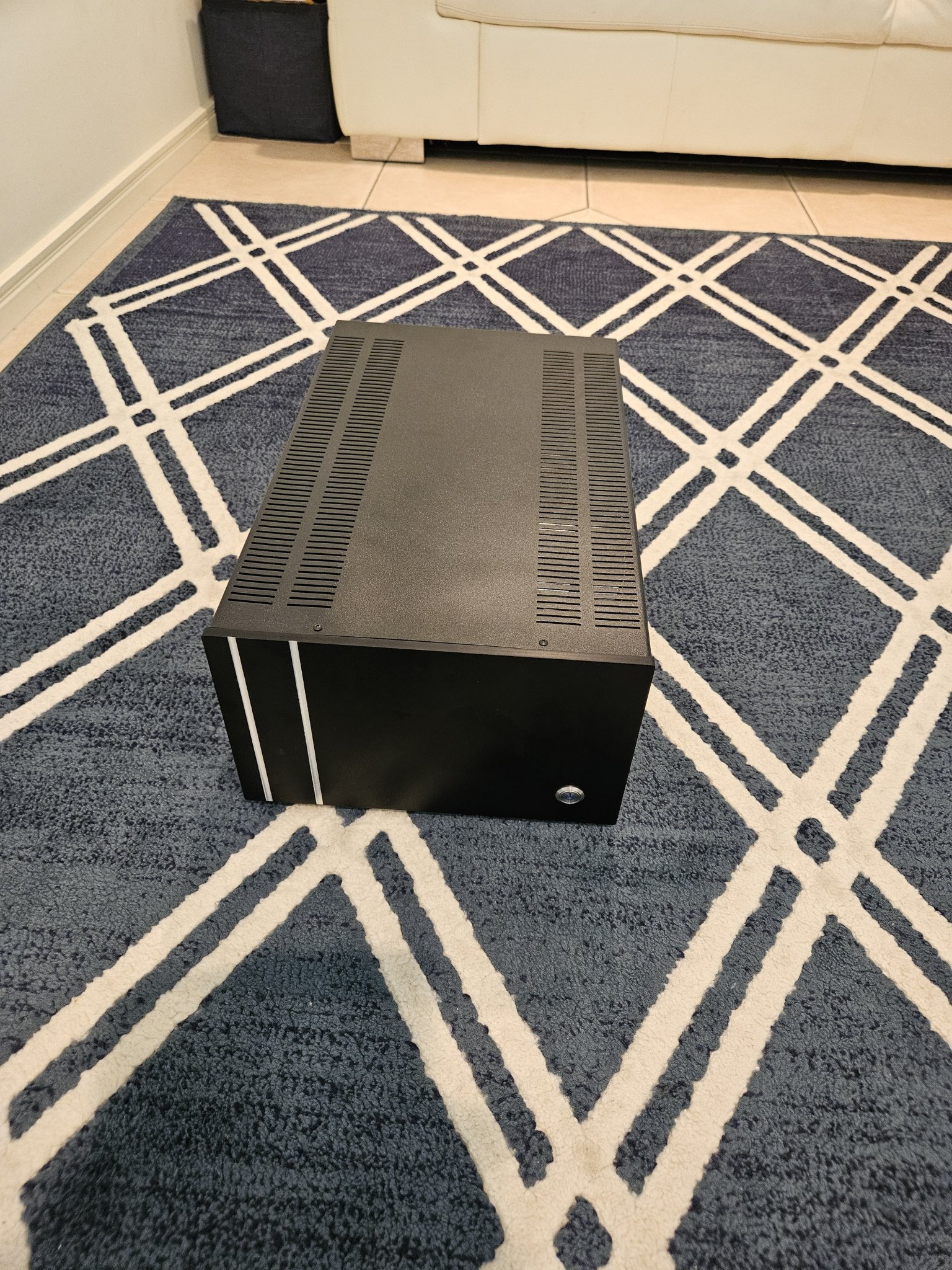

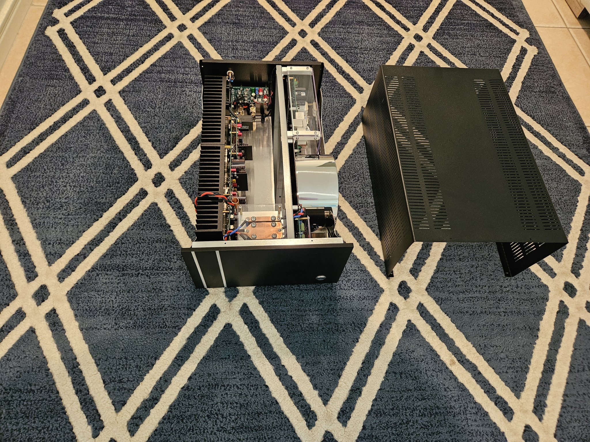

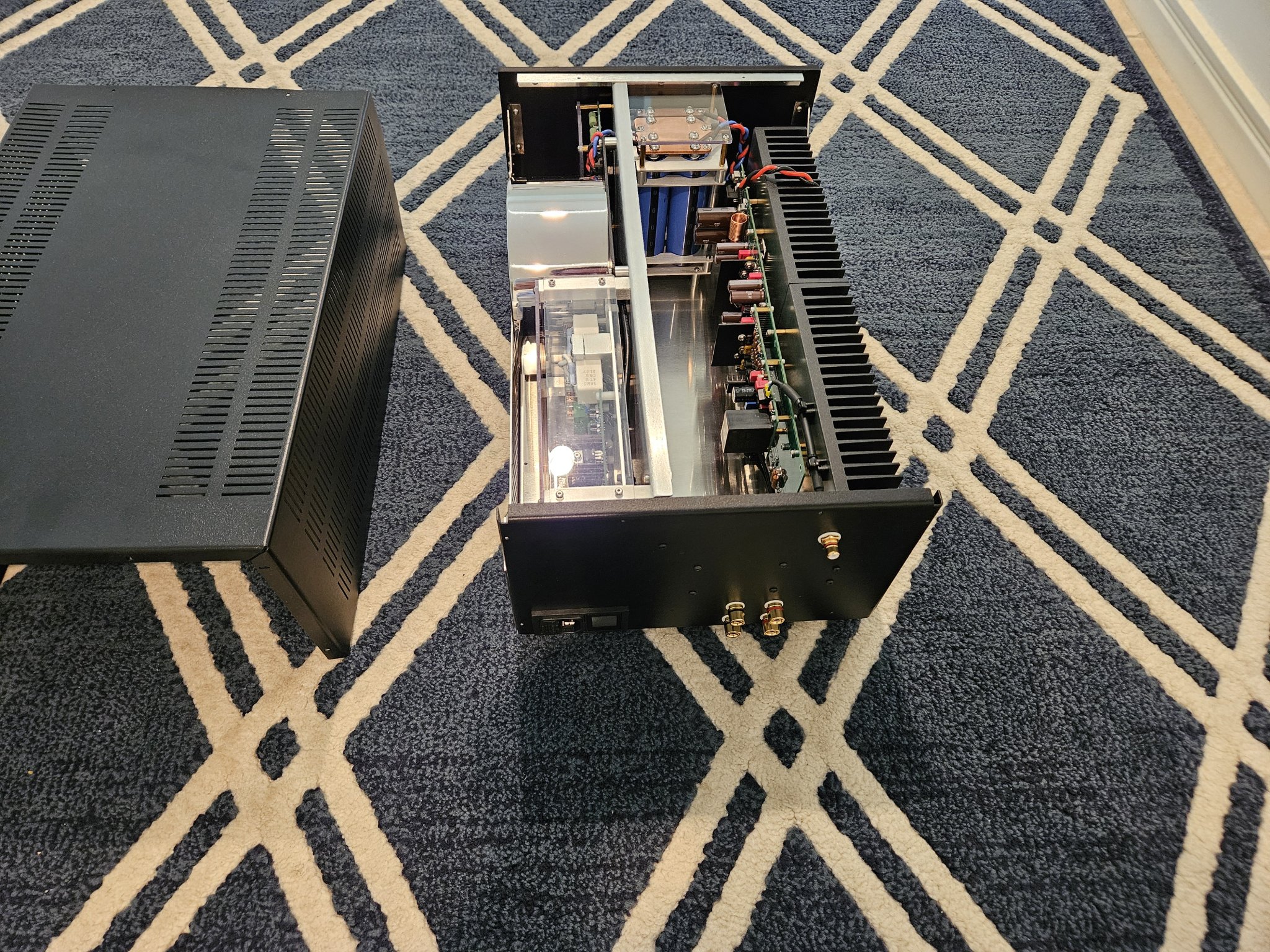

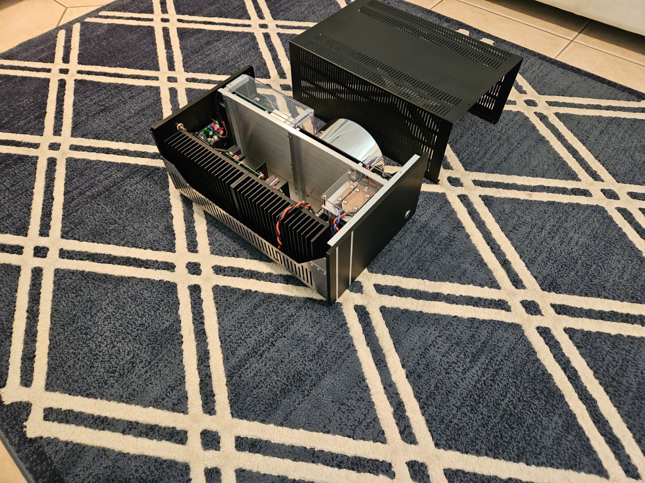

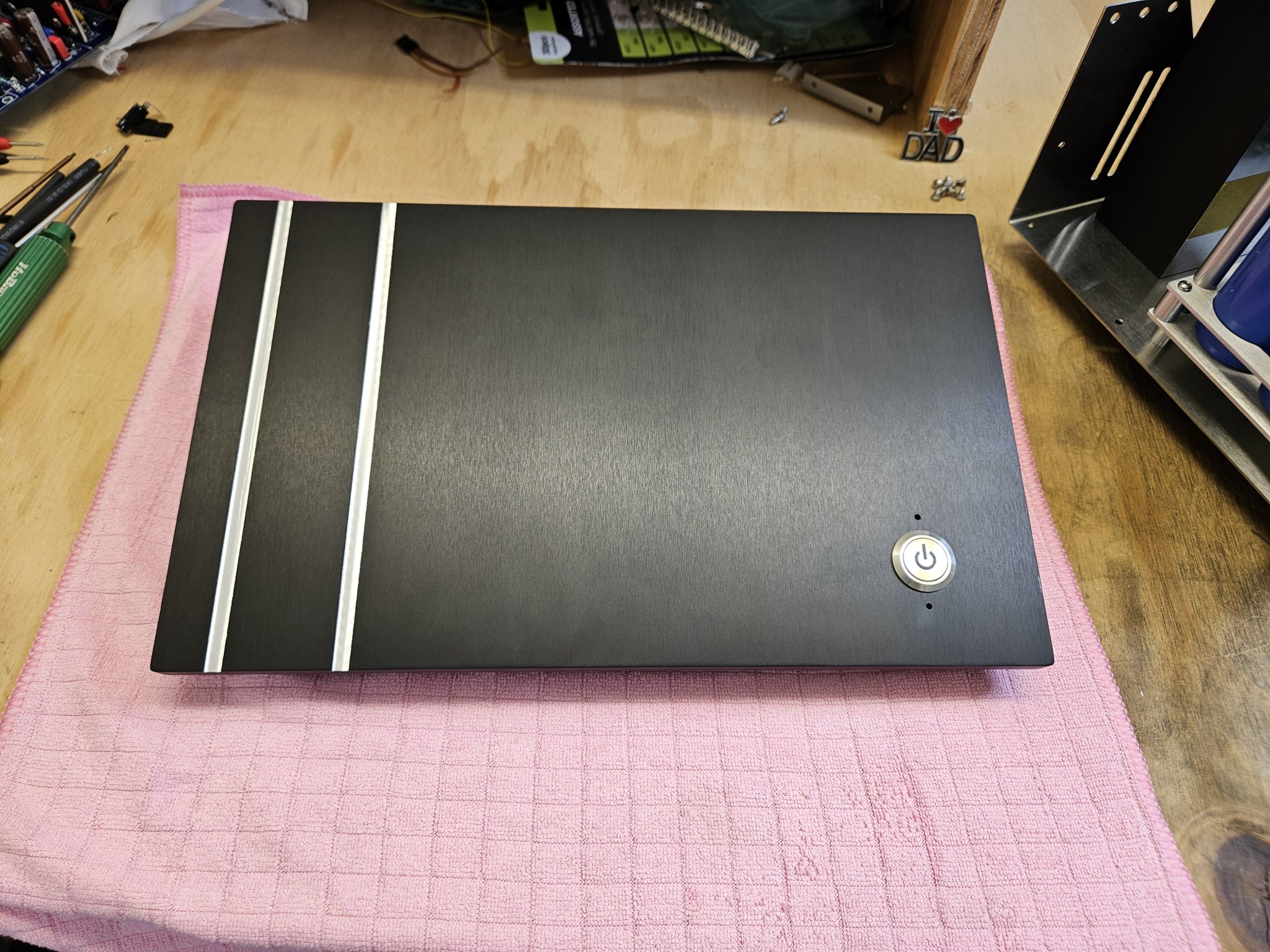

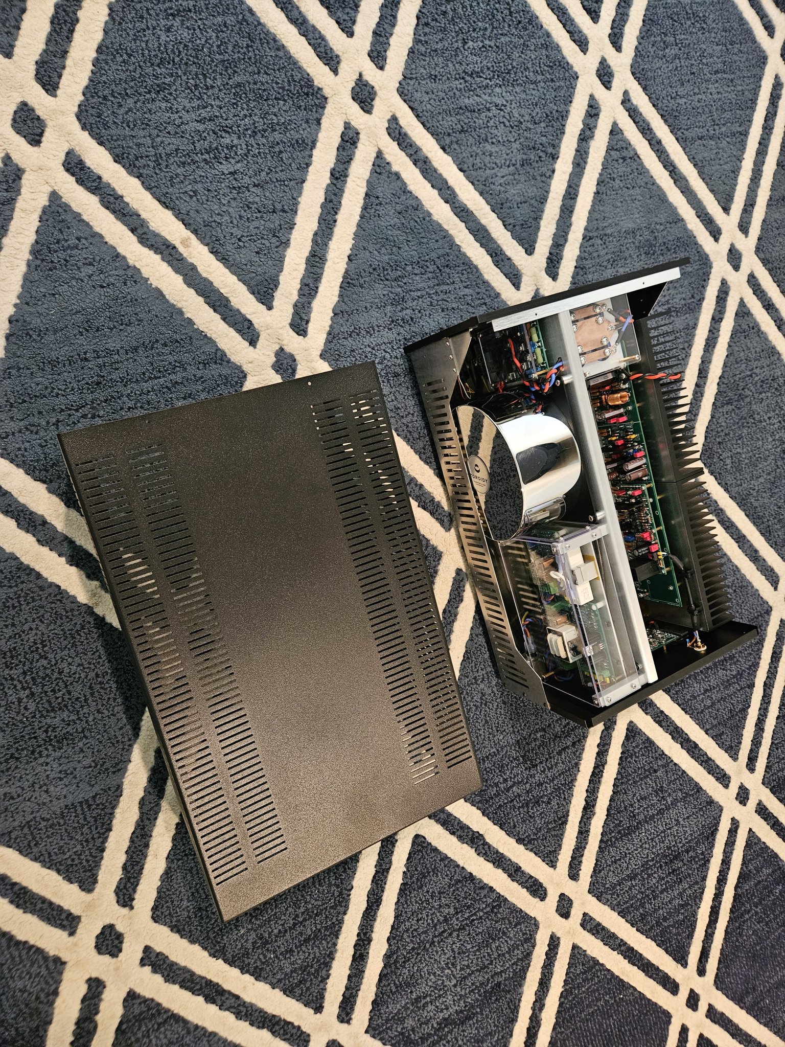

Finally finished one of the Wolverine monoblocks. Now just the wiring to go on the second.

Wow, seriously impressive! Can’t wait to get this far on mine. I like the low key look and it’ll be nice to see the two sitting side by side!Finally finished one of the Wolverine monoblocks.

I designed the chassis in Inventor, created flat pattern dxf files for all the folded parts and then the chassis was laser cut and folded by a local laser cutting firms. All the other components were made by myself or a few close friends. I work at a few engineering companies so their resources came in handy to complete this project.how do you make the chassis?.
VERY classy build, indeed. Excellent work, Stuart.
Great photos, but could you line up the faceplate racing stripes with the rug?
