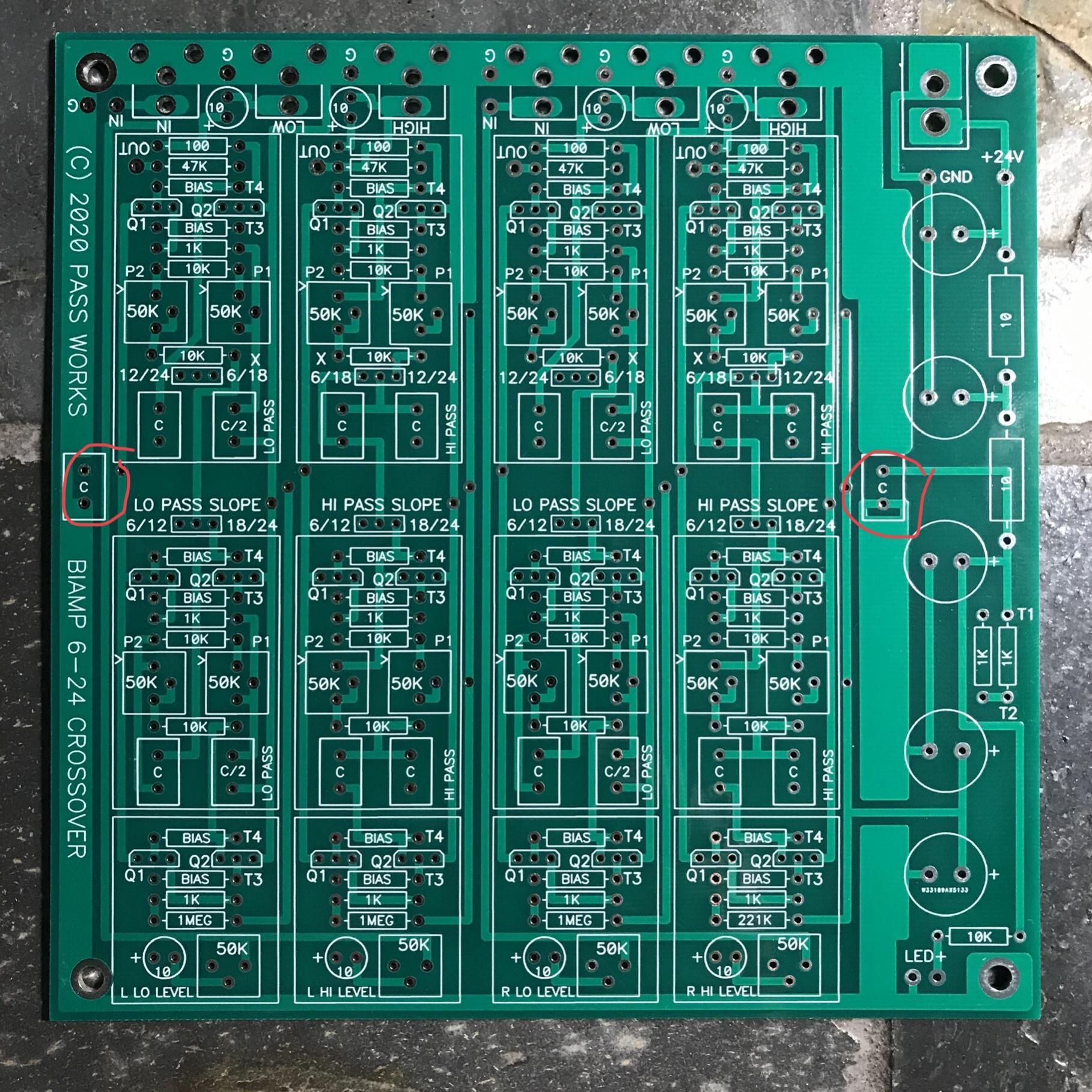

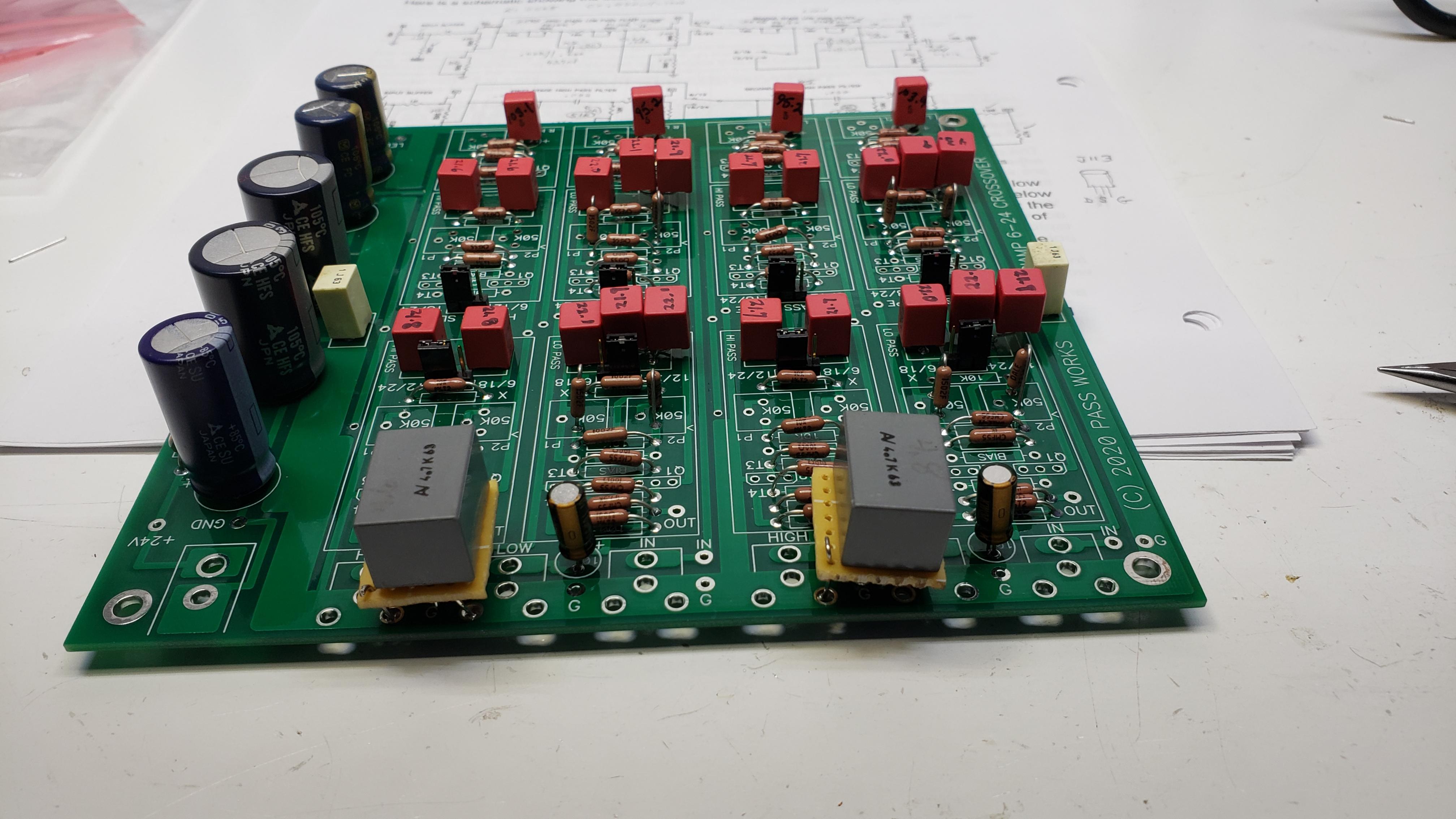

Left and Right bypass Caps marked C

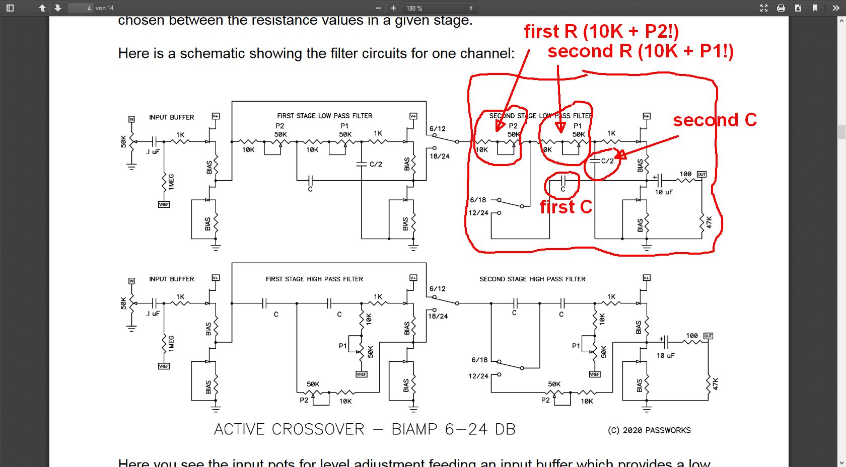

The capacitors marked C on the left and right of the circuit board (see attachment) do NOT seem to be in the schematic of the crossover or power supply. They seem to bypass the power supply electrolytic.
Nelson, what is the correct value for these bypass caps ???
Capacitor left and capacitor right are in parallel with the third C-R-C-R-C ( in other words , the output of the power filter ) . The capacitors bypass the electrolytic. I plan on using film caps for input and output caps . I know I will need to use less than 10uf and pay attention to the RC time constant as this forms a high pass filter. The 221k resistor in question is in the same position as the 1Meg input resistors, supplying the Vref to the FETs onthe input buffer. I soldered in a 1 Meg resistor. Cant wait to compare this crossover to my opamp based filter.
Those outlines are marked "C" and as it says in the manual; "All the values of “C” in this schematic are the same value, . . . ."
and "(C is) determined by the center frequency in the two octave range, and the “C/2” capacitors are generally at 1/2 the value of C."

I have some nice small blue plastic 1uF/63V capacitors laying around, so I popped in two of those. They look pretty, and I believe will work well enough.
I think something like 0.1µF or larger will be fine.

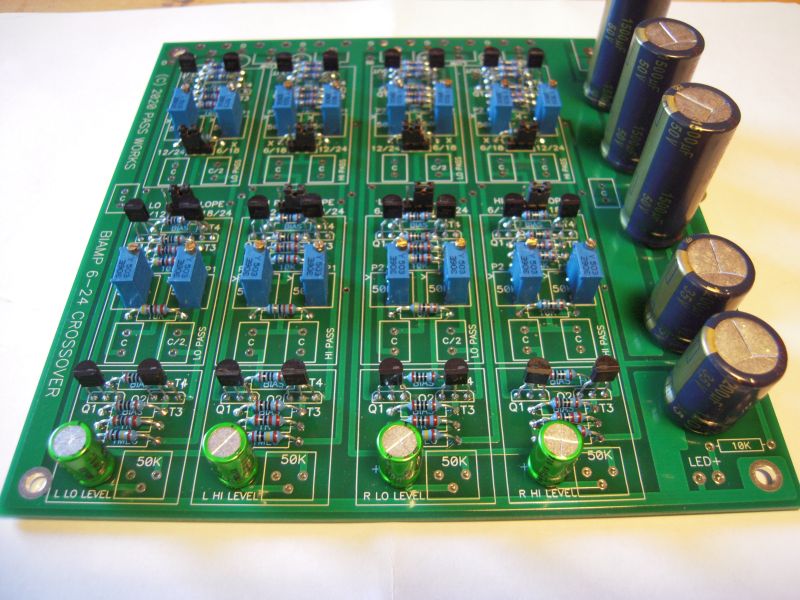

6-24XO

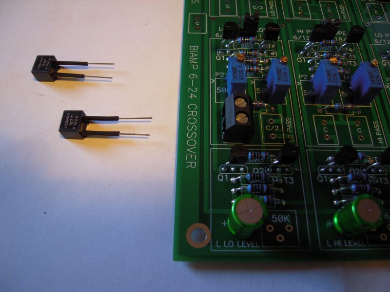

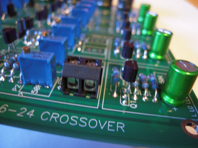

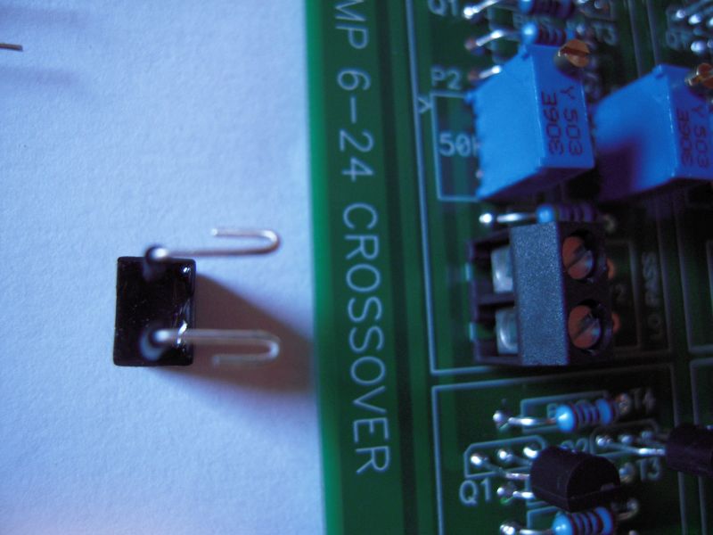

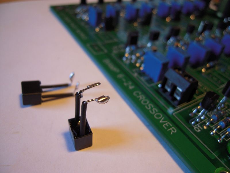

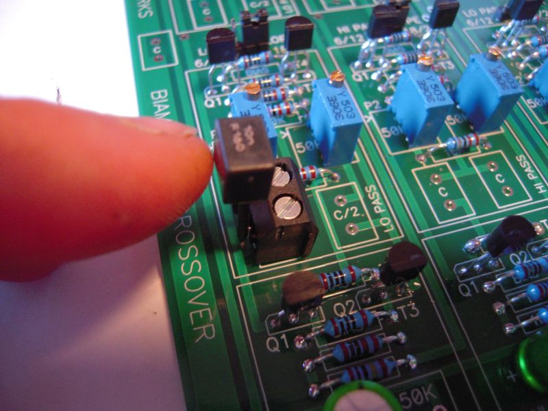

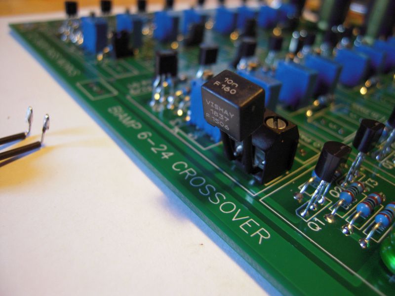

This is my approach to make tha caps for the filters changeable -
screwterminals.
Bend or prolong the legs of the small caps, solderblop and you can screw them in. It's a tight fit. But possible. 😕😀
Greets
Dirk
screwterminals.
Greets
Dirk

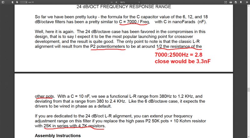

Thanks Dirk, good idea! Did you figure out the C values? Or diy you keep the same values as on the screenshot you posted earlier on?

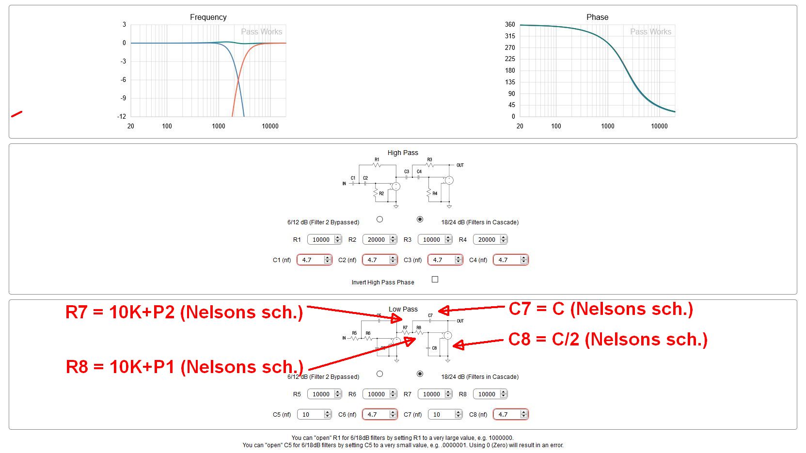

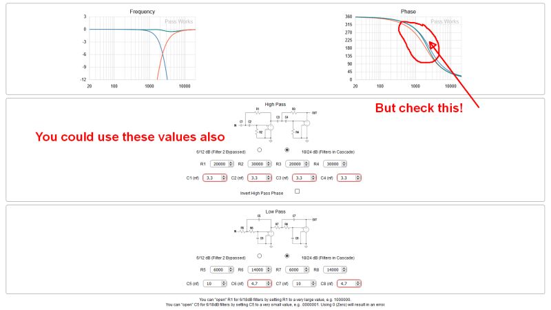

to Robin De Wolf #215 and all other builders
Till now I only played with the values in the simulator of Michael Rothacher.
I am focused on a 24dB crossover characteristic (steep slope).
I compared the schematic in the article of Nelson Pass with the schematic in
the Simulator of M. Rothacher.
I attach some screenshots.
You can play with the values of the C's in the simulator.
I am not 100% sure which values I wanna use yet (the C's).
I changed the values of the resistors (original 10kOhm) to 4.7kOhm (in the low pass filter) and from 10kOhm in the high pass filter from 10kOhm to 6.8kOhm. Because they are always in line with the pots.Still enough adjustment range with the 50kOhm-pots.
Please be patient with me.😉 I will report back as soon as I have a result for me.
All is only simulated yet. Listening tests have to proof the simulations.
Also pay attention if you play in the simulator what your phase-shift is doing.
Greets
Dirk
