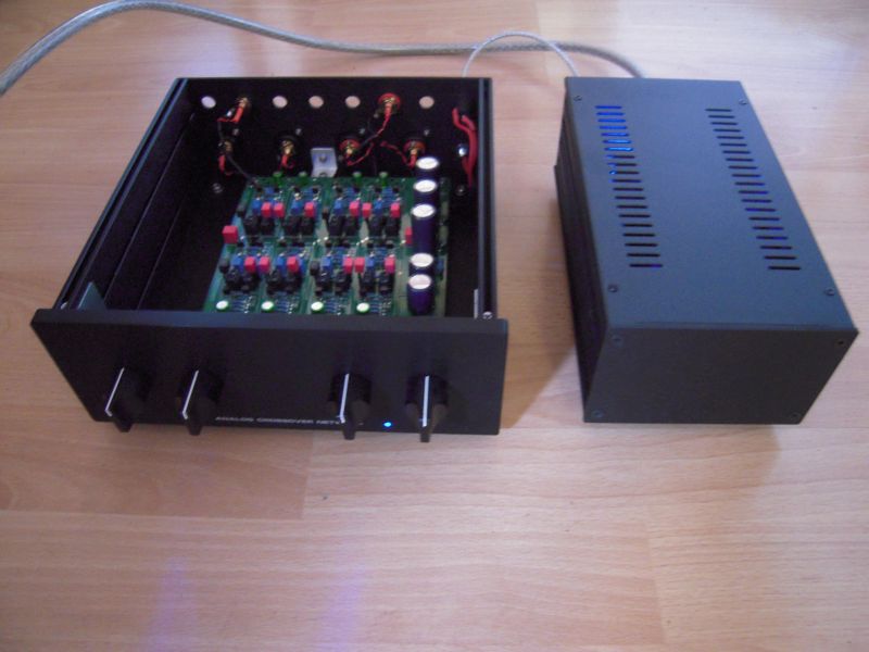

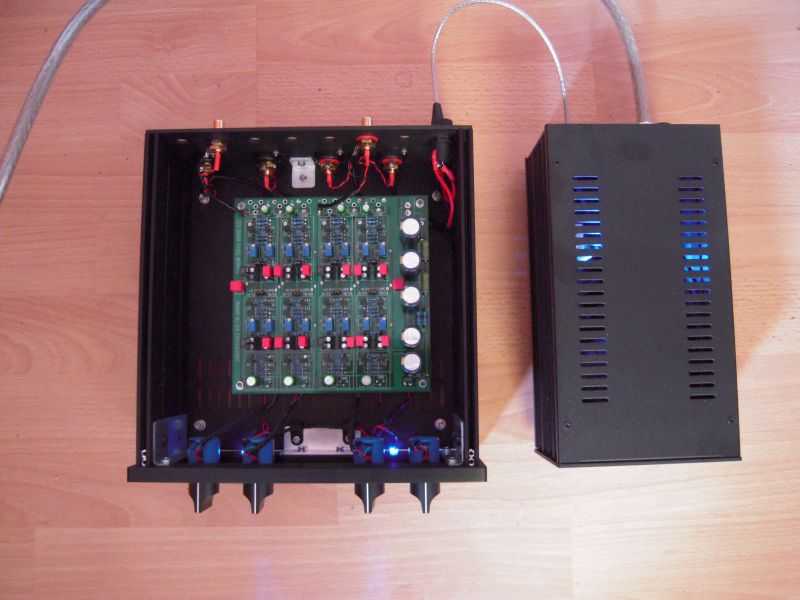

6-24XO
Hello members,
my 6-24XO is in the case (of my former ACN) and it is working - no smoke!
JFets are running at circa 36 - 40 C (temperature).
Perhaps a soundcheck this early evening....?
Greets
Dirk

6-24XO
It's playing music!
Preamp: B1 NUTUBE
AXO: 6-24XO
Amp (mid/bass): 50W SE Schade amp
Amp (highs): M2X
I only adjusted the inputpots of the 6-24XO. Lowpass at full power, Highs strongly reduced. Resistance of the filters have been preadjusted like in my simulations.
You can listen to music in a very satisfying way - from the start! But now starts the challenge to adjust the filters.
I am happy!!! Thanks Nelson Pass!
Greets
Dirk
