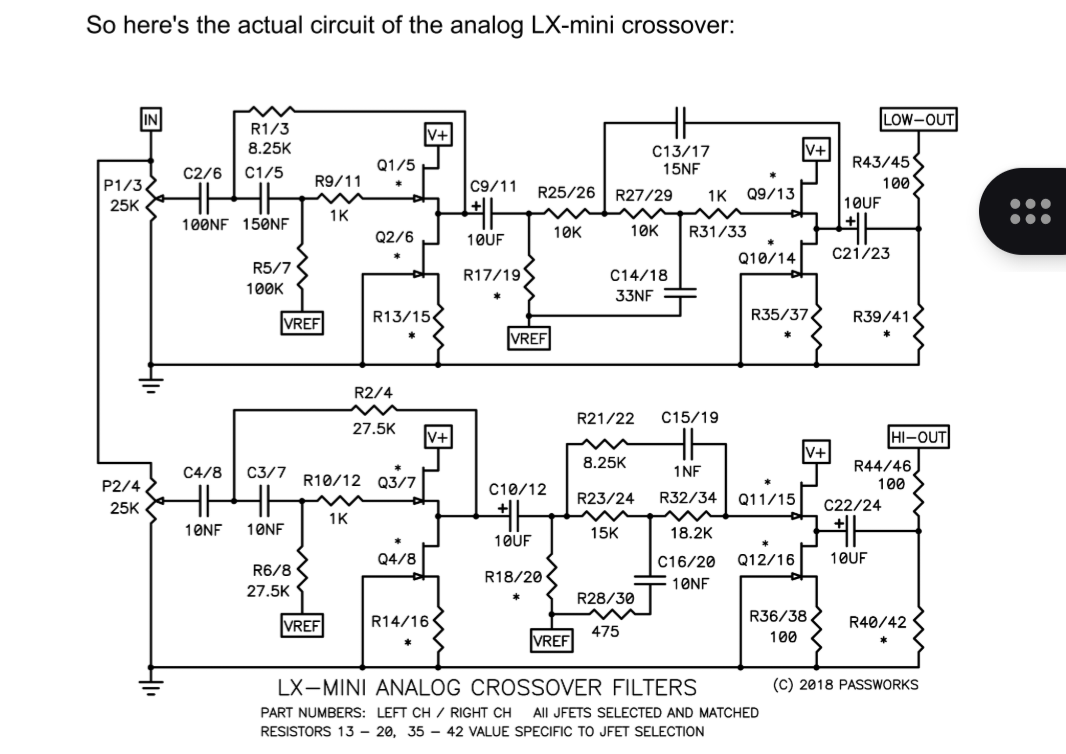

I'm planning to build an LXmini XO with a linear regulated PSU, and I would like to add a soft start to protect the speakers.
This one from NP seems to be perfect for this project, but I have some doubts about the number of filters. A regulated power supply has its own filters, as does the LXmini, if I'm not mistaken.
Could someone with more knowledge tell me if this is a good idea?

I am using a linear power supply on one of my 6-24 crossovers. Not problematic at all.
I keep it always on.
And I use the double PI filter with three 1000 uF capacitors and two 10 ohms resistors.
I think the soft start belongs in the power amplifier.
But of course, you could implement a relay and the crossovers output, disconnecting for a few second at power on.

if you completely roll your own you could use the B1 Rev 1 topology for the low pass and the B1 Rev 2 topology for the high pass. Use the Toshibas for the Rev 2 and the other JFETs at the bottom end.
The low pass will send the signal through capacitors anyway.
You will ned +/-12 V for the high pass and +24 V for the low pass.
