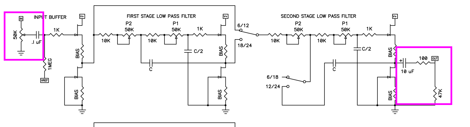

Question 1
The circuit has a 0.1uF cap in the input buffer, but this is labeled as "10" on the board, which one is correct?

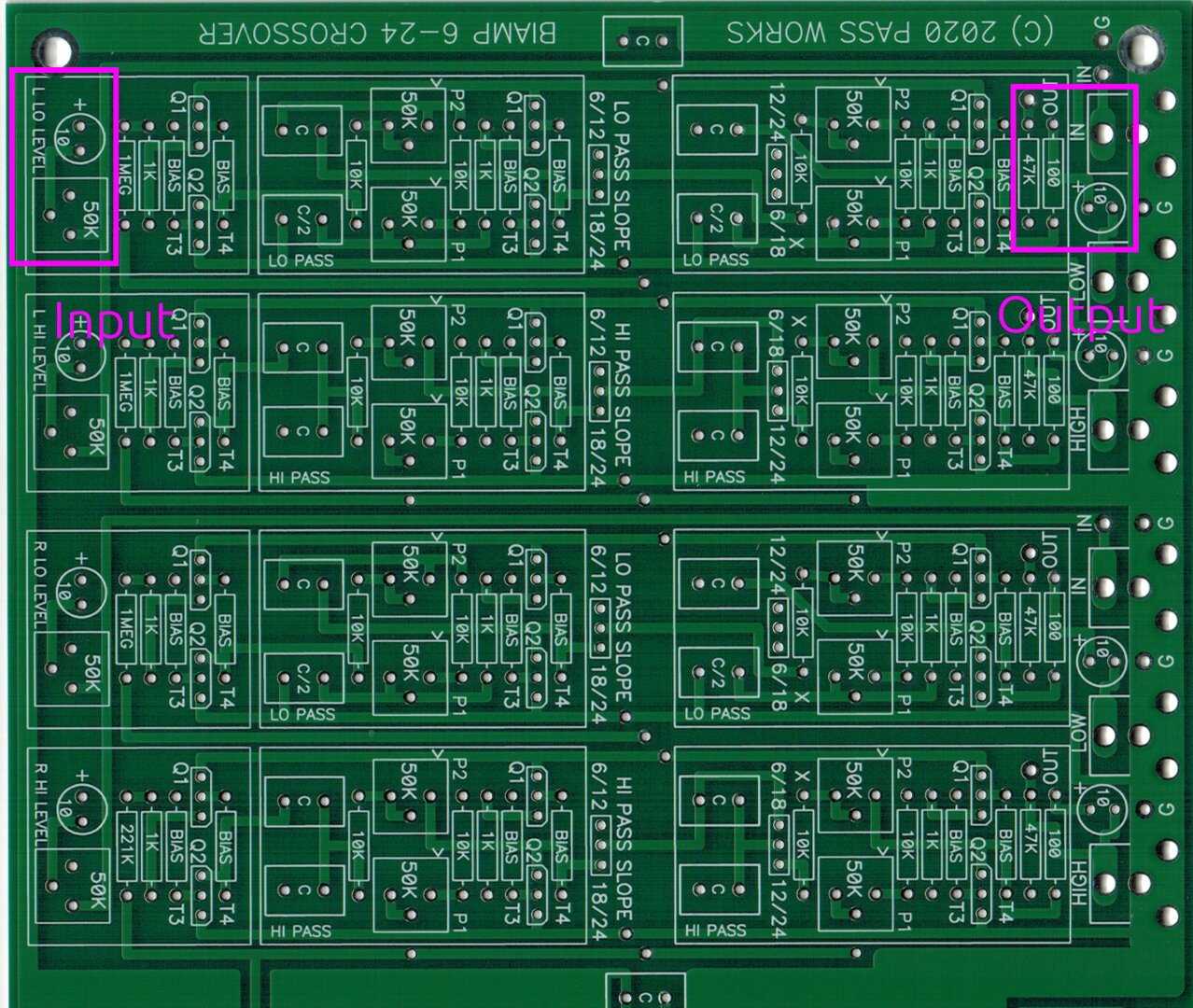

Question 2
Do I understand correctly that the circuit involves two polarized electrolytic capacitors in input and output? At least that is what I understand from reading this BOA. Now, I am in no way going to debate the design choices of a legend like Nelson, but I don't sleep at night with it. Is it possible to take the input section (50K pot in series with the cap) and the output section (starting before the output cap) off the PCB so that physically larger capacitors can be used? Is there any contraindication to leaving the PCB leads in those places?
Question 3
And we come to the input/output capacitors. Is it possible to use smaller film capacitors such as the usual 3-5uF of many tube line stages?
Question 4
Since I use a tube preamplifier that does not digest low impedances, I'd like to have >50K in input. Can I replace the two input pots with 250K pots or fixed resistors?
Question 5
For the possible input potentiometer, is it better to use a linear or logarithmic one? My intuition would suggest a linear potentiometer in this case.
Question 1
Question 2
Question 3
Question 4
Question 5
Answer 1:
0.1uF = 100nF will give you a low at 1.6 Hz - low enough I will think. I must admit I used 10uF polypropylene and both in- and outputs. I did not notice until later.
Especially for the high pass section 0.1uF should suffice.
Answer 2:
As mentioned I used PP, however on my Korg preamp I used the electrolytics, and I have a sound(!) sleep.
I installed my 10uF PP caps with wiring to and from the PCB, and there might be some pictures earlier in this thread.
Answer 3:
For the input capacitors as mentioned even 100nF should be OK in my opinion. The output capacitors "work into" 47k however, and further on into the power amplfiers input impedance. 2.2uF should into 47k should give you a -3 dB at 1.5 Hz. If the power amplifier has 10k input impedance the 2.2uF will land the -3dB point at below 10 Hz.
Answer 4:
I have not tried this, but I guess it is a fair change it will be OK. You have to try. It might pick up more noise.
Answer 5:
No experience. But one thing I will say: I am using this crossover with Quads and SVS subwoofers, and I regret I used trim pots at the input because I am adjusting on the subwoofer. Please not in other cases it might be the higher frequencies, not the bass you want to attenuate in which case the crossover or the power amplifier for the higher frequencies needs a potentiometer.
That concludes my views and experience on this - good luck to you with the experiments.

Hello piecor,
I will try to answer a few questions...:
Q1: I have used a 10µF bipolar cap (NICHICON UES BP - so called 'green sleeves') at the input and the output.
You could also use a PP-film cap there. The function of this cap is, that the virtual ground of the buffer
cells sits anywhere close to the middle between GND and close to ca. 21V (with 24 V rail - single ended).
Virtual ground is anywhere at +10 to +11 V , so you need a decoupling cap at the input and at the
output.
Q2: You can use physically larger caps at the input and at the output - if you want to lower the cutoff-
frequency (1 / 2xPi x R x C)
Q3: You could try a smaller filmcap at input / output. 3,3µF or 4.7 µF are worth a try. Don't ask me how it
sounds? This is your testfield.
Q4: You can try volume pots with higher values. Don't ask me how it behaves with a 250kOhm pot at the
input. Should be no problem?
Q5: For volume adjustments we normally use logarithmic pots. I used linear ones. And my ones are 10-turn
pots - possibility for very small adjustments. But that was my decision.
Hope this helps a little bit? Others are welcome to give a comment.
Cheers
Dirk

Thank you R-K Rønningstad!
Regarding question 3, I see your point. Actually one needs to consider the amp input Z in parallel with the 47K resistor, isn't it? In my case I have 47K input at the amp, therefore 47K parallel to 47K would be 23.5K. A 4uF cap would give the 0dB point at 16Hz (-3dB at 1.6Hz)!
I'm also thinking not installing the input pots at all. I don't want to attenuate the highpass and the lowpass will go through EQ correction anyway. Actually I'm also considering to replace the analog lowpass with a digital crossover that will allow me doing some EQ. I'll cross so low (80Hz region) that I don't care. I just wonder if a digital lowpass will be able to integrate perfectly with the 6-24 highpass... who knows!
