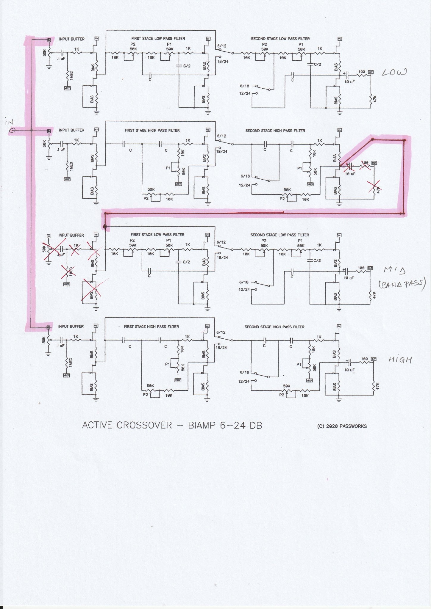

3 Way Active XO
Seeking opinions on a 3-way active crossover schematic (Low Pass, Band Pass, High Pass) on one board.
After searching through numerous posts, I haven't been able to find a complete diagram for a 3-way active crossover. My apologies if one exists and I've overlooked it.
Would anyone be willing to share their thoughts on whether this schematic represents a good approach?

Hello dansa69,
you can do it simpler for a 3-way - active setup using two of the DIY-biamp 6-24 crossovers:
build one as a subwoofer crossover (crossover frequency anywhere around 80 - 100 Hz) and a second one for your desired crossover -
frequency (mid / high) and daisy-chain them.
I did this in my system: 6-24 AXO at 80 Hz between subwoofer (low output) and (high output) to second 6-24 AXO.
The second 6-24 AXO is set up for crossover frequency between 2000 Hz to 3000 Hz.
Then you can still use the two different 6-24 AXOs independently. Works and sounds like a charm for me.
I run two 12 inch subwoofers (stereo setup) from the 6-24 AXO (No.1) below 80 Hz (driven from an PA-amp or BA-3);
the bandpass (80 - 2500Hz at the moment) drives a 6.5 inch midbass from Scanspeak (driven from different Pass amps like M2X);
Highs are AMTs driven from the high output 6-24 AXO (No.2) with an ACAmini or F5.
Greets
Dirk
I'm certainly not an expert, but yes, that looks like the right way to do it. Logically, you should not need the output circuitry if you're feeding directly to another stage, and you should not need the input circuitry if fed directly from the previous stage, as long as there is at least one buffer between them. And of course you've got to jumper the L and R input so each board runs in mono. I don't know if that affects the input impedance. There was a previous post that showed the same configuration, but no one ever replied about the results or whether it even worked.

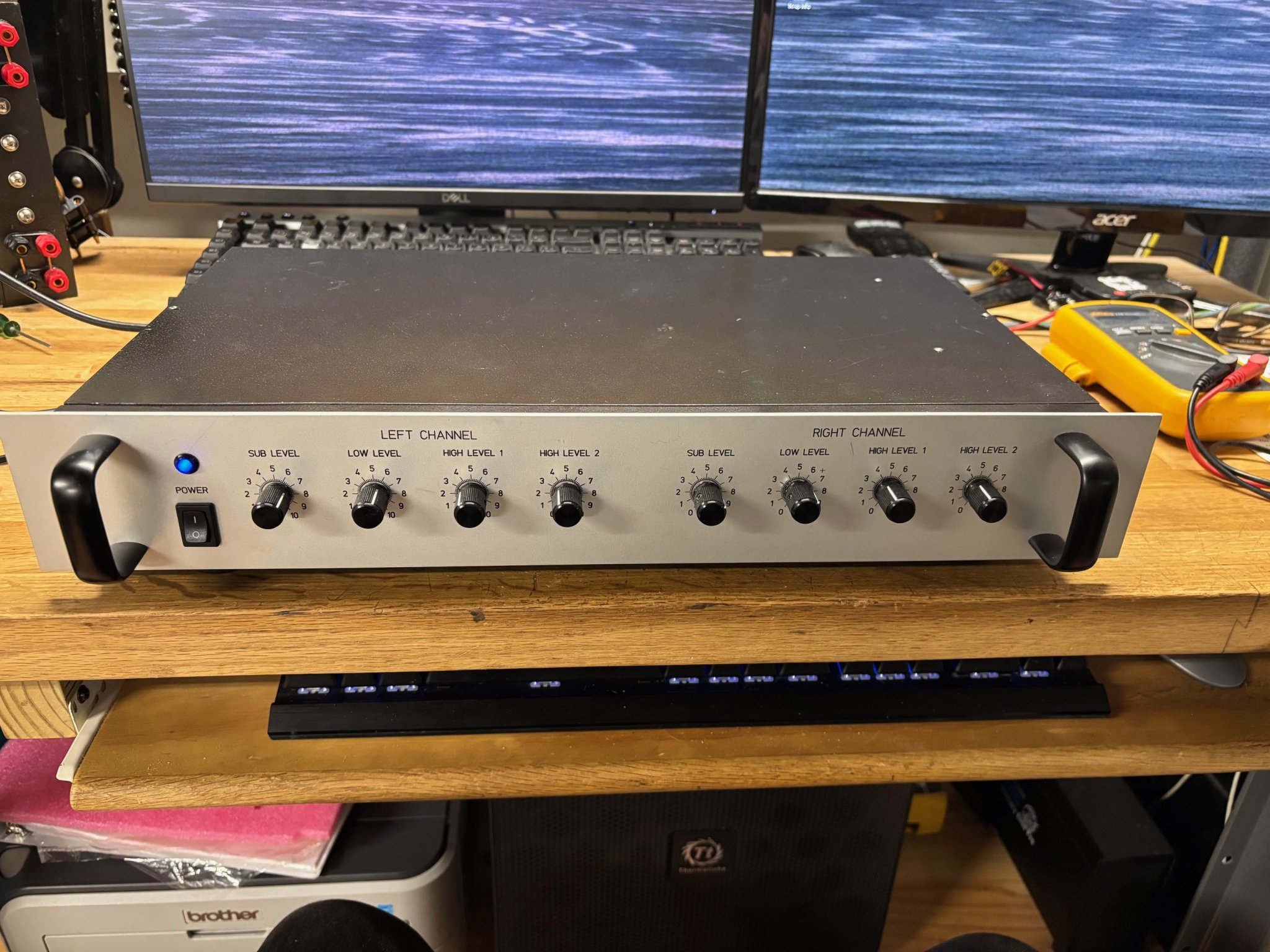

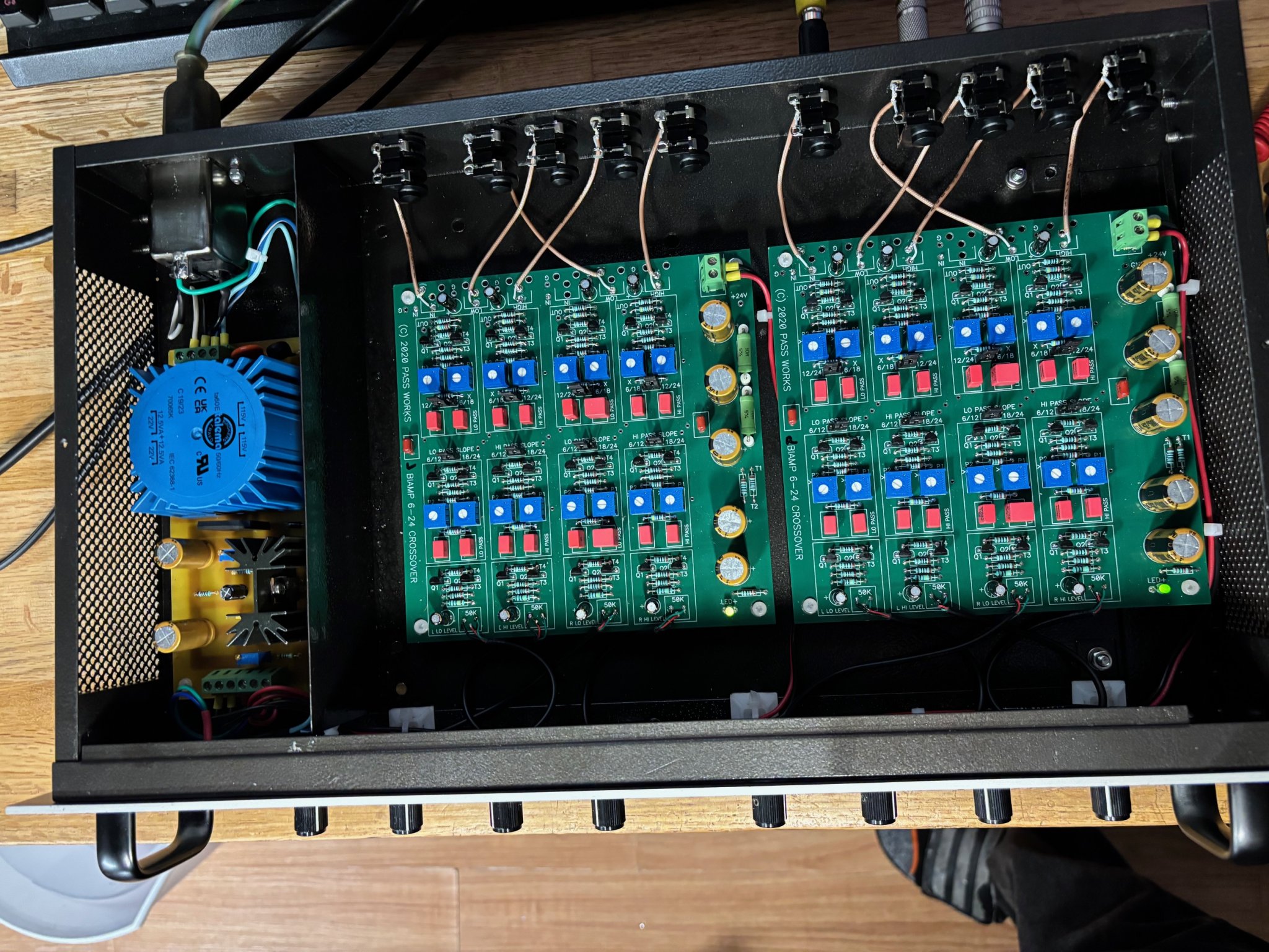

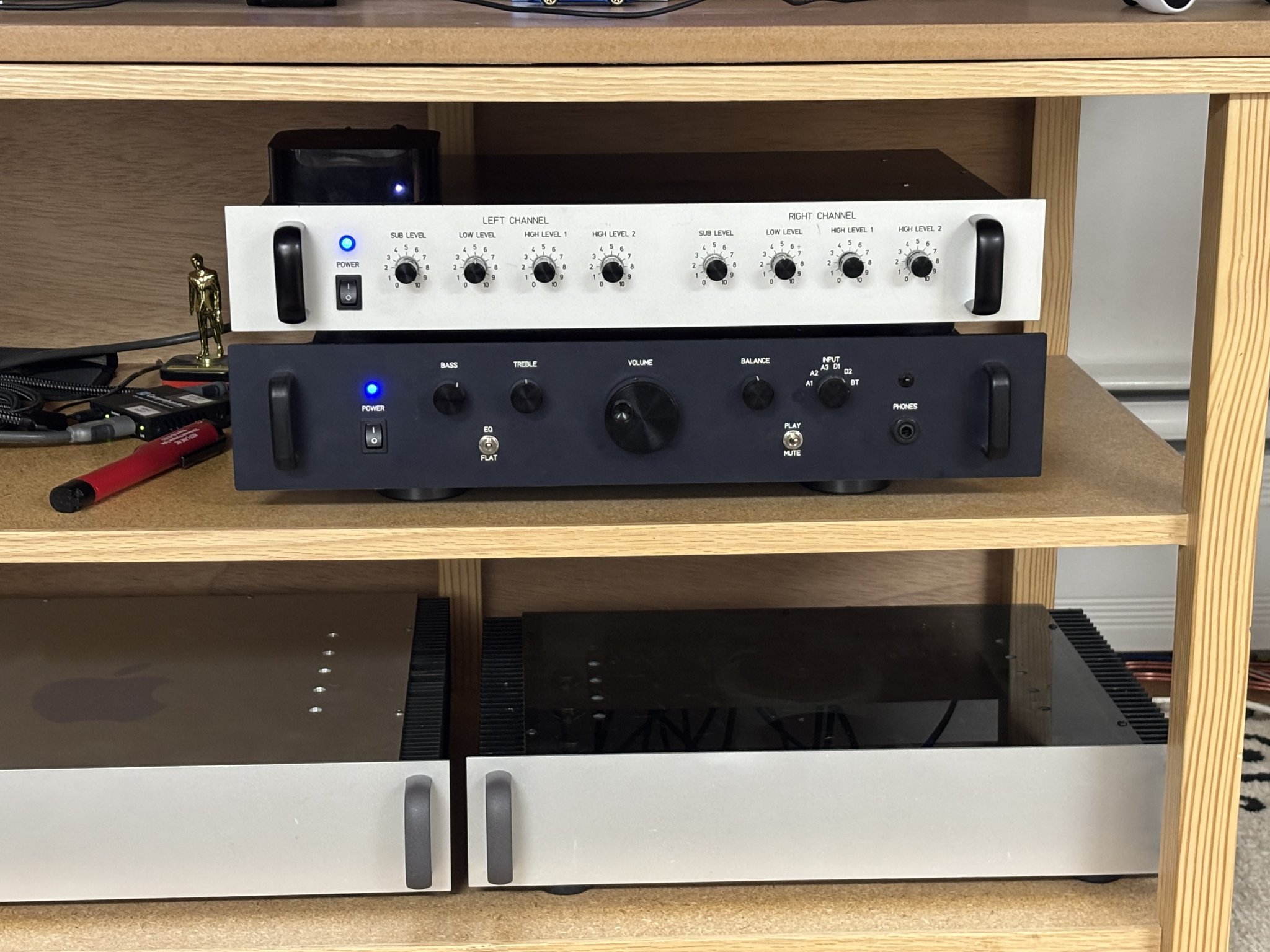

Here’s my implementation of the DIY 6-24 active crossover.
This was built to replace two ART CX311 analog active crossovers in my system.
The 6-24 consists of filters for sub, low, and high x2 for each left / right channel.
The sub low pass is at 150 Hz with 24 dB/octave slope and the low-high xo is 2.5 kHz also at 24 dB.

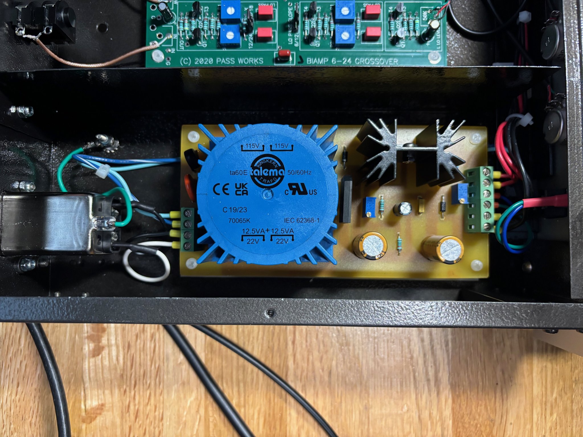

The power supply is my simple linear design with a 25VA toroid and an LT350 adjustable regulator.
The case from a scrapped piece of telecom equipment with addition of my front panel.
I used “Front Panel Designer” software from the Front Panel Express company but just made the panel myself using a piece of anodized aluminum from an old Apple power mac case.
The text and scales were applied with the toner transfer method.
Setup was fairly simple and done mostly on the bench since I already knew the xo frequencies that worked well with my speakers. Levels were adjusted by ear, as I did with the CX311s, and then I do a final check with REW afterwards.
I’ve been listening for about a week now and I like it a lot.
