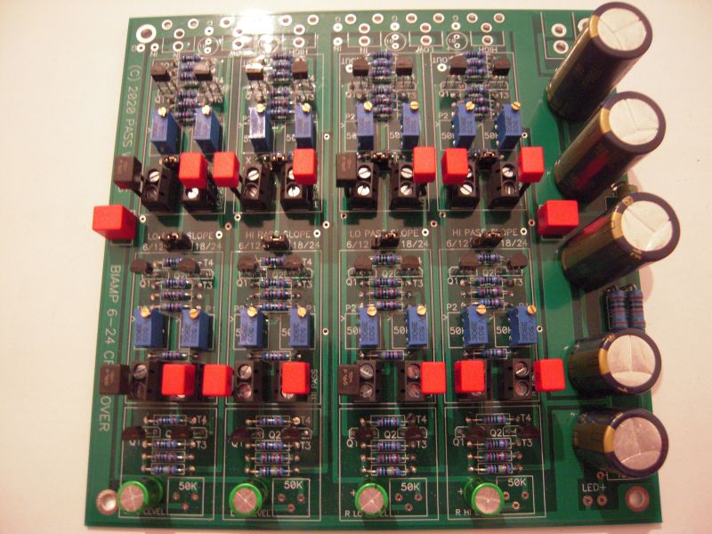

The capacitors marked C on the left and right of the circuit board (see attachment) do NOT seem to be in the schematic of the crossover or power supply. They seem to bypass the power supply electrolytic.
Nelson, what is the correct value for these bypass caps ???
Anything will work, in fact it is highly probable that no cap at all will still
be fine. For this reason I chose a value which is already on the part list.
:snail:

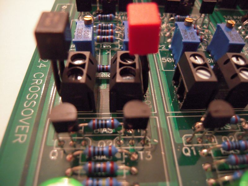

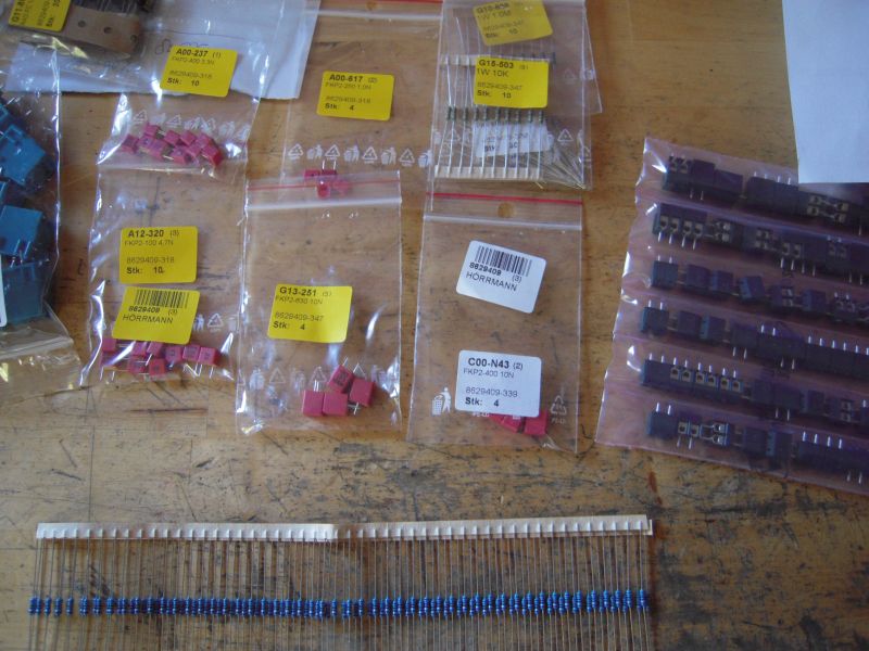

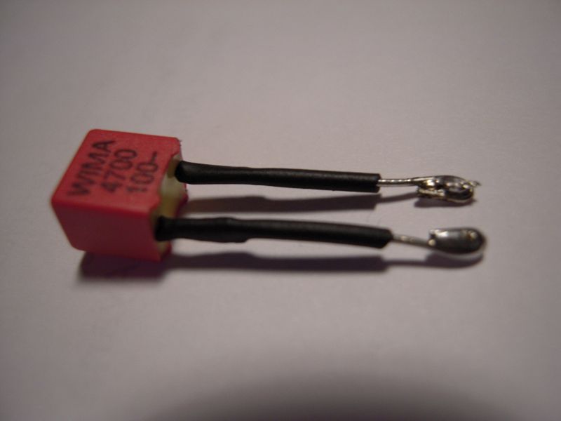

Hello 6-24XO-builders,
today I soldered the screwterminals in. I prolonged the legs of the WIMA-caps.
And screwed them in (low pass filter).
The story continues...
Greets
Dirk

Nice pictures - thanks for the updates
looking forward to receive my boards soon
One note though, for an experimental setup with ongoing changes it will surely work ok - but do yourself a big favor and avoid tinning any wires or component legs that you are clamping or screw mounting.
It has a negative impact on reliability and will have a better connection impedance w.o. the tinning.
It was not on purpose - but I seem to be in the footsteps of Nelson, my 6-24 Crossover will be added to a system with Pass F5 (and later F4's) and stacked ESS Heil in an open baffle system, also including SLOB's

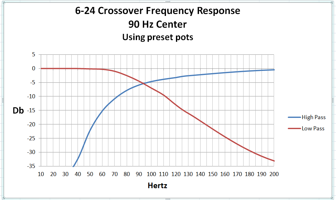

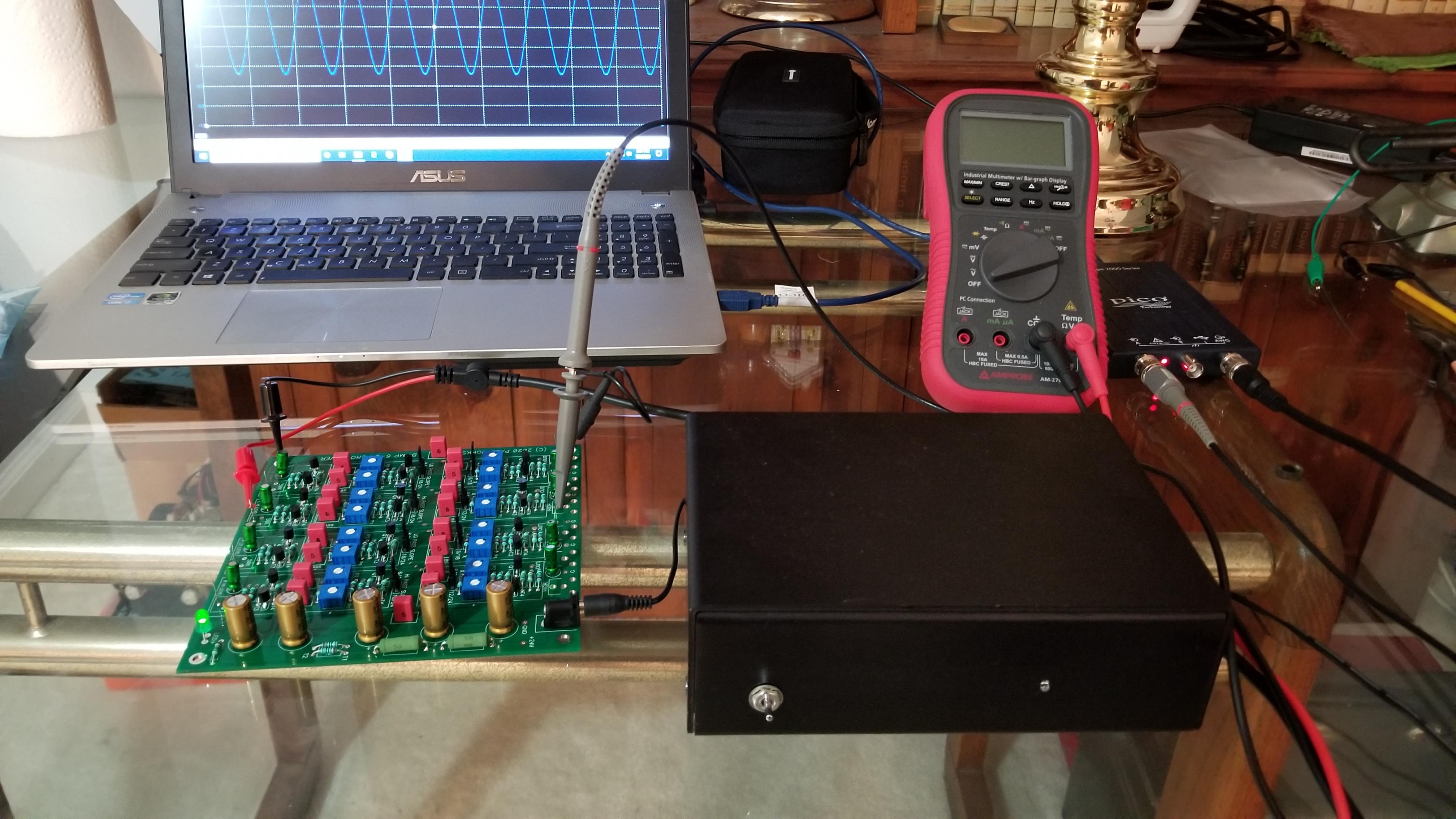

I finished up my 6-24 crossover tonight. It's working great. I preset all the pots before installing them on the board using calculated values for 90 Hz / 24 dB per octave. Attached is a graph of the frequency response I achieved with no further adjustments. Looks like I hit about 92 Hz. Not too bad. Probably will tweek it a little.
I used my DIY 24V power supply with Jung super regulator to power the crossover. (black box in the picture) This supply substantially improves my phono preamp. Don't know if will make much of a difference in this application. We'll see..
Only issue I had initially was with one of the low pass filters not working. Removing the jumper between the filter sections allowed them to be tested separately. Kind of a nice extra benefit of the jumpers. Both sections worked fine. I reinstalled the jumper and everything now works perfectly. Guess the jumper wasn't on properly. Weird.
Can't wait to listen to see how it sounds...
Thanks Nelson for a beautiful crossover !

to #232 and#233
You are absolutely right, that the tinning and screw terminals are not the
optimal solution. But this was the price I had to pay to stay as flexible as possible.
I have something else in mind with daughter - PCBs. For the future... 🙄
Greets
Dirk

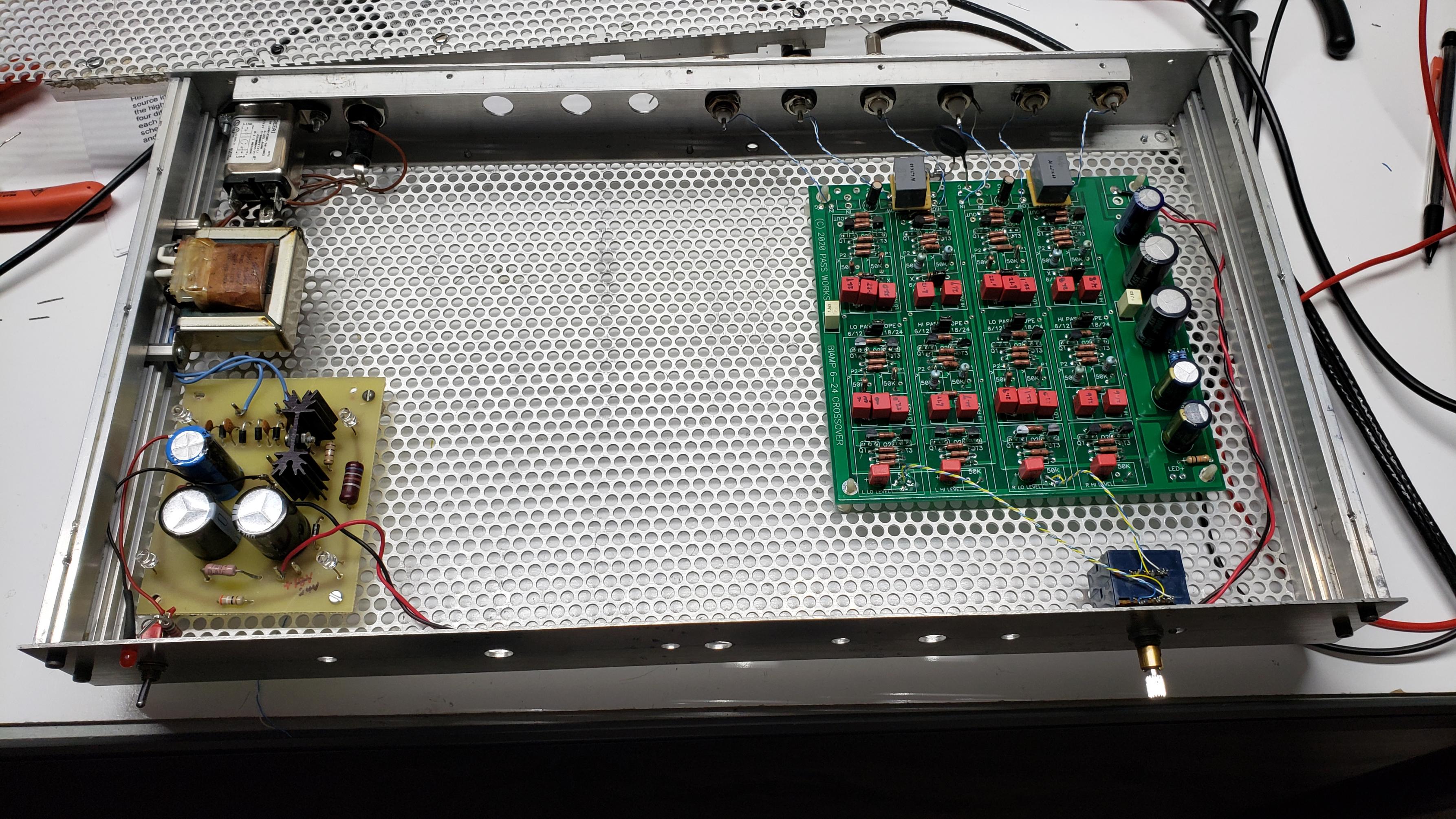

Up and running . Dead quite no hum or noise. I am biamping with a Aleph J and a 160 watt per channel class AB Fet amp for bass. Crossover is set for 24db per octave at 200hz. The difference between my opamp based crossover is quite apparent. Once again Nelson Pass hits a home run.
