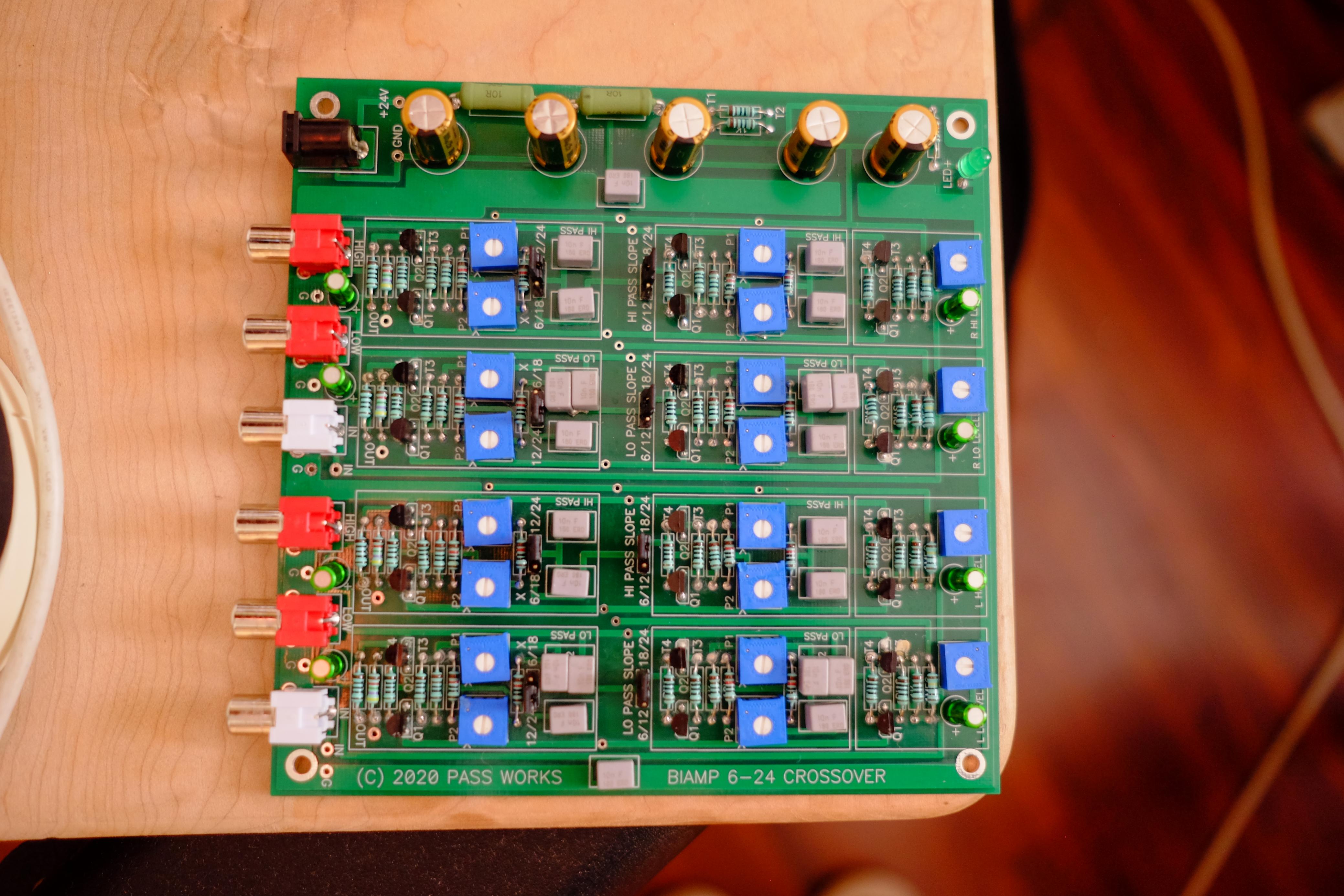

Very nice board Mr Pass! (The pic is just becuase it's an easy crack at being the first one . . . . something I don't get to do much so it's a cheap thrill at the thread's expense)
Thank you ! Everything, the layout, spacing, makes it a snap to do. Thank you!

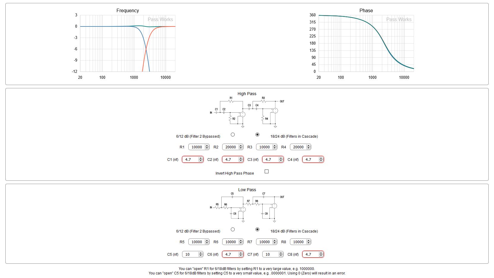

I want to use this beautiful 6-24XO for my 2-way speakers too.
My aim is to divide the frequency spectrum at 2500 Hz.
I show my values for the resistors and capacitors in the photo below.

So i would test to crossover at 2000 - 2500 Hz. Easily adjustable with this
fantastic 6-24 Xo from Nelson Pass. Also the different sound pressure levels can be easily adjusted with the pots at the input.

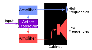

to Robin De Wolf #168
Hello Robin;
and I think you know, that your existing passive crossover in your 2-way - speaker has to be disconnected from the loudspeakerchassis. You drive each loudspeakerchassis with one channel of a power amp after the active crossover. So, for two -way - stereo speakers you need 4 poweramp channels. Two stereo poweramps.

Hi Dirk, thanks for the info. I will want to try it first on my 2 way bookshelves (8 inch driver + tweeter). This morning I was putting together the bom, and still figuring what value of C and C/2 to select. In your picture it looks like you applied C times 2 instead of divided by 2?
I will be using the ACA for tweeters and F6 for midrange woofer 😉 I guess I need to get rid of the ACA thump first, afraid that it will destroy my tweeter..?
Received my board today ! 😀
Question : There seem to be a little contradiction between the schematic and the silkscreen on the pcb. The input cap on the schematic is a .1uf but is a 10uf on the board and on the bom??
Second question, what value should we use for the additional filtering caps on the pcb. Those that are on each side of the filtering sections.
Merci !
Hubert
Was this clarified? 10uF with the 1Meg resistor gives you 0.016Hz while 0.1uF (100nF) gives you 1.6Hz as your low 3dB point.

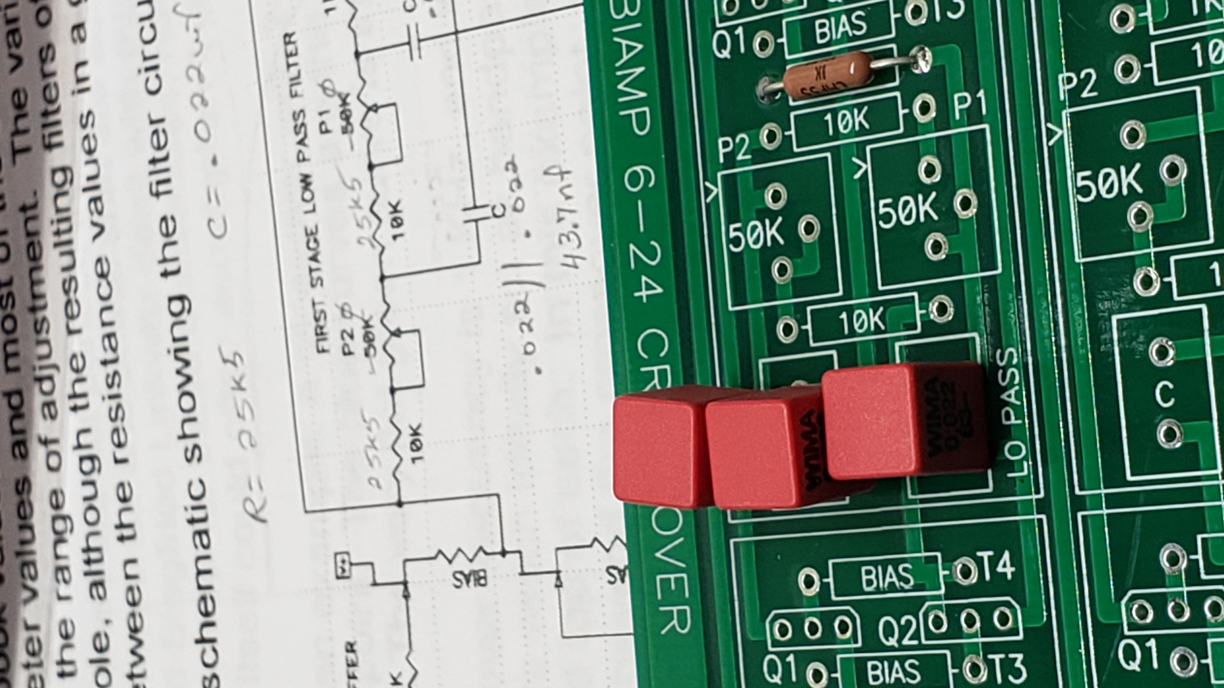

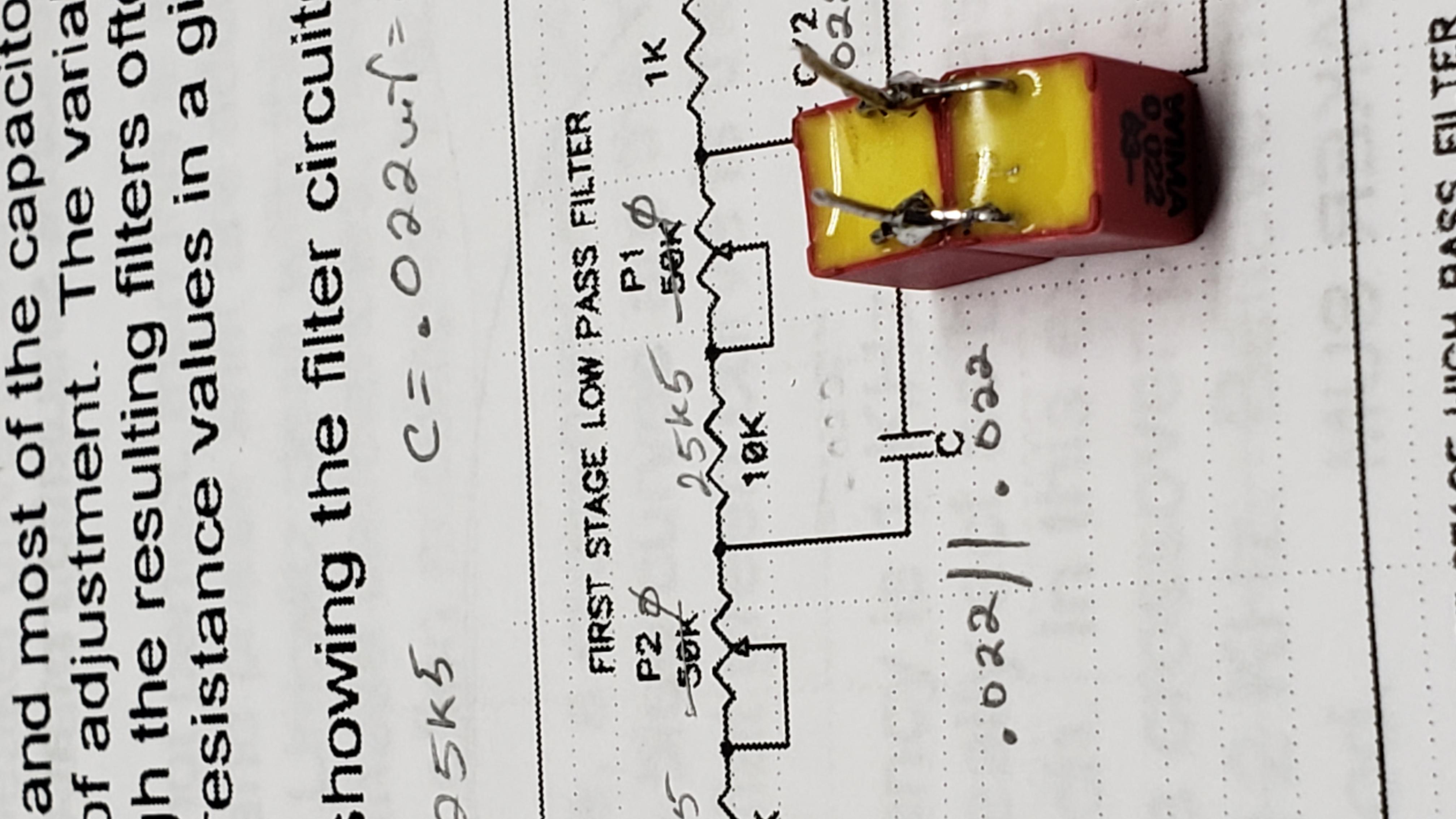

Socketing Frequency C's and Order Jumpers
I have been thinking it would make sense to have these items socketed as I suspect that these crossovers will have a life with several different applications over the years. I'd like to hear suggestions from those with more experince than I have.
Earlier this year I used the following items:
https://www.mouser.com/datasheet/2/273/4119-0-15-15-47-27-04-0-1350788.pdf
which worked, but the pins are thin relative to the PCB hole, and they were not easy to solder in squarely. Could someone with access to the Gerbers on this PCB let me know the diameter of the sandard small holes on these? If I can find a part with a snugger fit, it would be good.
Thanks, Skip
