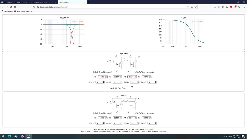

Trying to get up to speed here on something new. I need a four pole crossover for both high and low pass at 2.5kHz. The PDF says,
Also you can't see the value for C in the filters: That is determined by the center frequency that you want. Normally we will use the same value for C everywhere,with C/2 being half that value, as will be discussed shortly

Here’s a link to Mike Rothacher’s component value calculator that Nelson refers to on page 11 of the write-up, it’s pretty neat! It looks like you’ll want to be somewhere around 100-150nF (0.1-0.15uF) using the default resistor values in the calculator. 0.15uF is a standard value for Wima, unfortunately 0.075uF is not. Another smart design feature is the frequency is adjustable by the potentiometers, so you’ll have some adjustment range. For such a low crossover frequency you might set the center point a bit higher just to have a more useable range - since there aren’t too many (audio) applications for a crossover frequency below 30Hz.
PASS XO CALC

Mike Rothacher's filter application has proven its worth for me already by letting me verify the capacitor values I need for my desired 2.5kHz starting point.
