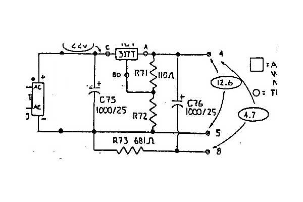

Thanks. I still haven't listened to it yet, just verifying some stuff (everything seems normal).
The ripple on the heaters is still 11mV or so. One thing bugs me... when I pull a couple of tubes, the heater voltage goes down. I had thought that reducing the load a bit should bring the voltage up. According to the datasheet, VO = V(ref) ( 1+R2 / R1 ) + IadjR2. Vref is 1.25V, R1 = 110 and R2 = 422 (IIRC). Vo should be 6.04V, but I'm getting 5.7V. Resistance that I get from ohming the umbilical pins 4-5 is 1.0 ohm (2 wire). When I pull tubes, it goes up until the last tube, in which case I only see the 2200uf cap across the heater lines on the tube PCB.
I tried bypassing the adj. terminal per the datasheet with a 10uf tant and put in a 1N4001 protection diode for this. No change. This is supposed to give 20dB more ripple rejection. I also tried more capacitance on the tube PCB, with no change either. The only thing I haven't tried is more capacitance before the regulator (4700uf in here, as was the stock cap). These are all new Panasonic FC caps, btw (C75, C76 and the one on the tube PCB, C301 not on schematics).
Any thoughts? Or is what I am seeing normal?

Hi Chris,
The voltage goes down eh? Does your ref. pin on your heater regulator go to the same ground point? Otherwise it must be oscillating and your scope isn't picking it up.

Hi Chris,
The adjust pin goes between R71 (110 ohms) and R72 (422 ohms). The attached is the SA5 schematic... the 5.1 uses an LM350K regulator. C75 is 4700uf/25V. Pin 4 (+) is tied to ground in the preamp chassis, and pin 5 is -5.7Vdc. Now that I think about it, I am measuring in the preamp chassis itself on the tube board, thru 2-3 feet of umbilical, etc., so dropping 0.3V @1.6A probably isn't too bad.
I don't think he did anything to the transformer from the 12V heaters of the SA5 (pairs of tubes in series across the heater lines. SA5.1 has each tube across the heater lines). That is a bit of voltage to be dumping across the regulator (manual shows that winding at 17VAC).
I'll have to recheck the voltage when a couple of tubes are out as the resistance across pins 4 and 5 of the umbilical goes up as expected when I pull tubes. I'm about ready to put this thing together for good and align it. I swapped out the 49.9K resistors I was using in the HV reg back to 100K/1K. Voltage across the zener is fine (48-50). I thought I found something in the heaters... I pulled all the umbilical wires from the tube board, cleaned it good, and cut them back 1/4" and resoldered. Pin 4 looked like a cold joint. Still looks the same on the scope tho. I'm guessing the ripple I'm seeing isn't anything to worry about. We'll see what my ears tell me.
Waiting for the 47uf cap to show up. I may put the other resistor in in front of it sometime in the future, looks like 150 ohms in front and replace the 500 ohm with 100 ohm (from what Duncan's PSUD is telling me).
Hi Chris,
I was trying to alert you to look at the ground reference for your measurement. So everything is okay?
I am pretty sure you will be more than a little happy with it when you're done. You are using your new power supply PCB aren't you?
