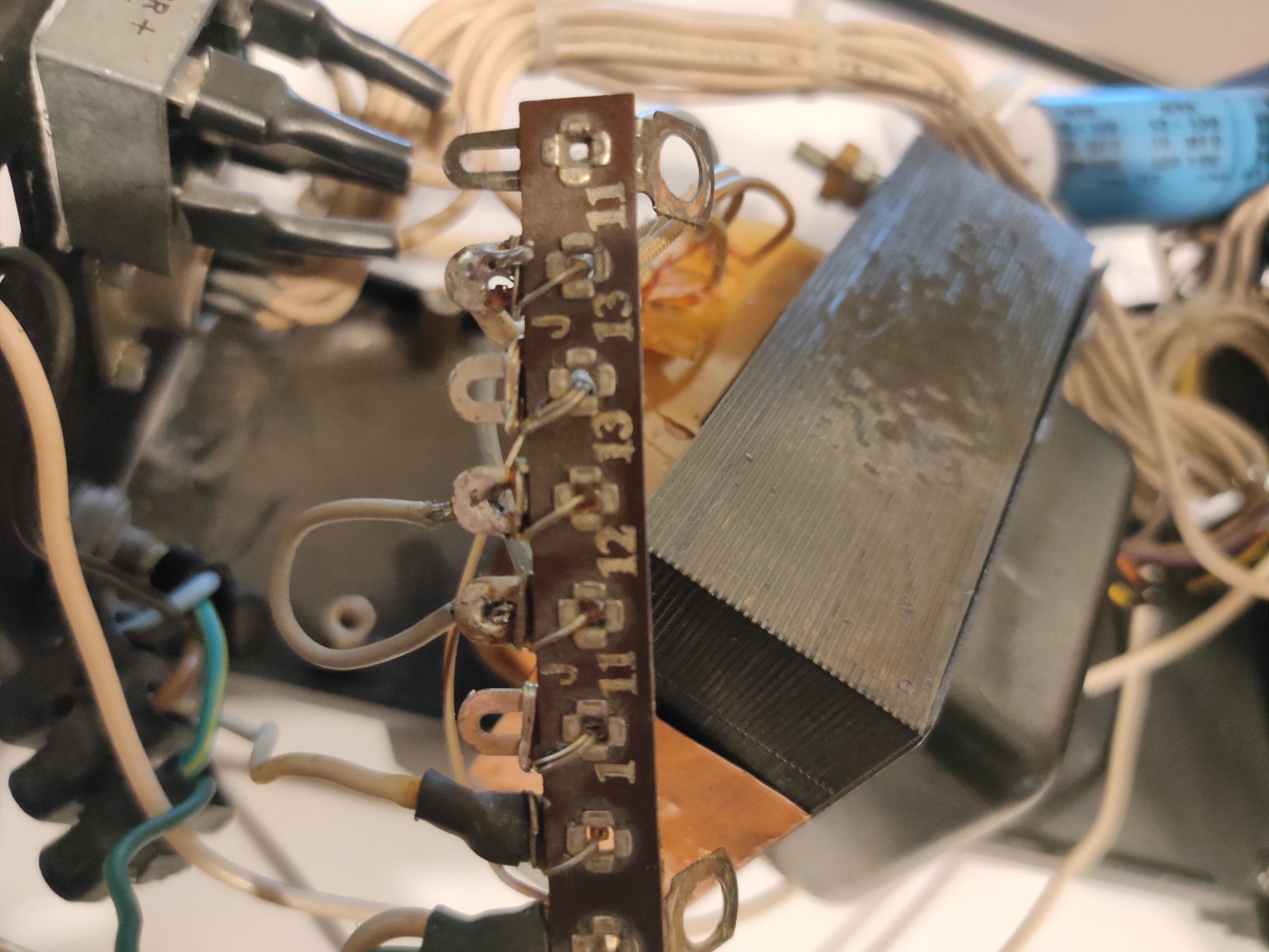

I have the 6CA4 socket out and see the orange and white 6.3v heater leads which have a splice about 4cm after leaving the transformer ( as do all transformer leads). Should I undo the splice and solder a new lead directly to the pad?
Hi violagran,
Okay, if he is neat, my faith is restored.
You should see where the heater traces have been cut on the board. If they aren't, make sure you cut them leaving wide areas of removed copper. Then you can solder the wires directly to the pads.
Someone removed or replaced the transformer and was lazy. Examine the splices to make certain they are soldered. Use heat shrink tubing to insulate them. I hate seeing work like that too.

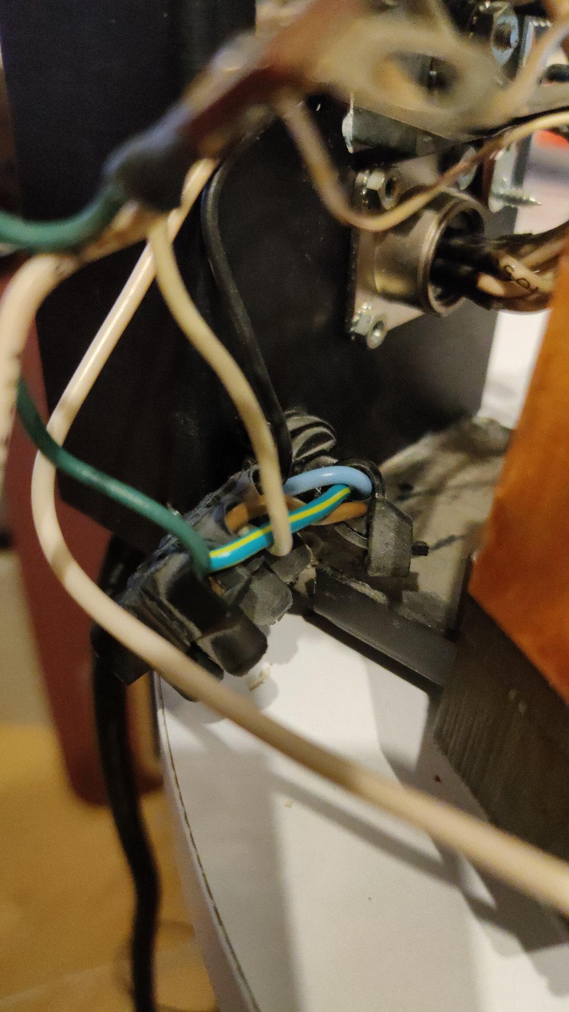

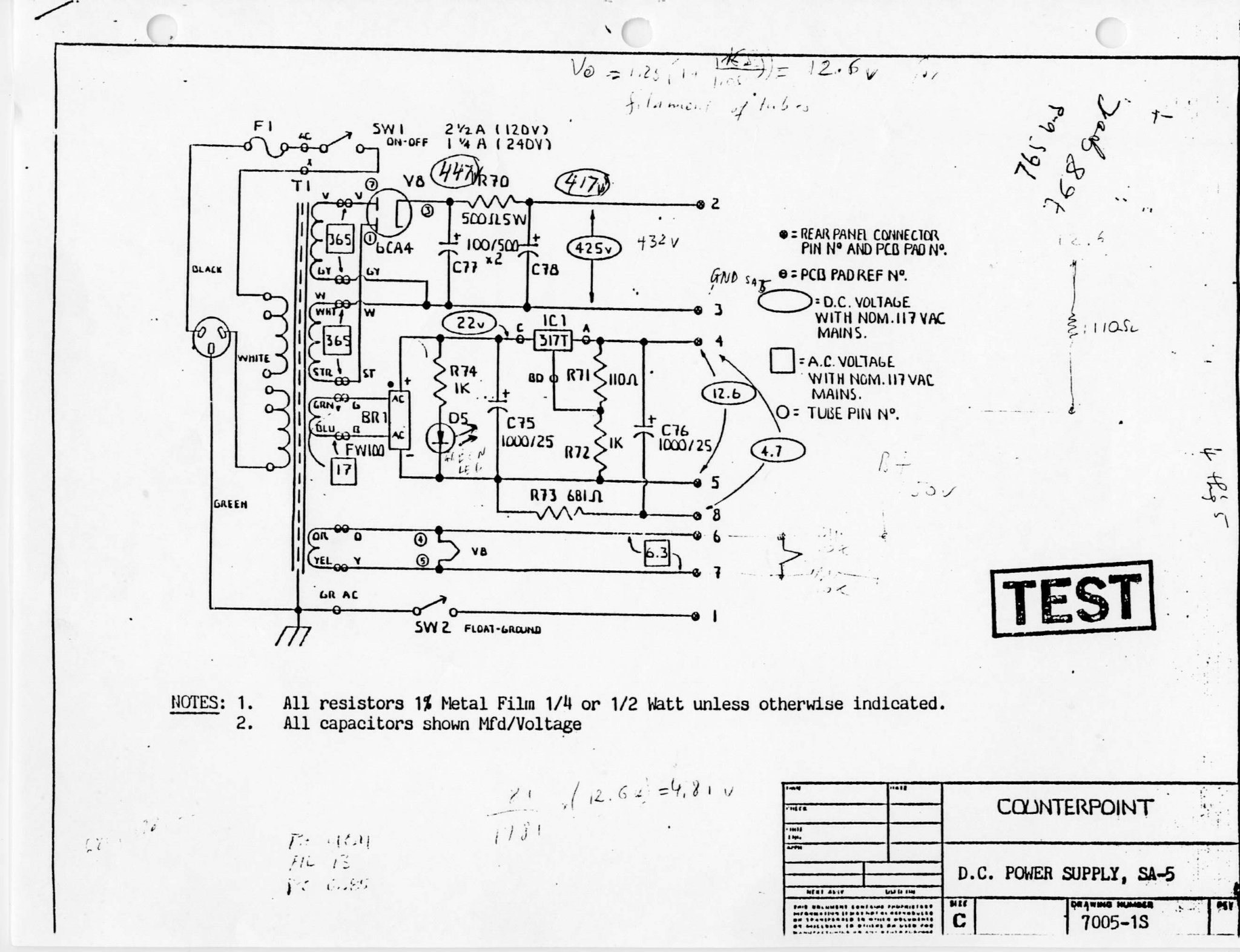

Here I am again over two years later. The technician I left it with in 2020 just gave it back to me and did nothing to it. The problem is the voltage before CR1 which was 97v and not stable. After reading through this thread, Im starting with the power supply to see if it has been wired correctly. The wire connector used to replace the ac cable is the first thing I don´t like. I would also like to ask for help to make sure that the transformer has been wired correctly for 220v. If you are reading this Chris, C77 that you metioned should be 47uF instead of 100uF is two 60uF capacitors in parallel in my unit. Thanks for you offer two years ago but I don´t think I´ll ever be able to get it over to you in Georgetown.
No problem!
Yes, the input filters are far too large. A common design error in the "high end" crowd.
I had to completely redesign the power supplies on all the Counterpoint preamps. So I am not really surprised your tech didn't get anywhere with it. Since the fix is a redesign, I can't tell you how to do it. I have to do it.
Would it at least be possible to help me confirm that the transformer was wired correctly?No problem!

Sorry to bother you with this but it seemed to me that Max29 was able to get his working with the power supply in it´s original form.
No problem,
I'll try to find the transformer wiring for you. - there it is along with additional info for you.
The original supplies can be fixed, obviously they did work. They were not reliable and performance can be greatly improved.
The only thing I won't give away is many hours of work and testing, plus there are changes that are not always easy to accomplish even if I did.
