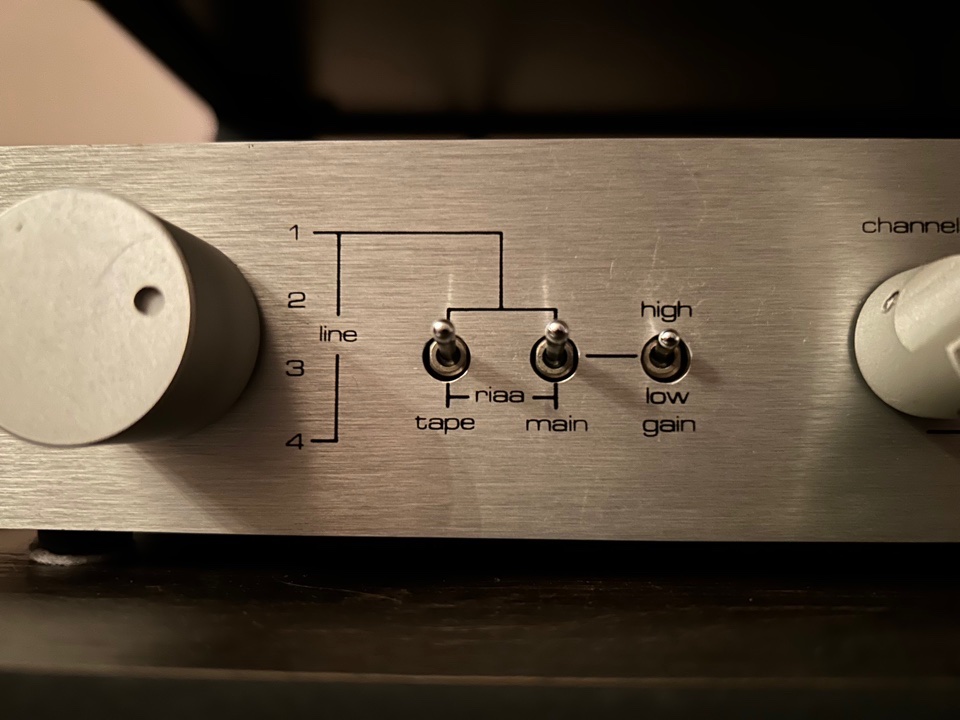

Hi, guys.
Sorry for necroposting, but I have problem now: don’t somebody have Counterpoint SA-5.1 (exactly 5.1, not 5) schematic of switchers part? It was repaired and switchers work wrong now. Thanks all.

Hi Revebrator,
No problem at all.
Those are straight mechanical switches. I don't recall much in the way of logic at all. The repair person must have decided they "knew better" and modified how it works.
I would look for pictures on the internet and correct it that way. The schematic diagrams were broken up into many small (useless) sections, extremely hard to follow. This is one of those cases where I would just look at it (in the flesh) and figure it out.
You didn't say what was wrong with how they were operating.

Hi, anatech,
I try to explain:
1. Use “Main” outputs, second switch in “main” position - no sound, have sound in other switch position;
2. Use 1-4 “Line” inputs and “high/low gain” switch change sound level - I think, phono section shouldn't be driving the “Line” inputs, right?
Schematic will be help, but I cannot find it, have one part only and PSU part. Maybe sombody have it all?
Cheers, Vlad.

Hi Vlad,
It sounds like the phono is shorted to the buss after the selector switch. The main switch is up for high level inputs, down for phono. The tape switch operates as you might expect (I think going from memory).
I would check the traces under the PCB. I bet someone did a cut 'n paste and got it wrong. You wouldn't need a manual for this. The fault will be obvious.
