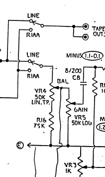

Coupling caps (again)
Still haven't changed these yet 🙄 but had a question or two regarding sizing. I've decided to go with Dynamicaps and am going to do the line stage only at this time. The heat shields on the PCB allow caps up to 18mm or so (maybe 20mm) if I retain them (which Anatek recommended I do). This means 1-2uf caps max if I stay with that.
The C8 / R17 combination concerns me a bit as 8uf Dynamicaps are 1.28" (33mm) in diameter. If I use a 1uf cap, R17 at 100K brings the -3db point to 1.6Hz. All other resistors for the high pass filters throughout the preamp are 1M (R20 in the line and all phono stage). I was told that I could increase R17 (1M is the datasheet max) to perhaps ~500K or so? So, it seems my options are:
Thanks,
Chris
- 1 Use 1uf and leave R17 alone... it will be fine at 1.6Hz
- 2 Use 8uf and leave R17 alone, you don't need the cap shields (or another value? 4uf? other?
- 3 Use 1uf and change R17 to ~500K (or another value)?
Thanks,
Chris

How do I bias the preamp tubes?
And how is the bias voltage derived, a secondary winding and diode,cap,resistor combination?
Hi people,
As you know SA-5.1's has a High & Low Gain MM selector and two sets of phono inputs at the back. In my unit Low Gain input has been disconnected by Mike Elliott for reducing complexity at the signal path. Now things turned out for me to use two tonearms on my turntable and changing interconnects is not working for me. One of the arms will have a 5mV MM cartridge, other will have a LOMC connected to a Counterpoint SA-2 and then to SA-5.1.
Since both will be around 5mV input and the necessary signal path for the high & low gain input is bypassed, I believe that adding a toggle switch to the path will not harm the signal. What do you suggest for this? The original toggle switch is ok to use or a rotary switch would be better. Can you please help me?
Not sure how much removing the Low Gain input "reduces complexity" as it consisted of 2 resistors (loading and 1 parallel) into the High Gain input circuitry :lol:
What toggle switch are you talking about? The High/Low gain toggle switch simply switches a high value resistor (400+K if I recall correctly) in series with the pot (low gain) or shorts it out (high gain), and has nothing to do with the phono stage; it is the line stage that it is affecting (and the phono stage, since it uses the line stage for the rest of its gain).
These SA-5 threads are excellent. I find a little BS in them, but on the whole, they offer great information that can help save the life of these units. I studied these threads before purchasing an SA-5.1 and it made my life much easier. When I do buy a preamp, I live and breath it. I study it inside and out and draw up the schematic if I can't find one. In this case, I found schematics in these threads. Thank you all. Then I look at the preamp and study it to see where it deviates from the schematic. Usually there is a good reason for a deviation, but not always. My SA-5.1 was stock (THANK GOD!). My re-build is complete and I am enjoying the preamp very much. One funny thing that I noticed that NO ONE seems to have mentioned in these threads... the original models have negative bias pots for each of the three amplification stages. The later SA-5.1 omits the pot for the first section of the phono stage. This grid for this stage is no longer provided a negative bias voltage from the negative bias supply. The grid is "grounded" just like it is in the SA-3 preamp. Here is the funny thing, if you have this factory version, take a close look at the tracing and breakout your volt/ohm meter and set it for continuity. What you will find is that the two red WIMA caps that are valued at 1uf 160v are in fact grounded at both ends and essentially not actively in the circuit! Both ends are grounded!!! They are just sitting there like spare tires on a car! I removed mine to make more room for air flow (that never hurts) and so that I can actually put them to use somewhere else. These Mike Elliott products are pretty cool, once you identify the bad flaws in the power supply and fix them.
Hi Chris, yes I'm talking about the High/Low gain toggle switch. My purpose here is to have a 2 channel switch for the phono input (like the 4 channel input of the line stage).
Since ME removed the low gain path, I assume that he also bypassed the toggle switch, and connected the high gain path directly to line stage. By the way I assumed the High/Low gain was located at the phono stage. Then I thought since there is an unused switch, attached to the chassis I can use it for this purpose. It saves me from the pain of drilling a hole to the front faceplate.
Regards
By the way, I opened a Social Group here in diyaudio for users of Counterpoint. Please be a member and share the group:
diyAudio - Counterpoint Users Group
Oh my...
Thank you Chris for clearification. So I must check if the toggle in use or not. When I switch it the sound degrades a bit both in sound level and quality.
Anyway, even if that toggle is not available my quastion is still valid. Do you think adding a switch for two phono inputs degrades the sound noticeably? What kind of switch do you recommend?
Firat.
Firat.
I did replace the gain resistors in mine with Caddock TF020 resistors in pretty much the same value as the Roedersteins that were in there. They are located up by the balance controls. This did lower the noise when in the low gain position, but I never really listened to the preamp at all after I had gotten rid of the heater noise. I can only imagine it made even more difference then.
As to what Mike did when he removed the low gain input, can you share what was done? Did he simply remove R1 (the 32.4K resistor) and the corresponding Ra loading resistor from each channel?
Because the phono is such a low level signal, implementation of the switch would need to be done carefully. First problem is how would you switch out the existing high gain input? Or would you cut the traces or wiring from the existing high gain input and rout the jacks to a switch to control which set of jacks would be used? That is probably the best route. The gain switch is the proper type (DPDT, On-On), but is a PCB mount type so would need to be disconnected. You would need to determine whether you wanted the preamp left in high or low gain and deal with the gain resistors accordingly (leave in for low gain, short out for high gain).
I might be tempted to leave it alone (possibly even restore the high gain MC section), and use an external switch box?
BTW, the stock switches in the preamp are TOCOS. Michael Percy Audio sells them, but the DPDT On-On is no longer available. I would look for a good quality switch with silver contacts if you go down this path. I would place it on the back panel, as close as possible to the phono jacks.
