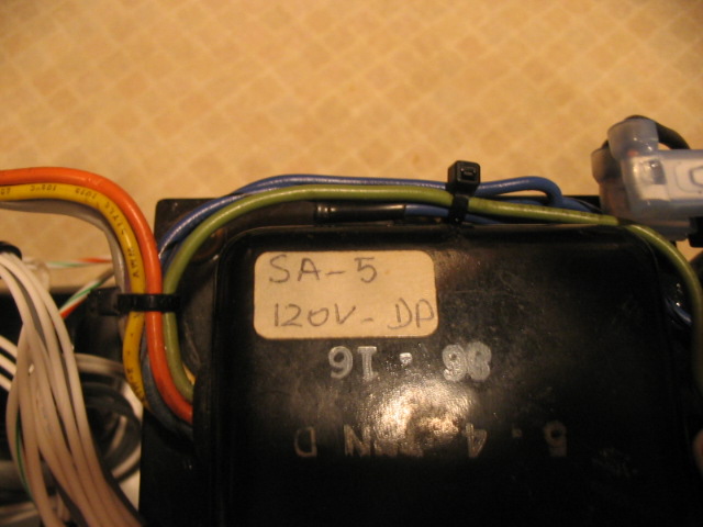

One other thing... the transformer in this has a handwritten sticker on it (see pic) saying SA5. According to the service manual, the transformers between the SA5 and SA5.1 were changed due to the move from 12V to 6V heaters. The sticker makes it look like mine has been replaced by a shop other than Counterpoint. Have you seen things like this come from the factory?
Thanks, and thanks again fro all of your help! It is most appreciated! Happy holidays!
Yes. This is quite normal from the factory.
