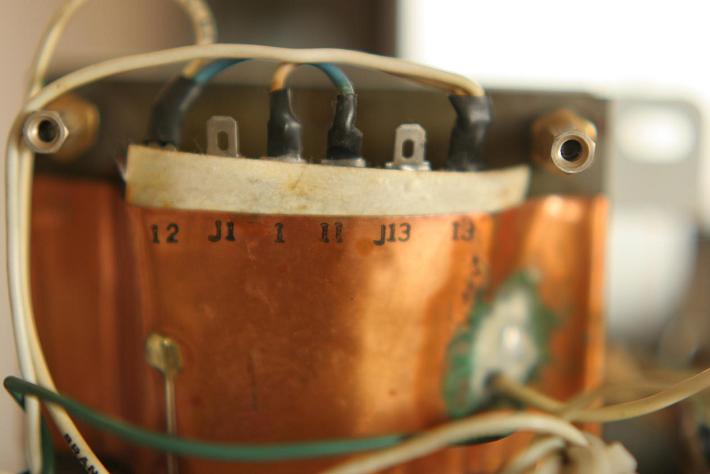

Know if the Trafo can be on 230volts directly... use a varistor now but the trafo has two pins not used so maybe...
url=http://img241.imageshack.us/my.php?image=trafo0077ta.jpg][img=http://img241.imageshack.us/img241/8962/trafo0077ta.th.jpg][/url]
have only 2.5 vdc over the diode cr1-d3
Hi max29,
As for the transformer wiring. This should be a 115 / 230 V transformer. There are two primary windings and they appear to be in parallel in your picture (115V).
I would think, by looking at your picture, that you remove the two jumpers going to 1 and I1 (put them in heat shrink and keep the picture). Then connect via a wire 1 and I1. Before you make the connection, measure the windings for resistance. There should be an open between I2 and I3. The resistance between I1 and I3 should be close to I and I2 value, measure and map out the unused taps. Once they are connected you should have about twice that resistance across the line. I'm just reconfirming everything before you go ahead and complete the job. The phases should be correct. If you power up and it doesn't turn on right away, switch off immediately. Measure your voltages, you may have to change to higher taps on the transformer if the voltage is too high.

have the 230vdc on... anyone need the schematics for having 220v 230v let me know.
J1 is Ac line 220v . 1 is ac line 230/240v. Both having 12 and 13 inter-lined.

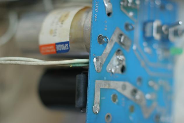

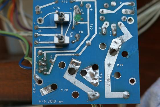

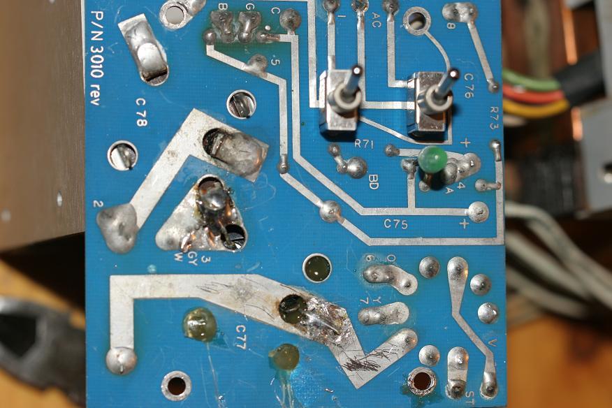

Chris..if there has to be 430vdc has to come from the powerunit so went over there at » 2 « are the two wires starting carrying the 430 to the unit...There has been some strange soldering been going on..as you can see but no 430vdc starting there....

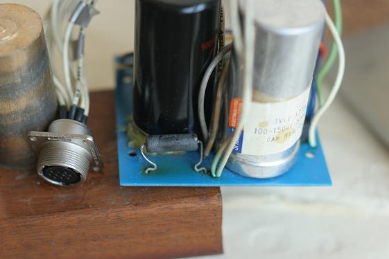

At »» 2 «« see the two wires going to the unit itself there is where i need to have the 430vdc right...so how do i get 430vdc there because it should be coming from the 6ca4 .....is on the line up.

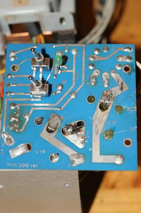

Hi max29,
Well, it looks like there has been heat, never a good sign.

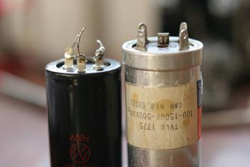

Step 1: Clean up the PCB, R70 (500R 5W) might be bad. The two caps are rated at 100uF 500V. I've always thought the first cap after the rectifier was too high in value. Take it down to 47uF or lower.
Step 2: Remove the tube socket and clean the PCB well. The PCB tends to track and burn. Clean it well and resolder. Clean off all the flux. If you have high voltage dope, use it.
Step 3: Resolder connections. Remove the old solder first and clean the oxides off the leads. Resolder using solder flux if you can. I see a couple bad joints. Check closely the heater leads to both the power supply PCB and the preamp PCB. They are known to go bad and cause much trouble.
The pad marked "2" is the HT lead into the preamp. I can't remember how many leads, but two seems odd. I'll have to see one and check. Look in the preamp for these leads. trace with an ohm meter. Test the 6CA4 while you are at it. It may be damaged. Use a good replacement, Sovteks have been okay.
-Chris
chris ...the R70 is measuring at 602R instead of 500 .... Replace or keep it on.....
the wires - heater leads - are all thinned copper and break easily.... have to start on replacing them later on very brittle..One can imagine they give problems ...
