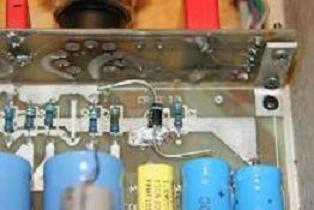

so the diode is a 1n 400 ....
or

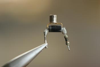

Soldering this off i noticed that one side was on the board the other leg went through the pcb .... Is that correct
The leg with the resistor on went THROUGH the pcb
The other was soldered on the surface only is that mean to be

Hi max29,
CR1 is a 1N400x series diode ??!
It's a 1.6 mA current regulator diode! That explains the resistor! Do Not Apply Power!!
A J506 or J507 from http://www.linearsystems.com/datasheets/J500.pdf would work. I used to buy the original from Electrosonic as a Motorola part, but they may be discontinued. This may be replaced by a constant current source circuit for enhanced performance.
CR1 = <part number not listed!> 1.6 mA, 100 V breakdown.
D3 = 1N5378 91V 5W zener diode. It's there to protect CR1 and normally never conducts.
I'm not exactly sure what you have posted, but please ensure these parts are installed before doing anything else at all.
-Chris

Hi Max29,
There are many examples. The best known may be the LED reference type and the "ring of two" type. Search for "constant current source" at this link. Basically the search bitton at the top right of your page at the top of a thread.
What you currently have in there is a constant current diode (because it has two leads only, I think it's really a FET of some kind.
The proper part looks like a glass diode with a band at one end.
-Chris
-Chris

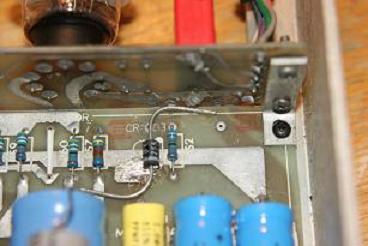

Did not solder the cr1/d3 in yet cause want to be sure
the diode cr1//d3 has the grey ring/band at the side of the tube board meaning current is oNLY flowing from the C51 to the P9 of 6gc5
Is that at yours the same

Hi Max29,
The band on the zener (D3) points towards pin 9 on the 6GC5. Follow the silk screening on the board.
I do not have a PCB layout. I'll have to take a picture of the next one I do. Until then, measure continuity to be sure. Test the current regulator diode as I suggested earlier.
Testing is of much more value to you than anything I can tell you unless I have one of these right in front of me.
