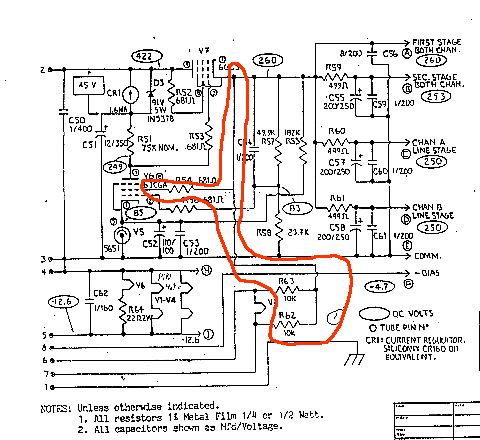

Finally got the guts (and time) to fire this thing up. Nothing exploded or started on fire... seems to be working fine as far as voltages go. I have not Q-doped the front of the PSU board yet. I turned off the lights and looked around and could see no signs of any arcing.
I still have the 2x 49.9K resistors in for R140 / R51. I tried out both of the new 6JC6A tubes that I got. Both drop more voltage across the zener (~80V for the Amperex and 72V for the Raytheon), so I guess the RCA that I had in there (with the 45V drop) must be the weak tube of the lot, and I'll need to revisit resistor values. The output voltage is a bit low (224V) and the voltage on C51 is also lower ~270 something versus 309 before. Voltage dropped across R140 is about 72V, giving ~1.45mA. Can't seem to get to 1.6mA with either of the 1n5303s that I have... I might try one of the CR160s I have, but both of those measured lower than the 1n5303s when I tested them with a 9V battery.
I will go back to the 100K in R51 and 1K in R140 and see how things look. Its looking like the stock 107K in R51 may have been about right for this. I assume that the target of 45V is to place the CRD midpoint in its operating range?
I'll have to try listening to it and see what the hum etc. situation is.
Also, can you explain to me what is going on with the outlined portion of the attached pic? I can't understand why you would want to feed in the AC heater voltage into the DC HV regulation section...
Chris (Pars)

Hi Chris,
They are biasing the heater for the pass tube to B+ so they don't exceed the heater to cathode voltage.
Don't worry too much about the exact output voltage or diode current. They had wide ranges in tolerance so don't loose any sleep over it. It would be nice to get your B+ voltage up a little higher.
Your output voltage is set by the grid to cathode voltage on the 6JC6. So the voltage on the cathode is your reference voltage. The divider formed by R57 and R58 samples the output voltage and applies it to the grid. The tube then compares the two voltages and changes it's conduction to stay in it's "happy steady state". This will change the voltage on the plate and the amount of voltage on the grid of the pass tube 6GC5.
-Chris

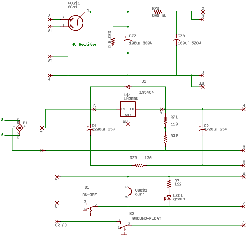

Hi Chris,
Regarding biasing the phone section: I take it from your answer that you just inject a sine wave (1KHz) and adjust for the lowest distortion you can get? Or perhaps I am missing something...
Regarding the heater supply, I threw a scope on it (and a DMM). Ripple is low (somewhat distorted sine wave with no spikes that I could see), 11mVrms on the meter, and looked about that on the scope (x10 probe, 50mV/div, approx. .2-.4 div PP), frequency was 1.6x div @ 5ms/div, so 120Hz.
General question: if I decide to look at the ripple of the B+ on a scope, can I ground the probe since it is not a floating device? Or would I really want to use a differential probe for this? (Sorry, been 20 years plus since I worked as a tech in the semicon industry, and they weren't my scopes then 😀).
Regarding the popping I had mentioned earlier... when I listened to this the other day it seemed to be gone. Maybe I'm chasing my tail here... my speakers have a 92dB sensitivity... power amp is an Odyssey Stratos (150 W/ch). I can hear a hum/very light hiss at ~1' from the tweeter. With my Gilmore Dynamic headphone amp (DIY), which can also double as a pre, it is dead quiet.
At full volume on the high gain setting my wife could not hear it seated ~10' away. Will a tube preamp ever give you dead quiet that close to the tweeter or am I expecting too much? Maybe I'll borrow my brother's Audible Illusions and see how it is.
Also, I attached what I came up with for a PSU schematic for an SA5.1 from ohming mine out.
