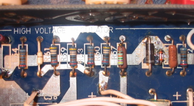

Hi Chris,
I started doing some testing using an R51 of 84K (what I had around, a couple of 43.3K resistors). Here is what I got:
B+: 422V
R51: 84K
Vr51: 121V (ranges from ~119V to 122Vdc)
Vd3: 70V-71Vdc
Ir51: 1.43mA
Vc51: 349Vdc
meter: Protek 608
The voltage across D3 (and the CRD) hits the zener voltage at about 91.3V when the voltages are coming up at power up, and again when either V5 or V6 (can't recall which one it is fires), then drops, once as low as 60V. This seems to climb as the unit has been on, and normally goes up to around 78-80Vdc. The 119V reading corresponds to a reading across D3 of ~80Vdc. The output voltage (C55) seemed fairly steady at around 236Vdc, but I didn't spend much time looking at it (I had changed R57 awhile back from around 50K to 42K to drop a high output voltage of 260Vdc... I'll probably have to redo this once I have this part right).
Something doesn't seem right here, as the CRD current seems to have decreased a bit, and the voltage across the zener is too high and varies more than I would think it should. I changed back to the previous C51 (Nichicon VX 22uf 450V, had put in BlackGate VK 22uf 350V) and retested, but same behavior (the 350V cap had been exposed briefly to ~420V when the zener was fried).
Could tube condition be contributing to this? I do have another set of tubes, condition unknown. The current tubes are pulls I believe that I got from Dennis Boyle at Chimera Labs probably around 2002-2003 timeframe.
I guess I will need to go back up to around 92-100K range and try again. I checked a second CRD and results were the same also (I got tired of cleaning out one of the holes for these, so put in some SIP sockets for the CRD).
Thanks,
Chris

Hi Chris,
Put the original R51 resistors (107K) in, problem still there (Vd3 of around 26Vdc). Replaced V5 and V6 with the old ones (the 6JC6A is marked Counterpoint, so probably the original). Voltages came up to 50-60Vdc range (starts around 50, creeps up as it warms up). It appears that the 6JC6A is the bad one. I'll see what I can find around town (Triode Electronics?). If not, any recommendations for good tube sellers?
I'm still concerned about the voltage creeping up and not staying stable. Is this normal? I took a look at B+ and it stayed stable ~434Vdc.

Hi Chris,
Didn't work on it much tonight. Called Triode, they didn't have any 6JC6As in stock, so I bought a pair off of Ebay (http://cgi.ebay.com/ws/eBayISAPI.dll?ViewItem&item=230046953344&sspagename=ADME:B:AAQ:US:1... I wound up taking the Amperex and the Raytheon 2nd from the right... don't know about brands for this tube).
I went back to my newer tube (the one giving 24-26V drop across the zener) and put a 100K in R51. Looks good (from 40-50Vdc, though I'm starting to mistrust my Mueller leads as I move them around the voltage changes). I'll hopefully get a better idea of which tube is to be trusted when I get the others.
Had a thought regarding the whole setup: since I have the R140(1K) in front of the CCS, and 100K R51 after it, the cap voltage (C51 is ~380V... too high for the BlackGate and hard to find a 10uf film for). The thought struck me that as long as the resistance thru that leg stays the same, why couldn't I swap R140 and R51? It would put the cap voltage down around 250 or so, same current (I think). From what I understand of CCS's, they like driving more of a short than a high impedence anyhow? Or if V6 won't like that, then maybe split the 100K over R140/R51? I didn't try any of this yet cuz
sounded better.

Hi Chris,
Don't swap those resistors. Just bypass a normal electrolytic with a smaller film type if you want. You don't want the capacitance right on the plate of V6, even with a 1K resistor in series.
Don't forget that the B+ to each circuit is filtered again. An expensive film cap for C51 would be wasted.
A true current source doesn't care about it's load unless the load goes open (then voltage compliance comes into play).
So your voltages look good so far, excellent. I still will go over what you have posted before. Short your leads and measure the resistance. Move the leads while watching the resistance reading. Breakage wil normally occur near the connection to an end of a lead.

Hi Chris,
In a series circuit, the total voltage drop between your B+ point and V6 plate doesn't matter. The existance of your capacitor will affect how fast the circuit can react to correct the voltage output of the regulator. I would not change this if I were you. Just use a 10 uF 450V capacitor for C51. You should have around 270 VDC across that capacitor once the regulator has settled down from start up.
You will find the voltage across CR1 will vary a lot with variations in the supply. The voltage drop will vary directly with the raw B+ supply, this is normal. Remember, this part is intended to accept these voltage variations and maintain a constant current. Every other part in the chain is sensitive to the voltage across it to a much greater degree.
It sounds as if you have it working properly. Just install a suitable capacitor for C51.

There is actually about 370-380Vdc across that capacitor (I assume the 270 in your post was a typo). The schematic shows 355 at that point. If I can come up with a 4.7-10uf 400V box film cap like a Wima or Rifa or something like that for this position, that is what I would think I would use. I have a couple of BC MKP383 X2 caps in 2.2uf which are rated at 275Vac (datasheet says 630Vdc) that I might toss in there (1 of them) if you think that is enough capacitance at this point. Digikey also has some AVX polypropylene in a 10uf 525Vdc that would work and fit (a bit pricey at $10 a pop, but the box style would be easier to fit than a Solen or something like that, smaller too).
C50 also has me a bit concerned (Wima MKP10 1uf 400Vdc with 434 Vdc across it... he does seem to like running caps overvoltage). C56 was the one I replaced (was an 8uf 210V Wondercap, replaced with a 1uf 450V Auricap). It still measured at 8uf according to my meter, so must not have minded the 260Vdc too much.
Yeah its getting close... might actually have to try listening to it one of these days and see what things sound like. And bias the tubes...
Chris (Pars)

It was a typo sort of. I figured out what you should have at the plate of V6 and was wrong anyway. You would read the regulated output voltage less the grid - cathode voltage there.There is actually about 370-380Vdc across that capacitor (I assume the 270 in your post was a typo).
Mr Elliot does not do power supplies well. There is normally something wrong somewhere. He also runs those transformers too darn hot. He seems to mess up basic things with regularity.C50 also has me a bit concerned (Wima MKP10 1uf 400Vdc with 434 Vdc across it... he does seem to like running caps overvoltage).
Do that. You only need to install it once.Digikey also has some AVX polypropylene in a 10uf 525Vdc that would work and fit (a bit pricey at $10 a pop, but the box style would be easier to fit than a Solen or something like that, smaller too).
