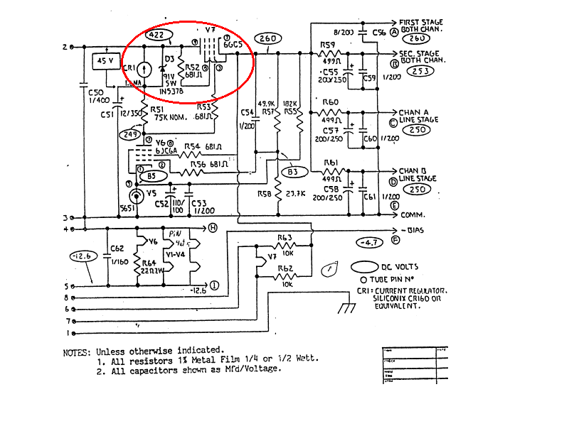

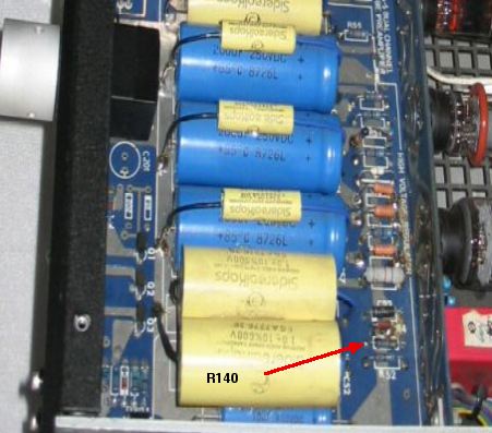

R140?
Well, decided to do a little work to m preamp, and wound up toasting a resistor marked R140. This is in the HV reg section, in between the 422V B+ rail and the CRD/Zener setup (it right next R52 on the schematic). This resistor does not appear in my schematic, and I can't read the value on it now (it measures ~100 ohms, but in a previous post on another forum, I had stated that it was 1K). Having doubts before I replace it, so if anyone has this in a schematic and can tell me what the value is, I'd appreciate it.
I already figured out how I caused it

Chris,
I don't see an R140. I do see R51 which is normally around 75K. It is between V6 plate, R53 and the junction of C50, CR1 and D3. Adjust it's value to get around 45 VDC across CR1 and D3.
That's all I can think of right now.

Already have an R51, and yeah, it is around 75K IIRC. This is a silkscreened/marked official resistor, second resistor board from the right in that row by the vertical board. Must be part of the 5.1 upgrade, as my schematics for the most part are 5.
Hi Chris,
Send me the image please.
I may have to see another to amend my notes and give you your answer.

What image? I ohmed the SA5.1 version that I drew in the previous post out from what is actually there. Mine is an SA5.1. SInce the board changed some from the SA5 to the SA5.1, I would guess that all SA5.1s have this. Here is a pic I had of someone else's SA5.1 showing the location of R140.anatech said:Hi Chris,

Hi Chris,
If the resistor is installed, it is there to protect CR3 (which protects CR1). CR1 is a current regulator diode with a mav aoltage of around 100V, D3 is a 91V zener diode to prevent an overvoltage condition. The intended voltage across CR1 is 45 VDC. This is consistance in all his designs that use that current regulatr diode. In this case it appears as though the 1K resistor was installed in case D3 conducts. In normal operation there is around 1.6 mA flowing in that circuit. A 1.4 w resistor is plenty but may not have a high enough voltage rating (we want it to go open in a fault).
I don't see a problem, but have never seen a unit with this part. It's easy to understand the purpose though.

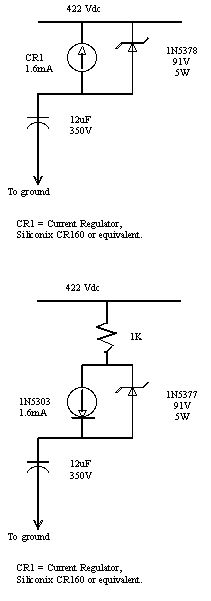

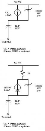

Hi Chris,
Yes, PRR went thru the circuit and described what was going on (headwize link).
He suggested replacing the CRD and the zener with a 27K-33K resistor (45V/1.6mA). I know Mike Elliot talks about replacing the "last vestitge of solid state sound" in his power supply upgrade, and figured it must be this CRD that he is talking about (they are just FETs).
PRR also could not understand why C56 (feeding the first stage) did not incorporate the 499 ohm resistor as the other feeds do (RC filtering), and suggested that I might want to try that. I've often wondered why C56 is so much smaller than C55, 57 and 58, but I guess he had his reasons (maybe too much capacitance with all 4 of them at 200uF?).
Well, I guess I will assume that I measured R140 correctly and put a 1K in (it was previously a Roderstein Resista which is 1/2 watt... I have some Dale RN60s or BC SMF25s, so will probably use the Dale).

Hi Chris,
Don't pay the $75. You will get an SA-5 manual with possibly and update. At least it's not $90 any more.
The current reg. diode isolates the supply from the diode to some extend. Installing a resistor instead is simply not very intelligent. You could easily build your own CCS, but why? My own experiments indicate that using a CCS is hugely beneficial. Leave it in.
BTW, M.E always uses excessive capacitance. The quality of the 1K resistor will have little to no effect due to the high impedance of that circuit.

I put the 1K in and went from there. It fired up fine (no flames) and the voltage at C55 measured fine (~240Vdc). However, I noticed a smell (like hot electric heat type of smell) and noted that V7 was running awfully hot. After things bled down after shutting it off, only the tube felt hot (resistors, etc. were fine). I fired it back up tonight, and still the same. Poking around a bit (still kinda a wuss with HV), I noticed that there was very little voltage drop across the zener (0.2V), and the voltage across C51 is ~420Vdc. I assumed that if the CRD failed it would go open and the C55 voltage would not come up... apparently not. It was only on a couple of minutes each time.anatech said:Hi Chris,

Hi Chris,
Normally the zener will short when there is a problem, protecting the constant current diode. Remove the zener and measure for a short. I suspect a new zener will correct the situation. Now I understand why the 1 K burned out (and the zener). You can install a higher wattage zener. Do not increase the capacitance of C51. It's more than large enough. A 10 uF poly type cap would be an improvement due to it's improved HF response.
It is possible to improve the circuit with an LED biased current source, but the increase in performance probably will not help much. There is also filtering after the regulator. So there is no point unless the current regulator is gone and you can't get a substitute part.

I replaced both the zener and the crd. Seems to work. Still getting kinda high voltage on C51 to ground (~390Vdc). All the other voltages I checked were on the mark (84V on C52, 244Vdc on C55... I had already replaced R57 with ~42K to lower the voltage a bit.. may go back up to 47K or so). The zener has 24-26Vdc across it. C51 is a 22uf 350V Black Gate VK (already had it, so tossed it in). I might pick up something like a 10uf Wima MKP10 in 400V next time I order from TAW.anatech said:Hi Chris,

Hi Chris,
You should have 45 VDC across your current regulator diode. The 1N5303 is the proper part. Ignore whatever is dropped across the resistor, it should be about 1.6 VDC for a 1 K value. The other resistor is a "fudge factor". It's only used to burn up extra voltage.

Hi Chris,
oops, math error on the 1K drop.
I pulled the CRD and tested both it and the old one on a breadboard with a 1K resistor and a 9V battery. 1.65 and 1.67 mA respectively, so they both appear to be good. I took a look at R51 which is actually two resistors soldered in series. The measured 107K, not quite the nominal 75K as indicated in the schematic. However, they are Rodersteins, and are nicely soldered together, so I'm not sure it didn't come from the factory that way?
From looking at the circuit, it would appear that reducing this value would also reduce what I am seeing on C51, as it should work more or less like a voltage divider. I'm not sure if this would increase the voltage dropped across the zener/CRD. Have you seen the value of R51 played around with like this Chris? I assume it is to regulate the current going into V6 and V7. but I'm a newbie when it comes to tube circuits...
I'm certain that the zener and the CRD were in correctly (cathode stripe on zener towards mark and towards B+... crd in the opposite of this, as a normal diode would be.

Hi Chris,
The quality (type and construction) of that resistor means very little in that circuit position. It's a very high impedance circuit with a good quality cap to ground (bye, bye noise). Use a normal carbon film or, my favorite, metal oxide.
The amount of voltage dropped across that resistor will vary directly as the resistance changes. It has nothing to do with any tubes. It only determines how much voltage is dropped across the current diode. Start at 75 K and figure out what you need to get around 45 VDC across the diode. Most I see are 75 K in value.
