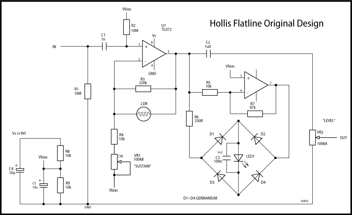

If anyone is still reading, I have questions I hope aren't too naive about the original circuit. I'm having difficulty understanding how a guitar's "300mV (rms, peak, p-p?)' input signal can break-over or overcome the 2x Si diodes plus the 750mV Vref on the positive swing by itself. And if 300mV means peak then that's a hot pickup a la hum-bucker type vs. single coil. And, what of the negative input swing..? How does that work.? Btw, I'm always looking for empirical test results for the actual incremental impedance change of a 12ax7 grid driven beyond 0Vgs. If you know of such a study please reply with a link.

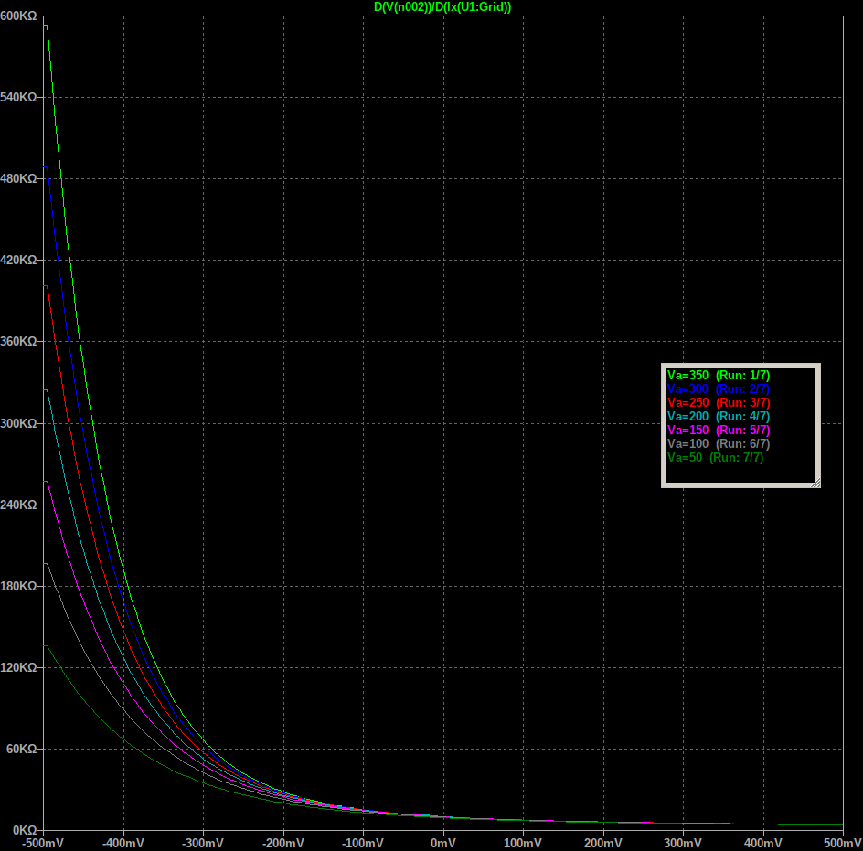

I don't have direct measurements of a real tube, but I've attached some data generated using Adrian Immler's 12AX7.TSr4 SPICE model. The model is fitted to measured grid current data and should be reasonably accurate. The grid resistance is about 10kΩ @ Vgk=0V and about 4.2kΩ @ Vgk=0.5V.
Gnobuddy asked what I meant by "original" circuit.
That circuit is an old idea of mine. The circuit in this post should work better. I still haven't tried building it (working on other projects right now), but the simulations seem promising.
Yes, I wish that >0V portion was expanded.
The grid resistance continues to drop. Roughly 3kΩ@1V, 1.8kΩ@2.5V, and 1.2kΩ@5V. I can't imagine you'd ever see more than 2-3V Vgk in a guitar amp. At some point the current will destroy the control grid.
...The grid resistance is about 10kΩ @ Vgk=0V and about 4.2kΩ @ Vgk=0.5V. <snip>
...The grid resistance continues to drop. Roughly 3kΩ@1V, 1.8kΩ@2.5V, and 1.2kΩ@5V.
Very interesting data!
I've suspected for some time that small amounts of grid current flow, in conjunction with the high output resistance of an electric guitar, might help to "squash" large positive-going signal transients at the start of each guitar note.
(This in turn leading to audibly less harshness than, say, an op-amp input stage in a solid-state guitar amplifier, which clips hard on input transients, rather than gently peak-limiting them.)
In a typical vintage Fender tube amp, quiescent Vgk is only around -1.4 volts. An e-guitar is perfectly capable of spitting out, for example, +/- 1.2 volt peaks, which would bring Vgk down to maybe 200 mV at the positive peaks.
The data you posted shows input resistance of a half-12AX7 has dropped to around 30 kilo ohms at that point.
This is more than low enough to apply some signal limiting to a guitar signal emerging from, say, a 500k volume pot set to half-resistance, which has a Thevenin source resistance of 125k.

I read that the original Perkin-Elmer" VTL5C3 was the ticket for the Hollis limiter. Good range, good attack and decay, etc. So I bought some current-issue VTL5C3. What a joke. On my bench with overhead fluorescent lighting they measured several meg-ohms. That was not right. Something told me to kill the ambient light. The DVM then pinned @100Mohms. The casing and potting used is translucent. Sold everywhere. Terrible. I painted them with black acrylic paint containing lampblack pigmentation. All fixed. In any case, you are in for an adventure as to how to linearize the knee of that LED=>CdS response. It's like a switch - if that's what you want. The thing will begin "turn on" in the low uA or sub-uA range. I've mused about how the very original Perkin-Elmer LDR linear coupler may have used grain-of-rice bulbs vs. LED.

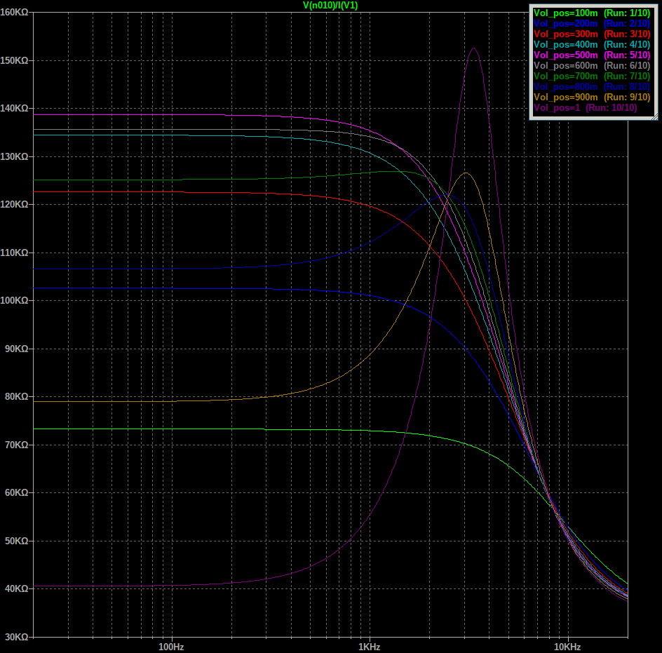

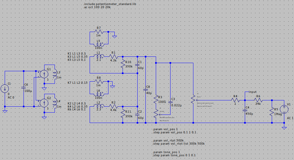

Here's some more data that might be of some use: The simulated source impedance of a PAF-ish humbucker equipped guitar + cable + input grid stopper and grid leak. In other words, the source impedance as seen by the control grid of the input stage.
Y-axis is the source impedance as seen by the control grid of a typical guitar amp input stage when using a medium-output humbucker guitar connected with around 10-15ft of cable (450pF cable capacitance). Each line is with a different guitar volume setting as indicated by the legend (apologies to colorblind individuals).

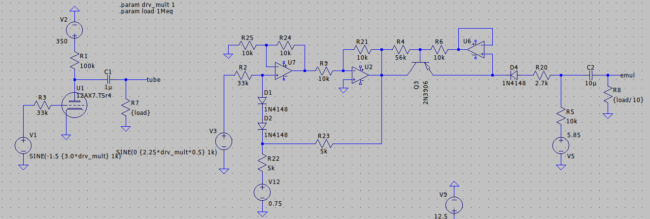

Here's a triode emulator I've been working on using opamps, BJTs, and diodes. Seems to work pretty well, but will obviously require scaling the input if you want to overdrive it a lot. It clips correctly into different loads and the harmonic distortion spectrum is pretty darn similar to the tube model over a wide range of input levels. The 12AX7 model is from Adrian Immler.
The time domain plots show the clipping behavior with 1Meg, 100k, and 10k loads. The frequency domain plots show the harmonic spectrum with different input voltages (peak-to-center into the tube, 1Meg load): 300mV, 1V, 3V, and 30V.
Make C2 very small and see what happens. 0.02 or 0.002uF.

VTL5C3...pinned @100Mohms..The casing and potting used is translucent.
Wow. So much for quality control or pride in the products you sell. 🙄
...the knee of that LED=>CdS response...
Interestingly enough, I quickly realized I couldn't really design my circuit without knowing more about the behaviour of the optocoupler, so I spent a few hours measuring LED current and LDR resistance from 2uA to 10mA.
It took a long time because the LDR took quite a while to settle at the low-current end of the curve. Tens of seconds, even.
Then I plotted the data on a log-log graph and looked at it. To a first crude approximation, it's not too far from a straight line when plotted on a log-log graph.
That gave me an idea for a pretty simple equation to fit the data - the resistance looked to be nearly inversely proportional to the LED current!
That idea didn't work out quite right, but it wasn't terribly far off either. Tweaking it a little resulted in a surprisingly simple equation that matches the measured current/resistance data absurdly well over the entire current range (2 uA to 10 mA).
The equation only matches the steady-state resistance, after the LDR has had all the time it needs to settle. So it's not a full mathematical model - it doesn't include the time dependency of the LDR resistance.
Still, the equation was simple enough to let me very easily create an LTSpice model for the optocoupler, and that let me get on with designing the rest of the circuit. Mostly, I needed to know what range of LED currents the circuit would need to produce, and what range of resistance I could expect as a result.
All that data is on my PC at work, so I can't post the optocoupler fit equation or LTSpice model now. I'll try and remember to post it next week. I'm not feeling too well, and won't be going to work today, which is why I'm up at 4 AM. So it'll have to wait until I'm back at work next week.
