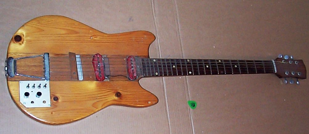

When I first got interested in electric guitars, I was still a student with no money. I built my own electric guitar (pic attached) using whatever scrap materials I could scrounge or buy. I leveled the frets with a whetstone, but had no crowning tool, so the guitar was hard to play. I made the pickups from scraps of ceramic magnet from a broken loudspeaker, and wire I got by taking apart a broken relay. They worked, but were very low output. The lightweight body was mostly pine (from an orange crate!), the lightweight bridge I sawed and filed from a scrap of aluminum u-channel. The guitar had very little sustain, probably because of the light parts.
I played that guitar for several poverty-stricken student years. It got me through those initial stages as a beginner guitarist. I learned to find chords and play scales over the entire neck of the guitar, and I could play simple solo parts that didn't require lots of sustain. But eventually the guitar's limitations were holding me back.
And that was the point at which I finally bought a budget Squier Strat, which got me through another couple of years of musical development.
