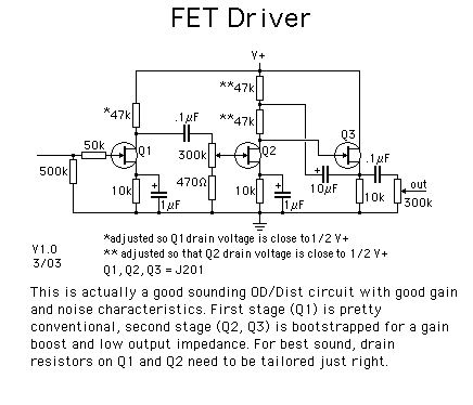

I found out that Azevedo actually has a website, with a page about solid state tube emulation featuring the 2BJTE circuit: https://nexp.pt/tube_emulation.html
He apparently was inspired by the work of Tim Escobedo, and even has a 'tribute' page on his site with, among many other circuits, this 'FET driver':
Looks a lot like the idea I mentioned in my previous post... I am going to play with this.

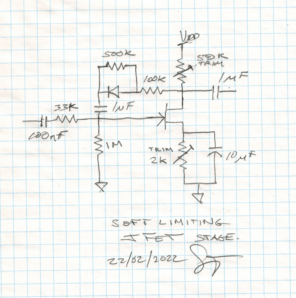

I am curious, could you post a schematic?This is similar to what I did on my Jfet boost with soft limiter using a single diode but with series and parallel resistors.
Sure thing.. it`s a work in progress as mentioned. CheersI am curious, could you post a schematic?

Just a little update on the soft limiting Jfet booster, I built one for a friend who plays bass. This time I put it into a bigger box and there's a switch to go between cleanish JFET boost only, and 1 or 2 diode drops limiting. I am not using the single diode in one direction, rather one or two pairs of diodes in reverse parallel. The JFET alone has just enough asymmetric distortion to get a warmed up sound that still perceived as "clean". Switching in 2 diode pairs gives a nice amount of grit, which on a solid state Ampeg bass amp sounded good. With a single diode pair, this starts to sound like heavy overdriven bass, almost into a compressed fuzz territory. The 500 K in the NFB was replaced with an adjustable "gain" pot, so when the diode limiting is on, you can vary the amount of grit/distortion.
The booster stage I posted earlier is best to be driven from a buffer, I used a source follower JFET stage. It will work without it, but the input impedance with the inverting NFB circuit drops quite a lot.
