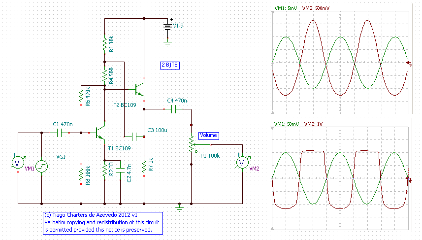

Take a listen to the attached MP3 file, and see what you think. (Just remove the ".pdf" at the end of the file name; it's really a short MP3 clip, not a PDF file.)
Moderators: the file is a few seconds of crude guitar playing, not a copyrighted song or other audio performance.
The guitar playing in the clip is - ummm - not so good. But set aside the playing, and listen to the sound. What do you think of the tone (timbre) of the sound?

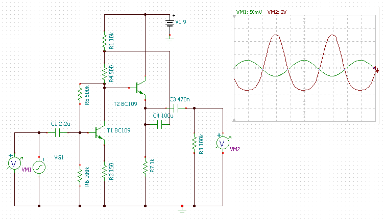

This is supposedly a sound sample created by a very simple two-transistor circuit, created by one Tiago Charters de Azevedo in 2012.
Azevedo called his circuit "2BJTE" for "BJT Tube Emulation with 2 transistors".
Azevedo's Web presence seems to have disappeared in the ten years since 2012, along with his schematic and sound clip. But I have a copy of both on my PC.
The "2BJTE" circuit has many bizarre component values, indicating a "design by plugging parts into the breadboard until it sounds good" approach was taken.
There is an additional complication. Azevedo said he had obtained this sound sample by plugging his guitar into a well-known Boss overdrive pedal, the output of which he connected to his 2BJTE circuit. Azevedo's post said that the Boss was set to provide only clean gain, and no overdrive.
If that was correct, then the sound sample really does represent only the sound of the 2BJTE circuit. But it almost sounds too good to be true to my ears...two transistors, no EQ, and what I hear as quite a rich and dynamic overdriven sound.
It's possible that part or all of the rich overdrive tone came from the Boss pedal, and not Azevedo's circuit. But it's so simple a circuit that it's probably worth building and testing, just to find out.
If anyone is interested, I'll post Azevedo's schematic. Let me know in your posts.

I think this may be the circuit:
From this page.
@Gnobuddy, please confirm or deny :)
