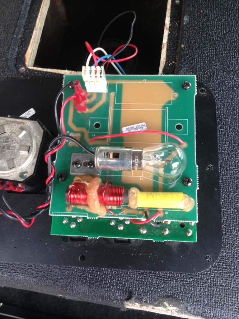

In US/Can parts stores, 1156 is the old-old standard "brake light", 12.7V 26.9W (2.1A)My go-to protection bulb is a car rear light 12V 15W bulb
1157 has one filament like a '56 and one "running light" at about a third the current, 8.3W, needs a double-contact socket you only find in car-parts stores.
1141 is 18.4W 12.8V 1.44A.
In their loud (for the time) 2.7" Sentry (IV??) speaker, E-V used a 28V aircraft bulb. You could see it flashing through the grille.
Get them while you can. And avoid LED "equivalents".
From before I could drive until last year I had a stash of 1156/1157 always at hand. Last year I realized that not even the 1993 Chevy pickup (RIP) and not the 1996 or 2002 Hondas used the 115_ series lamps; only the 1991 Miata has big bayonet lamps. Later cars have the baseless "wedge" lamps which tend to age badly (rusted to the socket so bad you have to get a whole socket assembly for the specific model).
Car headlights ran 35W-55W. 35W is more common on LO, but tonight two guys followed me with 55++W lights.
I checked into that one, current is too high...(2A instead of the 1A that I guessed, and Fahey confirmed).In US/Can parts stores, 1156 is the old-old standard "brake light", 12.7V 26.9W (2.1A)
I looked at that datasheet, too. IIRC, long ago and far away, I soldered wires directly to the three wire leads emerging from an 1157 bulb. I seem to remember there was a flat rectangular plastic base, with the wire leads wrapped once around it, each in their own individual groove in the plastic.1157 has one filament like a '56 and one "running light" at about a third the current, 8.3W, needs a double-contact socket you only find in car-parts stores.
But once again the current limit isn't quite right, though the 8.3 W filament would work (maybe too conservative, but that's better than blown tweeters.)
I missed that one. 1.44A might be a tad high - what if I parallel a suitable power resistor across the tweeter terminals, so the voice coil only sees 1 amp when 1.44 amp total current flows? (i.e. pick a resistor that flows 0.44 A when there's one amp through the tweeter.)1141 is 18.4W 12.8V 1.44A.
Exactly! The idea (to try and use a dome tweeter in a little 30W - 40W personal monitor/tiny PA) only occurred to me a few days ago. When I started looking for incandescent auto bulbs, I found they are already mostly extinct in the auto parts stores, Amazon, et cetera.Get them while you can. And avoid LED "equivalents".

I was talking the humble 12V 15W (there might be a 12V 12W version) "position light" (we call it that way) ,maybe US/UK "tail light" which neither signals something special (such as braking) nor illuminates road ahead for driver, simply tells the World "I am here".
Typically bayonet mount.
FWIW this is the actual crossover plate in a "fridge" type Ampeg cabinet, showing said lamp in all its glory:

Last night I did some more searching, and found some 12V, 12W bulbs sold for RVs, exactly for the purpose you describe. Side marker lights, etc. I think these may be the ones you recommended, or very similar: https://www.lightbulbs.com/product/westinghouse-03726I was talking the humble 12V 15W (there might be a 12V 12W version) "position light" (we call it that way) ,maybe US/UK "tail light" which neither signals something special (such as braking) nor illuminates road ahead for driver, simply tells the World "I am here".
12V/12W is the "holy grail" 1-amp bulb I've been looking for. They should limit an 8-ohm tweeter to nominally 8 watts (with 20 volts RMS applied to the series bulb+tweeter).
I also found some 12V, 10W halogen bulbs with wire leads on Amazon. Nominally 0.83 amperes, or about 6 watts into an 8 ohm speaker (when 18.7 volts RMS is applied - close to the maximum square-wave output signal from the amplifier I plan to use).
With any luck I'll be able to solder to those bare wire leads. I ordered a few to try.
