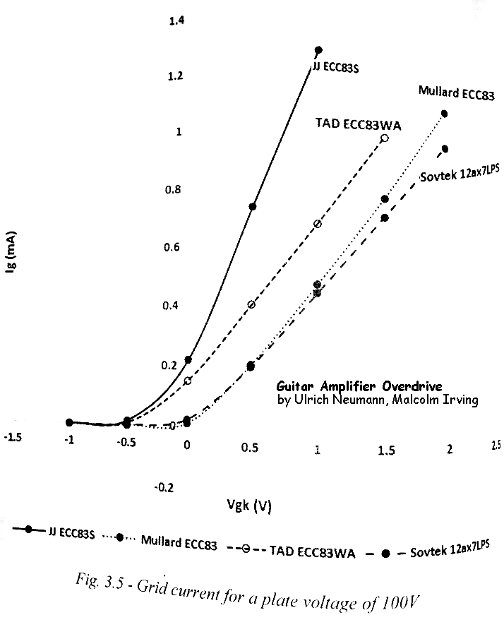

At some point the current will destroy the control grid.
True..... on a good test-bench. Never from a guitar pickup, or even a battery-size boost pedal. 1.2kΩ@5V is 6mW, inside a 1W plate. Even if the flimsy grid is good for 1/10th, even 1/100th, the power in the plate, it will survive.
Here's a snippet of teh Ulrich Neumann, Malcolm Irving data.

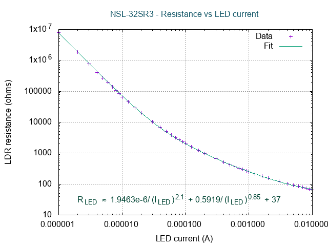

Interestingly enough, I quickly realized I couldn't really design my circuit without knowing more about the behaviour of the optocoupler, so I spent a few hours measuring LED current and LDR resistance from 2uA to 10mA.
It took a long time because the LDR took quite a while to settle at the low-current end of the curve. Tens of seconds, even.
Then I plotted the data on a log-log graph and looked at it. To a first crude approximation, it's not too far from a straight line when plotted on a log-log graph.
That gave me an idea for a pretty simple equation to fit the data - the resistance looked to be nearly inversely proportional to the LED current!
That idea didn't work out quite right, but it wasn't terribly far off either. Tweaking it a little resulted in a surprisingly simple equation that matches the measured current/resistance data absurdly well over the entire current range (2 uA to 10 mA).
The equation only matches the steady-state resistance, after the LDR has had all the time it needs to settle. So it's not a full mathematical model - it doesn't include the time dependency of the LDR resistance.
Still, the equation was simple enough to let me very easily create an LTSpice model for the optocoupler, and that let me get on with designing the rest of the circuit. Mostly, I needed to know what range of LED currents the circuit would need to produce, and what range of resistance I could expect as a result.
All that data is on my PC at work, so I can't post the optocoupler fit equation or LTSpice model now. I'll try and remember to post it next week. I'm not feeling too well, and won't be going to work today, which is why I'm up at 4 AM. So it'll have to wait until I'm back at work next week.

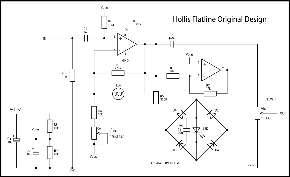

I don't want to reveal just how many hours I've spent on the bench over many, many days trying to make friends with the opto-CdS. Some days I have to walk away, frustrated. My approach has become a "try this" or "try that". I'm still just placing DC voltages across two representative Ge diodes, the LDR LED, external components outside the Ge bridge, components inside the Ge bridge (series and/or parallel), etc. KISS. I don't use the extra amp b/c mine is rail-to-rail. The TL072 isn't. IMO the Hollis circuit can't do anything but provide a brick wall limiter. I see no chance for a linear region especially with that x4.7 "bridging" amp. Every move the main amp makes is differentially quintupled. How does that do anything special re a graceful entry into limiting?
I would love to see your mathematical implementation. of taming the LED-LDR. I have not noticed the long recovery time at low currents. I stay away from the uA region by shunting the LDR with like 10K. Make that thing work a bit.
Wow. Over 200uA of grid current at Vgk=0 for some of those tubes.
It looks like Vgk=(-0.5V) is the threshold above which significant amounts of grid current start to flow.
In a typical 12AX7 stage biased to roughly Vgk=(-1.4V), that means an input signal with a peak amplitude of 1V or more will start to feel the impact of grid current flow.
If the signal peaks at 1.4 volts unloaded, then it will "feel" up to 200 uA of loading. Enough to squash anything coming from a reasonably high source impedance. Even the naked 8k DC resistance of a typical guitar pickup, never mind the inductive reactance or volume control Thevenin impedance.
-Gnobuddy
Agreed. Too much open loop gain, too much feedback. Brick-wall limiting is exactly what you'll get.
I've tried a couple of affordable guitar compressor pedals, and always found that they took away too much playing "feel" (dynamics), for that very reason. They just completely squash signal dynamics. Maybe that's why they've never really become as popular as the typical go-to FX pedals every electric guitarist owns.
I would love to see your mathematical implementation of taming the LED-LDR.
I plotted LDR resistance vs LED current on a log-log graph, and found that it wasn't too far off from a straight line, over some three or four orders of magnitude.
If you look at it more closely there is definitely some slight curvature to it, but even the crude straight-line fit* isn't terrible, given the enormous manufacturing tolerances of devices like this.
*Straight line on a log-log plot, meaning you're actually looking at a power-law fit function: resistance is proportional to LED current raised to some (negative) power.
That was my starting point. I tweaked it a bit to accommodate the observed slight curvature. I'll post the exact fit function next week, once I'm back at work. (Fighting with COVID-like symptoms now. Yuck.)
I tried that too, in an LTSpice sim of the circuit I want to build.
I'm not sure if the parallel resistor is a good idea or not. It adds a kink, a dead-band, to the optocoupler characteristics. Resistance stays very high until there's enough voltage drop across the 10k to light the LED, then resistance plunges abruptly.
-Gnobuddy

...mathematical implementation. of taming the LED-LDR...
Here is a quick overview. I'm attaching four files that should make it all clear.
1) The manufacturer datasheet for the NSL-32SR3 includes a tiny R vs I_LED graph that gives an idea of the transfer function, but it's so small and lacking in detail that it's of limited use. Still, you can see that the line is only gently curved, so a power law fit (with a negative exponent) looks plausible.
2) I measured the actual resistance of one of these optocouplers for LED currents from 1 uA to 10 mA. I plotted the data with Gnuplot, started with a likely fit equation, and tweaked it until it fitted. It fits really, really well - data and fit overlap almost perfectly over four orders of magnitude!
The actual equation is printed on the graph. As you can see, it is piecewise linear, consisting of two power-law segments, and a constant.
The fit equation is for resistance in ohms, and LED current in amperes.
Resistance in kilo ohms and current in mA would be more human-readable, but I wanted to make an LTSpice model of the optocoupler using this fit equation - and LTSpice "thinks" in ohms and amperes, so that's what the equation needed to use.
3) The third file is an LTSpice model of a red LED. Years ago, I tweaked it to match the voltage drop of some random red LED I had. Drop it in the same folder as the LTSpice model of the optocoupler itself (coming up next...)
4) The fourth file shows how simple it is to use this fit equation to create an LTSPice model of an NSL-32SR3 optocoupler. I simply plunked down a red LED and a resistor, then right-clicked on the resistor and made its value dependent on the LED current, using the fit equation from step 2.
The LED and current-dependent resistor together now simulate the optocoupler.
If you open up this file with LTSpice, you can run a simulation showing how LED current affects the output voltage from a potential divider made using the optocoupler LDR and a 1-ohm resistor.
You can, of course, drag and drop the LED and LED-current-dependent resistor onto your own LTSpice simulations.
Time dependency of the LDR resistance is NOT simulated. In real life, the LDR resistance changes slowly, taking up to a minute to settle at very low LED currents.
In the simulation, the LDR assumes its final value instantaneously. This means you cannot simulate a compressors attack and decay time constants very well using this LTSpice simulation. Sorry!
I hope this is useful to someone!
-Gnobuddy

I don't even know what a log-log graph shows you or buys you - in this case.
Sorry, I completely misunderstood - I thought you were an EE, and so I made no attempt to explain that rather technical post.
I can explain in non-math terms. The almost-straight log-log graph tells us that the optocoupler responds to ratios, rather than differences.
A linear response would mean that an increase of "x" milliamps would produce a reduction of "y" ohms. For example, every milliamp increase in LED current would produce, say, a 10 kilo-ohm reduction in resistance.
But that's not what the optocoupler does. Not even close.
What it actually does is this: at low LED currents (below, say, 20 uA), every time you double the current, the resistance drops to approximately one-fourth of its previous value.
Another way to say that: if the LED current increases by 6 dB, the LDR resistance drops by 12 dB.
As the LED current gets bigger, the resistance doesn't drop as fast for every doubling. By the time you get to roughly 200 uA and more, the resistance only halves for every doubling of LED current. That means, for LED currents above roughly 200 uA, a 6 dB increase in LED current only causes about a 6 dB drop in LDR resistance. (Not a 12 dB drop.)
At currents in between 20 uA and 200 uS, response is somewhere in between.
And, you didn't start low enough re LED current. I found the CdS responding @ <1uA on my bench.
I also saw the LDR in the optocoupler I used respond to changes that small - but LDR resistance was already eight million ohms at 1 uA LED current. It was also very slow to respond - it took several minutes (!) to settle after each current change.
In short, for my purposes, LDR resistance was too high to be useful, and LDR response was too slow to be useful, at 1 uA LED current.
I won't get into it, but measuring currents below 1 uA with any accuracy requires specialized equipment. An ordinary DMM won't cut it.
The two Si diodes...
It takes roughly 1.8V to light a typical red LED, and each silicon diode drops roughly 0.6 volts, so there needs to be about 3 volts DC across the bridge before the LED will light. When the input signal reverses polarity, the poor op-amp has to try to instantly produce -3V before the LED will light.
There is a huge "dead zone" that the output of the second op-amp has to traverse before the LED gets any current. Since the op-amp cannot slew its output instantly from +3V to -3V, the frequency response of this part of the circuit (2nd op-amp, diode bridge, LED) will be very poor.
If you're also powering the op-amp from only 9 volts, the situation becomes very marginal. A TL072 can barely manage +/- 3V output when its running on 9V. The op-amp will saturate before the LED is fully lit.
At the same time, that "dead zone" is what sets the threshold above which compression starts. The "knee" of the compressor.
You want softer compression? Increasing VR1 is not doing the job? In that case, my suggestion is to try reducing the voltage gain of the rectifier part of the circuit. That means reduce R7.
This will have the side effect of also raising the threshold voltage (compressor knee), in addition to reducing the compression ratio.
The only way to compensate for this is to add one more op-amp gain stage, before the input. Adjust the gain of that stage to get the "knee" where you want it. Increase VR1 and reduce R7 to tone down the brick-wall limiting above that knee.
In my twenties, I tried more than once to design and build a DIY guitar compressor. All of them worked, i.e. they did compress, but all had unpleasant side-effects which I did not like.
Later I tried an Alesis NanoCompressor, which has all four of the controls a compressor should: attack time constant, release time constant, threshold, compression ratio. It's a nice little compressor with a good reputation, but I still couldn't learn to love it (for guitar).
-Gnobuddy
