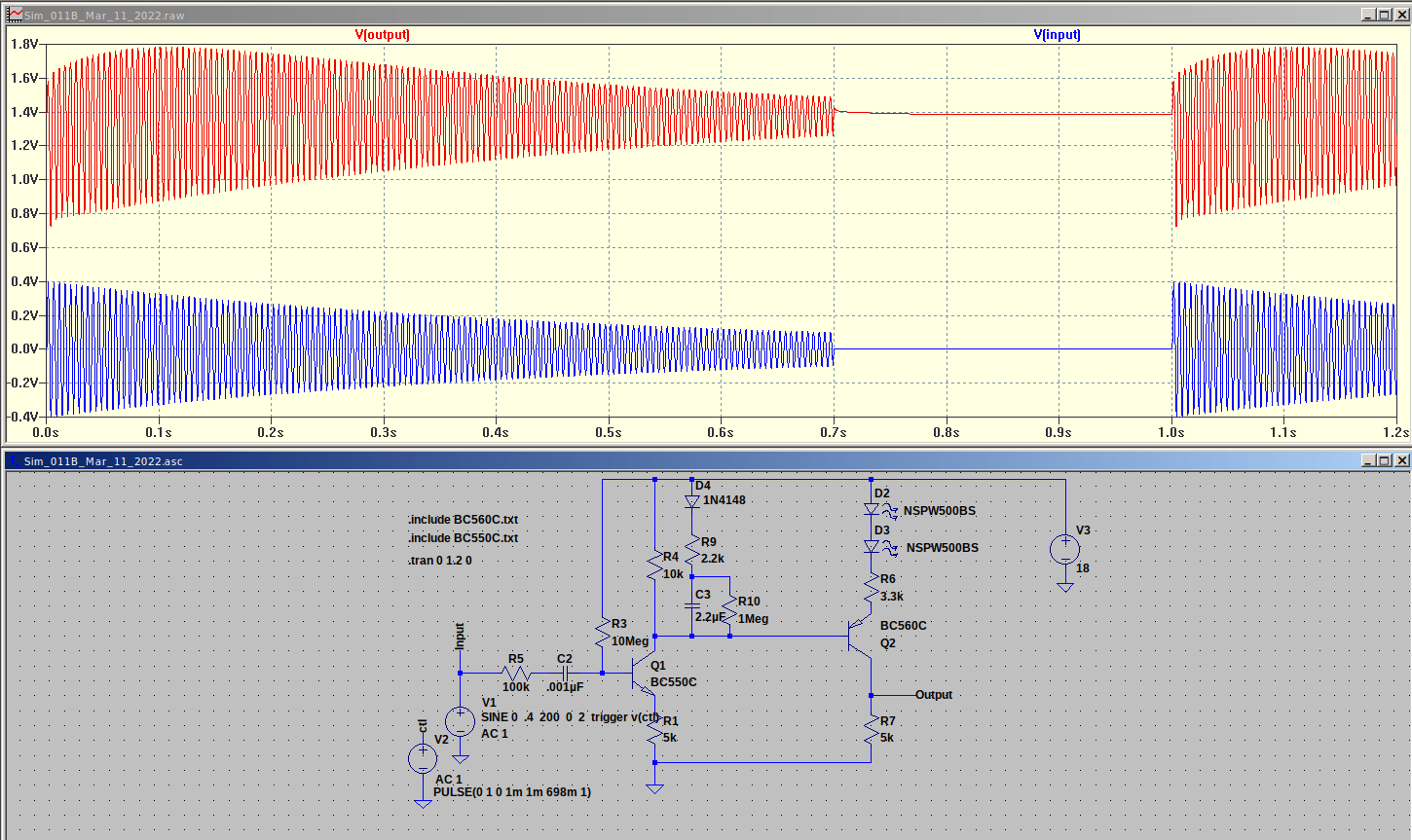

Just to say that there does seem to be some bias shifting that goes on similar to what can happen with common cathode vacuum tubes.
No doubt! If you put a sinewave through a device that conducts better one way than the other (like a square-law JFET transfer function), you automatically get partial rectification, and therefore, and average DC level that depends on the peak amplitude of the signal.
I wonder if there was also enough signal strength for the gate-source diode junction to become forward biased on positive peaks, flowing one-way gate current and adding to the bias shift.
I tinkered with the idea of adding a diode-resistor network to either the emitter or collector side of a BJT common-emitter amplifier. LTSpice thinks this can produce some very interesting effects. Not only duty cycle modulation, but even dramatic changes to the envelope of the waveform, particularly the transient at the start. (Output waveform in red, input waveform in blue. Input is just a repeating damped sine wave at 200 Hz.)
-Gnobuddy
...behaving somewhat badly...
And in this case, we have considerable control over the amount and type of badness, by tweaking R9/R10/C3 values.
I have no idea what values would actually provide the right sort of musically attractive badness, so some experimentation is called for.
If I zoom into the simulation, I can see the output waveform looks almost half-wave rectified at the start of the note, but looks like an almost undistorted sine near the end. Hopefully that will translate into interesting variations in timbre throughout the note.
I forgot to attach the LTSpice simulation file to my last post, so I'll attach it here, if anyone wants to fiddle with it.
As an aside "Behaving Somewhat Badly" sounds like a pretty good name for a punk band. 🙂
-Gnobuddy

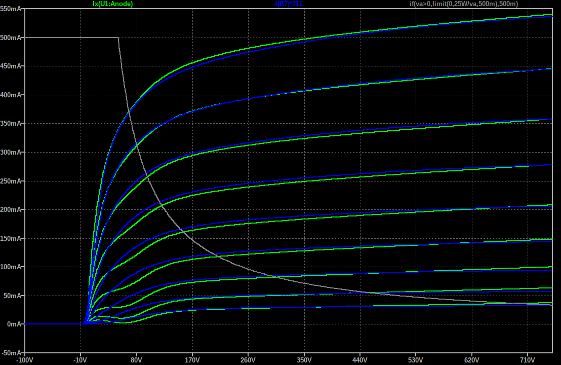

I've been working on improving the accuracy of my power tube emulation (see attached anode characteristics – green is an EL34 tube model and blue is my circuit) and I started to wonder about output transformer saturation and whether it actually happens to any significant degree in a cranked guitar amp. Does anyone have any data on the DC saturation current for guitar amp output transformers?
When a typical LTPI is overdriven, it exhibits significant bias excursion, causing duty cycle modulation of the output waveform. This means mismatched average currents in the output tubes and a DC component in the output transformer. Simulations suggest somewhere around 150mA of DC offset for a Marshall-style 50W power amp with the phase inverter driven hard.

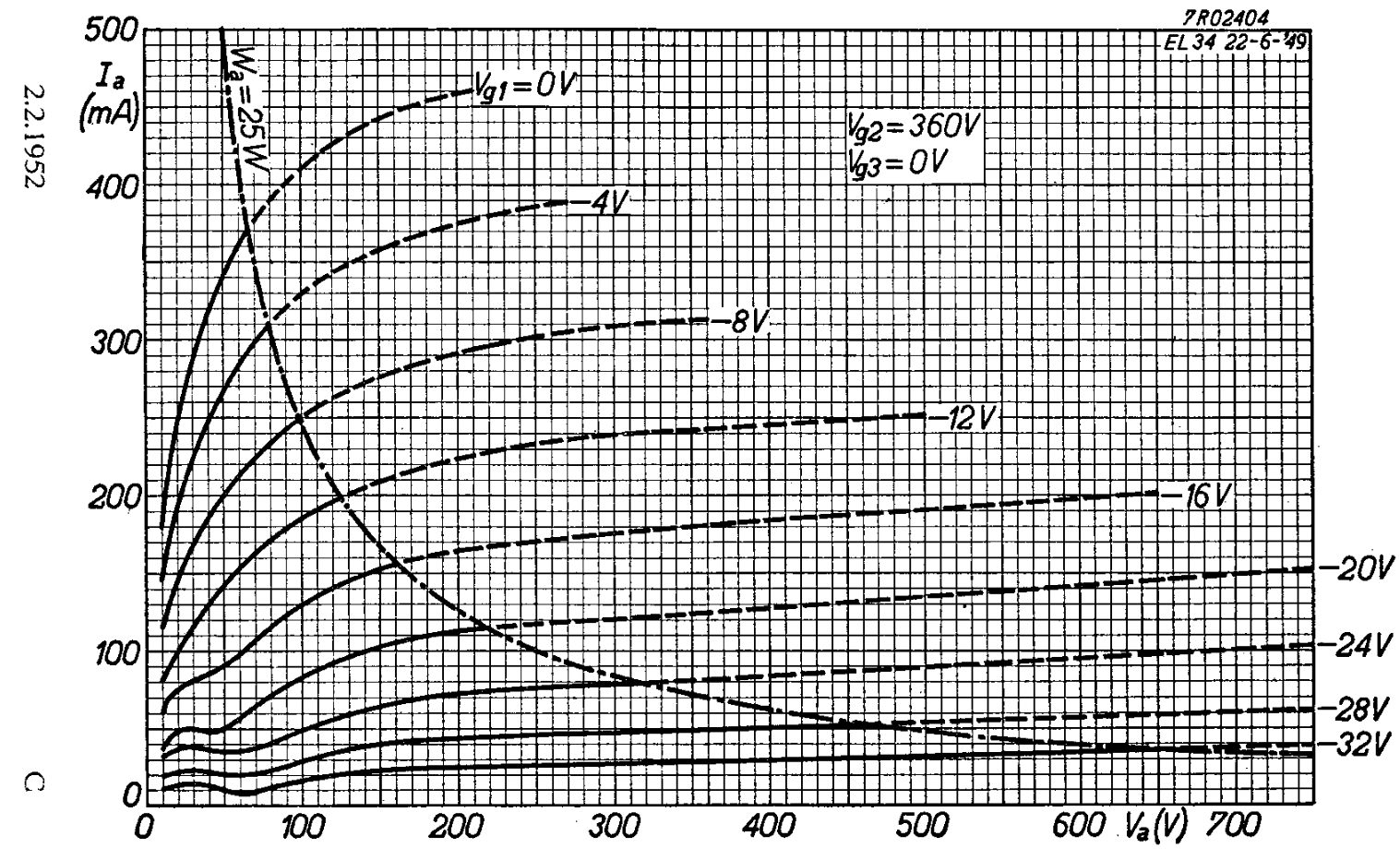

...the kink at low plate voltages...
As I'm sure you know, that kink is the last remaining trace of the negative-resistance region, which was a massive flaw in the predecessor to the pentode, the tetrode valve.
Philips engineers invented the pentode by adding the supressor grid to the tetrodes, and then patented it. Other valve manufacturers were not particularly happy about being either shut out of the lucrative pentode market, or being forced to pay Philips a pentode licensing fee. The beam tetrode was invented, and by careful shaping and positioning of the electrodes and grids, eliminated the troublesome negative resistance region of the original tetrode.
All that remains of the massive original flaw, is those little kinks at low anode voltage and low anode current...
While I see those kinks in 6L6 and 6V6 and EL34 anode curves, datasheets for some later-generation beam tetrodes have no kinks at all. Evidently the engineers managed to completely eradicate the last vestiges of tetrode misbehaviour before the valve era came to a complete end.
All of this is to say, those little kinks have always been a flaw, and IMO, unlikely to play much part in the sound of a tube guitar amp. I doubt you'd need to reproduce them before you could convincingly mimic output tube characteristics.
IMO, the actual spacing of the curves is much more important. If you read Schade's white-paper on the design of the 6L6, he talks about one of the failings of the beam power tube / beam tetrode: compared to proper pentodes, beam power tubes have high second harmonic distortion.
While that was a flaw for Hi-Fi and other linear applications, that very failing is probably why "6V6's sing the blues, while EL84s rock", as Tubelab George puts it. More singing 2nd harmonic from the beam tetrode, more growling 3rd harmonic from the pentode.
-Gnobuddy

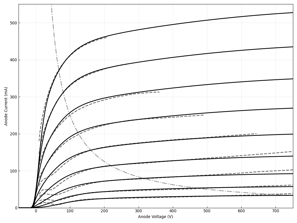

I decided to try to fit the anode characteristics of my solid state pentode emulator to data I extracted from the Philips EL34 datasheet rather than a SPICE model. The black solid lines are my circuit and gray dashed lines are from the EL34 datasheet. No fundamental change from last time, just changing some component values. I suppose the question now is how the circuit performs in practice. I've got a fair amount more work to do on the rest of the circuit, but I'll build an updated version of the circuit I mentioned in post #134 at some point incorporating these improvements.
Reactions: Gnobuddy
