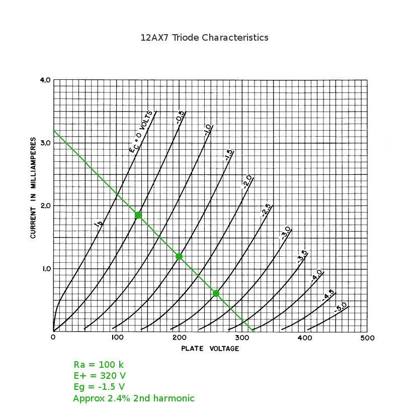

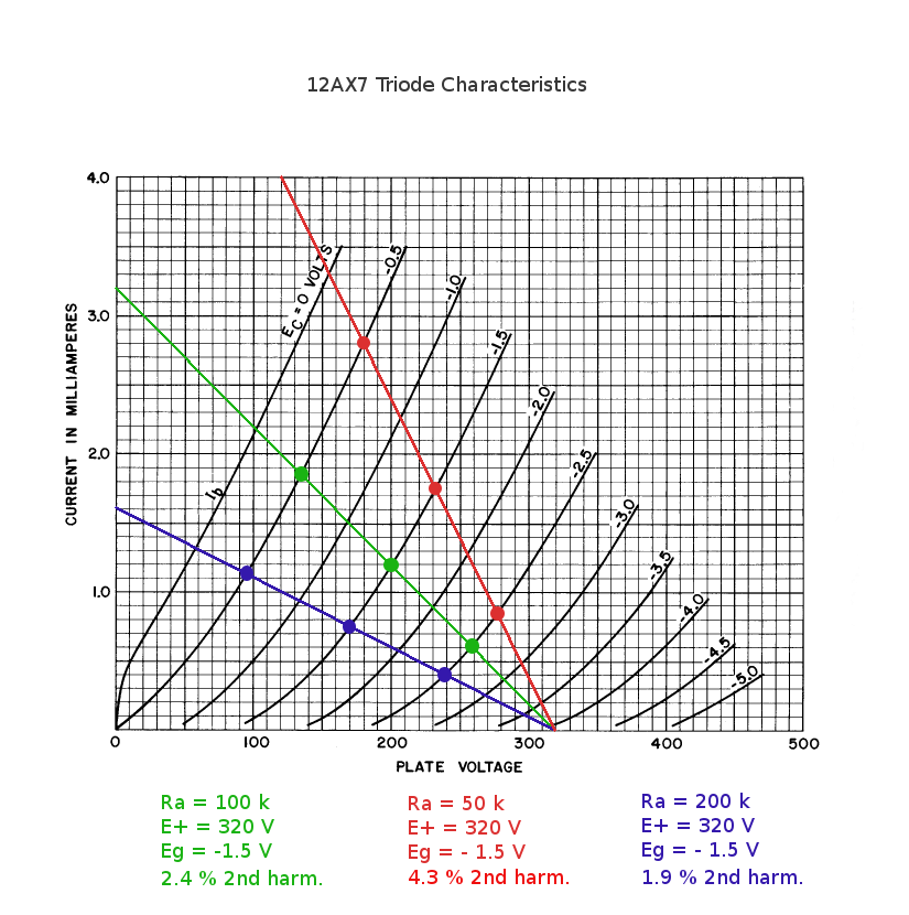

Since most attempts to make a good-sounding solid-state guitar amplifier are based around emulating at least some of the characteristics of valves, here are a few images to remind us of the starting point - a single vacuum triode.

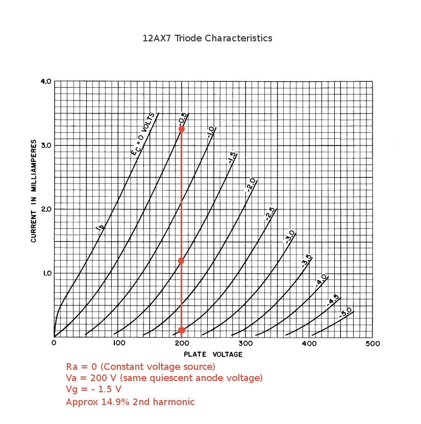

I made these images for myself a few years ago, while thinking about the simplest of "toob" guitar preamp stages, the half-12AX7 gain stage Leo Fender borrowed from the RCA tube catalogue, and built into many of his guitar amp designs.
In each case, I've drawn a load-line representing the value of the anode load. Looking at where that line crosses various grid curves, we can see that equal changes in grid voltage do not cause equal swings in anode current. Based on the unequal swings around the bias point, there is a simple formula that can be used to calculate the approximate amount of second-harmonic distortion in each case.
The first image shows the typical Fender / RCA gain stage: 1/2 12AX7, 100k anode load, 1.5k cathode resistor, roughly 320 volts B+. Biased at Vgk = -1.5V, and with a 2 Vpp input signal swing, THD at the output is estimated to be about 2.5%. Audible with a sine wave input, but very subtle.
The low distortion occurs because, inside a triode, the electric fields from anode, grid, and cathode mix, creating unavoidable internal negative feedback.
One side effect of this is that the amount of negative feedback (and therefore, harmonic distortion) varies with the value of the anode resistor. A bigger resistor results in more internal negative feedback, and a more linear triode stage. Gain goes up a bit because of the bigger resistor, but not quite proportionally, because of the simultaneous increase in internal NFB (which reduces gain, opposing the effect of the larger anode resistor).
The second image shows the effect of varying the value of the anode (plate) load. As you can see, increasing the 100k load to 200k reduces harmonic distortion. Going the other way and reducing the resistor to 50k, also increases harmonic distortion.

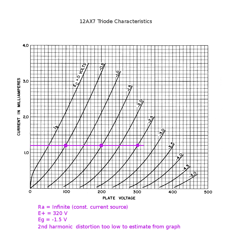

The third image (fig3) shows this taken to an extreme - replacing the anode resistor with a constant current source, with nearly infinite impedance. The resulting horizontal load-line produces extremely low harmonic distortion. No wonder some tube-Hi-Fi aficionados love using constant-current source loads with triode valves in preamp stages.
The fourth image is a "what if" from me, showing the opposite extreme - an anode load of virtually zero impedance. In practice, this could be achieved by using a cascode setup, with the anode of the triode wired straight to the emitter of a BJT, or source of an FET. The output signal would be taken from the collector of the BJT / drain of the FET.
Because the cascode arrangement isolates the triode's anode from signal swings, all internal negative feedback within the triode is suppressed, and the full nonlinearity of the device is exposed. The same 2 Vpp input signal now produces roughly 15% second harmonic distortion at the output, compared to only 2.5% with the typical 100k anode resistor.
For Bucks Bunny - note that 2nd harmonic distortion is not the only one produced by the triodes in these images. But it is the dominant harmonic, and the only one that is so easily calculated just by measuring the unequal signal swings on the load-line.
While the "tube Hi-Fi" guys have taken advantage of CCS anode loads, I have yet to see a tube guitar amp that takes advantage of the opposite end of that same spectrum: a constant voltage source anode load, in the form of a cascode with a transistor, in order to increase harmonic distortion to the maximum possible with a triode. Instead, tube guitar manufacturers tend to be conservative, and make copies of vintage tube amp designs from many decades ago. Their customers tend to be conservative too, and probably most of them want replicas of old "classic" amps, rather than novel new designs.
Heck, I haven't even seen a tube guitar amp that drops the 100k anode load to, say, 56k, in order to gain a little more "tubey" distortion, at the cost of a small amount of voltage gain.
The difference is slight, but audible even with a single gain stage; obviously in a preamp using multiple gain stages, the effect can be cumulative.
Some years ago Fender sold a model they called the Excelsior, which had 220k anode loads on its two-stage triode preamp. The larger value was used in an effort to squeeze sufficient voltage gain from only two triode gain stages.
As an unwanted side effect, that amp also sounded extremely "clean", bordering on the too-clean, sterile sound of a typical solid-state amplifier.
-Gnobuddy

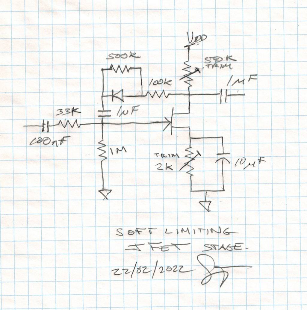

This is what I was working on with the soft limiting (squishy) Jfet stage. The 500K was setup as a variable resistor, which varies the NFB which varies the overall gain and also how much effect the diode limiting has. I posted up the scope pic earlier on this thread. The next step is to string a couple of these stages together and preceded by a standard common source stage with no limiting or very little. Will try it at 18 volts supply, to increase the headroom. For my scope test I used a Jfet source follower as the input for the guitar.
Then you will see that the negative half of the output will clip hard when input signal gets large enough.
I hope to keep the signal amplitudes much lower than the 18 Volt supply rail, that's the plan anyways..to avoid a hard clip on the negative going. If it did clip, the second stage is inverted so it should soft limit that excursion.
In that case your clipping will become symmetrical with H3,H5... dominant instead of H2,H4.
There is no free lunch
It may well produce H3, H5 as dominant harmonics at peak signal levels such as the initial pick attack. To me that's okay, I can learn to live with "Fets behaving badly"..as you said there's no free lunch. Once the signal starts to diminish in strength, the H2, H4 start to dominate (hopefully in a gradual way) and finally as the input signal decays down to 100 mV or so it's back to almost no harmonic distortion. I had already built a 3 stage FET preamp, but it was running on a lower supply (9V) and without the diode limiters. It sounded quite good, and the spectrum of harmonics changed with signal strength in a gradual way. I'd like to improve the dynamic range of it by upping the supply voltage and installing the diode limiters on 2 of the stages.

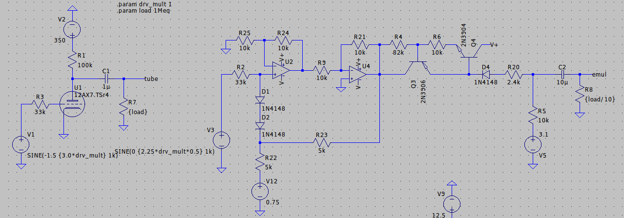

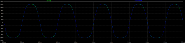

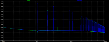

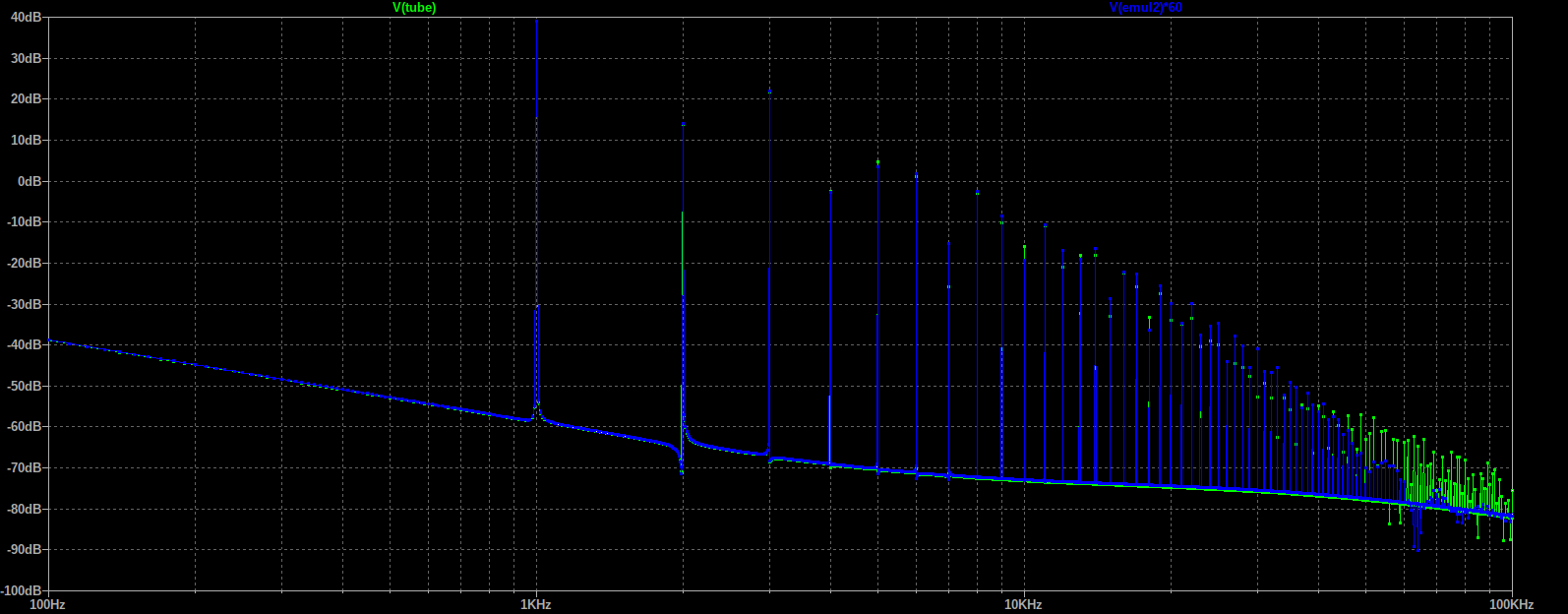

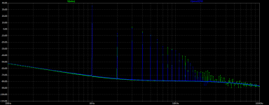

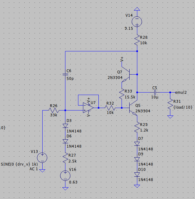

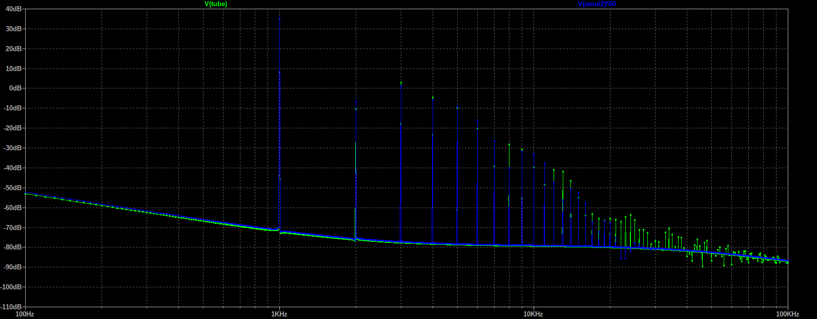

Here's my next crazy idea for triode emulation. The last one (post #156) suffers from high noise and very limited input and output voltages. This one does better on both counts. Basically, it's a nonlinear voltage controlled current sink with feedback. The output impedance (scaled down 10x from the tube) is nearly identical to the 12AX7 model.
Do you really need the opamp? interestingly, the circuits starts to look a bit like the KMG emulator now. Great minds think alike?
It needs some kind of buffer, otherwise the input impedance would be extremely low and there'd be constant "grid" current. Could be something other than an op amp.
There are definitely some similarities to KMG's circuit. The output impedance of mine is much more accurate due to the feedback, but it has other limitations of course (gain and output swing are the two main ones). I'm basically just trying to figure out what can be done with BJTs and diodes so I can maybe avoid the wide parameter variation you get with JFETs and MOSFETs.

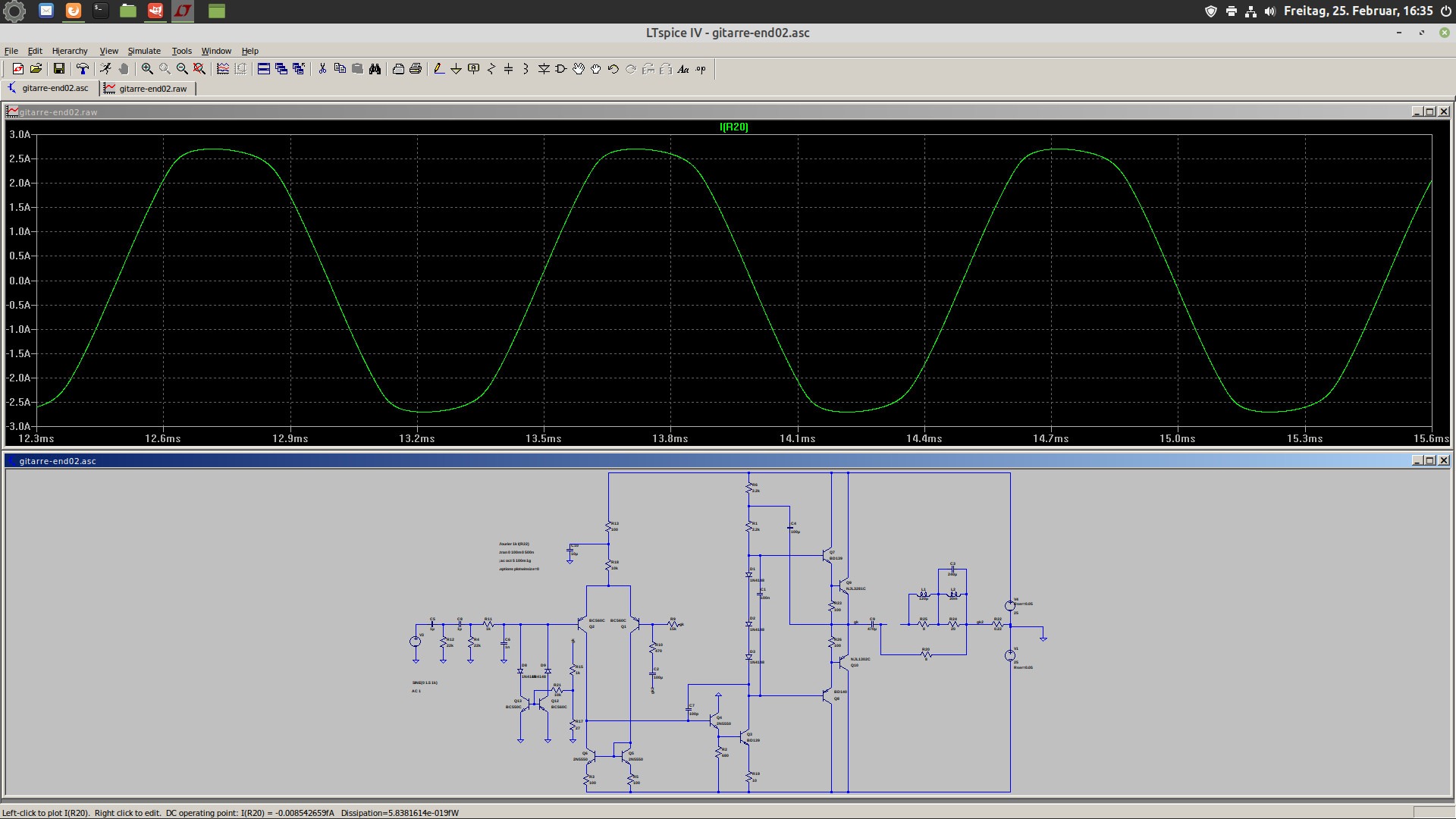

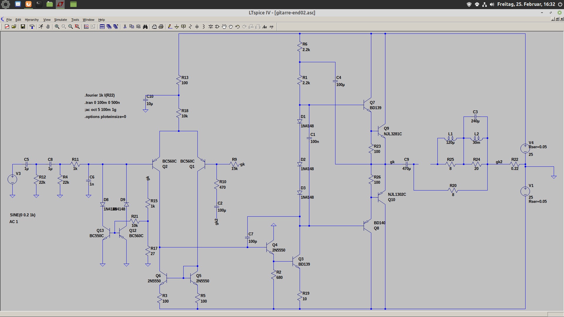

A small contribution to a power amplifier:
This Amp has no DC at the output and it clips soft. The number of semiconductors is manageable and there is no need to adjust bias. The amp runs in class-b.
It is just an idea, no in reality working amp.

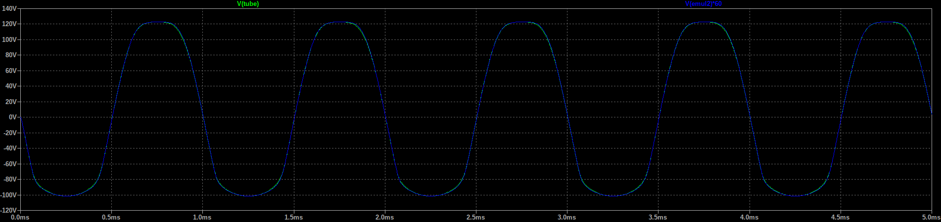

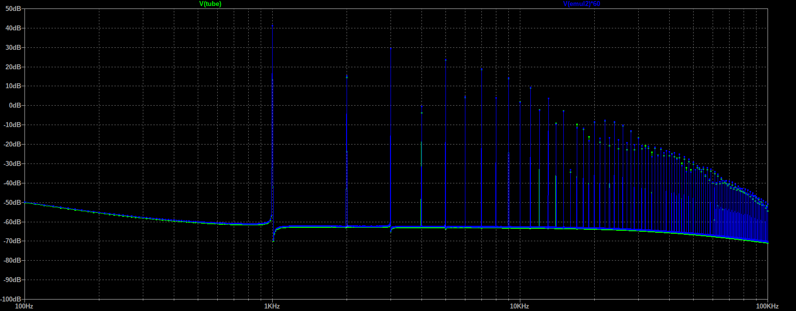

I ran some guitar through LTspice simulating a single 12AX7 gain stage (300V supply, 100k anode load, bypassed cathode resistor, Adrian Immler's 12AX7 model) to see if I could hear the effect of the distortion. With the samples accurately volume matched, I couldn't really hear much of any difference unless I set the drive level so that the (simulated) tube was clipping the transients. Makes me wonder if there's really any point in trying to recreate the preamp tube nonlinearities below clipping levels. Do I have tin ears? I can clearly hear the distortion with a pure sine input.
