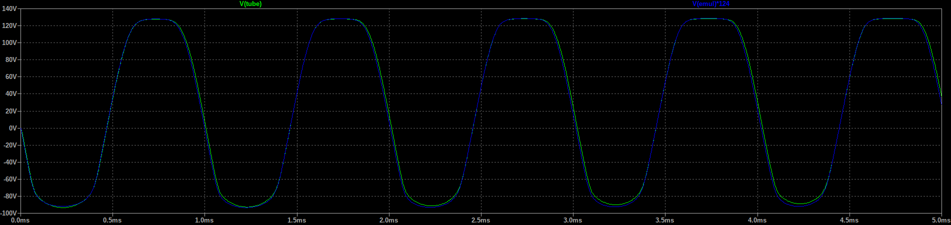

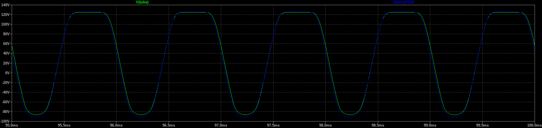

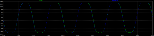

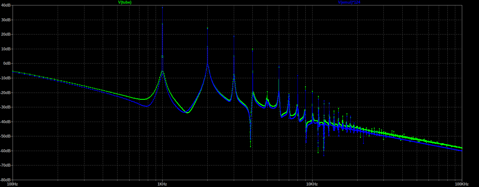

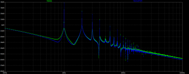

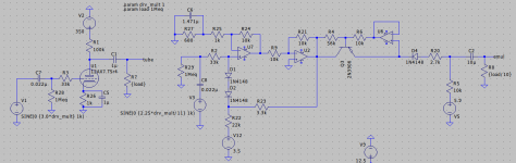

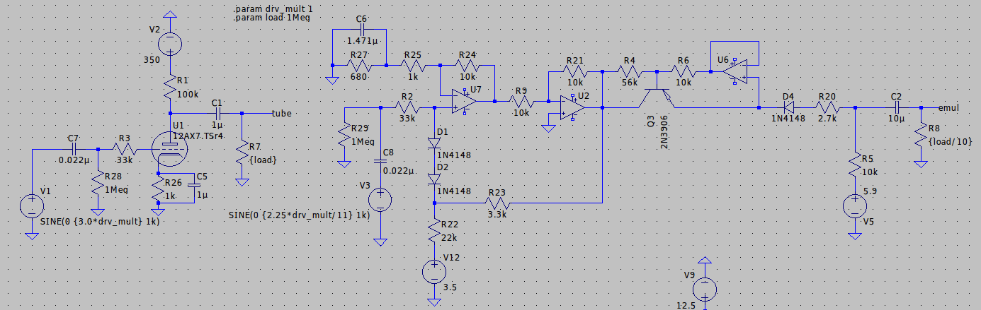

Here's an AC coupled cathode bias triode emulation. I didn't try as hard to get it perfect this time, but it's still pretty close. This one is set up with more gain. Duty cycle modulation is clearly visible switching between the first and second time domain views (0-5ms and 95-100ms). Harmonic spectrum is pretty darn close again. 2nd harmonic amplitude error is less than 1dB.

Looks really great! Have you also tried putting two stages like that in series? would they react the same way as tube stages?Here's an AC coupled cathode bias triode emulation. I didn't try as hard to get it perfect this time, but it's still pretty close. This one is set up with more gain. Duty cycle modulation is clearly visible switching between the first and second time domain views (0-5ms and 95-100ms). Harmonic spectrum is pretty darn close again. 2nd harmonic amplitude error is less than 1dB.
No, it is not. If you had tried the little exercise I described, you would see for yourself. As it stands, you are b--s-ing. In "practice" you never even tried.And because of that, in practice there are steep low-pass filters before any A/D converter, to exclude frequencies at exactly 1/2 of the sampling rate. In practice such problem you are describing (hoping for?) never occur. Only two dots in one cycle very close to the 1/2 sampling frequency is enough, indeed.
Theoretically, yes. The grid conduction and nonlinear output impedance are modeled pretty accurately, which are two important factors. One other thing that I didn't include is the grid to plate capacitance, but that's easy to add.would they react the same way as tube stages?

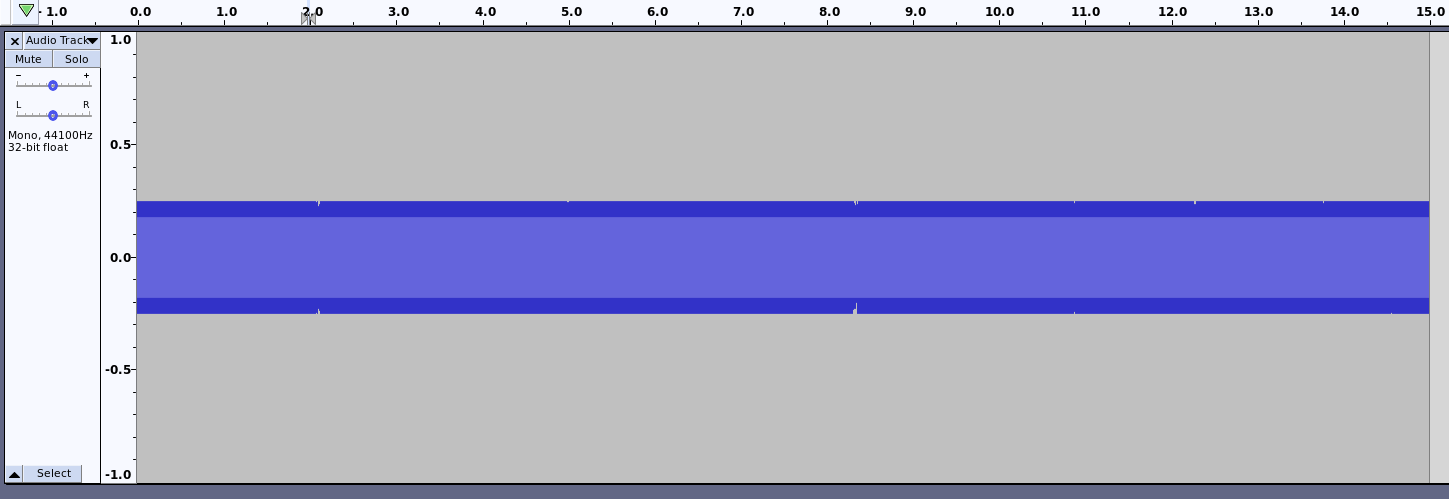

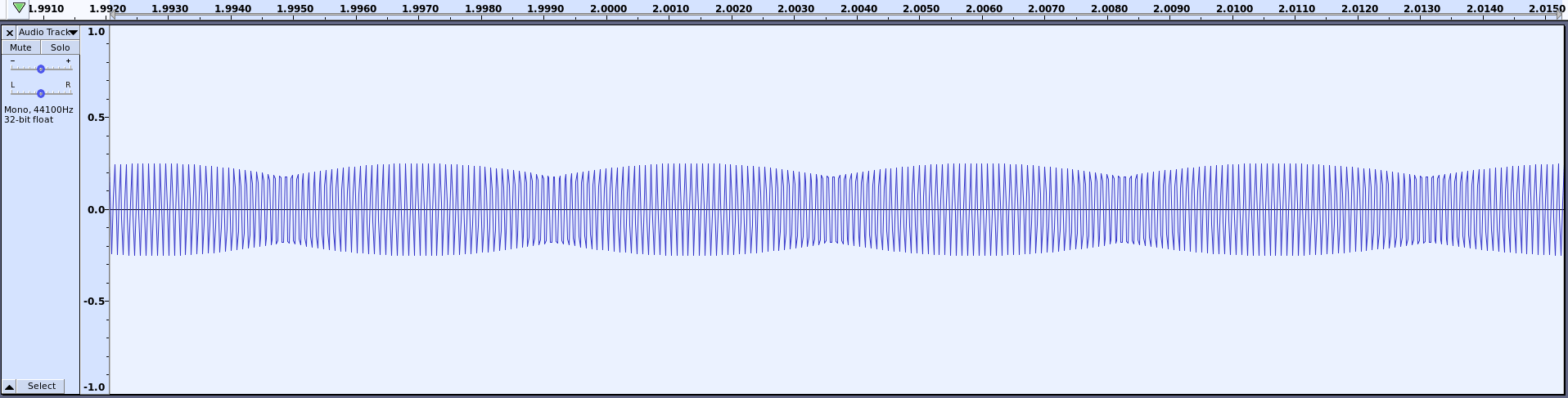

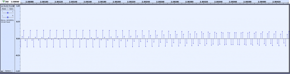

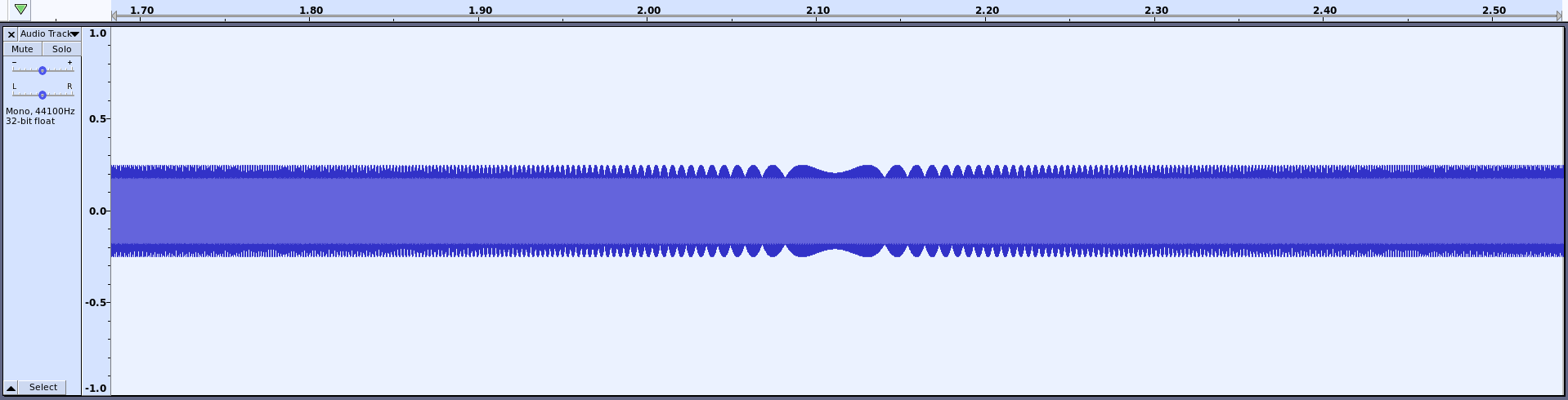

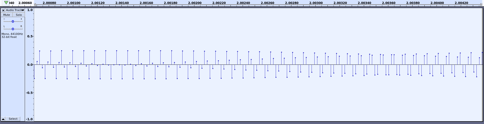

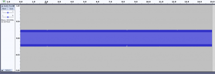

Presenting: a "mathematically perfect" sine sweep from 10kHz to 20kHz, sampled at a "perfect" 44.1k. Zoomed in on ~11kHz to verify that it's not just the screen resolution creating moire patterns. Aliasing is its own separate thing.
If you looked closely, you'd realize that audacity simply connects the dots for its waveform display (linear interpolation). This is not what happens in a DAC. With a real reconstruction filter this moiré-like effect goes away.
