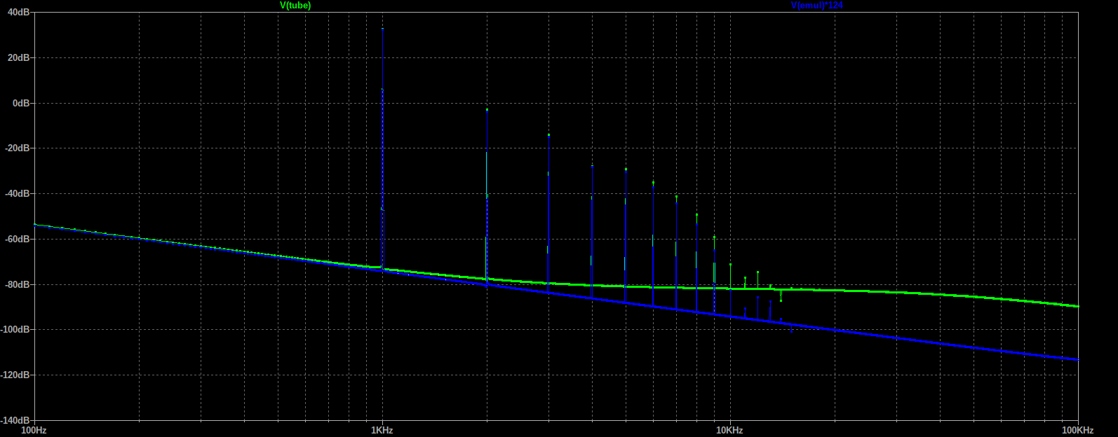

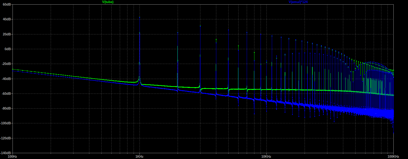

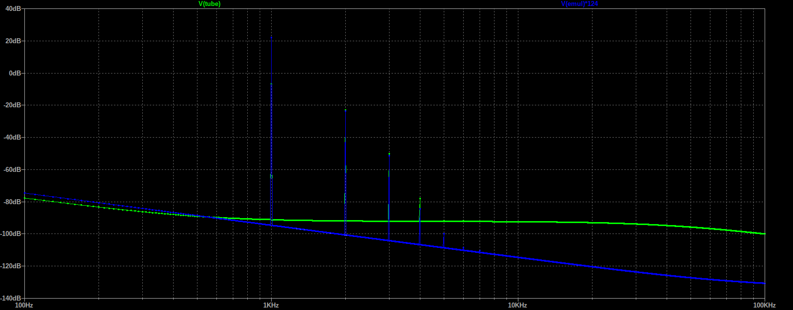

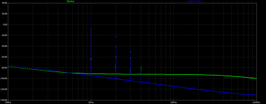

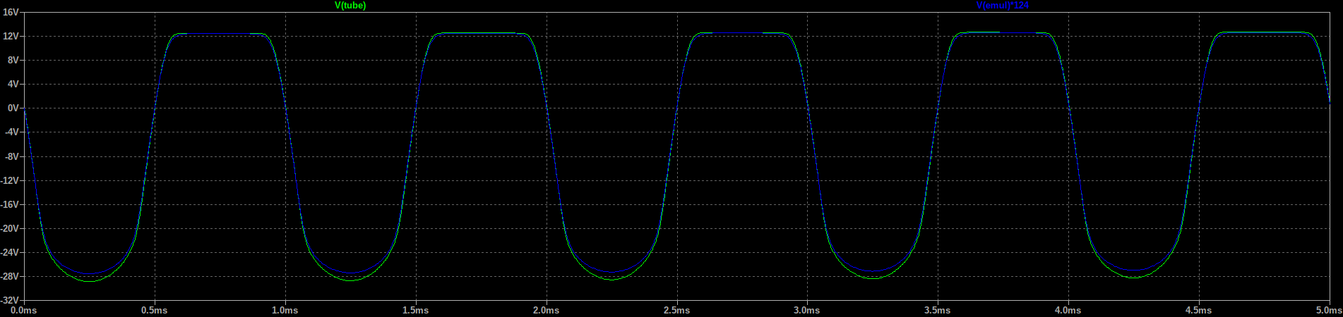

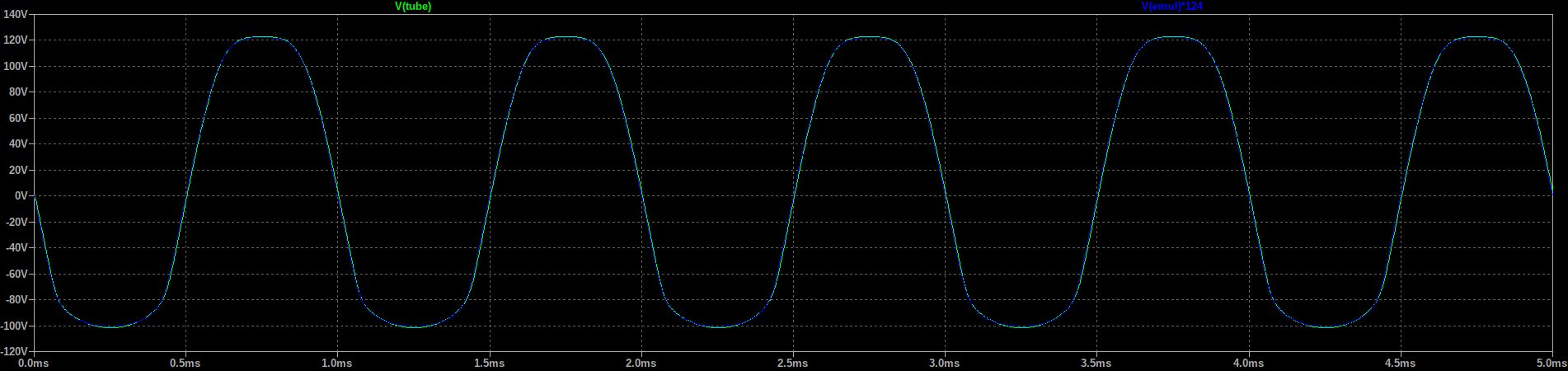

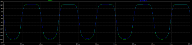

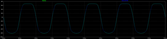

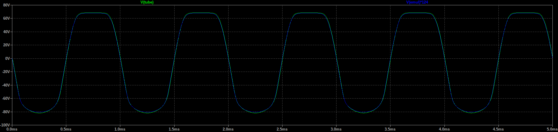

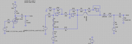

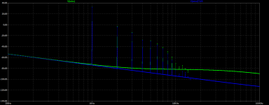

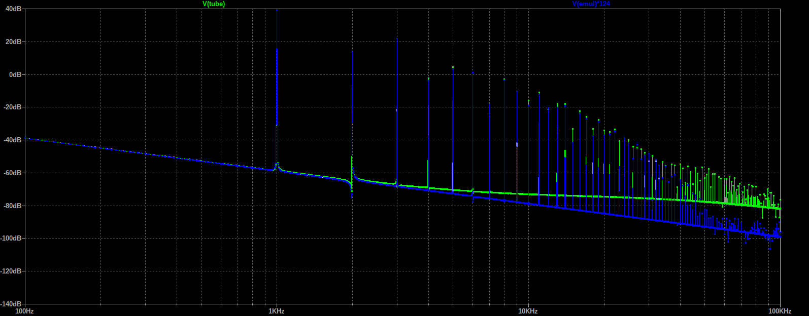

Here's a triode emulator I've been working on using opamps, BJTs, and diodes. Seems to work pretty well, but will obviously require scaling the input if you want to overdrive it a lot. It clips correctly into different loads and the harmonic distortion spectrum is pretty darn similar to the tube model over a wide range of input levels. The 12AX7 model is from Adrian Immler.
The time domain plots show the clipping behavior with 1Meg, 100k, and 10k loads. The frequency domain plots show the harmonic spectrum with different input voltages (peak-to-center into the tube, 1Meg load): 300mV, 1V, 3V, and 30V.

Very nice for a solid-state "dirt pedal", but not really comparable to a good tube amp.

The input diodes emulate the grid conduction/rectification. The first opamp provides a bit of gain and the second is just an inverting buffer. Q3, R6, R4, and U6 form a buffered rubber diode, which basically just acts like a long string of diodes in this case. R20 makes the emulated anode resistance more accurate. The rubber diode and D4 are forward biased through R5 by V5. When D4 becomes reverse biased, it's like the tube going into cutoff. R5 is analogous to the anode load resistor (scaled down 10x from the tube circuit).
Thanks, it's starting to dawn. And why are the input diodes and R22 + R23 connected the way they are?
