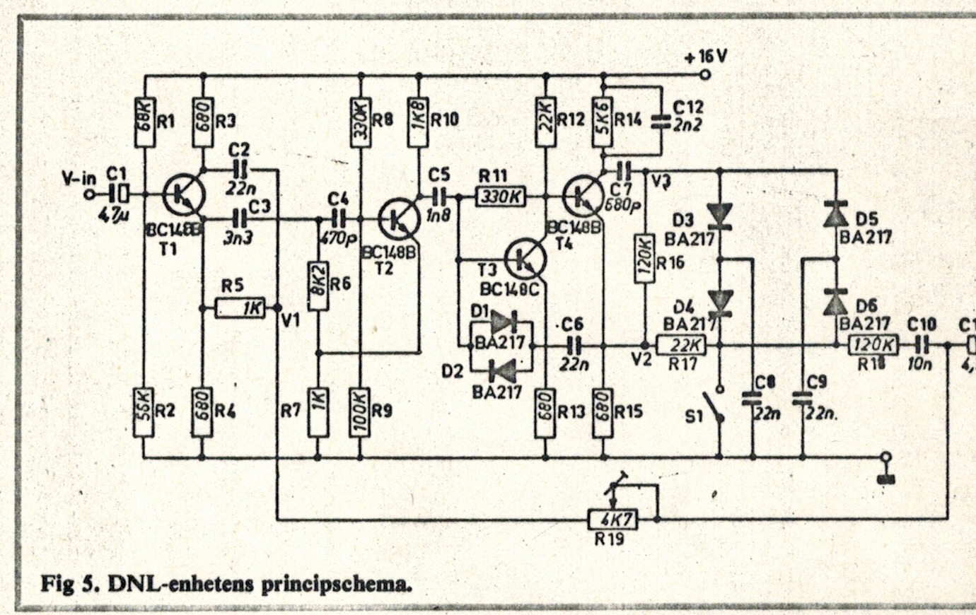

Even more dramatically, in the 1970s, before Dolby Noise Reduction, Philips designed, manufactured, and sold their Dynamic Noise Limiter (DNL) to reduce tape playback hiss. The clever circuit used several diodes as variable resistors, while creating negligible amounts of distortion from them. The goal was that you wouldn't hear any distortion at all, only hiss reduction.
I'll attach the Philips DNL schematic, for anyone curious. I built one a long time ago - it worked quite well, reducing the tape hiss from my DIY cassette deck quite noticeably. The clever part was that it responded to audio signal level and frequency content, basically turning down the treble only when there was no appreciable music content at those frequencies.
So yeah, if you keep the audio signal well controlled, you can stay away from harsh diode clipping. In fact you can keep distortion inaudibly low, or nearly so, with careful design. (Not the goal for guitar, but possible.)

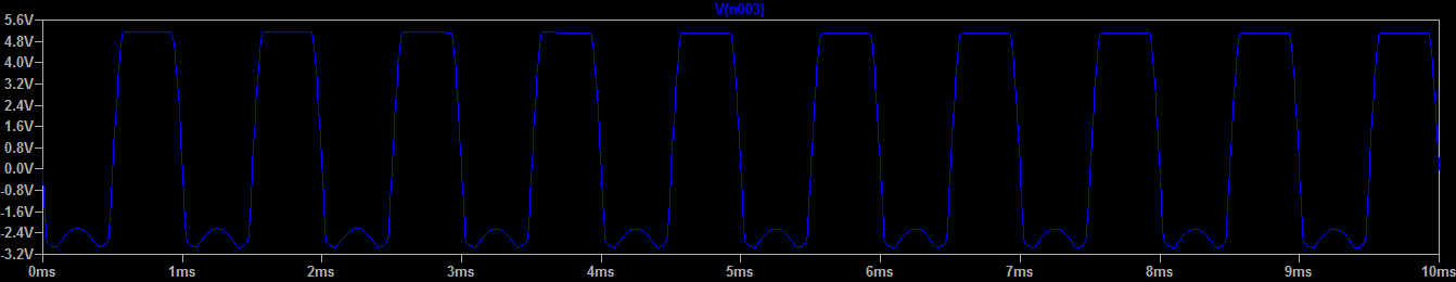

I don't really like the sound of this thing. And I think I know why, here is a simulated waveform of an overdriven J201 stage as in the schematic:
It sounds just as it looks. The problem with particularly the J201 is that it has a very low pinch off voltage, wich makes it clip quite early on the negative side unless you make special bias arrangements
Turn down the amplitude of your simulated drive signal a lot. What does the output waveform look like now?
In the video clip I attached to my previous post, you can hear the guitarist start out playing gently (maybe also with the guitar volume pot turned down). What we're hearing at that point definitely is not a rail-to-rail squarewave.

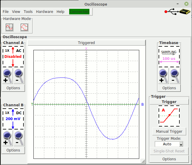

The attached waveform is from a J112 (JFET), in common-source mode, powered from two 9V batteries wired in series (18V total).
This is an actual waveform captured with a USB scope. It is not a simulation.
Input signal amplitude was turned up until the output was just shy of clipping. As you can see, there is no harsh/abrupt clipping in the output waveform at all.
There is also quite a lot of distortion in the screenshot, so you can turn down the input level and still get some "warmth" added to the guitar clean tones.
It's been a couple of years since I made these measurements, and I may have forgotten some details. I'm pretty sure I was using 10:1 'scope probes, so the output waveform was about 12 volts peak-to-peak.
I didn't record the input signal amplitude, but I do remember that the J112 FET produced far more voltage gain than older JFET types in the same circuit. The J112 produced about 30 dB of voltage gain, compared to something like 10 dB - 12 dB from, say, a 2N3819 in the same circuit.

Driven gently, JFETs produce nice smooth low-order distortion.
Yes, and it sounds good, most people would agree. But why design an overdrive pedal using parts that do not sound nice when overdriven?

I really wonder that you were so amazed by the philips DNL. I built it at that time and fitted it into my Revox A77. Yes, it reduced the residual noise. But after a few days I removed it as it made the sound dull to me.

I really wonder that you were so amazed by the Philips DNL.
Can you design something that works better, with so few components, and only those components readily available in 1970? And using only inexpensive components from that era, at that?
I still think the Phillips DNL was a very clever circuit for its time. For one, generating a level and frequency sensitive DC control signal in response to the very complicated signal that is music, without audible artifacts, is a difficult challenge.
AFAIK, only Ray Dolby had done that job well before, and he was using more expensive and more exotic components (a JFET as VVR), along with a lot more components and complexity. His original noise reduction system was so complex it was extremely expensive, and only used in recording studios.
For another, using ordinary semiconductor diodes as variable resistors in the DNL was quite a clever trick, keeping costs and complexity down, while providing acceptable performance for the era.
...after a few days I removed it as it made the sound dull to me.
