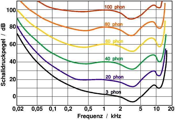

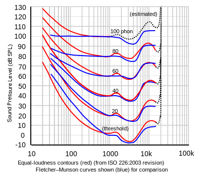

Thing one: flutter from tape was far worse than jitter from any D/A converter ever was.
Thing two: if you look at equal-loudness contours for the human ear (ISO 226:2003 curves attached), we cannot actually hear much above 15 kHz at ordinary loudness levels.
The second of the two attached images shows dotted lines above 15 kHz...the dotted lines are guesses, not actual measured data, because you can't really measure them, because people can't really hear them!
By the time you raise loudness to 110 - 120 dB SPL, 20 kHz might just barely be audible for young ears - but the same very loud 110-120 dB SPL will immediately destroy those ears (causing PSH, permanent shift of hearing), so they can no longer hear 20 kHz!
If you look at old Hi-Fi books, they often list 30 Hz - 15 kHz as the limits of human hearing. This is much closer to reality. Over time there was a kind of "inflation", or "specsmanship", and people began to talk about 20 Hz - 20 kHz hearing limits. But that is really too generous for our poor human sensory capabilities.
The motional-feedback woofer I developed was capable of flat near-field response down to 10 Hz, so I actually listened to a clean 20 Hz sine wave. It sounds like a moth fluttering inside your ear. Unpleasant, and not musical. You hear individual cycles, not a steady musical tone.
Raising the frequency to about 30 Hz changes that. Now I could hear a musical tone. It's probably not a coincidence that the lowest frequency from a 5-string bass guitar in standard tuning is 30 Hz.
All this means the gap between the highest frequencies we can actually hear (roughly 15 kHz) and the CD Nyquist frequency limit (22.05 kHz) was not nearly as tight as it appears at first sight.
Still, there were criticisms, valid or not, and engineers responded; CD players with oversampling arrived very quickly - it didn't take decades. In 1990 I bought a Sony CD player with 8-times oversampling, for only $100 USD - that was all I could afford, as a starving student living on a tiny scholarship. The first consumer CD player was released at the very end of 1982. That means cheap 8-times oversampling was available less than 8 years after the CD was first introduced to the public.
You don't actually need 8 times oversampling to get away from the brick-wall filter. Even 2-times oversampling gives the filter a lot more room to work with, as the aliasing frequency moves up to 44.1 kHz, while there isn't much audible music above 15 kHz. 4-times oversampling is more than adequate, with tons of room between the most generous estimate (20 kHz) and the 88.2 kHz aliasing frequency.
