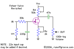

If you want to use this with an electric guitar, you can easily add a simple preamp in front of it to sweeten the clean tones a little bit. A single JFET is a good start; try using it configured as a Fetzer Valve http://www.runoffgroove.com/fetzervalve.html ).
I would suggest using a 10k trimpot for Rd, rather than a 50k one. 50k is really too large, and will end up set to nearly one extreme. A 10k trimpot will be less "twitchy" to set.
This still has no tone controls, and will sound midrange-dominant and dull until overdriven. If that's not to your taste, Runoff Groove has several other (more complex) JFET-based circuits that you can place ahead of the Digikey LM386 board.
The J201 FET or MPF 102 FETs used in some of these old circuits may not be available any longer. If this idea appeals to you, we can help you find a JFET that is still available, and which will work in this circuit.

I think this could be fixed with some experimentation. Replace the 100k drain load in a KMG gain stage with a 39k resistor. Now tweak the KMG combination of diodes and resistors connected to the MOSFET source, to get back the voltage gain and distortion characteristics of a half-12AX7. It will mean lowering the unbypassed source resistance, and maybe also reducing the number of Schottky diodes in the source network.
That should produce an even better MOSFET emulation of a half-12AX7 triode than KMGs original design.
There is an even simpler way: simply add a second LND150 as a source-follower, direct-coupled to the drain of each KMG MOSFET stage. Add a 39k resistor in series. Bob's your uncle, you now have a 40k output resistance!
Of course this doubles the number of LND150s you need, but the little MOSFETs are cheap. Eighty cents apiece at Digikey, in Canadian money.
-Gnobuddy
Thanks for that insight, may be very usefull for future experiments. So far I have been mostly interested in trying to use the KMG trickery on low voltage stages, with j113 jfets. But never focussed much on the output impedance and how that affects the sound, interesting new angle.In other words, the output impedance of his MOSFET gain stage is much too high.
I still have a dream that it is possible make a simple solid state guitar amp that behaves and sounds 'rock&roll'. But it has to be Lo-Fi, as you say, basically a bad amplifier. It should be like a vox or fender 5e3, biased well into class A region, no or very little feedback. And use jfets where you can.I did not know that Hi-Fi audio circuits sound awful with electric guitars
