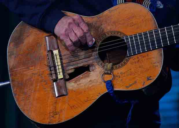

Nelson has played the same acoustic guitar for five decades. During all those thousands of hours of playing, his right hand has worn a large hole entirely through the guitar's wooden top. Even with a big hole through the top, Nelson claims to believe it is still the best sounding guitar he has ever heard, and he refuses to play any other. Nelson gave his guitar a nickname, probably a part of his "shtick" to give his fans something to identify him with.

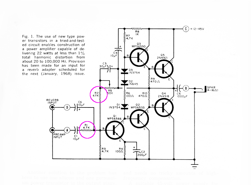

I used a "Lil' Tiger" amp from the early 70's for guitar (with preamp for a spare amp for the ocational drop in player) and it has minimal gain and only localized NFB. Sounded good.
I looked up the schematic (attached). There is global NFB around the entire amplifier (configured like an inverting op-amp block).

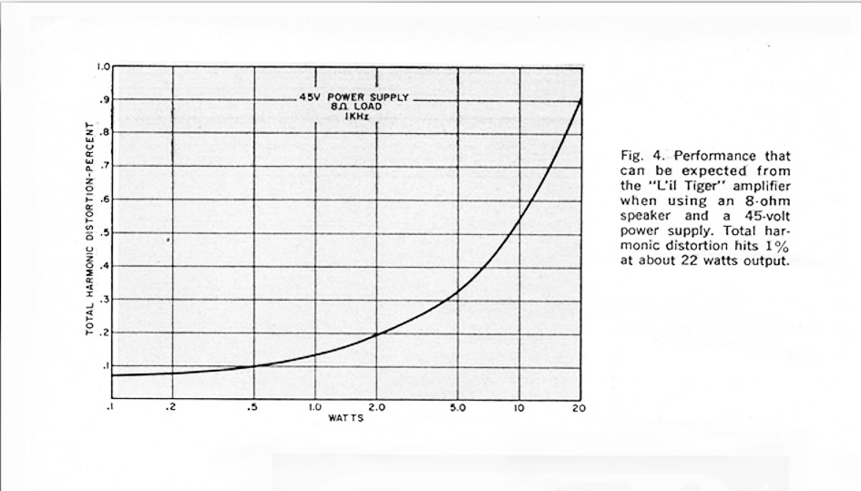

But open-loop gain was certainly very low by modern standards. There is only one gain stage, and even with its bootstrapped collector load, voltage gain was probably limited to a few hundred, rather than the 100,000 - 1,000,000 typical of modern op-amps.

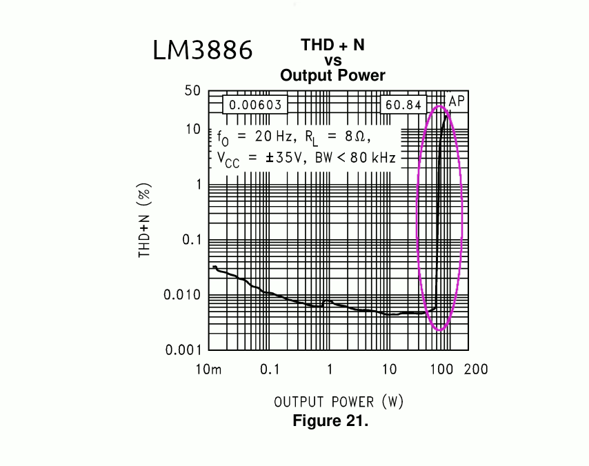

The second image (THD vs power output) tells the tale. Distortion rises quite progressively over the entire range.
Modern high NFB power amplifiers have much lower THD over the entire usable range right up to clipping. But once they start to clip, THD shoots up almost vertically. The third image is for the LM3886, a deservedly well-beloved modern Hi-Fi chip amplifier.
Lots of NFB, very low THD, and generous power headroom is an excellent recipe for Hi-Fi audio. Just not for e-guitar.
-Gnobuddy
