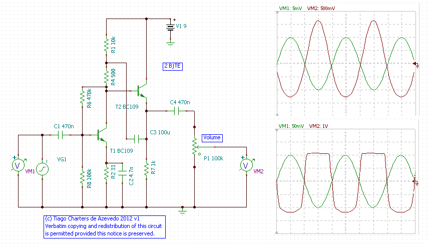

I got confused with the fuzz box. This one uses a single transistor. It's the "Russian" version of the Fetzer valve. I don't have the time or the desire to figure this out, but for tube distortion, it is common practice to use two stages; Hot and Cold bias is the lingo. The waveform supplied indicates a Fuzz Face kind of clipping; hard on top, soft on the bottom. It needs a buffer or the guitar pickups will be overloaded.
This looks like it should be quieter than the all transistor types because of the diodes, and the low resistor values.

Yes, the circuit looks as simple as a Fuzz-Face. But it sounds absolutely nothing like one!

As mentioned before, my first reaction to Azevedo's sound clip was that it is just too good to be true. I can't help but wonder if the Boss overdrive pedal Azevedo used between his guitar and his 2BJTE circuit was contributing some or most of that rich tone.
I have not built or verified that Azevedo's circuit really is capable of the sounds in that clip.
If it really does sound like that, I think it might be the sleeper of the last fify years of solid-state guitar amplifier design. More bang-for-the-buck than anything else I've ever seen or heard.
The additional head-scratcher is that the 2BJTE circuit completely dispenses with all the well-known mechanisms for creating acceptable-sounding distortion from an e-guitar using a SS circuit. No JFETs, no diodes, no carefully designed clipping circuits, no EQ, no low-pass filter, no high-pass filter. Just a couple of everyday transistors in a crude two-transistor DC coupled amplifier configuration.
From the engineering point of view, there are many design mistakes in the 2BJTE circuit, including useless components that don't do what they're supposed to do. But maybe they contribute to the distorted sound by accident, like Leo Fender's DC-coupled cathode follower. Or maybe they really do nothing at all. Someone has to build and try this thing out before we can know for sure. 🙂
-Gnobuddy
No way. There is not enough clipping in the waveform to produce what is on the sound sample. Better off using a Fuzz Face silicon version.
One SPICE simulation, with a single steady-state sinewave input signal, at one single amplitude, reveals almost nothing about how an e-guitar circuit will sound.

Take a listen to the attached MP3 file, and see what you think.
Had a listen, and yes to my ears it's a good classic overdrive sound. I have played though a couple of modern styled Marshall tube amps that sounded ice picky and harsh distortion..This sounds more like a vintage style, smoother and you can still discern individual notes of the chords. It would probably pair up nicely with a cleanish Jfet boost in front giving the higher impedance input, adding a volume control etc.. good stuff.
...to my ears it's a good classic overdrive sound...
That's what I think, too. To me it sounds kinda like a well-recorded classic Marshall amp, after the recording engineer's worked a little magic to remove some of the spikier and harsher treble frequencies.
Now, how in the world can a couple of fifty-cent transistors manage to sound like a big box full of Marshally goodness that costs several grand? :scratch:

This (Ed: 2BJTE) ...would probably pair up nicely with a cleanish Jfet boost in front giving the higher impedance input, adding a volume control etc...

If the sound clip really did come from this 2BJTE circuit, I also think the circuit is ripe for some further tweaking.
Look, for example, at the values of R2/C2. Both components appear to do nothing whatsoever. R2 is too small to affect the DC operating point of T1, and C2 is too small to bypass it at audio frequencies.
Or look at the values of R7 and C3. The second BC109 is running at quite a high current. Is this really necessary for it to sound right? If not, it would be interesting to scale down operating currents and scale up resistor values, to reduce power consumption in case someone wants to run this off the usual 9V flat battery.
Even the ratio of R4 and R1 is curious. If R4 were a bigger value, C3 wouldn't need to be so huge. (But would it still sound the same? I don't know, because I still don't understand why this circuit sounds the way it allegedly sounds in that MP3 clip Azevedo posted.)
There's also the striking fact that there is no EQ curve built into the circuit at all, other than the accidental one resulting from the effect of the bootstrap components C3/R4 at lower frequencies. Would it sound better with some of the usual EQ tricks, in particular, removing some of the deeper bass frequencies before applying the signal to T1?
I am wondering if this is an example of a circuit "behaving somewhat badly" which for electric guitar sounds surprisingly good! The first stage emitter resistor and "bypass" cap as you mentioned..R2 might as well be zero, but having something in the order of 100 ohms would introduce some degenerative local feedback, maybe to make the operating point more stable. But C2? Luckily it's a straightforward build on a solderless breadboard, and it might be very interesting to tinker with.
Well, I just did a first test run of the circuit. It sounds pretty impressive for a two transistor minimalist design, but I don't feel (yet) it is the holy grail of overdrive. The first thing that came to my mind is that it sounds like a tube screamer, but a bit harsher on high frequencies. I ran it in a simulator first, and indeed the top of the waveform has rather sharp edges..
The setup was a clean jfet stage with a direct coupled emitter follower, to have a low enough impedance, into a 100k pot and then the 2BJTE circuit. The output then goes through a 'master volume' pot and a big muff style tone control, and then a transistor power amp with a celestion eight-fifteen speaker. So very simple gear.
It is a circuit worth fooling around with I think, you do get a lot of tone for only two transistors... recommended for tinkering!
One observation is that for most normal amplification stages, a designer will try to make design choices which follow certain standards of good stability, linear operation, minimal distortion etc. Most of the time when these criteria are met, one "assumes" the circuit to be operating within normal constraints. So for example how small does a signal have to be, in order to for us to consider the amplifier to be operating as a small-signal amplifier with the normal calculations and rules applying to said amplifier stage? According to my college text book, a signal is considered "small" if the peak to peak swing in emitter current is less than 10% of the quiescent emitter current (Ie). For larger signal swings you start to see the effects of compression on the sine negative half cycle and elongation of the positive half cycle (progressive increase in distortion). This is due to the non-linearity of the diode curve of the BJT. R2 is lower than what we would see in a "normal" CE amplifier, and I suspect that increasing it up past 100 ohms, say 500 to 1 K ohm would reduce the signal at the emitter to a point where the peak to peak current swing would get below 10% of quiescent Ie and it would behave "nicely". Reducing R2 down to zero may have the effect of sounding more fuzz-like. I still don't get why C2 is there exactly.
