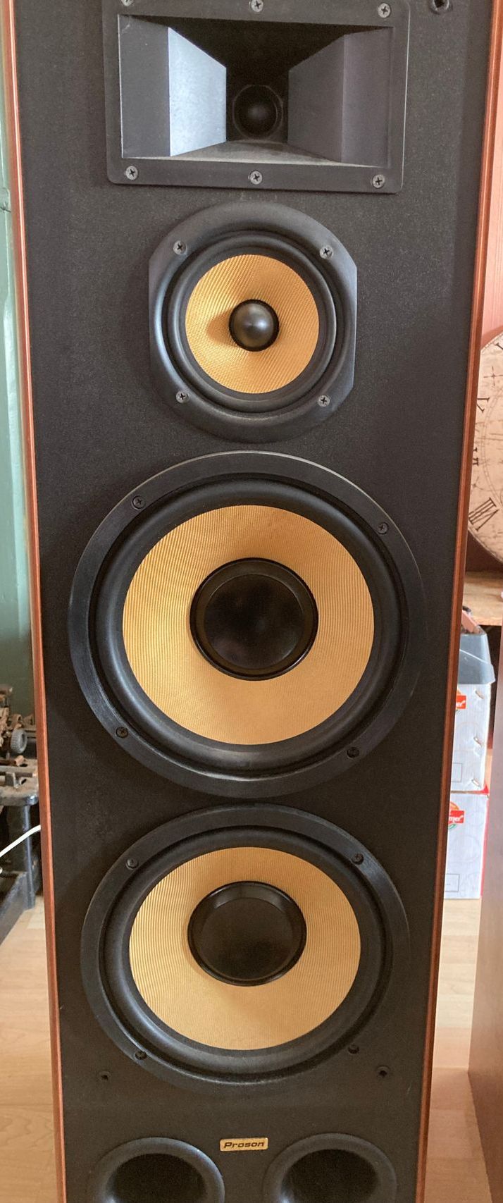

I don't have any diagram response chart of these speakers, for this and I went to 2.6A to be sure ... but my ears also heard this at high volumes like listening to mp3 vs flac ....hahaha
Mmmm ... you would seem to listen much louder than I do! 😀 Or your spkrs are less efficient than mine. 😵
Hahahaha yes....Proson or JWS Speakers inside i think....Mmmm ... you would seem to listen much louder than I do! 😀 Or your spkrs are less efficient than mine. 😵
