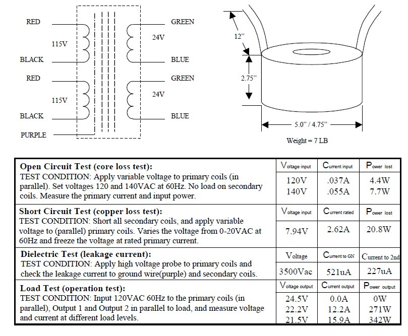

Hello forum, I am making final choices on parts for my build. I have decided to build a duel mono configuration with two 300VA 24V transformers. I am looking to buy two of the transformers below.
https://www.antekinc.com/as-3224-300va-24v-transformer/
There seems to be an extra ground wire on these, Purple in the diagram below. Would that go to chassis ground our just better left unused.
Any info appreciated, trying to educate myself on this. Thanks.

That's purple wire goes to chassis ground. That's the extra "screen" that the AnTek AS line comes with to reduce noise/interference. Definitely attach that to ground for best performance. The AnTek AN transformer series doesn't have the screen.Would that go to chassis ground our just better left unused.

I assume that you are building the 8ohm version of the AN-39 using the dual rail SLB. The rectified voltage of the 24V secondaries is 33.8VDC. The SLB will have to drop at least 6V (not easy to do) for you to be in the required voltage range of 27V - 28VDC. If you have not purchased these yet I would look at purchasing the AS-3222. It is the recommended transformer rating for the 8ohm version.
PS: I tried the 24V transformers and they did not work for me. I could not get the SLB's to give the required output voltage I needed. I purchased the 22V transformers for my 8ohm version. Unfortunately I have other problems with my build and will be sorting that out soon.

@xrk971 can you confirm that I should be ordering the 300VA 22V transformers instead of the 24V. These are from Antek. I was going off of the first post on the group buy thread... I will be using two SLB's in a 4U 400mm modushop case. I just ordered them today... there may possibly be time to change my order given the holiday weekend.

Please refer to the second paragraph of post #1 of this thread - it mentions transformers with 22V secondaries for +/- 27V with the SLB power supply:

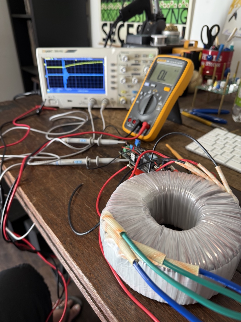

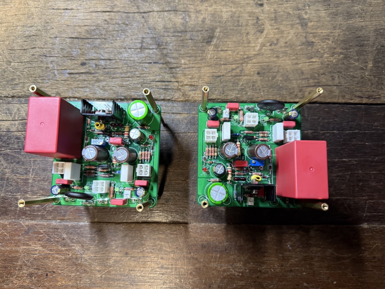

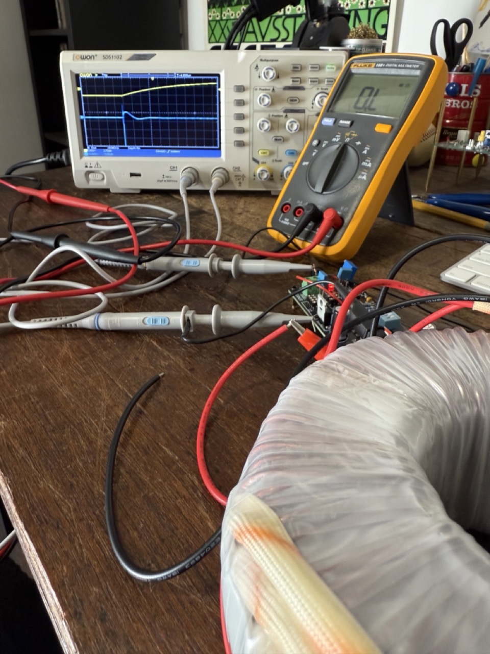

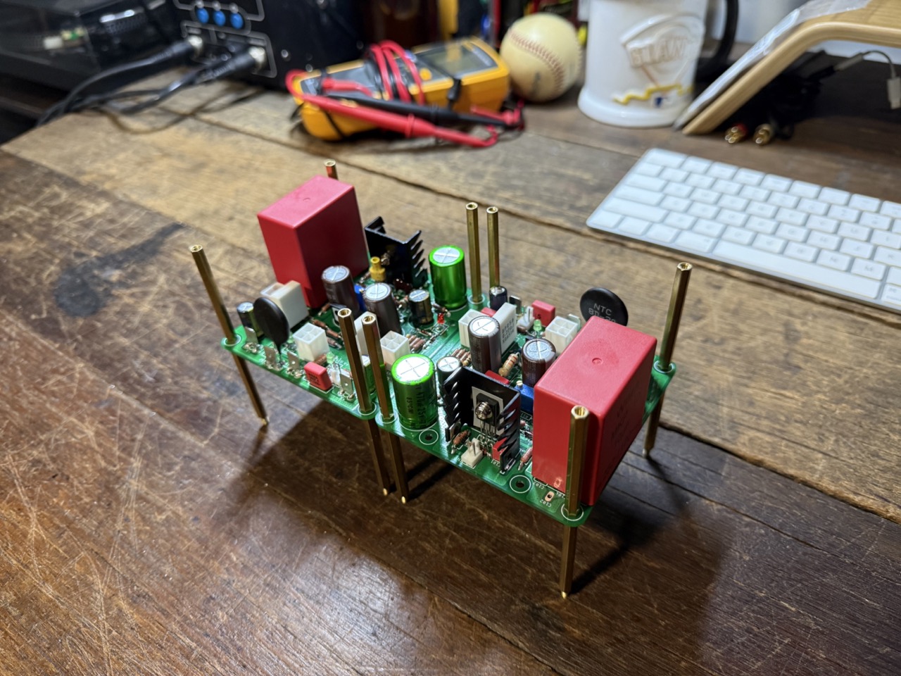

Sharing a little bit of progress on my build. Amplifier boards are populated. I also got a chance to use my Simple BJT matcher for my KSA992's and the Quasimoto to determine my snubber values for my transformers. I confirmed the phase of the primaries and secondaries on my Antek's as well. This will be a duel mono 8 Ohm version of the AN39 with these transformers. I did go with the 22V Secondaries. My plan is to use a 5U 400mm case.

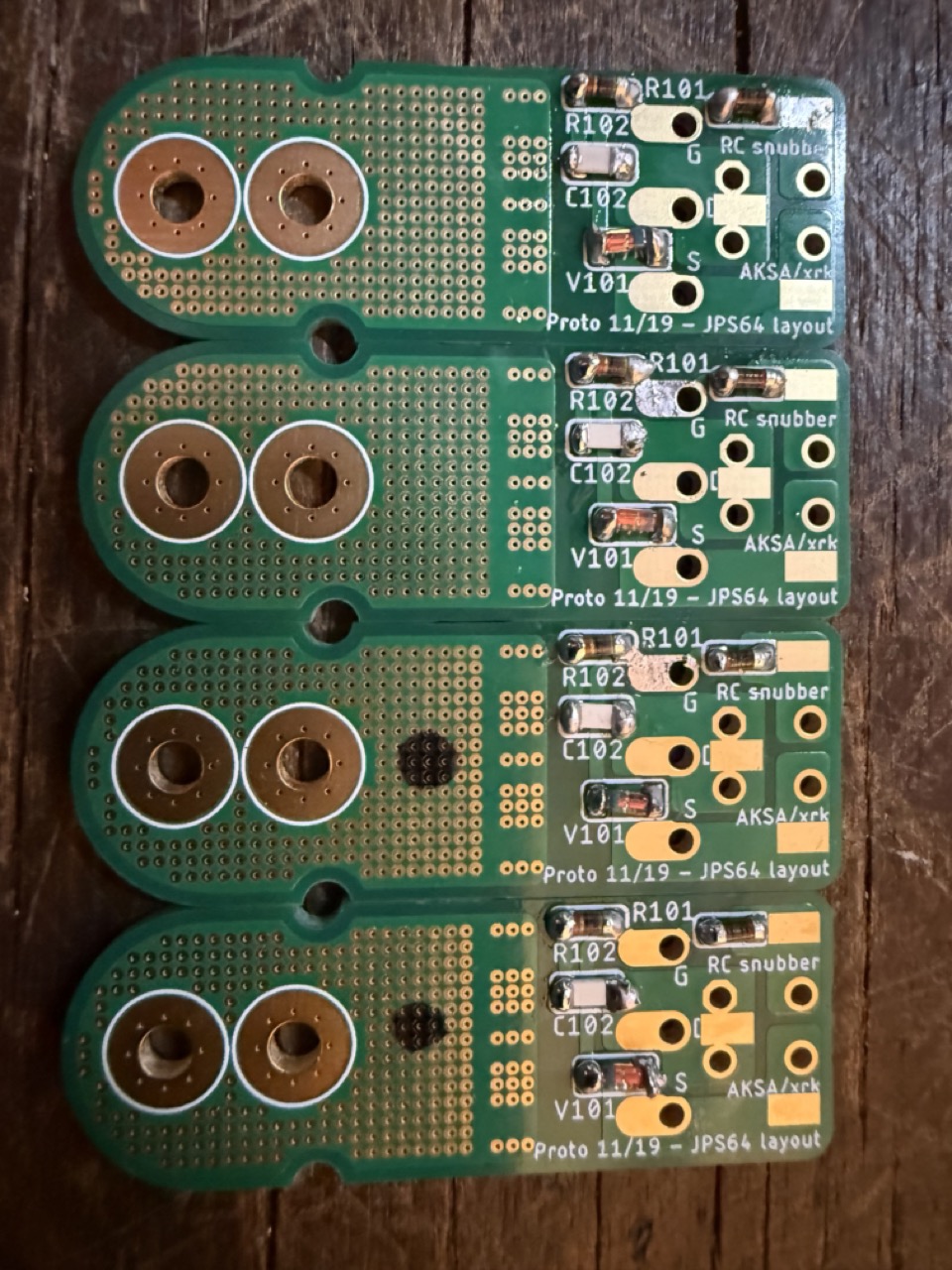

My surface mounts don't look the pretties but I think they will work. 🙂

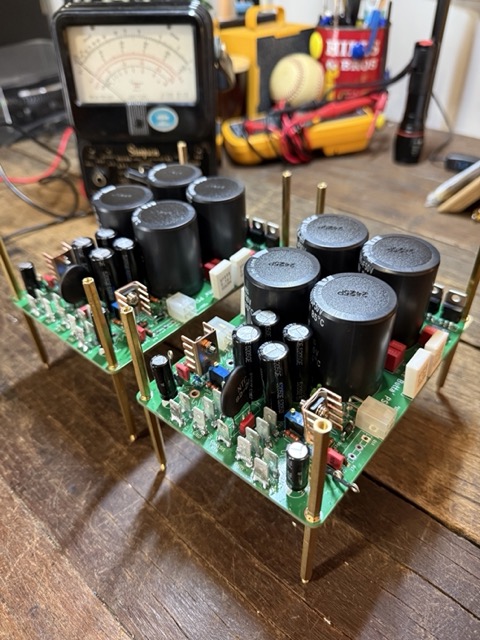

A little more progress to share this week, power supplies built.
