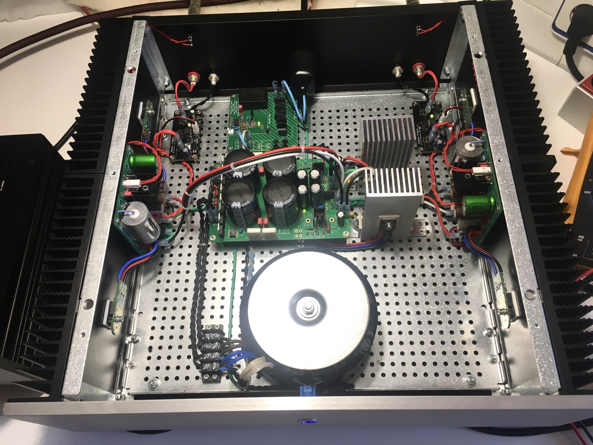

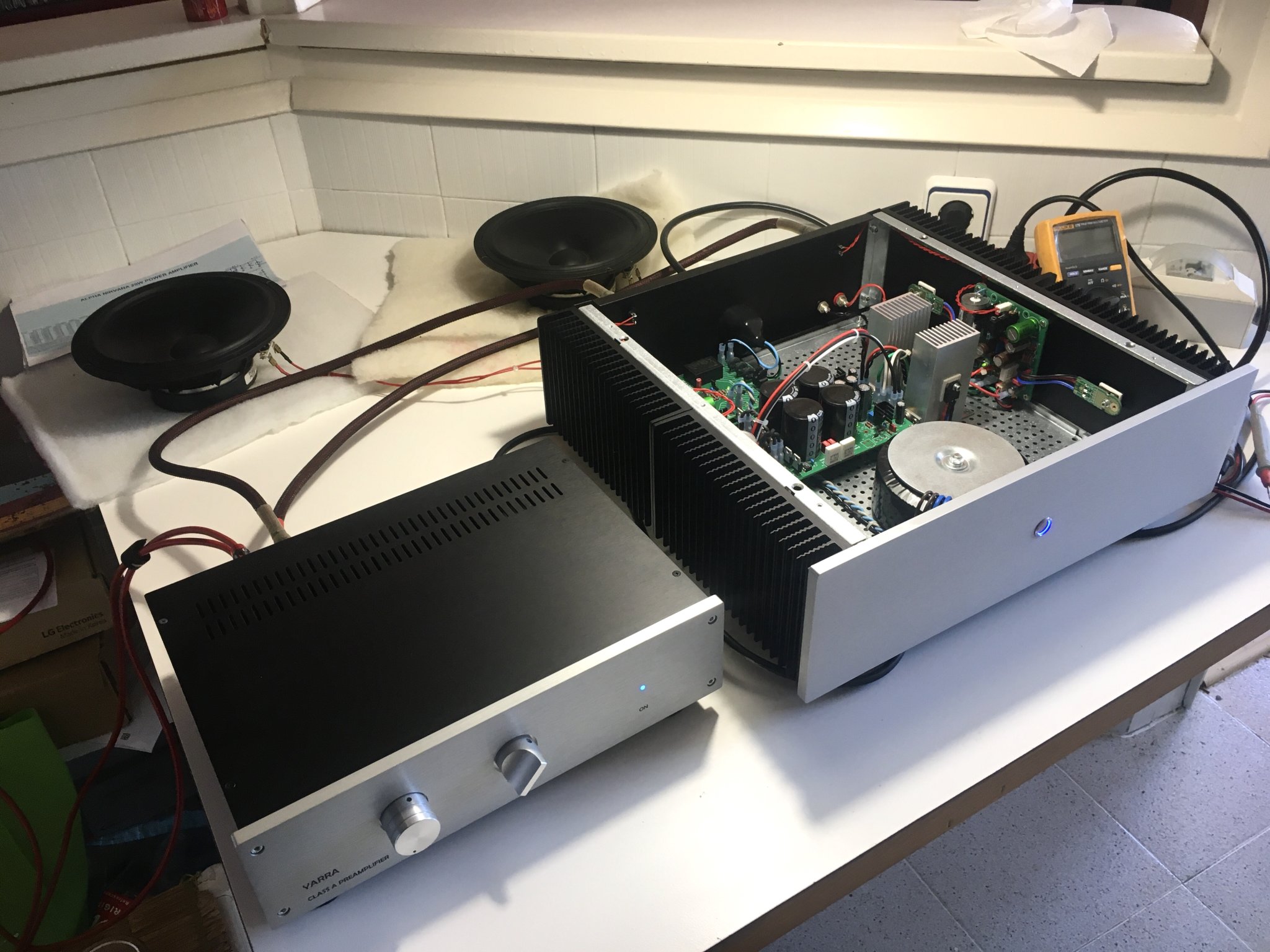

Hi, I am making the final adjustments to the AN 20w//8ohms. For testing used a pair of loose Vifa speakers that I already had. Interestingly the sensitivity and minimum impedance, are very similar to the values of the mid and treble part that will finally feed the amp. As a pair I use the Yarra/Hakuin preamplifier.
Because the sound volume was already very high in the first steps of the attenuator, I had to play with the feedback shunt resistor value R124 leaving fixed R126 of 22k.
I ended up with a R124 value of 10k (820ohms original value). If I am not mistaken this gives a gain of 10dB (27 dB original value).
My doubt is if lowering so much the gain of this amplifier, can produce some electrical or sound profile change. It is the only way I have to tame the attenuator in its first steps.

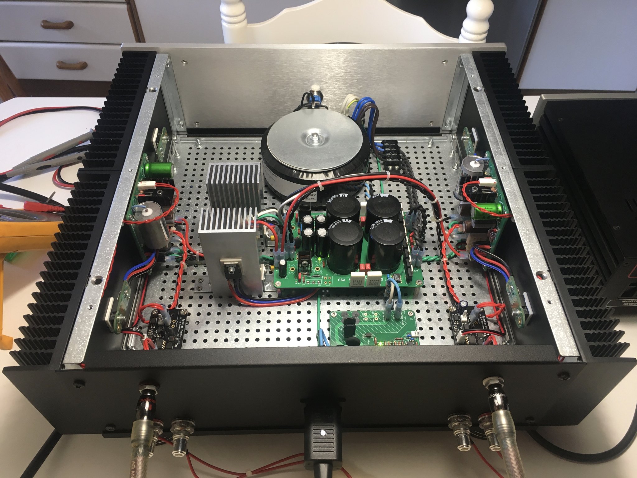

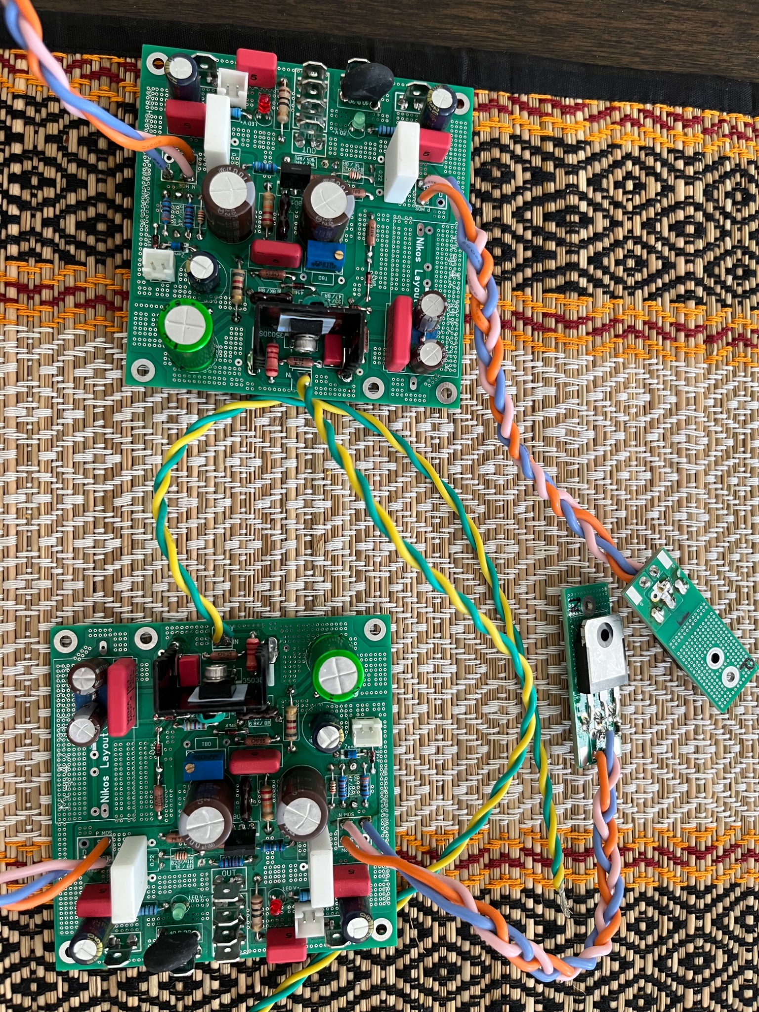

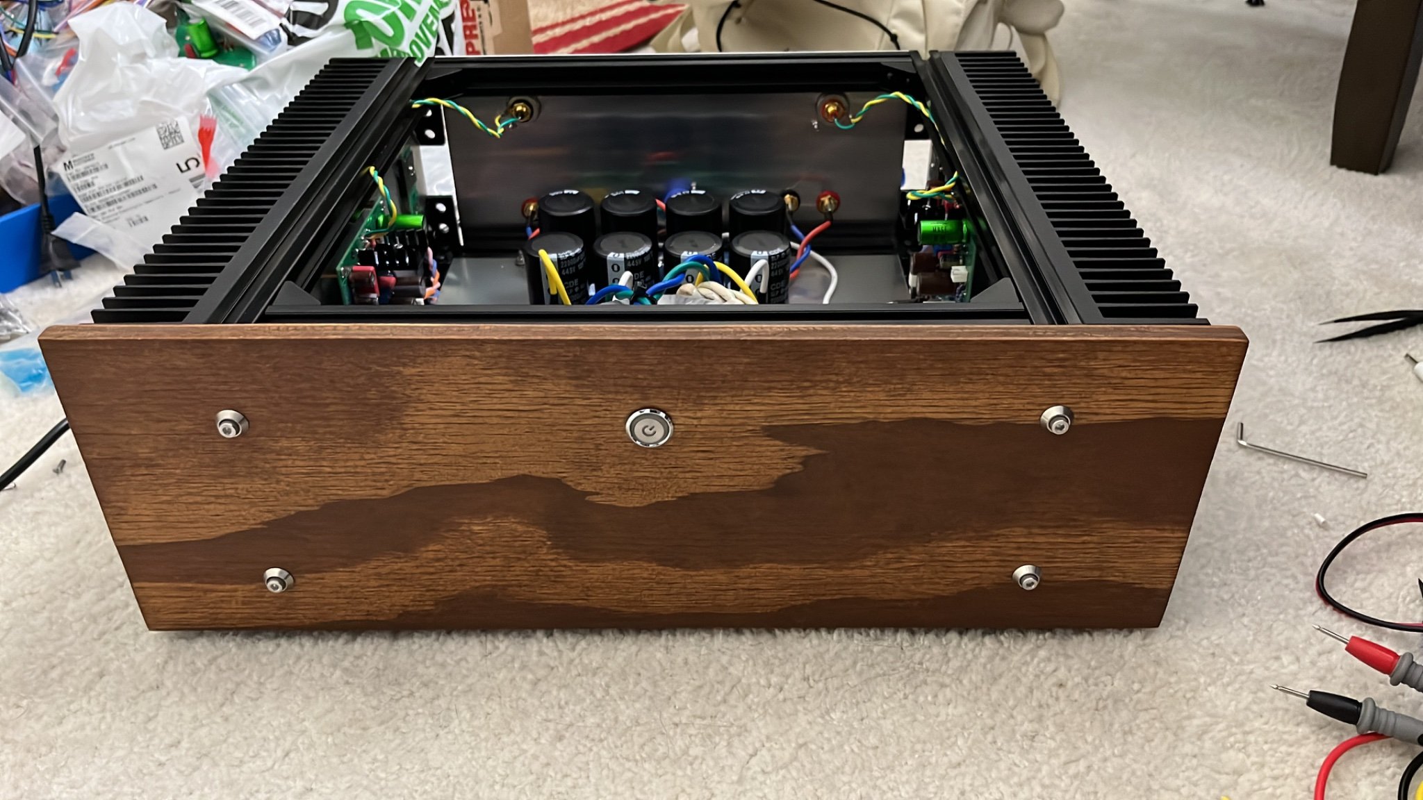

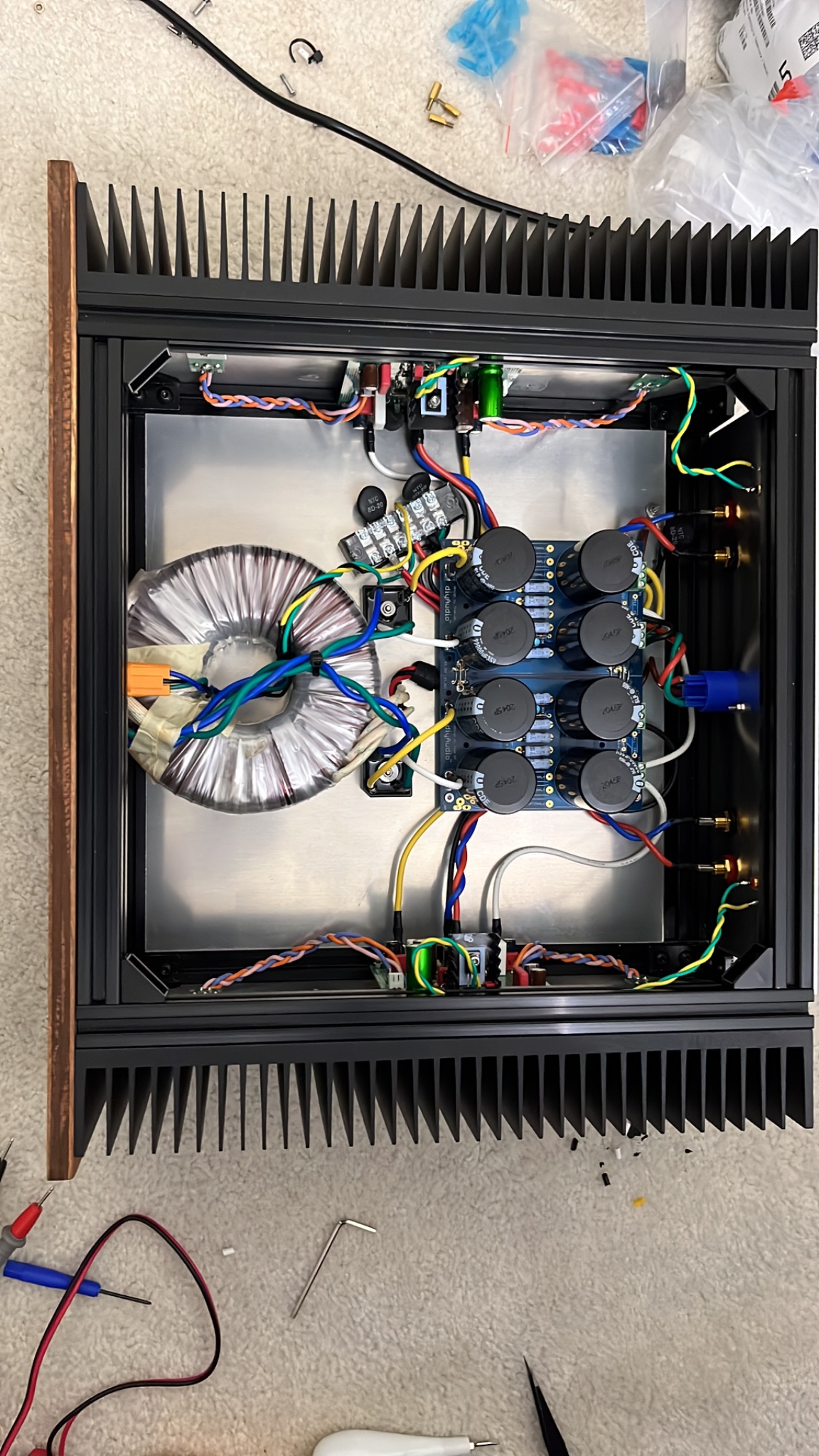

Thanks to @Nikos for giving a set of boards I finished my AN39 amp and it’s playing music. I wanted to build a 4 ohm version of this amp to power my PAP clone speakers. Heat sinks are 350/150/55mm so they are hot to touch but with Midwest cold winters it’s a good room heater. Initial impressions is it’s good amount of power and a very tight base, dynamic soundstage. I can now even listen with less than 10% of volume on my HPA preamp compared to my other amps.
