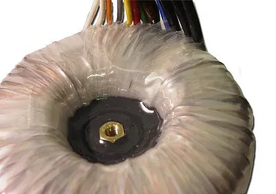

Hey! Sometimes toroidal transformers get hot from induction heating the mounting screw. The reason is high current flowing continuously. You should check if the screw on the tranformer is warmer that transformer itself. I had some issues like this so i decided to attach transformer with a plate of aluminium and 4 holes outside transformer core.

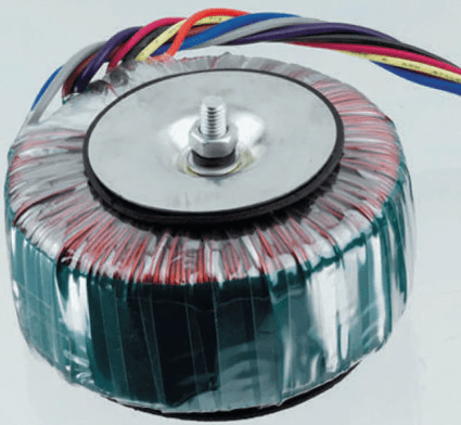

A toroid can only be secured by a centre bolt and plate else you have a potential fire. Everyone should know this.

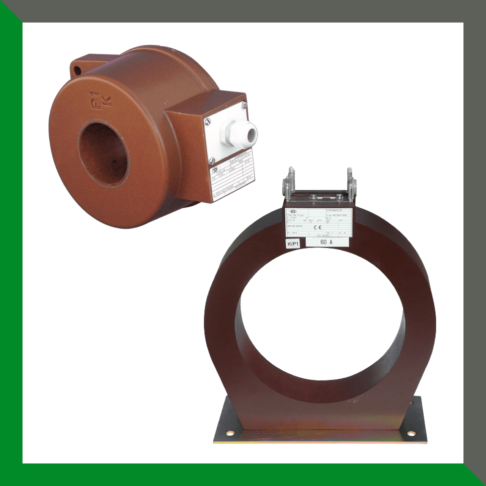

That is absolutely not true! There are also fully encapsulated toroidal transformers with mounting holes outside of the transformer as well as epoxy laminated center nut/thread, upright standing mounts etc.

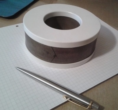

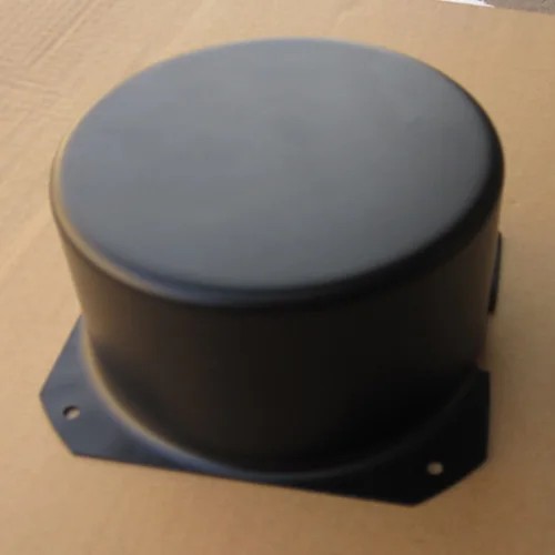

Why not just epoxy it to the mounting plate, use four cable ties, use plastic mounting materials, cement it into a box. let it lie on the floor.... You show a core, what for, mounting it? You show a screening box, if you do not pot the box the transformer will rattle inside. Would love one of those brown things in an upmarket amplifier. Sell that idea to Parrasound or Linn, or MacIntosh, it would really boost their products appearance.
If so - use a 6mm nylon bolt!! 😵
I don't think that 6mm nylon bolt can handle 400VA tranformer. In my case it was 1000VA transformer and i decide to use harder materials.
