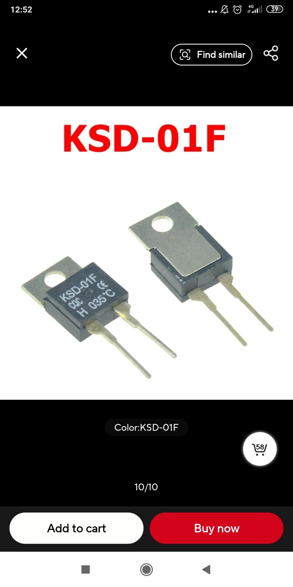

https://www.aliexpress.com/item/32368291387.html?spm=a2g0o.detail.pcDetailTopMoreOtherSeller.2.3359OBrwOBrwWs&gps-id=pcDetailTopMoreOtherSeller&scm=1007.40050.354490.0&scm_id=1007.40050.354490.0&scm-url=1007.40050.354490.0&pvid=e43d7f66-5bfb-46ef-a50a-90246dae1aed&_t=gps-id😛cDetailTopMoreOtherSeller,scm-url:1007.40050.354490.0,pvid:e43d7f66-5bfb-46ef-a50a-90246dae1aed,tpp_buckets:668#2846#8109#1935&isseo=y&pdp_npi=4@dis!EUR!1.52!0.93!!!1.65!1.01!@210385db17266526801378614e2f28!12000028863493626!rec!GR!134849728!XZ&utparam-url=scene😛cDetailTopMoreOtherSeller|query_from:
Has anyone used this component to interrupt mains 220V trafos?

I think these are used in a lot of generic class A soft start circuits that also will shut down the supply at a given temperature.Has anyone used this component to interrupt mains 220V trafos?

80 watts of power dissipation plus signal leveling, the little rascal can't take it - guaranteed!I'll see if I can get a TO-220 BjT and a resistor to run continuously on 40 volts, 2 amps;-)
I already have cuffs on the Bub and his sister Babe - the TO couple can just about cope with the thermal stress there. AN39 is a completely different beast.
have fun,
HBt.
Why BJT? - we are building push-pull MOSFET power amplifiers here.
