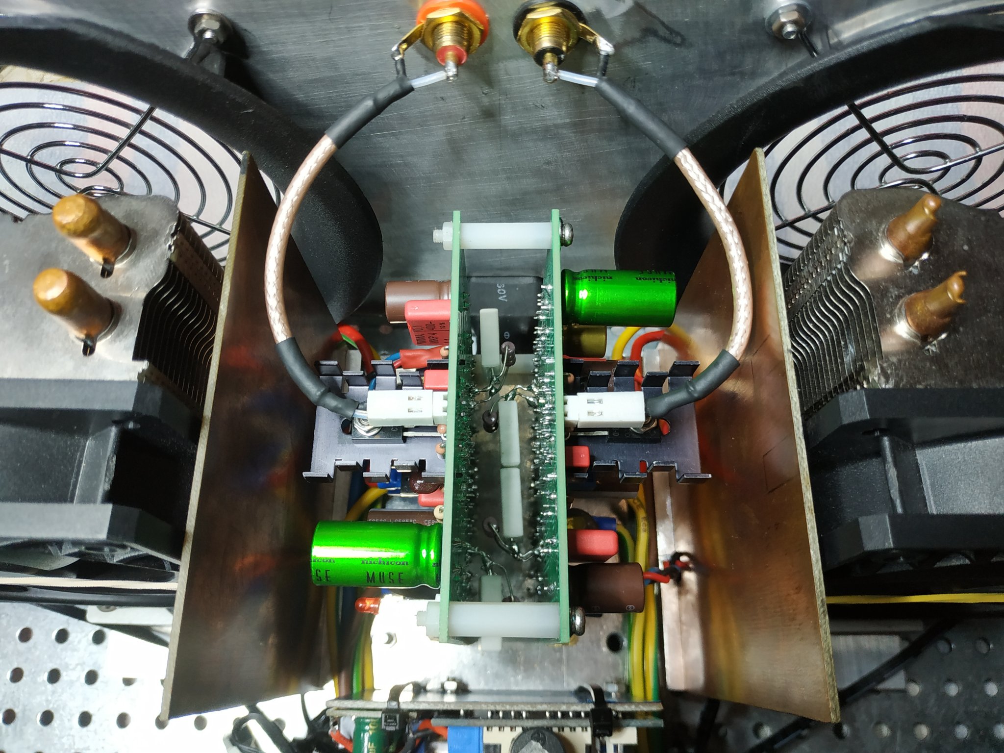

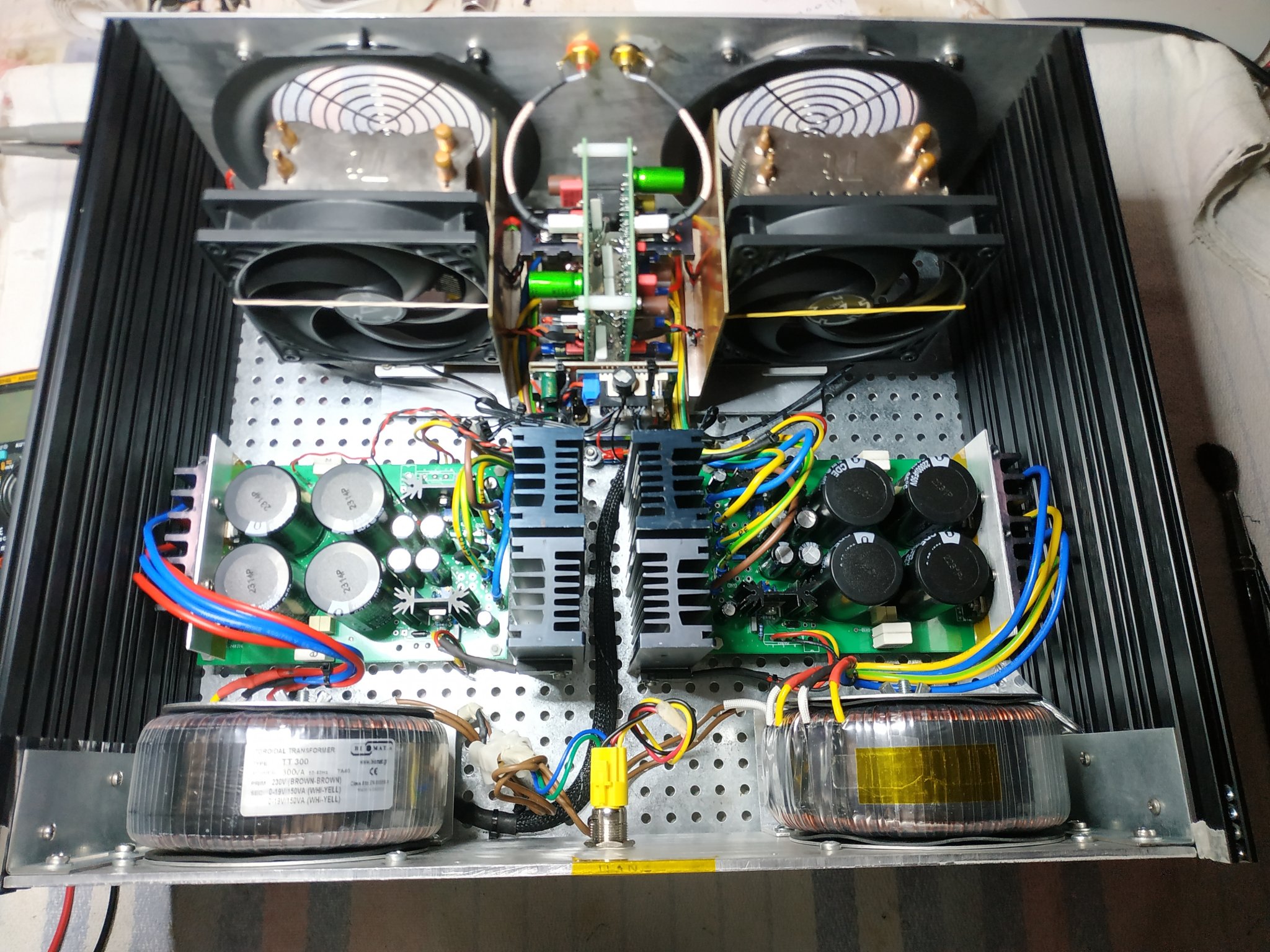

I made some changes to the input wires ..double shielded and silver I think With a simple multimeter Rms the measured noise on the scale of millivolts Ac 0.200mv and the other channel 0.400mv ac The fan controller is powered from this channel. which meters noise of 0.400 ac mv All this with the input NOT short.
My bias is at 2.6A. 0.15Ω+1Ω parallel.
AMAZING AMP!!
CPU coolers are a great way of getting rid of heat quickly. Well done/
Nico not only.It weighs much less, you can move it very easy , and the most important ha ha ha in the winter it will also serve as a heater. With the high price per kilowatt hour here in Greece the usage should be disappointing but the sound quality is very rewarding. 1 kwh = 0.15€ _ 0.20€ They have introduced the price of the kilowatt hour to the stock market and the Greeks They are saddened by this but they are not listened to...primarily the profits of private companies .

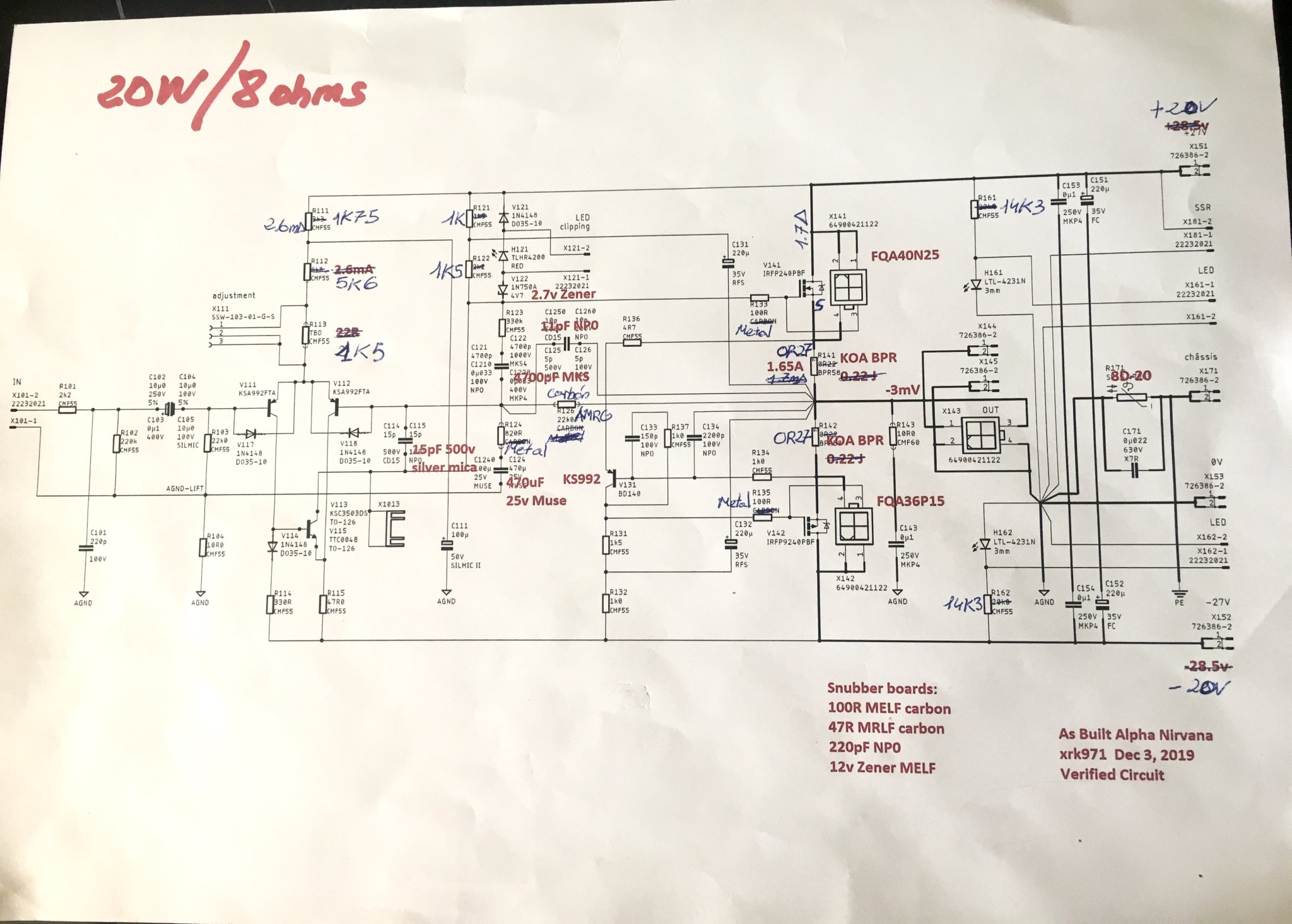

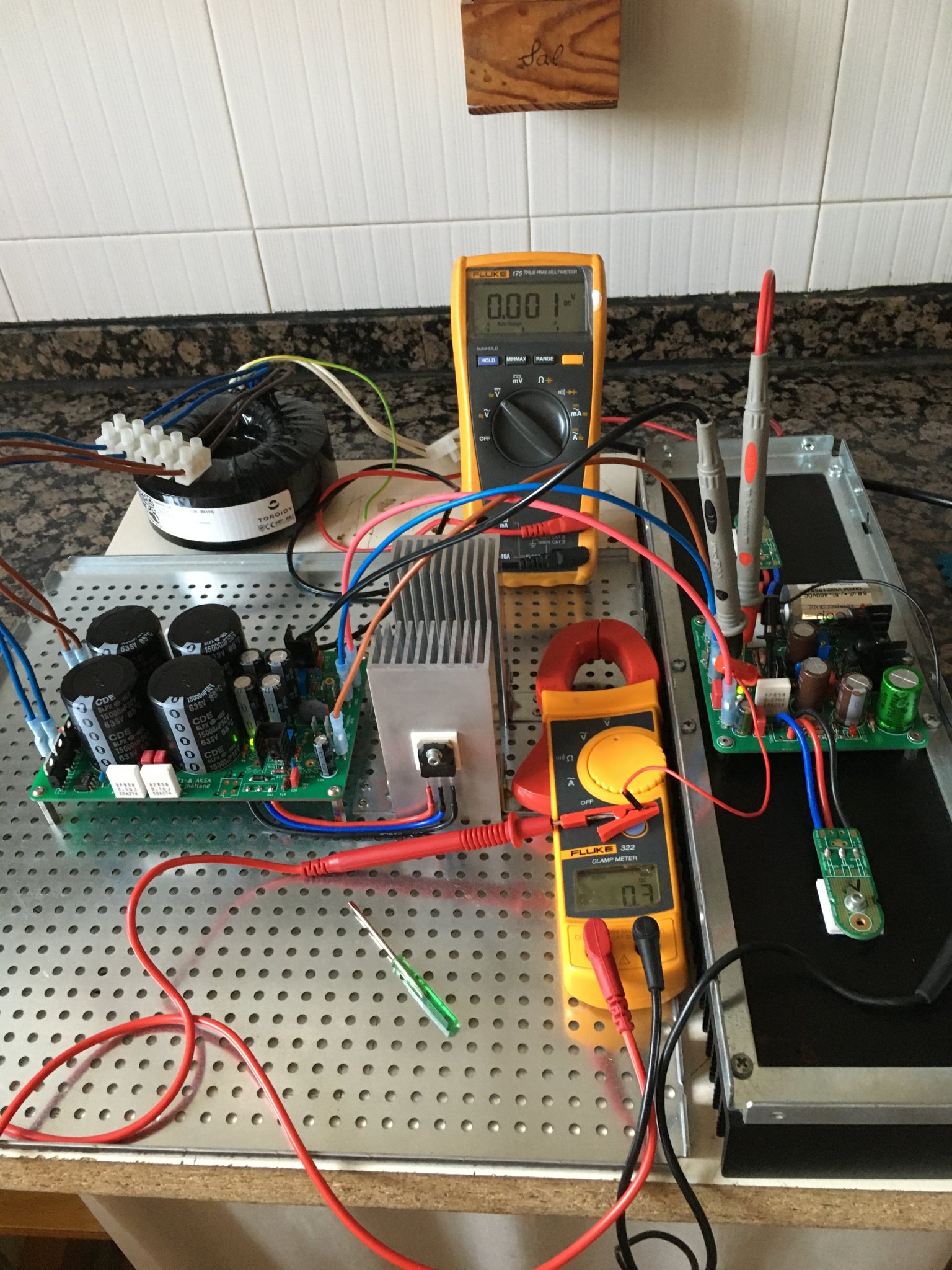

Hi, I just started testing the parts of my Alpha Nirvana 20w/8ohms. SFP soft star and SLB power supply are working properly. The transformer is a Toroidy 2x18v/400va.
These measurements are with a single AN channel.
The transformer output 19v/19v and the SLB output +/-23v (both should drop a little more when connecting both channels).
The voltage at R111 (1k75) is 4.6v set with potentiometer R113 (1K5) which set to 1K1 gives 2.6mA for the LTP stage. DC offset 19mv.
I have a question with the voltage measurement of the source resistors R141/R142 (0.27ohms). This voltage is 340mv and using the ohm's law:
I=V/R=0,340v/0,27ohms= 1,25A. Shouldn't this measurement be somewhat higher? Something like 1.65A/1.7A?
The truth is that looking at Mr. Hugh's simulation, the voltage of the source resistors is similar, slightly higher 354mv, so I=0.354v/0.27ohms= 1.3A.
Thank you in advance and best regards
The base bias of the sensing transistor V131 draws quite a bit of current which increase the required drive. In most cases R134 drops about 100mV so this requires more than the expected 0.65V across the combined sense resistors, R141/R142.
Hope this is clear; I am somewhat wooly headed this morning!
Hugh
