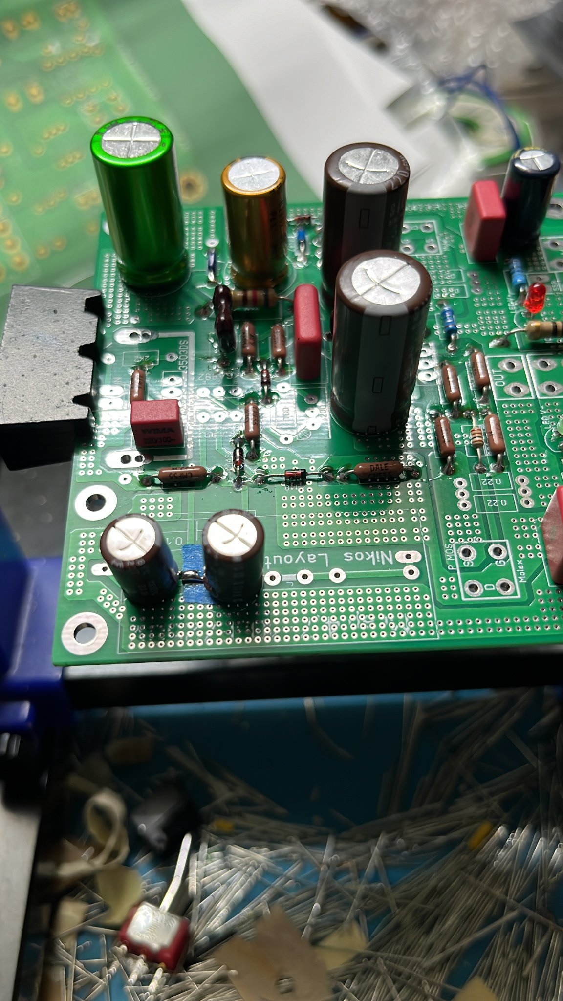

Sounds very nicely clear and detailed over headphones. Congratulations 👍Some first tests with the two-channel operation. I need to decide the bias current setting at 2.2A or 2.65A. The first impressions analytic amp deep extended bass with a big 3Dstage .

I got one side working. Sounds good and will play with it after I get the other side working. Both sides are running 28.5v rails. Admittedly when I hooked up the npn to the side that isn’t working properly I had the gate and source on wrong sides. When I switched them back I got the funky measurement on the transistors. Any Ideas?

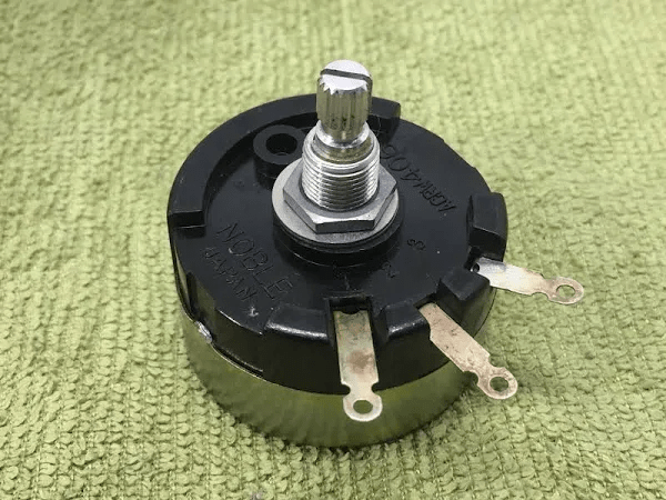

Use the wire wound pots that was popular in front and back speaker control for vehicles, they were about 15 watt rated and low value. The pic is from Noble. You can place a fixed resistor in parallel to make very small adjustments.
If they were used for spkr control in cars - I suggest they would be up to 3 or 4 ohms, max. So not so good for changing between 0.1 ohm and 0.2 ohm.
And how do you exactly match two of them (to equalise L & R channels)?
Know anything about paralleling resistors. You can adjust the value exactly. This is school maths. Obviously to adjust two you need two calibrates multimeters. Use two light bulbs and adjust for the same brightness, or two motors and adjust for the same speed, or place two fingers on them and adjust for the same temperature....... 😴 I will think of some more less scientific ways.
