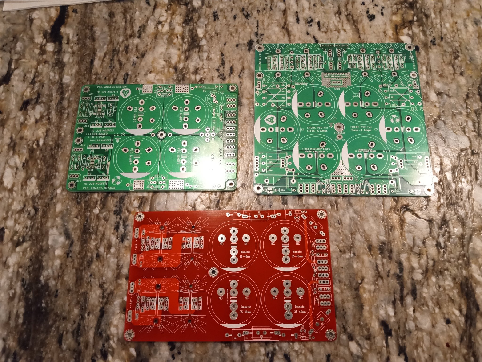

Thanks for the hints and suggestions. If I was going to populate a CRC design for the AN39, it would have to be one of the following in the attached pic as I have 2 of each of them, and do not plan to purchase any other's.
Which one would you choose, the red colored Project 16 board (Prasi took this over years ago), the LT4320/CRC board, or the CRCRC board, and why would you make that choice.
I am planning to refurbish the SLB and get it working, so the above is for curiosity and knowledge and as a backup if things go really wrong with the SLB rebuild.

Myles,
Two more follow up questions for you:
1. Can you please share a pic of the chassis that you are planning to use for the AN39 build?
2. What is the AC voltage of the transformers you have for the project, and what make/model?

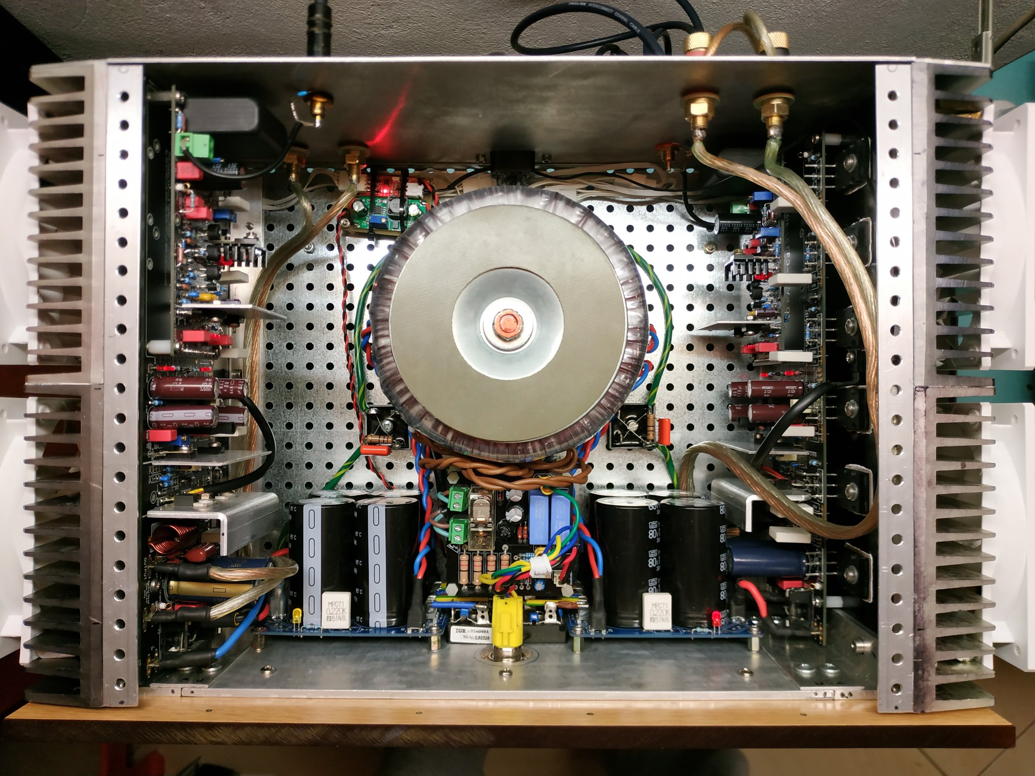

Hi MMIf I was going to populate a CRC design for the AN39
But if you populate this CRC for AN39 you needed different voltages trafo....

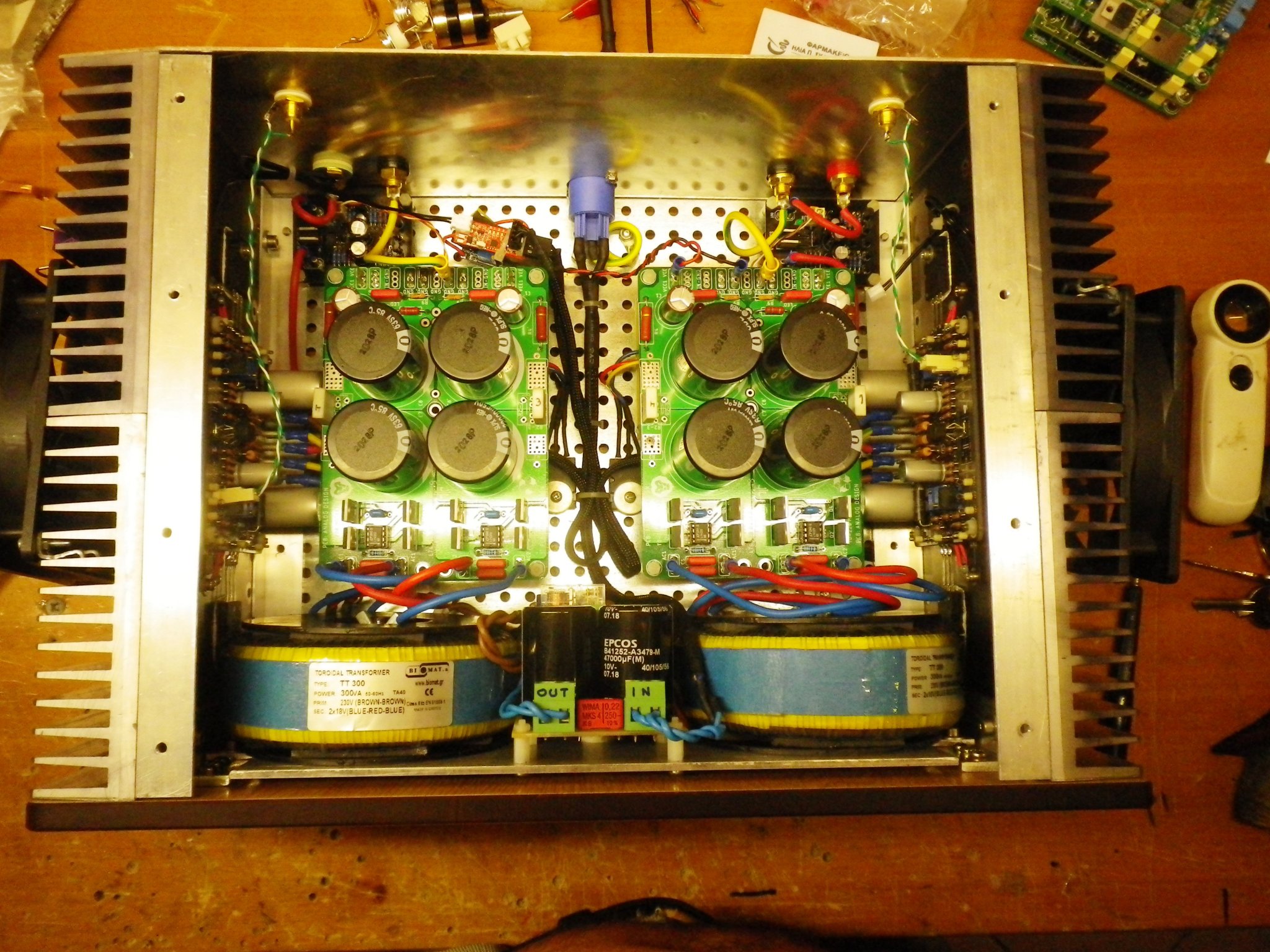

here is my USSA 5 with CRC ...
My litle system 2 x Mimesis 9.2 clone monoblock ,USSA 5, Mirand 4490 dac, Salas dcg3 and 6V6 preamp, Emerald phono and Thorens 280 ...simply and nothing special...also Wolverine and ALPHA NIRVANA amps added ...

MM,
With a standard CRC power supply and 2 x 24V AC secondary transformers, the DC voltage after rectification is likely to be a bit higher (31-32.5 V DC) than what is the recommended value for the AN amplifier. A higher rail voltage will result in more heat dissipation from the output devices.
If you need to use a CapMx to reduce the voltage from the CRC power supply, that ends up defeating some of the KISS (Keep It Simple Stupid) approach that we were trying to get using a simple CRC PSU.
Would you be able to measure how much is the voltage from your transformer secondaries?
