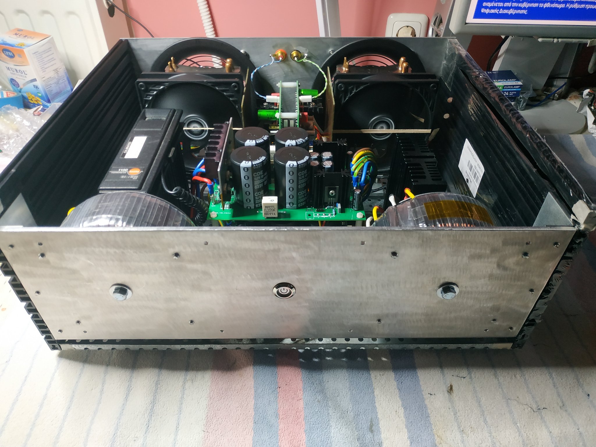

Please use NTC’s instead of plain resistors for the soft start. As I found out the hard way, if your relay ever fails to switch on after a few seconds, the high current will burn the resistors into a flaming mess.
I use two 8D-40 in series and that provides 16ohms series initial resistance. If the relay fails to bypass, it becomes 1ohm and gets hot but not flaming hot.
Wonderful build by the way. I love your double stacking the boards to keep a compact form factor. A lot smaller than my A40 design which is going to production this week. You can see the two NTCs on the soft start in the central board which provides a solid state relay for the soft start and the speaker output DC protection.

Very nice..
Is that big red cap (Wima?) a coupling capacitor of is this a DC-coupled amp?

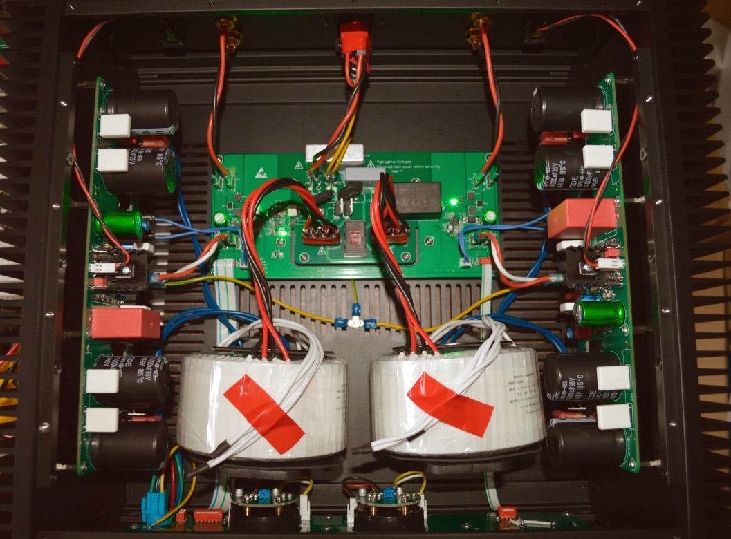

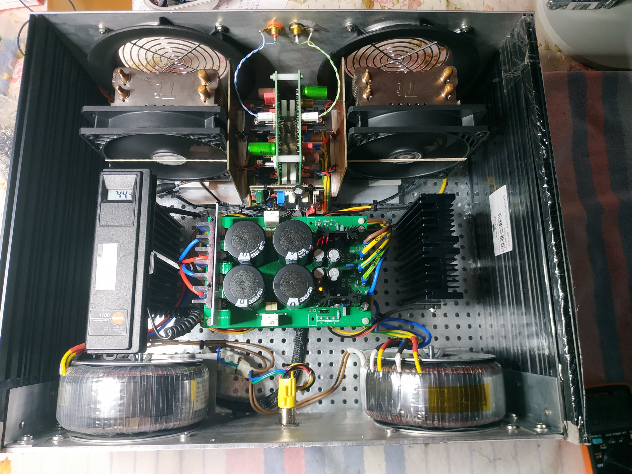

Hi Vunce,
Those are the 2 wires from the secondaries for the low cap psu to be used with the speaker protection module's. I have them on both sides as this is a dual mono build, they are not hooked up, hence the blue tape on the ends.

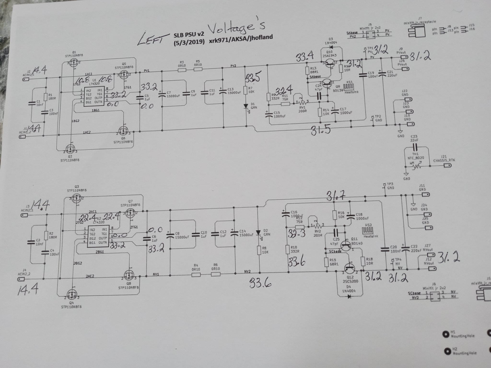

Thanks for the schematics!
You have 2.2V across the large pass transistors for both regs so it looks OK.
If you see 0.6V across BE on Q9 and Q11 then the regs are working correctly.
So if voltage is not reaching the amp modules then it can only be a wire missing or broken so check for mistakes there.
If D1 and/or D2 are not lighting up check the polarity of the led is correct because the voltage tells us they should light. I am concerned about 31.5V and 31.2V at the ground and makes me suspect the link wire from C15/R14/C17 to ground is missing.

I dont finish it yet i need a front plate from wood laminate match to my other audio system. I will use those 8D-40NTC only two in series?
Did you notice any positive difference with the double CRC and classic rectifier instead LT4320 and cap multiplier?
Big tafos....how many VA are they?

Hi Nikos,

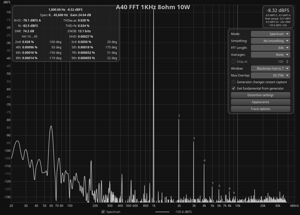

The CRC PSU is quiet enough but not dead silent like the SLB. These are some of the tradeoffs we make for a commercial product. With a well designed CRC, we can get the residual 60Hz main peak to about -80dB at the speaker. Which is not bad because it means you can press your ear to the speaker cone and barely hear a buzz. With SLB it should be inaudible like you cannot tell that the amp is turned on. But that’s why we have DIY, to go all out on amps with all gadgets. I am using custom made 22v 200VA toroidal trafos.
Here is the FFT for 1kHz 10E excitation into an 8ohm load on the A40. You can see the noise floor below the mains peak at 80dB. Also, the very nice harmonic profile of this amp.

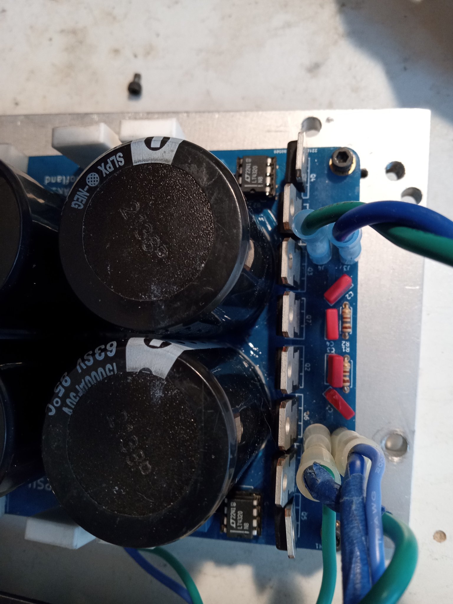

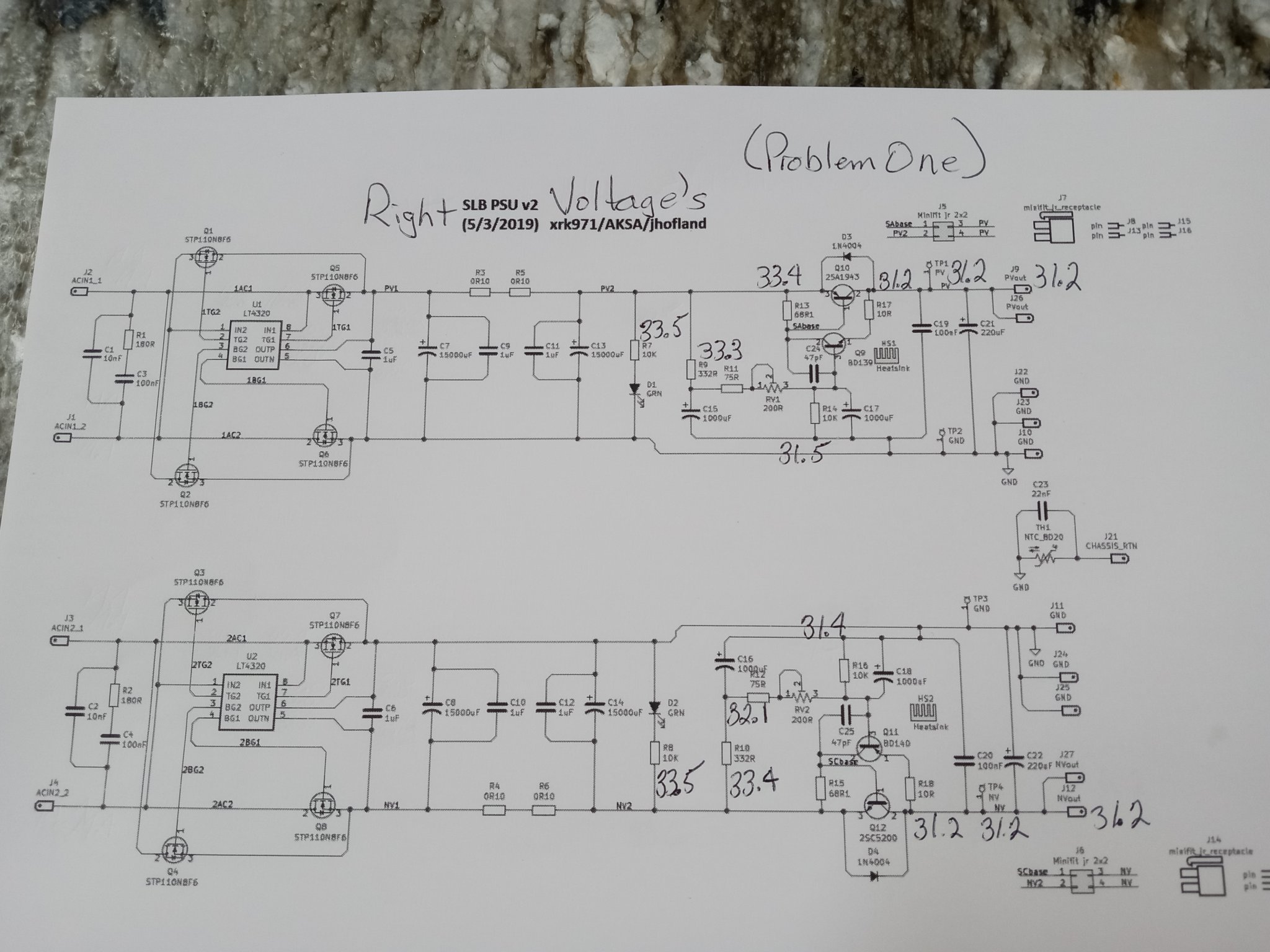

Hugh, X, Nikos, Vunce, thanks for all the help so far. I was measuring the base to emitter voltage on Q9,Q11, and they were 1.7 V not the 0.6V as Hugh mentioned. I went to reposition my self for better access and some how got a short that knocked out the PV side on the good SLB (or so I thought) and it knocked out the SFP also.
So, I have decided to redesign the layout of of the chassis for better access to components, rebuild the SLB's, and find out what happened with the SFP. I am going to begin with a fresh mind and perform test's and record V's as I go along. But first of all I am going to take a break for a few days. Not to worry, I am not giving up
