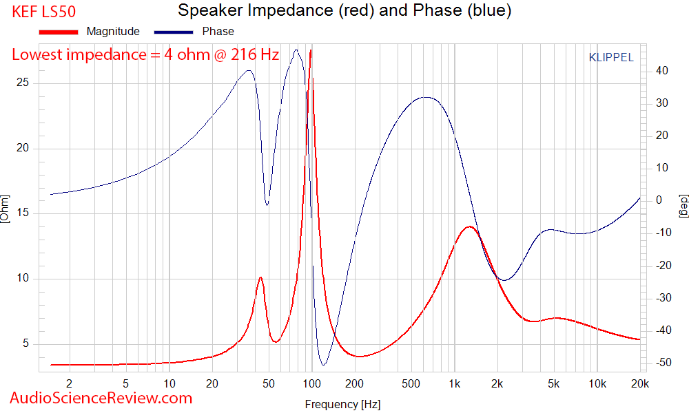

Very definitely 4Ohm!
Here you go with impedance measurement done by audiosciencereview.com for the KEF LS50 from 2020.
That's a pretty wicked plot! 🙁

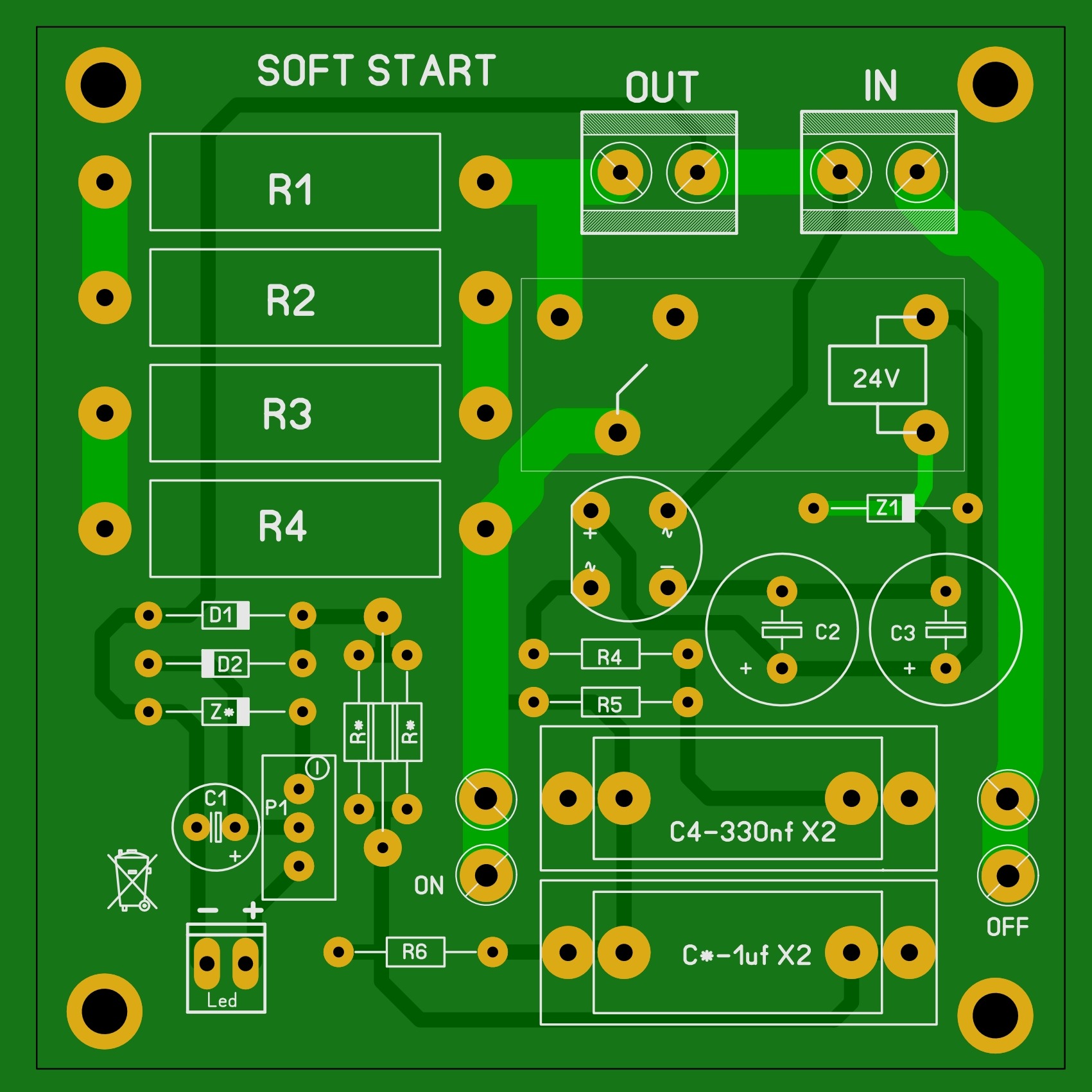

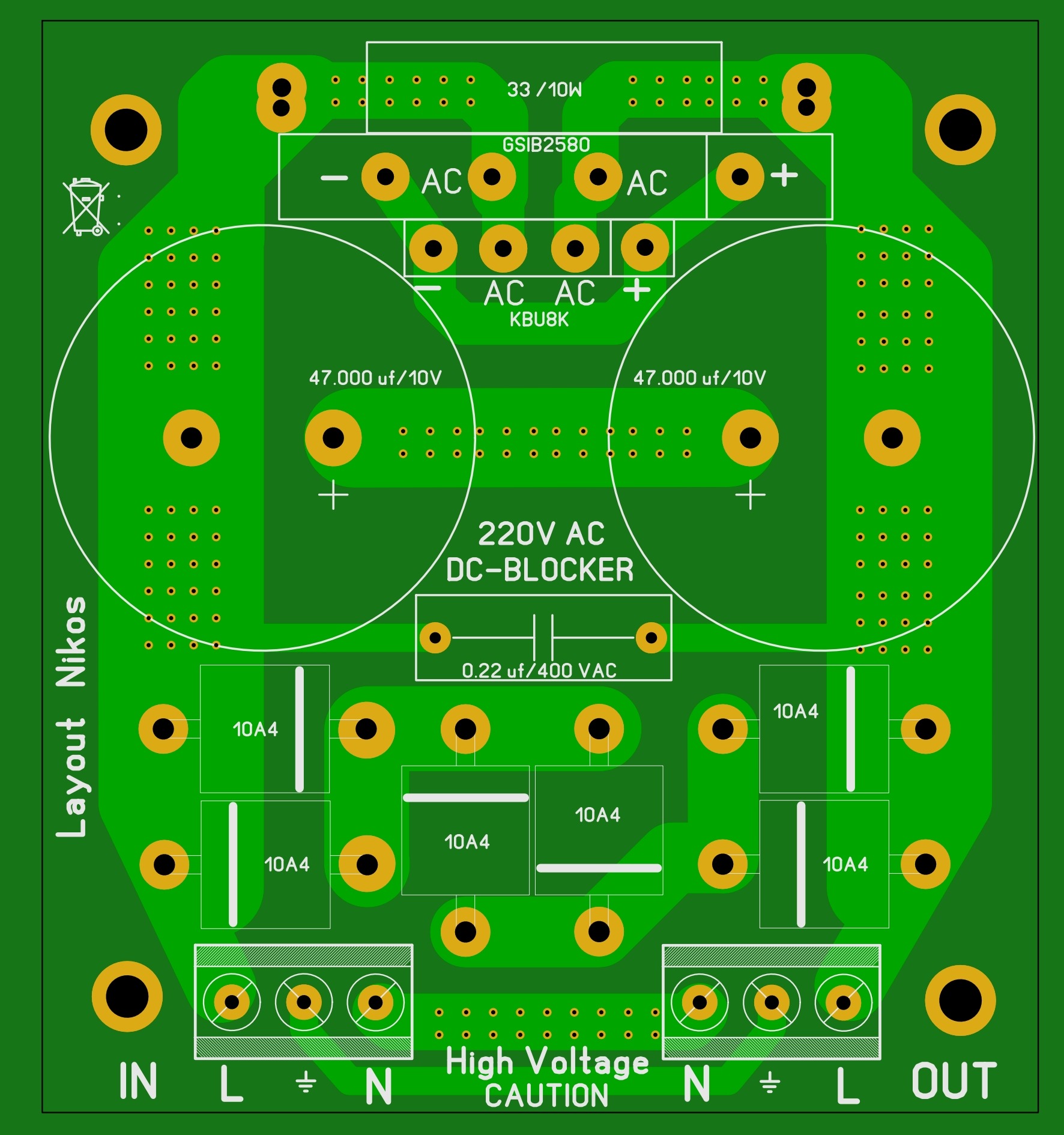

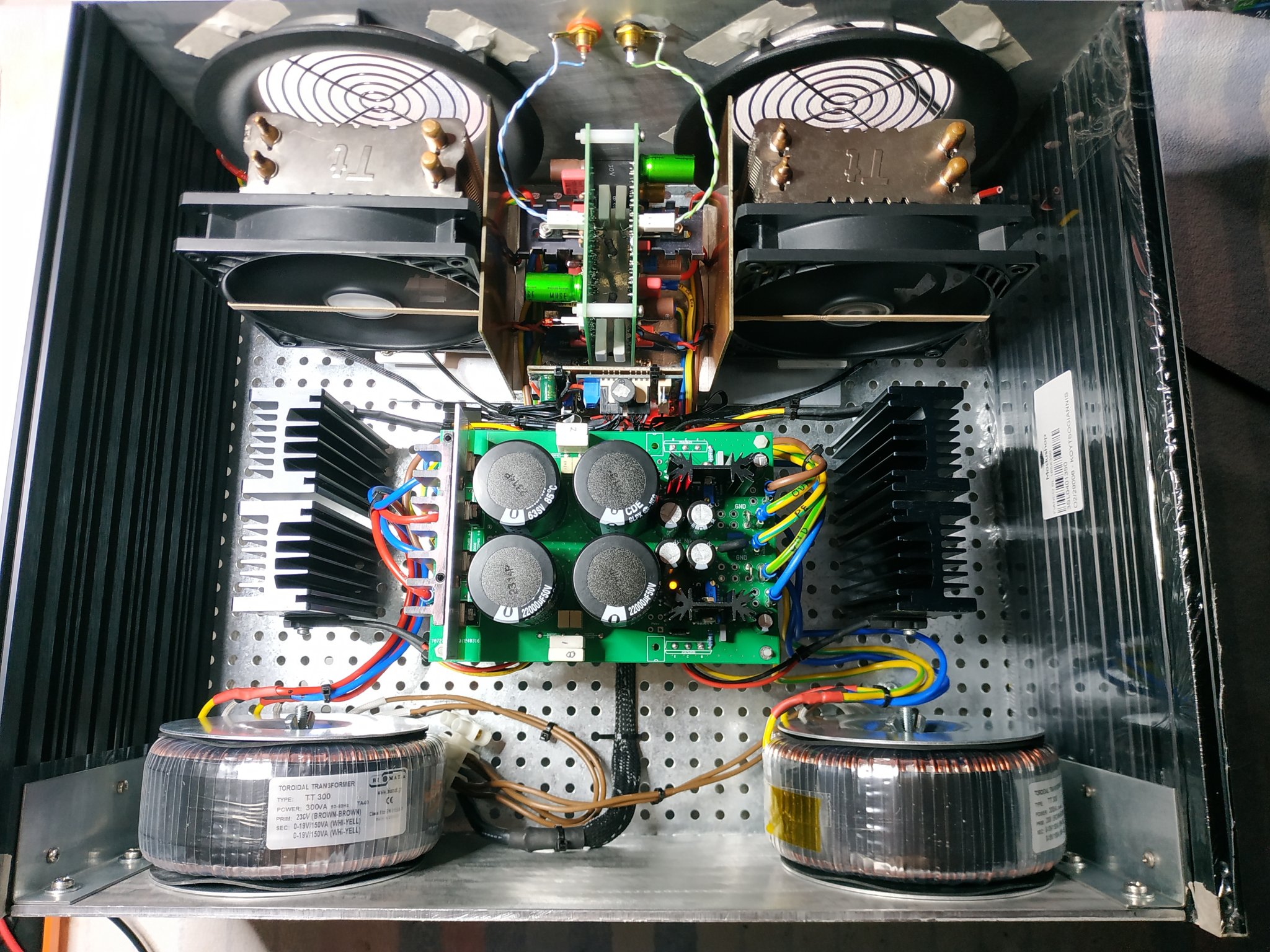

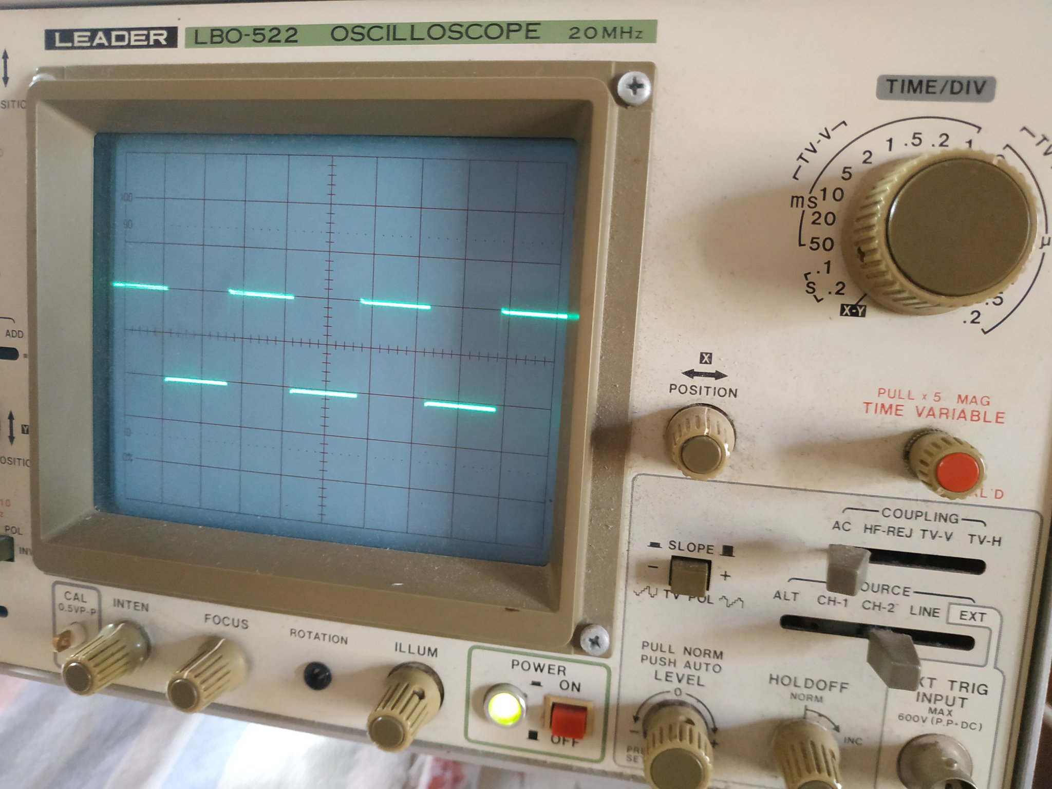

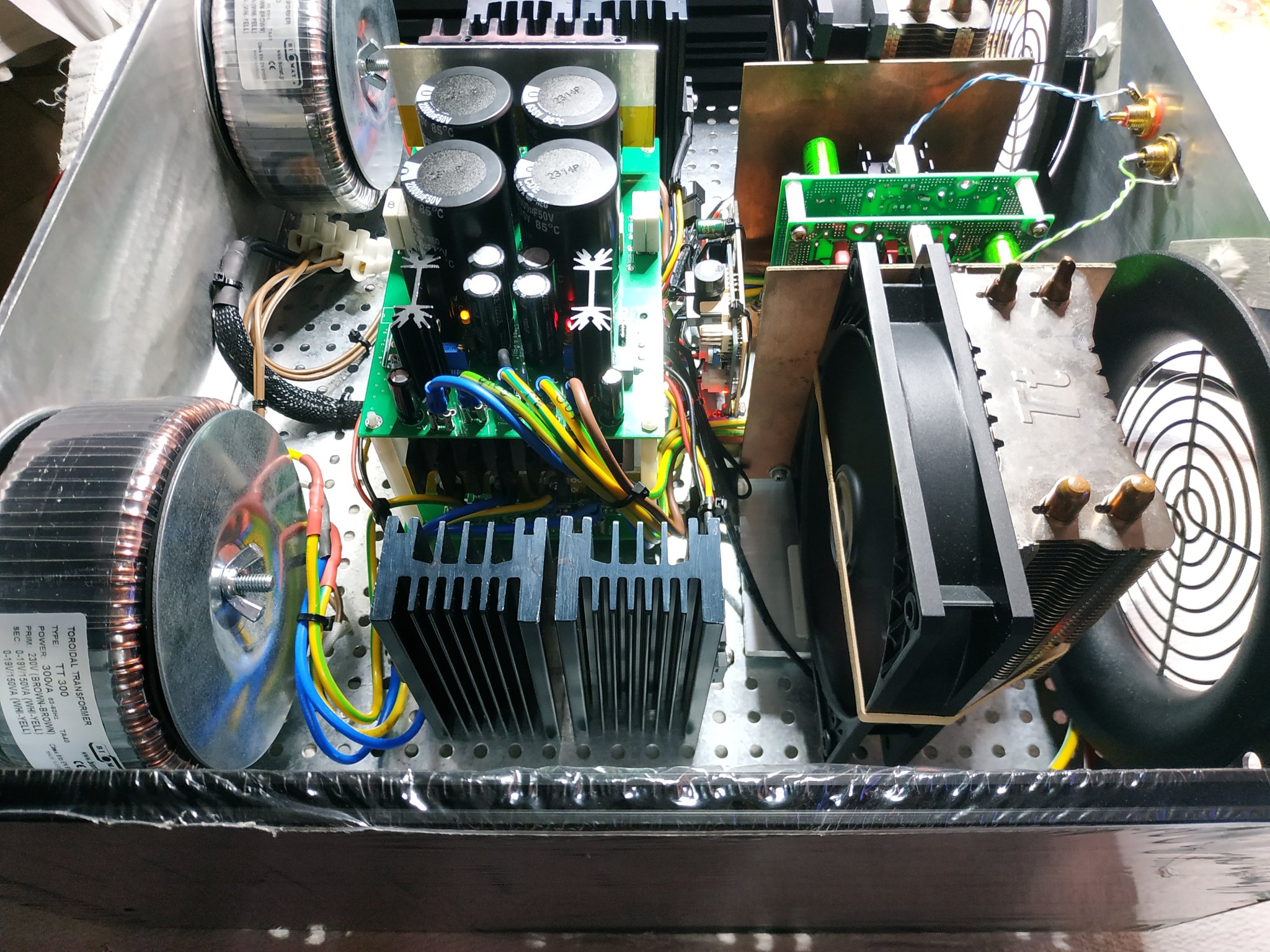

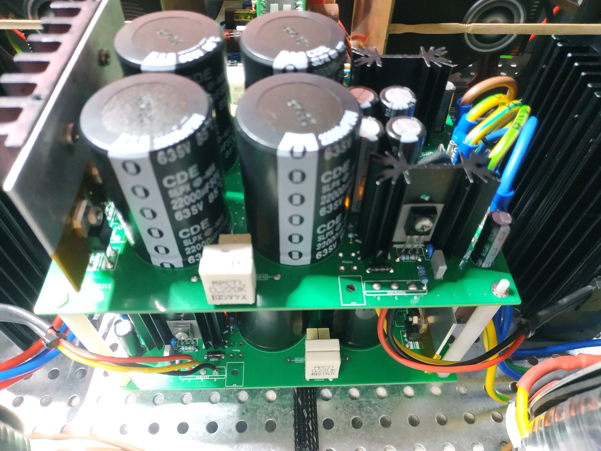

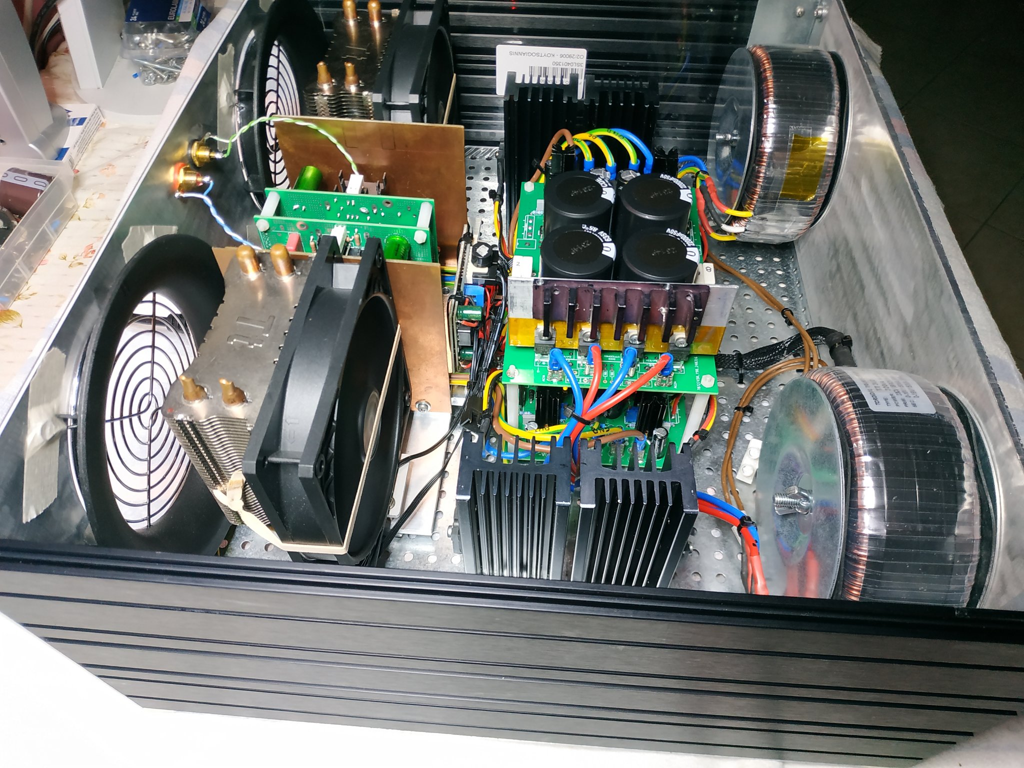

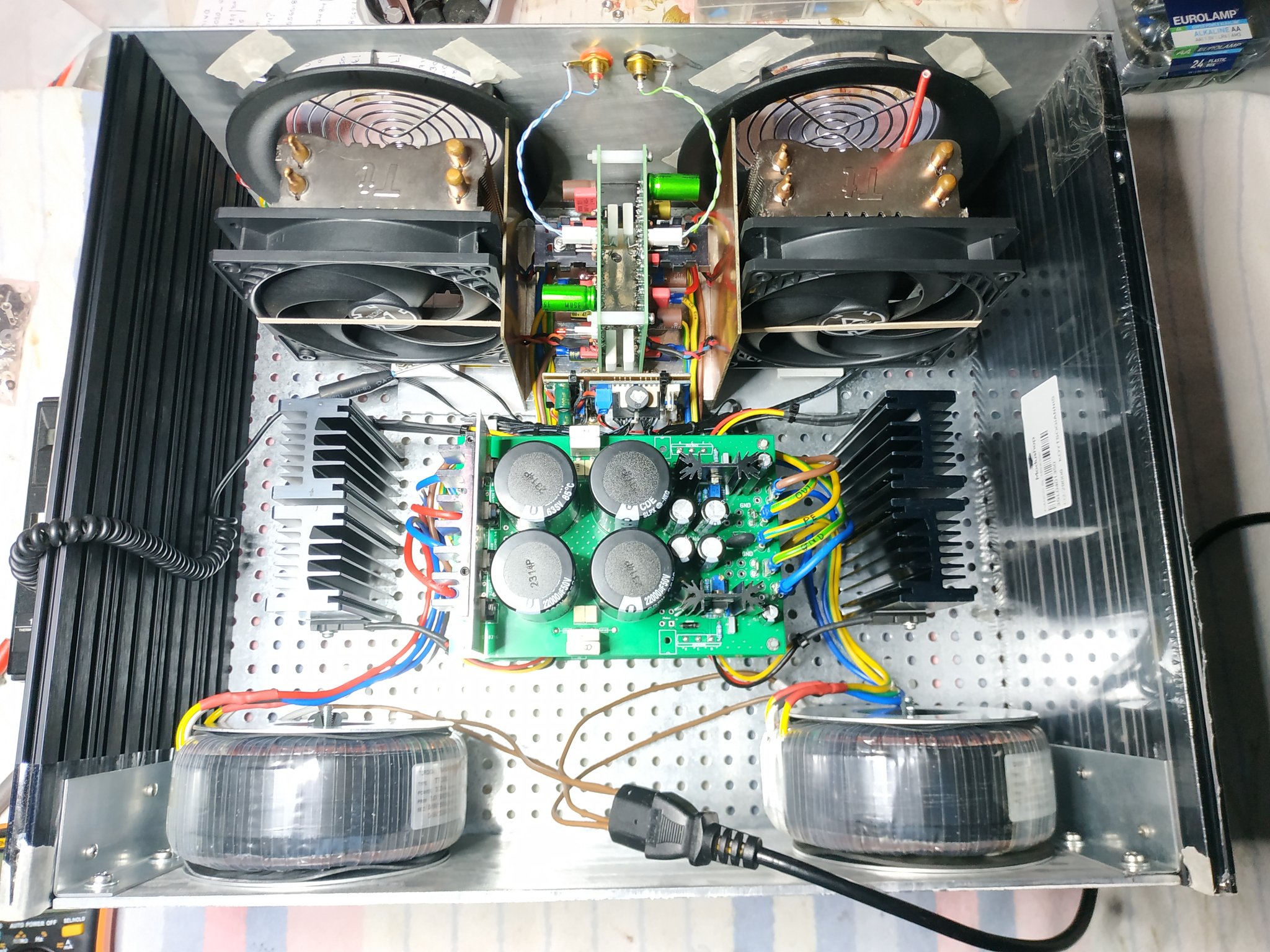

The only thing needed is a soft start board and maybe one dc blocker ....I'm waiting also a couple output conectors .That's how I found the time for some measurements now that everything is in a box. The measurements are without load.

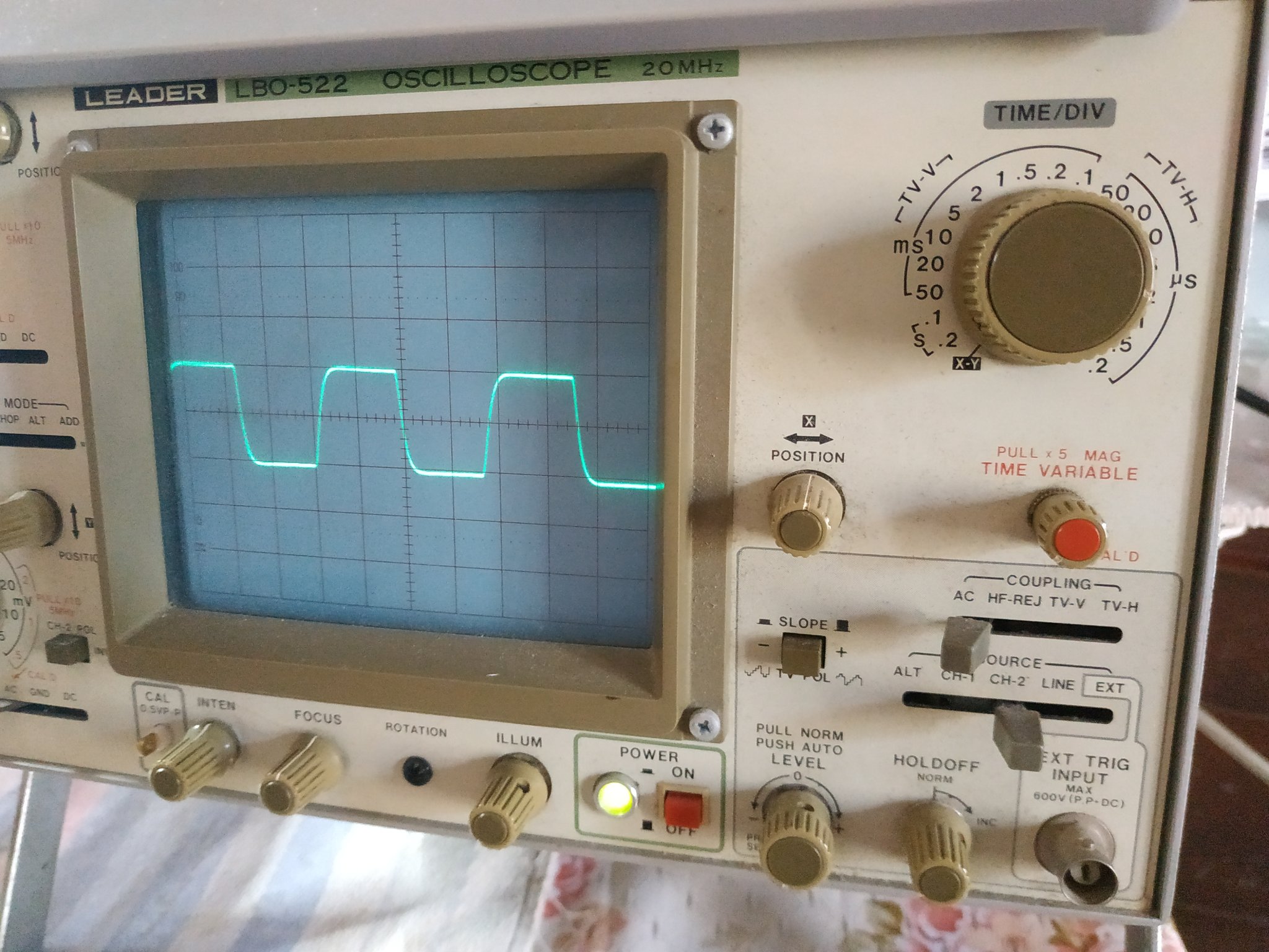

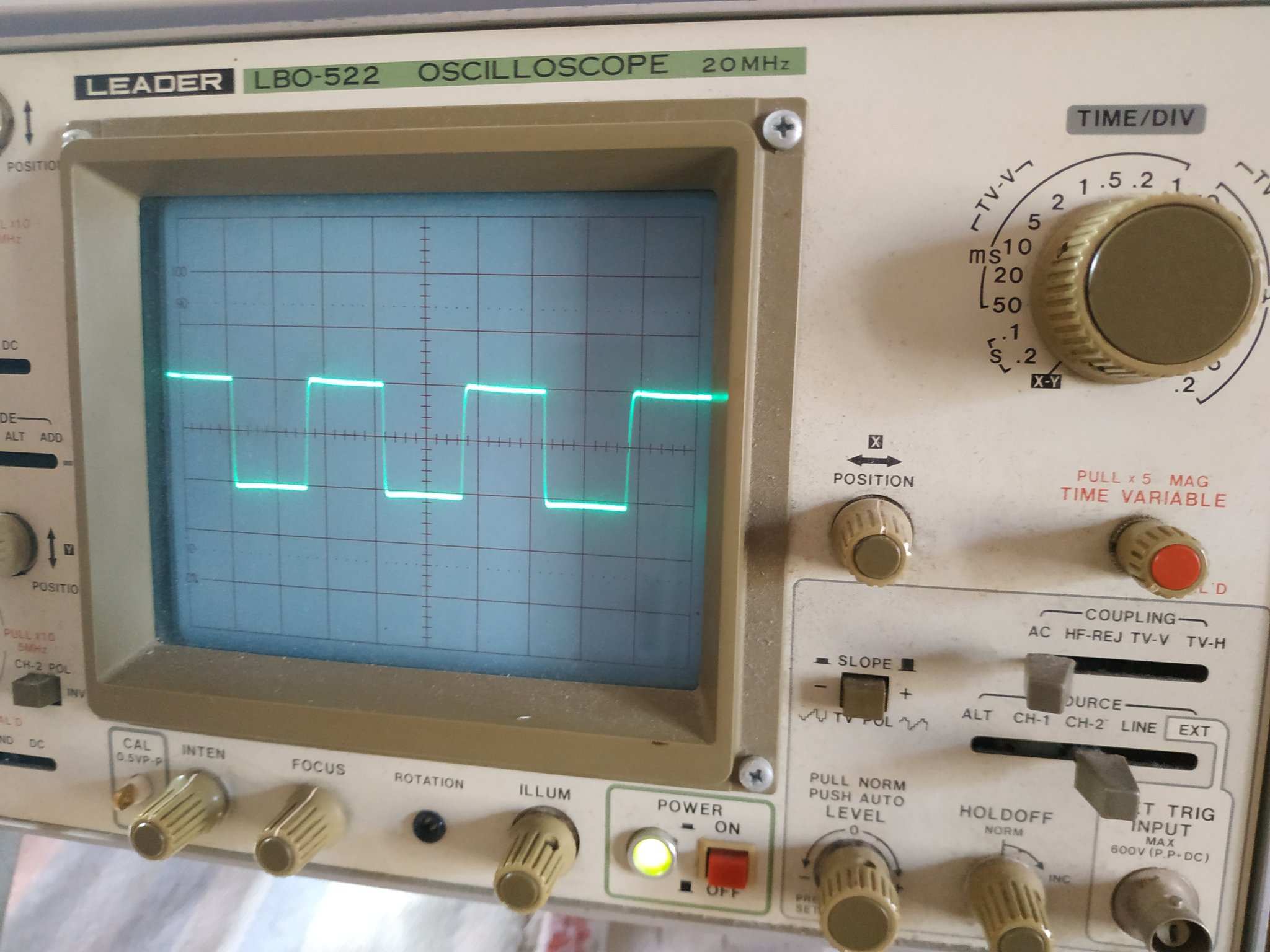

40khz 10khz 1khz square signal.

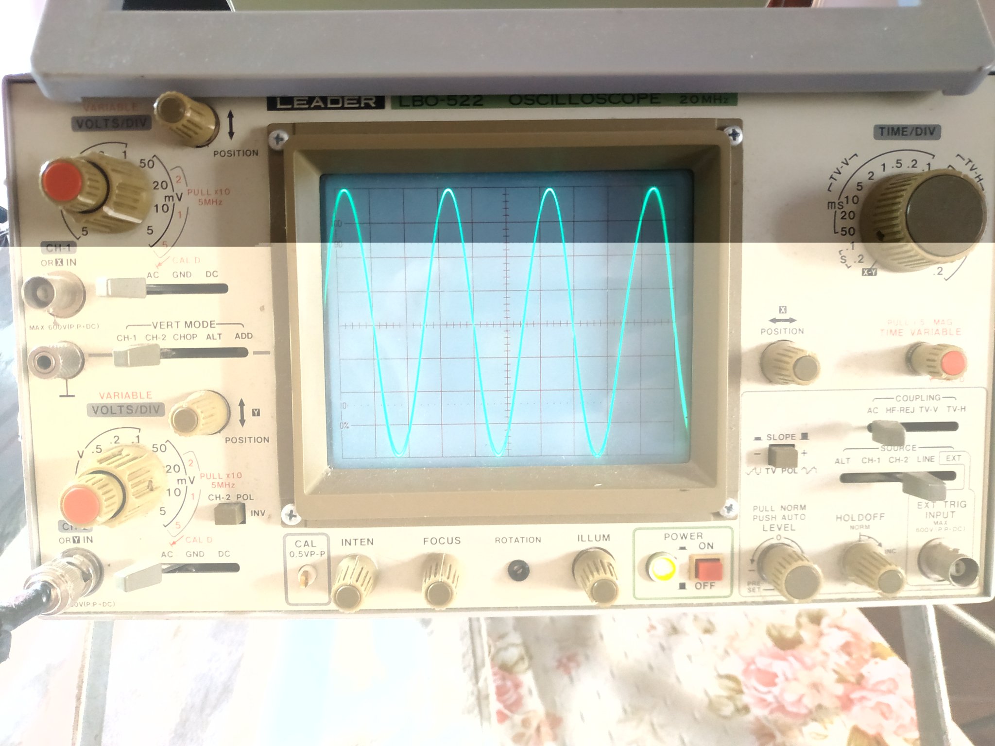

If my old scope measure correctly i have 40V p-p 1khz sine signal before clip.
I haven't heard him yet with both channels working. I let the anticipation grow.....

Soft start for a switch with led 24V and a simple DC Blocker ... .
