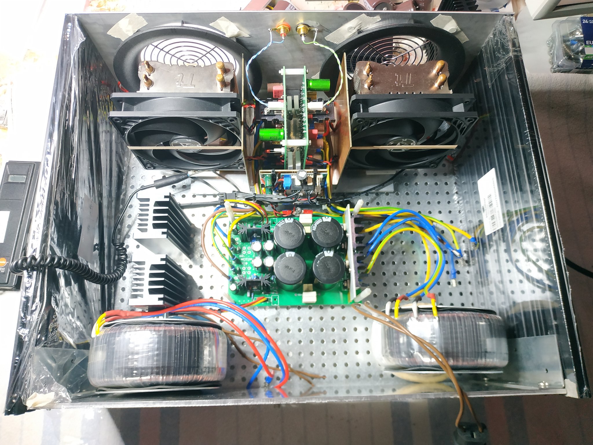

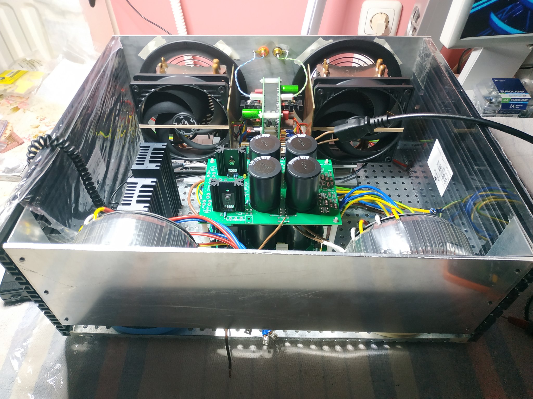

The heat issue is a tricky one. Here in Spain, unfortunately, there are also episodes of very hot weather.
Luckily, I have been able to mount an air conditioner at home. The problem is that I can't finish mounting the Alpha Nirvana, nor some speakers that I'm making myself, the air conditioning has taken all my budget...what a rage 😤
I hope to clean up my economy soon.
Regards
Regards

I'm trying to finish the box and the second channel of the amp.....but the heat wave is holding me back. Tooooo hooot 36-43C this month.
In contrast, we are having some severely chill weather here - so my AN4Rs are making the temperature in my listening room a lot more friendly. 🙂
