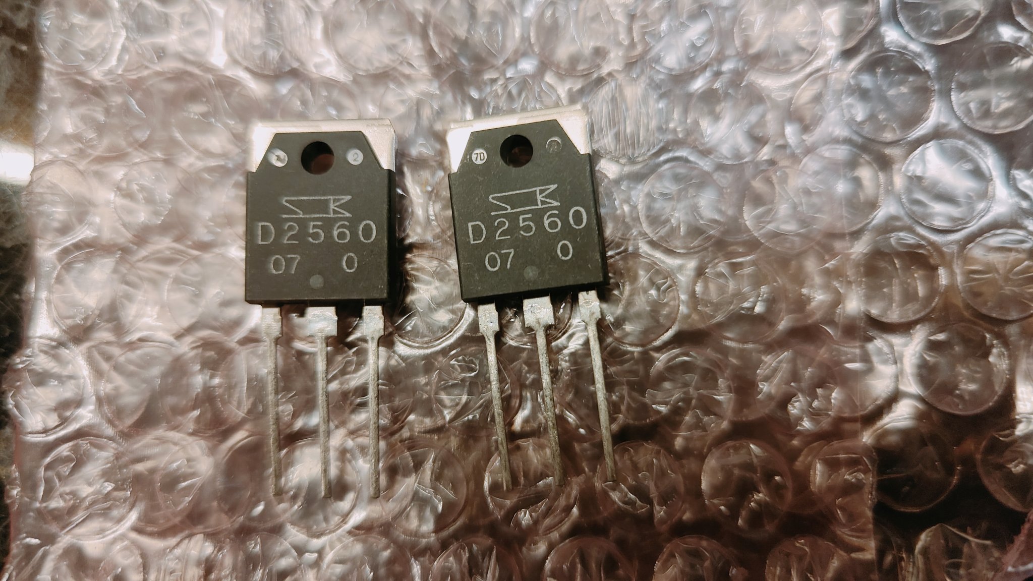

Got a pair from UK seller Littlediodes for £3.50ea + post. I'm not a big Digikey user and would have needed to have make up an order, so I'm happy with these.
Have not heard of "Littlediodes"; sure GBP3.50ea might be a good price ... but are you sure they're genuine? 😵
At least buying from the majors - like RS, Digikey or Element14 - you can be sure that their supply lines are kosher.

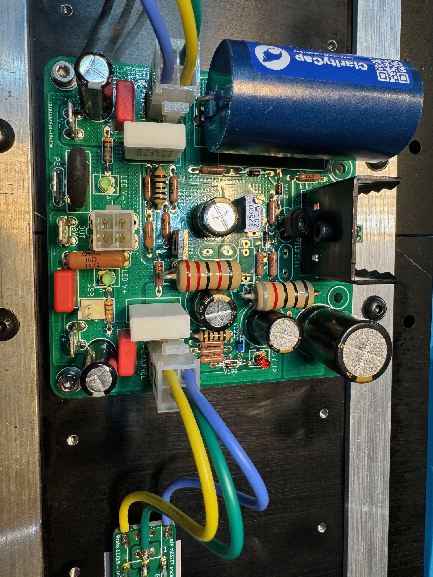

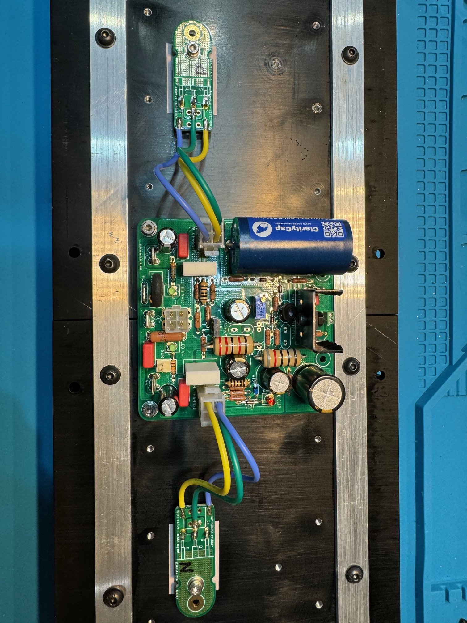

Yeah, this sucker runs hot. Each amp goes in a Modushop monoblock chassis, so that's a pair of 4U x 200mm heatsinks (so each output MOSFET is on its own 4U x 200mm heatsink). I have a thermal camera (FLIR TG267) which is reading about 55 degrees (celsius) on the heatsink and 63 degrees on top of the MOSFET helper PCBs. With the thermocouple reaching behind and directly on the MOSFET, it reads 74 degrees. So hot!
As for bias, I measure 334 mV across the 0.12 ohm resistor (R141), so that's 2.8 A. On the LTP, I measure 11.1 V across the 5 kohm resistor (R112), so that's 2.2 mA.
They'll go into the chassis and playing music later today (I hope).
